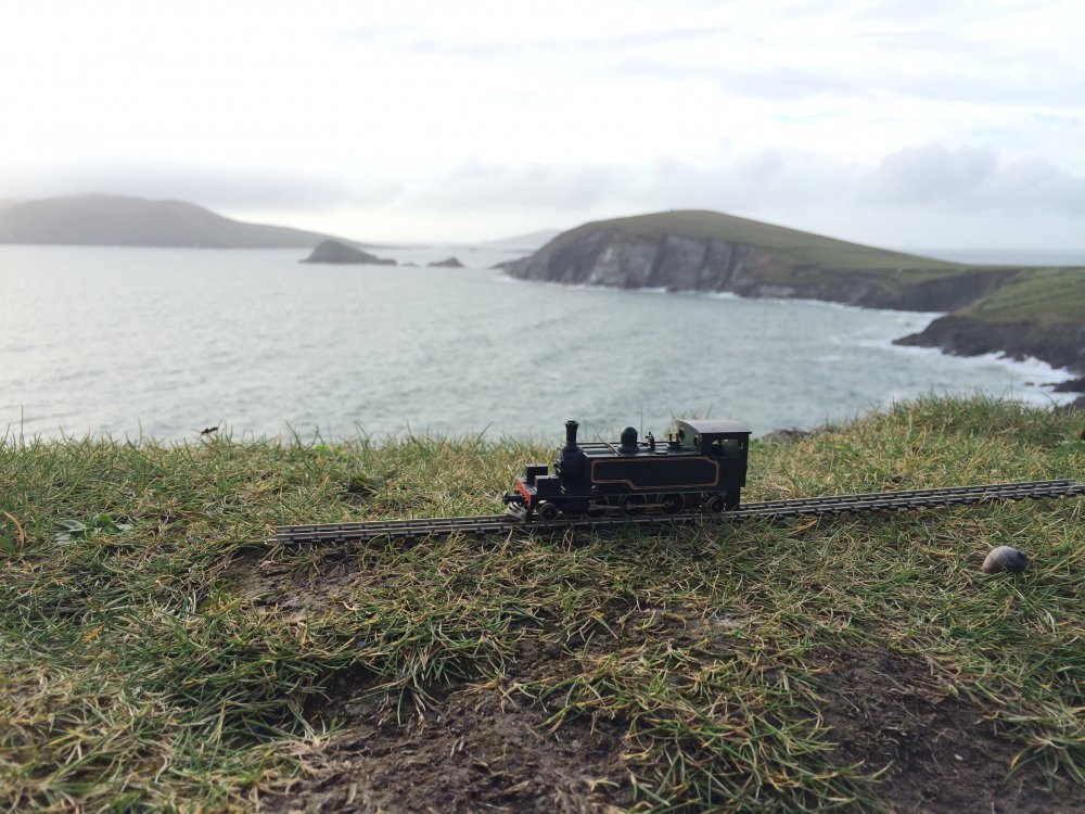

irishrail201 Posted December 13, 2017 Posted December 13, 2017 Hi All, A quick question, I have several T&D Chivers 009 model kits bodies assembled and would like to add handrails and knobs to add more detail to the loco. I have Alan Gibson short knobs and brass wire, but very little experience as to how to go about it. I even have a small hand drill to cut a hole in the whitemetal body. If anyone can assist let me know Here is 5T seen overlooking Slea Head and the Blaskets, surely the furthest a T&D loco has gone! 1 Quote
Noel Posted December 13, 2017 Posted December 13, 2017 (edited) Super photo of an amazing place. Sailed through it many times. Nice loco too. Sorry can't help but interested in the answers you get. Edited December 13, 2017 by Noel 1 Quote
