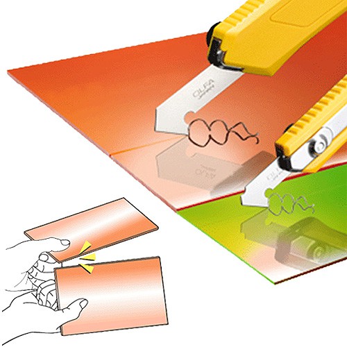

Broithe Posted February 11, 2018 Posted February 11, 2018 46 minutes ago, GNRi1959 said: Cutting wills sheets with a craft knife can be very dangerous. I’ve had one or two very deep cuts after blades slipped! Olfa (and others) make "plastic cutters" which are a much safer option than the standard 'Stanley knife' approach. They work by 'ploughing' a V-shaped groove which is then used to snap the sheet. Much less scope for personal damage.... 2
David Holman Posted February 12, 2018 Posted February 12, 2018 11 hours ago, GNRi1959 said: Cutting wills sheets with a craft knife can be very dangerous. I’ve had one or two very deep cuts after blades slipped! Would be a liar if I said I had no scars (picking up a soldering iron at the hot end is a bad idea too). However, provided the blade is really sharp, then you don't need to apply too much pressure and hence the knife is less likely to slip. Have used craft knives with snap off blades for years. As soon as the tip starts to wear, simply snap off a new one. (Mostly) works for me, though the Olfa gizmo certainly looks good.
