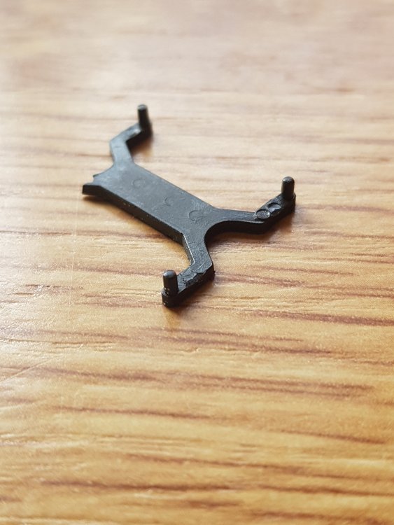

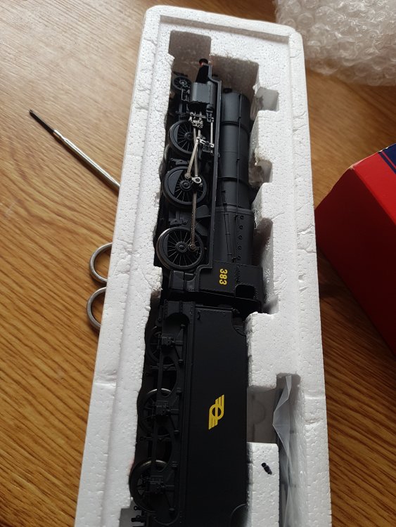

heirflick Posted February 22, 2019 Posted February 22, 2019 Hows the boys? Got this loco for the handsome price of nothing ...its in perfect condition, but manhandled by a toddler who broke the drawbar. The bar itself is plastic and appears easy to damage so has anyone got any suggestions as to a stronger replacment? Thanks!
Mike 84C Posted February 22, 2019 Posted February 22, 2019 Use the damaged one as a template to make a new one from brass or nickle silver. Use wire to solder in the pegs. Or make a plastic replacement and laminate a strengthening piece on top and bottom. Or contact Bachmann and see if its available as a spare part. FOC , that model is worth a lot of effort, that was a jammy sort of gift! Mick 2 1
Broithe Posted February 22, 2019 Posted February 22, 2019 You could get 'somebody' to knock up a brass one? It looks like it is a close-coupling cam type thing... 1

murrayec Posted February 25, 2019 Posted February 25, 2019 Hi Heirflick Do a sharp pencil sketch around the edge of the part on white paper- as close to the edge as you can get it, also measure the overall length, the thickness of the part, the diameter of the pins, the height of the pins and include them on the sketch, scan the sketch to a jpg and send it by pm to me .... and we'll see what can be done! Eoin 2
Broithe Posted February 26, 2019 Posted February 26, 2019 On 2/22/2019 at 2:04 PM, Broithe said: You could get 'somebody' to knock up a brass one? It looks like it is a close-coupling cam type thing... 9 hours ago, murrayec said: Hi Heirflick Do a sharp pencil sketch around the edge of the part on white paper- as close to the edge as you can get it, also measure the overall length, the thickness of the part, the diameter of the pins, the height of the pins and include them on the sketch, scan the sketch to a jpg and send it by pm to me .... and we'll see what can be done! Eoin See.... 1
heirflick Posted February 28, 2019 Author Posted February 28, 2019 On 2/25/2019 at 11:27 PM, murrayec said: Hi Heirflick Do a sharp pencil sketch around the edge of the part on white paper- as close to the edge as you can get it, also measure the overall length, the thickness of the part, the diameter of the pins, the height of the pins and include them on the sketch, scan the sketch to a jpg and send it by pm to me .... and we'll see what can be done! Eoin Eoin, before I saw your reply I contacted Bachmann who are sending out a replacment for 5 pounds posted. As this loco will not be near little hands again and be given the care it deserves, the replacement drawbar will see me out! But I do thank you for the kind offer of help, it is really appreciated 2
