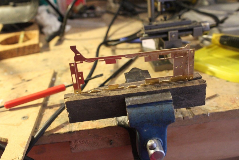

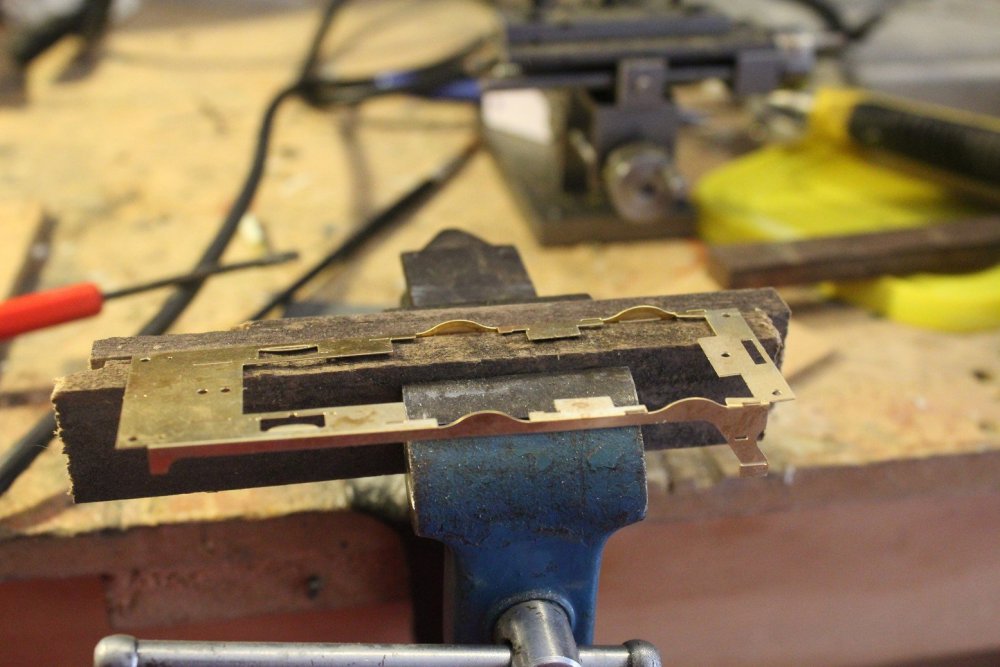

Not sure if I am a Luddite or Kiwi No 8 baling wire mentality I have had an Etch Mate  hold & fold tool for many years but rarely use it.
I prefer to clamp the workpiece upright in a vice and form the bend with a steel rule or even a strip of hardwood.
Sometimes the etched fold line is too-narrow to form a right angle. The fold line should be 1-1.2 times the thickness of the metal in order to etch ½ way through through the metal to form a 90° bend
I use aluminium angle or hardwood strips if the workpiece is linger than the vice!
Before
Steam loco valence clamped in vice, before bending footplate at 90° with a block of wood.
After:
Valences bent at 90° to running board.
