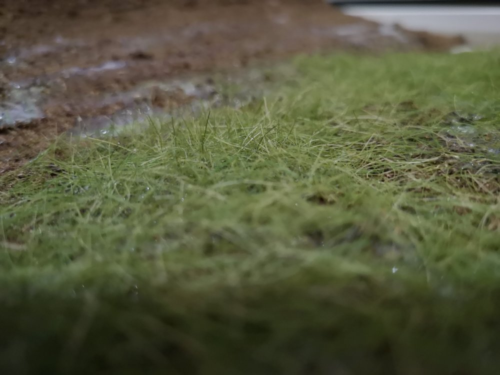

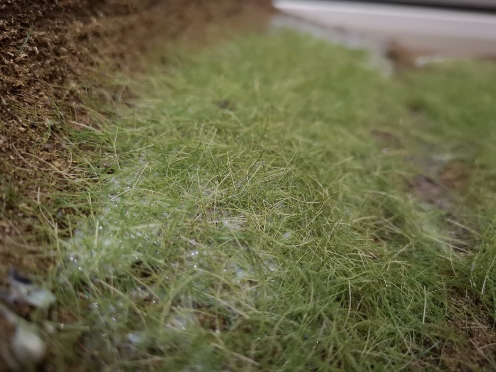

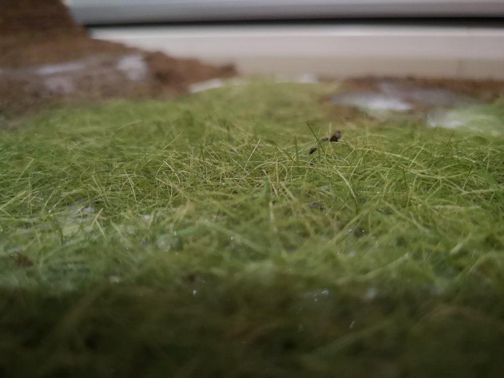

gm171 kk Posted May 14, 2020 Posted May 14, 2020 Just wondering if anyone has any suggestions. I've followed the instructions to the letter.

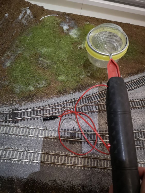

0 Garfield Posted May 14, 2020 Posted May 14, 2020 In the second photo, the pin/nail at the end of the wire linked to the applicator is not pushed into the surface adjacent to where you're laying the grass. This could be the problem. If you move onto a different area, you will need to take out the pin and insert it into the surface of the new location you are working on. Also, this may sound like a daft question, but... is the battery charged? 1
0 gm171 kk Posted May 15, 2020 Author Posted May 15, 2020 41 minutes ago, Garfield said: In the second photo, the pin/nail at the end of the wire linked to the applicator is not pushed into the surface adjacent to where you're laying the grass. This could be the problem. If you move onto a different area, you will need to take out the pin and insert it into the surface of the new location you are working on. Also, this may sound like a daft question, but... is the battery charged? That photo is just to show the applicator I'm using. The nail is always in contact with the board where I'm applying the grass. The batteries are new and hood quality. 1
0 Garfield Posted May 15, 2020 Posted May 15, 2020 4 minutes ago, gm171 kk said: That photo is just to show the applicator I'm using. The nail is always in contact with the board where I'm applying the grass. The batteries are new and hood quality. Hmm. Is there any indication that the applicator is taking power from the battery (e.g. a small LED that lights up when switched on)?

0 murrayec Posted May 15, 2020 Posted May 15, 2020 (edited) Just looking at the photos in your first post- it seems to me you have not spread the pva glue throughout! It should be a 'sea' of glue total in the area your working on and not just blobs here and there, also ensure the nail is attached to the sea of glue to complete the circuit...... I read somewhere that their might be difficulty with long static grass and that unit- try some shorter grass maybe. Eoin Edited May 15, 2020 by murrayec 3
0 Noel Posted May 15, 2020 Posted May 15, 2020 (edited) Why is the earthing pin touching a metal rail instead of driven into the wet board near where you are applying it? Also for conductivity better to use a simple metal pin or nail rather than a galvanised one. Edited May 15, 2020 by Noel

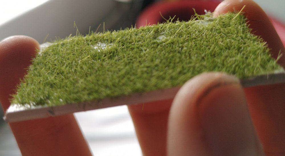

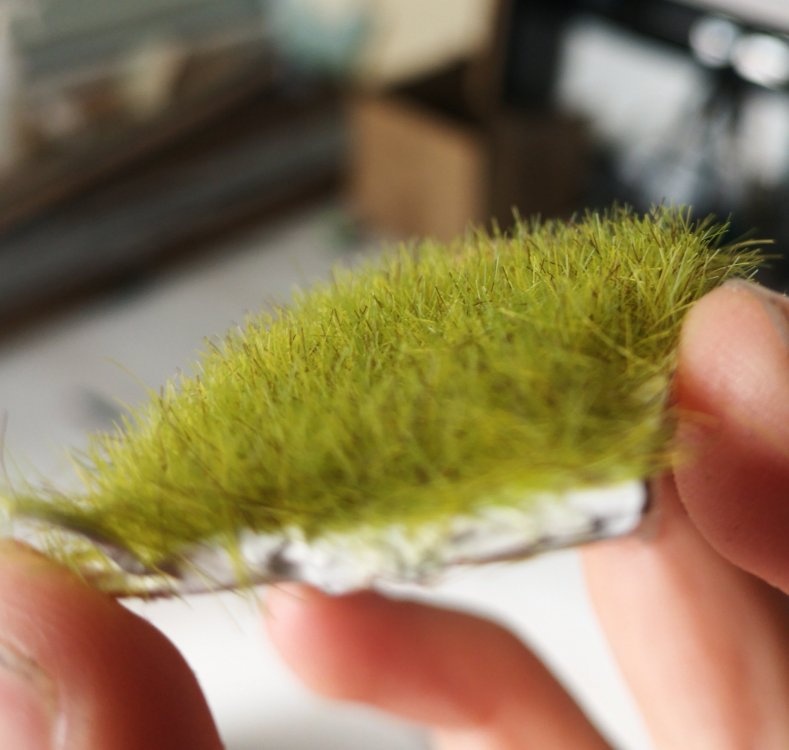

0 gm171 kk Posted May 15, 2020 Author Posted May 15, 2020 (edited) I've just tested these two this morning. I changed the nail to a wire to give me more room (I often hit the nail with the applicator). The 2mm grass is woodland scenics like the 12mm (not overly impressed with the result but most of it seems to stand). The 5mm grass is Faller and its all standing. Edited May 15, 2020 by gm171 kk 2
