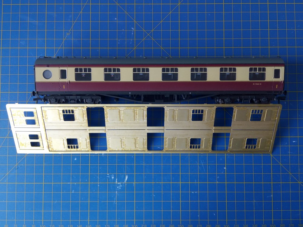

Next build lined up, the MED parcels/luggage van. I will be using a Bachmann LMS 60 foot porthole coach as victim, not cheap but it's the right length and the bogies look good too. The MED trailers converted to these vans followed the MED lightweight build (steel body frames, ribbed sides, low roofline) around the time body and chassis were being integrated into a modern tubular construction so they look fairly distinctive. It's not just the low roofline, the lack of a solebar gives a distinctive see-through look underneath, with towards the centre what looks like a hanger for the side valances once sported by these vehicles. So I think this needs to start from the bottom up, remove the Bachmann trusses completely, remove the solebar below buffer centreline and represent the hanger with remnants of solebar and truss. Then with this as baseline offer up the etched body sides to see how much needs to be removed from the top. I can't see much in the way of underfloor equipment (battery box offside? regulator box nearside?) so will remove everything except for the brake cylinders, v hangers and brake connections then see what can be done with the pieces. I'm not sure what the two-tone paintwork is all about - differential weathering maybe? - but most of these photos are of the same vehicle anyway so I will probably not bother. I will try some scrap brass for the steps and will also model the handrails at the centre doors and the corners (though perhaps not the knobs) and maybe the lamp brackets too after plating over the ends with flat plastic sheet. I think the MEDs might have had smaller 3' wheelsets too so might have to change the Bachmann 14mm wheels for 12mm to get the full see-through look. As for the roof, I have ordered an aluminium BR Mark 1 profile and hope to flatten it somewhat with a rolling pin!

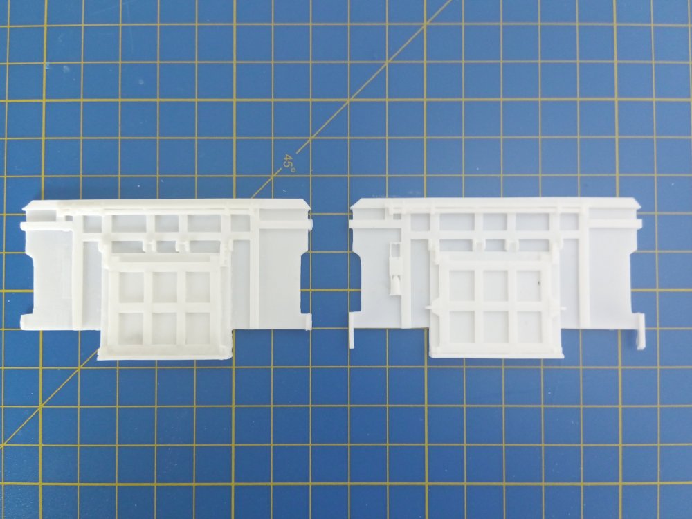

Made a start on the spoil wagons. I am modelling them in their later PW configuration so (left hand side) have removed the ram that powered the door-lifting chain, the door lugs to which the chains were attached via the rotating bar at the top and the hangers for the footboards(?) on the solebar. I won't be modelling the handrails either, except for the remarkably persistent centre handrail, nor the cutoff half door/removed top lip variant as I think it diminishes the essential character of these implacable brutes I'm not at all sure how they operate in this configuration but, as far as I can make out, in their original configuration the ram pulled down on a chain attached to the outside of the top bar which caused it to rotate so that chains fitted further along on the inside of the bar raised the door above doorstops on each side until the load forced the bottom of the door open and was discharged. The handrails and footboards(?) were presumably used by two fellas who relocated the door behind its stops as it was lowered back down. With the houses that close this must be right next to the main line out of York Road station

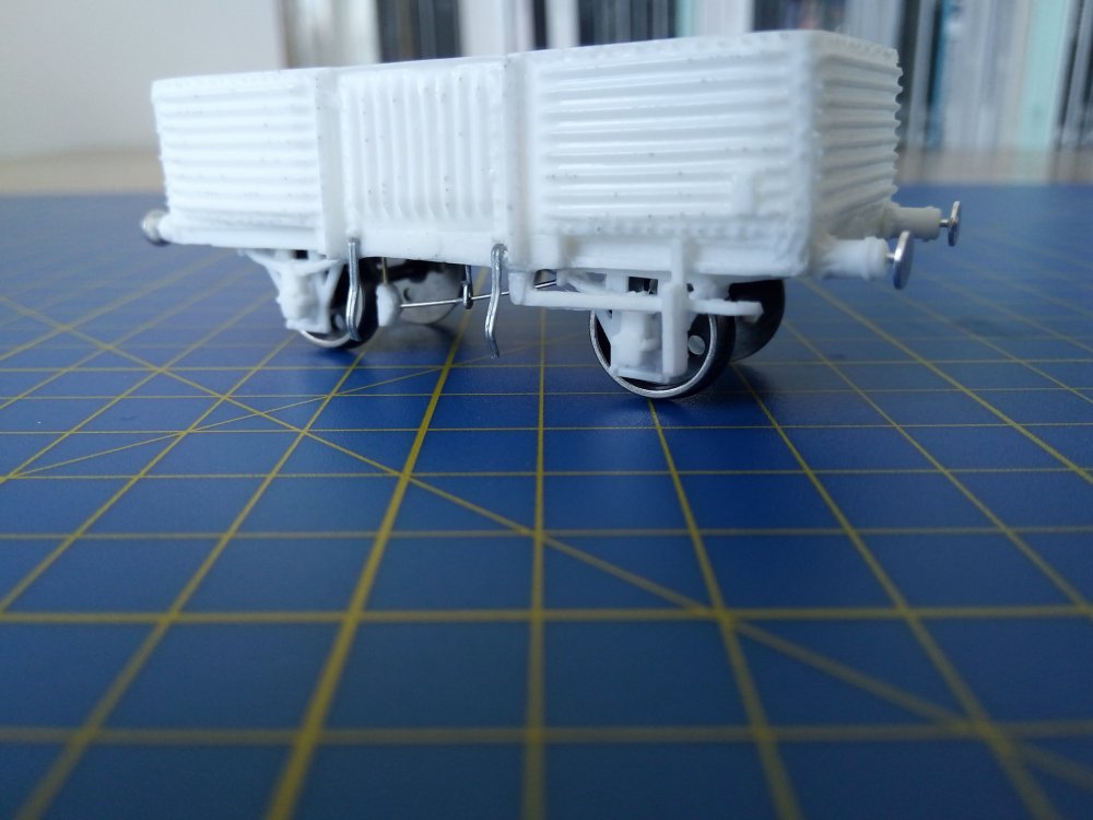

My first kitbuild. It's a wide-angle photo, the buffers are not that wonky Not prototypical but I needed a fairly easy kit to start with, though I'm sure I saw one or two knocking about NIR in the 80s. Next up three NIR spoil wagons, with the open wagon above that should make for a decent PW train. Happy Easter!
