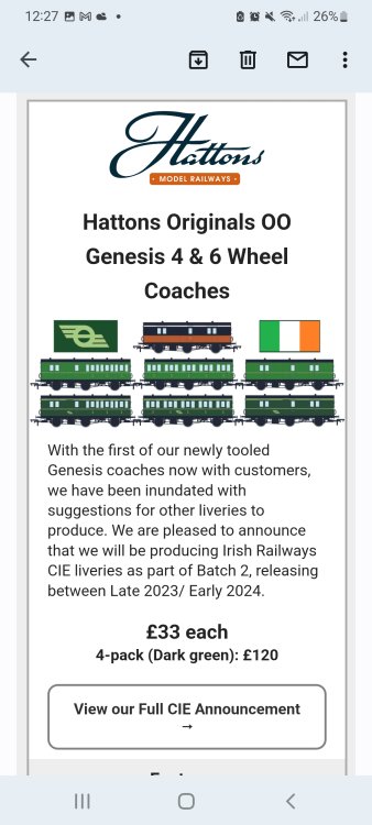

Preordered a set of 4, should look the bee knees alongside Mk2s, Cravens, 4 wheelers and generic irish-ified coaches in a mixed rake behind an A class! Well done lads!

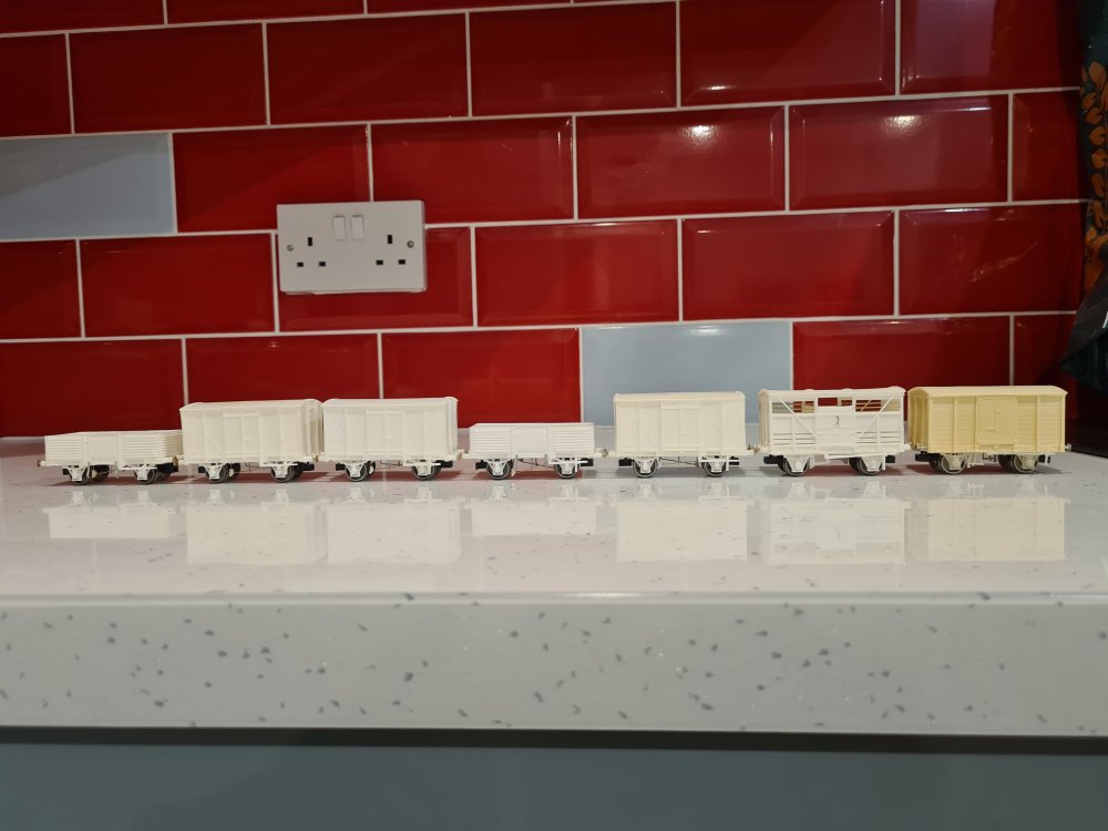

7 wagons ready for the paintshop! More of Leslie's wonderful wagons and bar some user error and complete cockup of a kit, some lovely kits to build! Just 4 more cattle vans to be assembled and my kit backlog will be cleared! Thanks, Dane

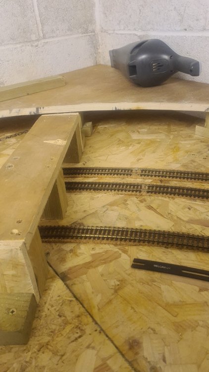

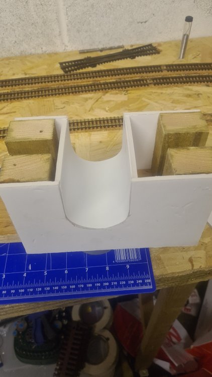

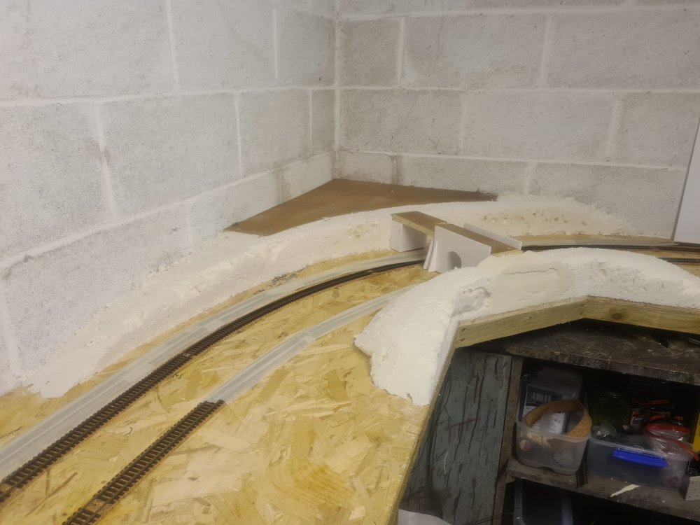

Took a notion and decided to start scenic work on one corner, I'm happy with the trackwork, fully tested with Steam, Diesel, DMUs, Coaching stock, and twin axle and Bogie freight, all running smoothly. Trying to construct it to look like the branch line was there originally and the main lines were added after, with an older stone style bridge transitioning into a more modern plate girder style bridge and a cutting to allow the two main lines to pass through. Raised section was built from offcuts from my first layout attempt and packed with insulation foam, followed by expanding foam and cut down to suit. Bridge is a hodgepodge of wooden offcuts, clad in foam board and plasticard, waiting for Slaters embossed plasicard to make it look more bridge-ey. I'll have to get more embossed plasicard and foam board to create the cutting walls before using Sculptamold to build up/fill areas before plaster being applied to lock it all in. Thanks all!

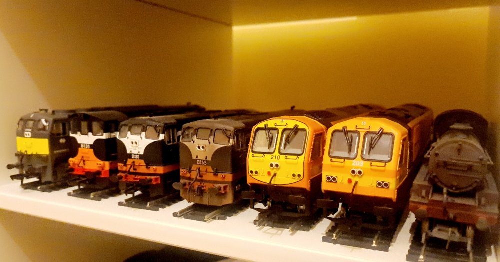

Recent addition of River Erne and River Corrib brings me up to a healthy stable of GM locos (including 177, currently on testing duties), and my Mogul even snuck in for a photo too

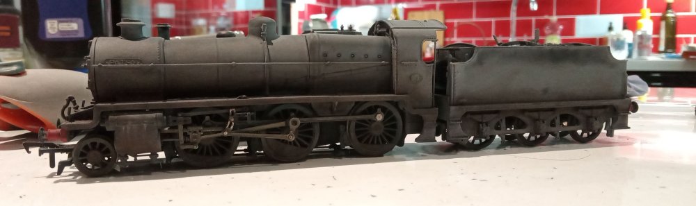

Correct on all accounts, boiler has a sizable weight inside of it, as does the tender, the shell itself is plastic Bit of an oddity I assume but the actual firebox controls on the foorplate themselves are one big die-cast chunk
Putting aside my awful paint and weathering attempt, I do have to say the moguls are rather fetching in a mundane kinda way in the grey! I'd love one with a proper non split, dcc ready chassis and that horrific quasi kinematic drawbar revised Other than that, they're a great model to cut your teeth on and a easy modification to start your irish steam conversions!

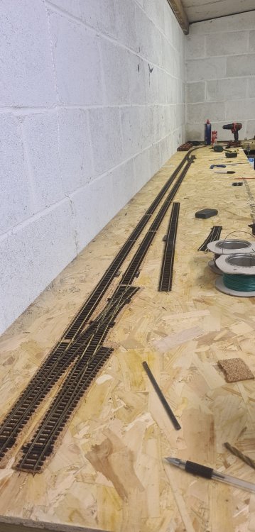

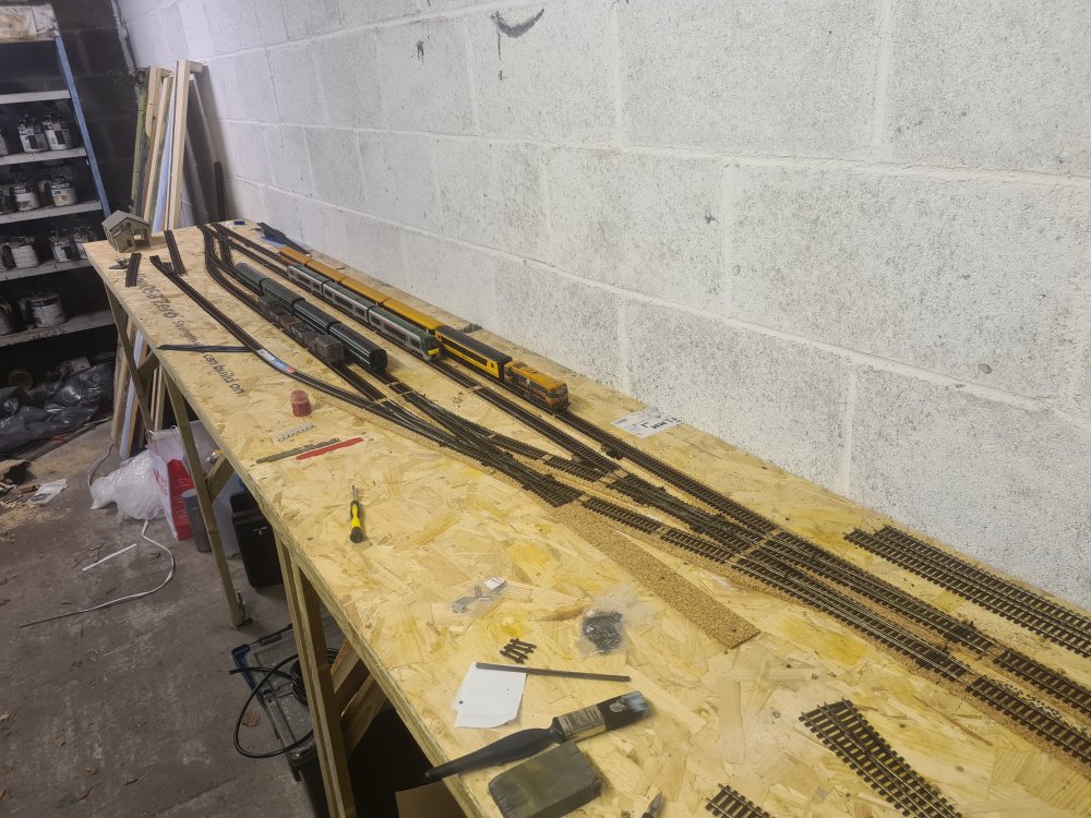

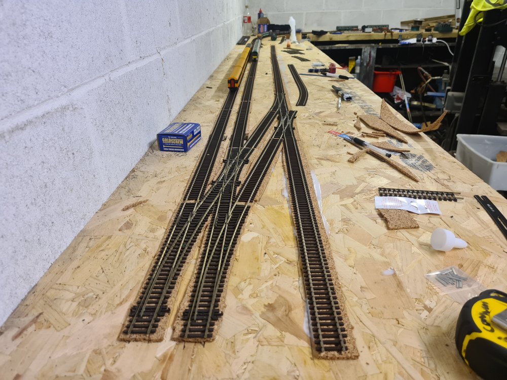

After finally managing to get some Flexitrack and paintwork, the 4 platform station area is beginning to come together, still waiting for things to get moved, but progress is progress! For scenic areas, 48" radius curves will be the minimum, with some tighter 3rd and 4th radius curves in hidden/non scenic areas. As well as long radius points wherever possible, with mid radius points for storage areas and short radius for the depot only. Early days yet, but it's beginning to start to look kind of like a layout!

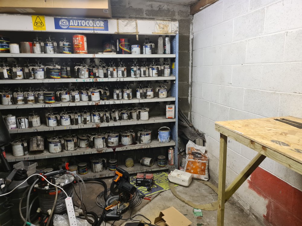

Unfortunately I didn't get as far along as I had hoped so far, the paint rack, tyre machine and pillar drill are blocking progress and to get that moved, there is a pair of MK2 Escorts that themselves have to be moved back to my uncles yard, so everything is on hold until they move. That aside, Baseboard three is built, another 8x2 board, bring the total length of usable baseboards up to 23ft so far, a rake of 12 gypsum wagons can be seen in the back left corner for scale Baseboard 4 will drop a couple of inches to give the layout a variety of elevations, I'm planning to include a small dock/town street in the lower area With not a lot else to do, I've turned to trying to pin down an exact track plan, though its hard to scale and plan for space with just my mind and pen and paper. As well as sitting by the window the arrival of my Ferts, loaded and empty 40s

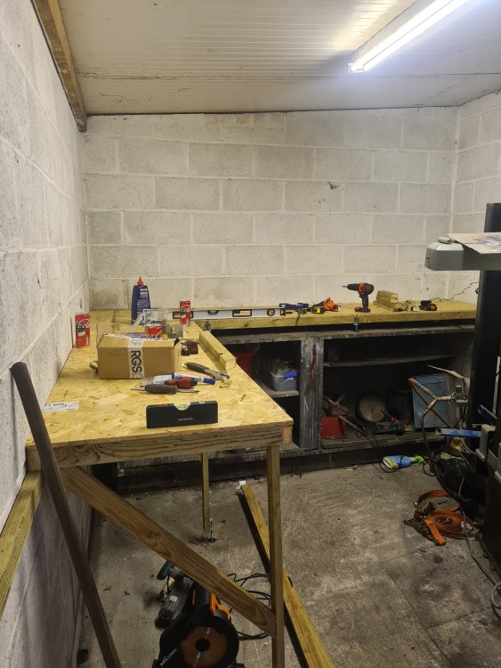

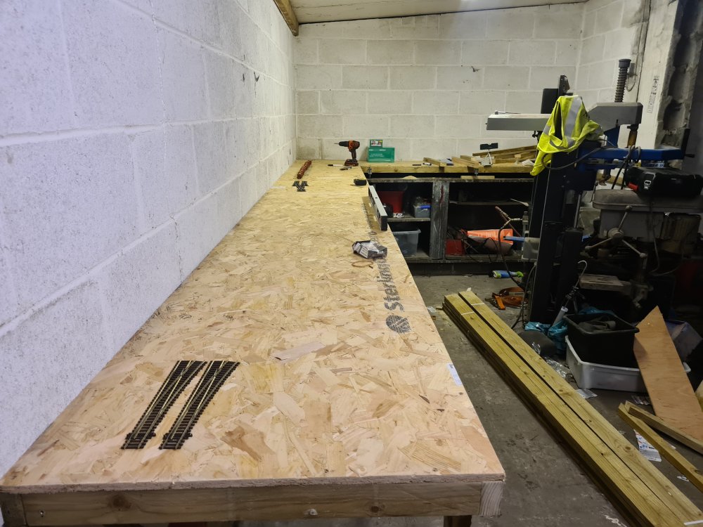

The main layout has begun in earnest! Two baseboards built and leveled measuring 8×2 and 7×2. The beauty of backing onto a solid cavity block wall is the ability to fix a length of 2×1 which gives me the back side level meaning the front side is the only area to worry about. Just awaiting more timber to continue the build now!
