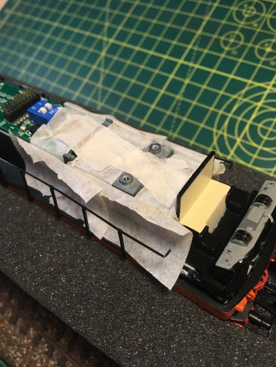

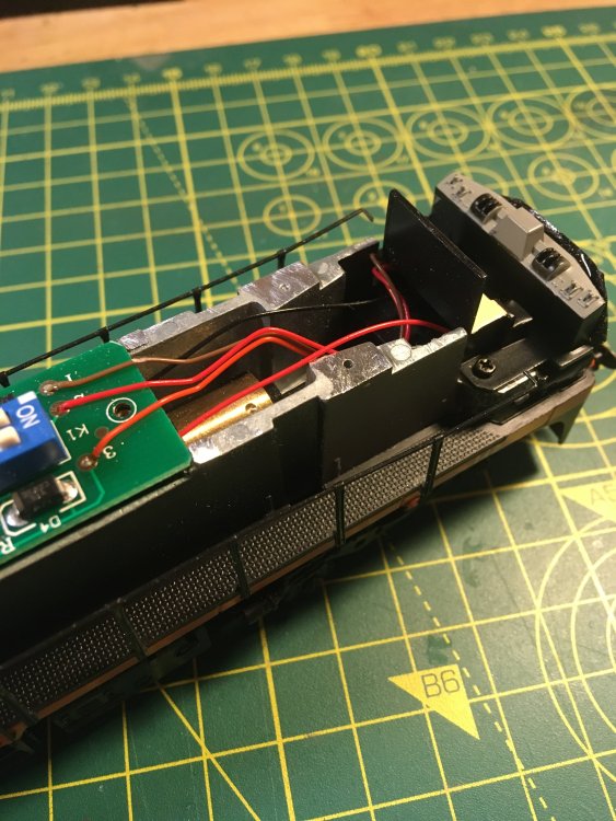

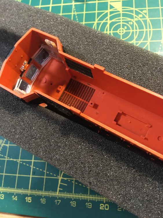

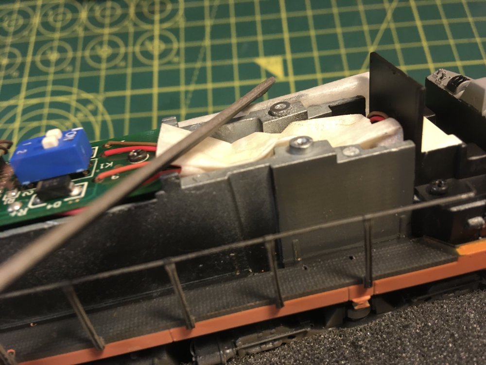

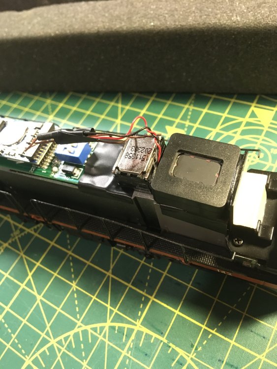

@mmie353 I literally just finished sound testing a load of different speakers on my 141/181s - I get them from Roads and Rails as well. You might find this useful... 1. The playlist of different speakers tested is here and you can judge for yourself (I found a combination of a sugarcube and megabass worked best for bass and higher freq sounds): 2. There's a direct comparison video of double iPhone vs sugarcube & megabass in that playlist as well - second last vid 3. Here's a few pics of how to file off the lugs (4 metal on the chassis, 1 plastic inside the roof of the loco) and fit the speakers (get some black tack from Roads & Rails if you are ordering, it's class): You can get a set of files from Woodies for a few quid Make sure and mask up to stop the filed metal falling into the motor Metal lugs filed off Cut / file off the plastic lug on the right in this picture Black tack is very handy for sticking down the speakers - I covered over chassis with black tape as a speaker base - left a gap in the tape for air to circulate around the motor (not sure if needed but was being cautious ) 4. And the finished result is here Hope that helps your decisions! -

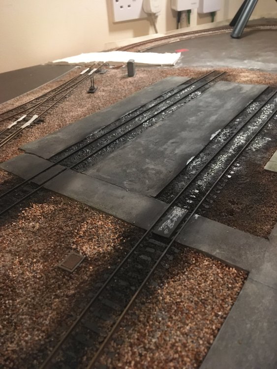

Phase 2 is complete! So in this phase I concentrated on getting the ballast in place with a base level of weathering and some trackside details. I've gone for a really dirty, oily 1980s depot look, with lots of spilled oil around the tracks as well as oil leaks from the locos along the most used routes in the depot. Things are much cleaner nowadays but they really didn't bother cleaning anything in the 80s! Have included a set of reference photos as well that I was working from. I also experimented with point motors, manual levers and point rodding to see how it would look - it turned out great but the point rodding was very fiddly (especially as I had already laid the ballast and had to dig some of it up). In the end I decided that in our depot, the last of the old point rodding was about to be removed and replaced with manual levers, and some of the previous point rodding was just lying around, rusting with time. This will eventually be overgrown with grass and weeds etc. in the next phase. Honestly, I'm delighted with this result One thing I found as well is that as most phones have cameras at the top, if you hold the phone upside down you can get a much more realistic perspective Also, reversing the camera and placing the phone in unusual places can give you great, normally unseen shots looking out from the back of the layout - just a quick tip for any folks reading this In the next phase (Feb - Apr) I hope to complete: Backscenes Fuelling point Level crossing road surface Static grass and overgrown areas Weathering of the sheds Practice weathering on some old locos and body shells that I have - no way I'm starting on my lovely Irish locos! As always, I welcome any feedback / thoughts / ideas people have - enjoy the photos and the short video at the end! --- Reference photos I was working from: Looking across the depot from the fuelling point into the setting sun (got this shot totally by accident when the phone looked directly at the light bulb ) Looking through the engine shed with light reflecting on oil stains #183 in the headshunt with old rails and the last of the point rodding still in place before being replaced in our fictitious depot Obsolete point lever frames and rusty point rodding, with manual point levers, a relay box, manhole and rusted rails This siding in the foreground will be a little overgrown and used for fuel tanker deliveries - I'll probably add some fuel pumps into the ground for pumping fuel from the tankers to the fuelling point #073 sitting on the fuel point, with oil stains reflecting the light The other section of the layout (initially just for loading locos out of sight, but I decided I might as well practice here too and make this section more modern) has electronic point motors, with cable trunking emerging from a (future) tunnel and exposed wiring to the motors and relay boxes Note the oil stains where locos idle, waiting for release from the sidings, between the sidings will have some weeds and static grass added in the next phase. The rusty siding to the lower right is no longer used and will be totally overgrown. Cable bundles running from the trunking to the relay boxes, these will also be overgrown with weeds Another unusual perspective, I love the foreshortening effect on curves when seen from this angle Murphy Models class 071 #073 on a short move from the headshunt into the fuelling point- 80 replies

This is a very quick series of videos on how to get that dirty, almost smooth, oily ballast typical of a filthy fuelling point. I experimented with fireplace ash, coal dust and baby powder to get the right consistency and found that a 3:1 mix of baby powder and coal dust did the trick. My wife thought I'd lost it when she found me in the sitting room scooping coal dust out of the bucket with a spoon! Here's the end result: The playlist has 5 x 1 min videos - jus enough for a cuppa You can watch individual videos or the full playlist is below... * Step 1: Add the baby powder / coal mix * Step 2: Airbrush a base layer of grime * Step 3: Spray on a heavier oily layer * Step 4: Add oily patches * Step 5: Add reflections Full Playlist
