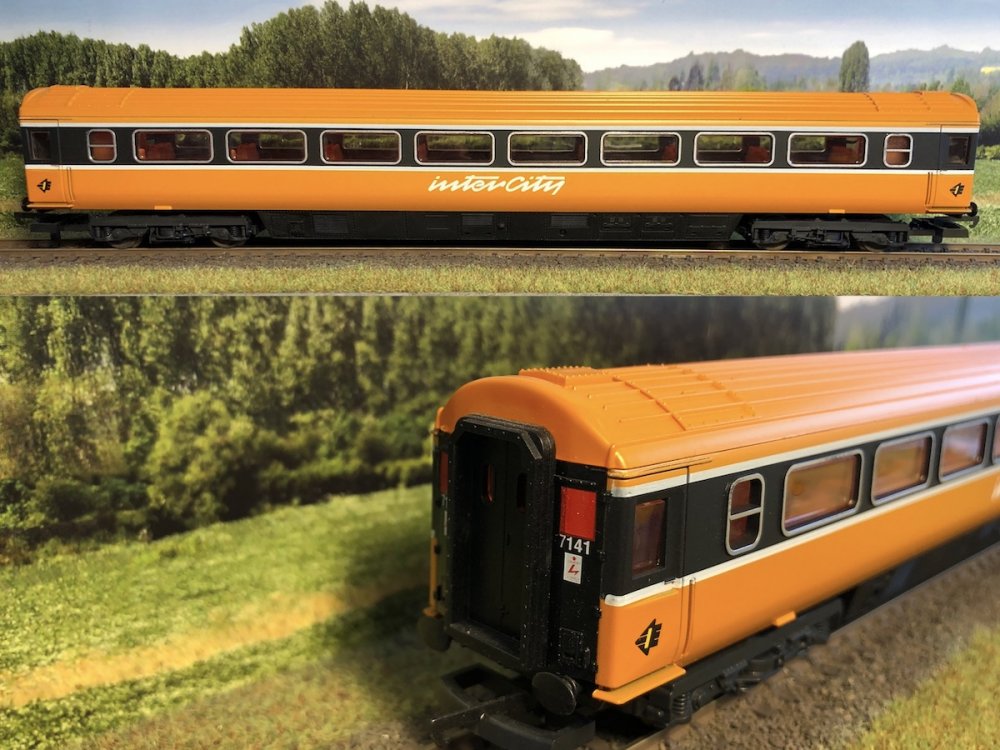

  13. One final Hornby 'shortie' respray Resprayed the black chassis black on top of grey primer coat because the pristine shiny black plastic looks toy like and weathering paint won't take to that plastic. This will bring the rake of mk3s up to 9 coaches inc EGV (when I've finished the EGV).

  15. Gobsmacked, wow David ‘Enniskillen’ looks utterly sublime, another brass maestro is born. Respect. Amazing it’s in brass, a scratch build and your first is a striking achievement.
