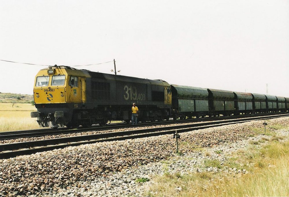

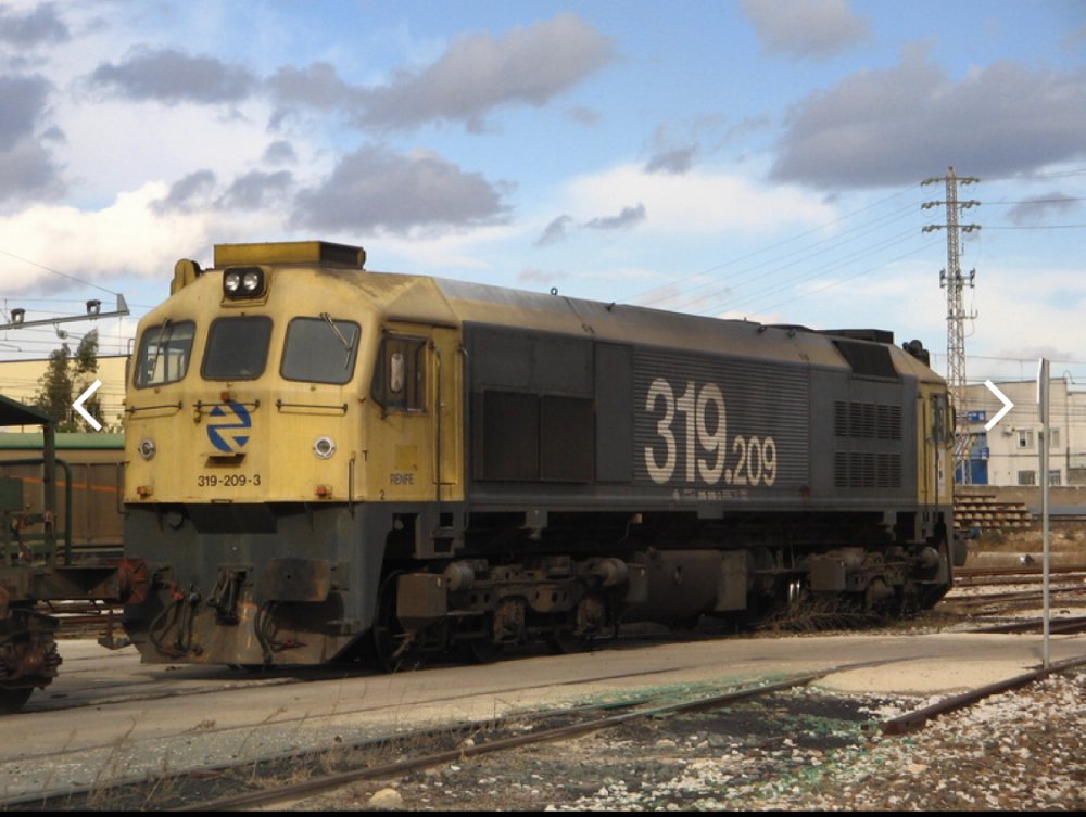

Moxy Posted May 25, 2021 Posted May 25, 2021 GM switcher demonstrating what happens when it meets a smaller loading gauge. https://www.lner.info/forums/viewtopic.php?p=116509#p116509 This was after a runaway and meeting a tunnel it wasn't designed to fit through. Quote
