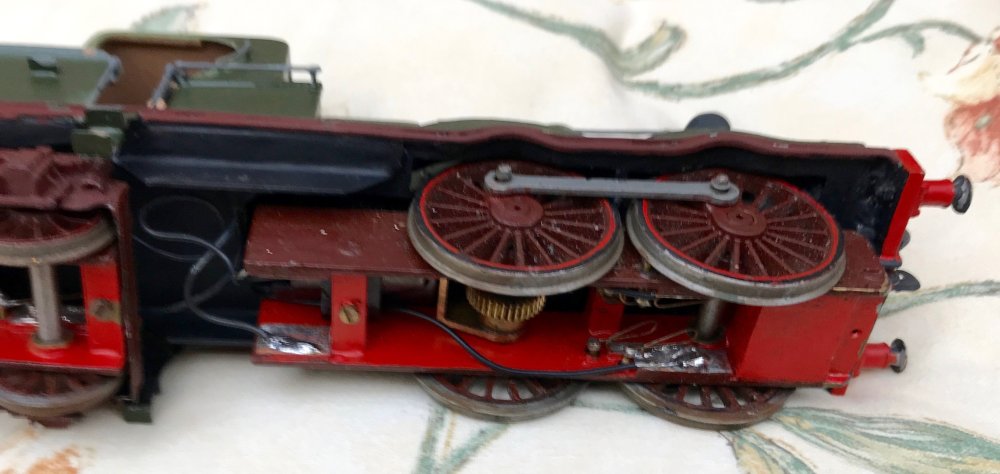

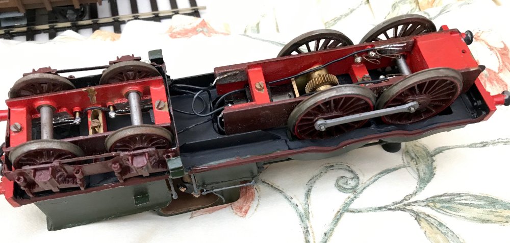

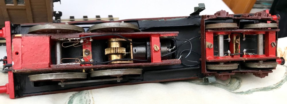

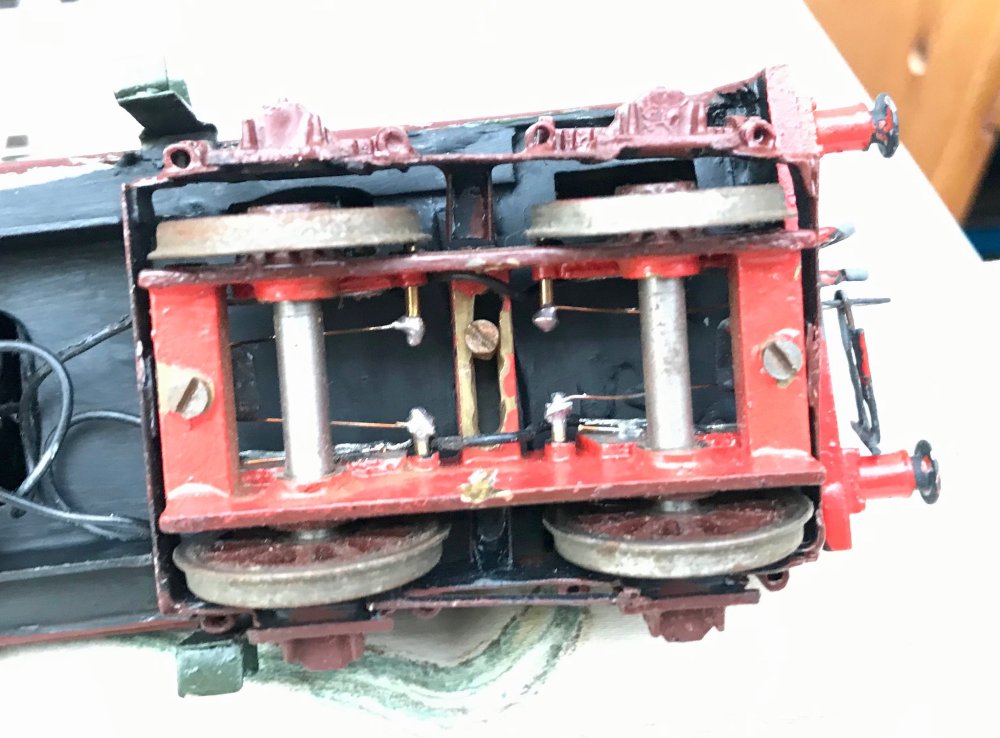

leslie10646 Posted August 28, 2023 Posted August 28, 2023 On 18/8/2023 at 9:43 AM, Northroader said: Perhaps, Leslie, if you can do a photo of beneath the loco looking up, folks can get a better idea of how the leading coupled drivers are mounted? I'll oblige later this week. 1
Northroader Posted September 5, 2023 Author Posted September 5, 2023 (edited) Thanks, Leslie, so what are we looking at here? I’ve done three 0-4-4T locos besides this one, and I’ve found that you need to allow the rear bogie to traverse sideways across the loco, besides just pivoting centrally, because the leading drivers are fixed to the superstructure. On a curve this displaces the rear end of the loco sideways by a fair amount, and so the pin the bogie turns on works in a slot across the bogie frame. The first batch of the GSWR 0-4-4T were originally built as Fairlie engines, with the driving wheels mounted on a bogie, as well as the carrying wheels at the back end, so the whole lot worked very like a modern Bo-Bo diesel. Later versions were built without the driving wheel bogie, I suppose because of the trouble with having flexible steam pipe joints, The trouble is in a model, this particular class does have quite an appreciable distance between the front and back sets of wheels, and you do encounter sharper curves, so you do need a bit of flexibility. To do this, the Driving wheel sets are mounted on a frame as well, with a central stretcher with a hole for a pivot screw which attaches the frame to the superstructure. The motor is mounted on the back axle, and points backwards so as to clear the central pivot. The motor fits inside the firebox, with a small amount of clearance on each side, so it can wag from side to side a bit. (If the engine had full side tanks it would be much better for the clearances) There’s a brass block at the leading end of the frame to help balance the motor overhang. Then the rear bogie has a full slot across the middle stretcher for the pivot pin to traverse across the full width. There’s pickups on all the wheels, though I see the wheels are starting to get a bit rusty. That’s the trouble with Slaters wheels, they do the tyres in mild steel to keep costs down, fair enough, but on a loco which has been around some time, you have to go round with some emery. Edited September 5, 2023 by Northroader 7 1
David Holman Posted September 7, 2023 Posted September 7, 2023 Clever! The Sligo 0-6-4 tanks likewise require a bogie with side play/springs and need careful driving on Northport Quay - though they shouldn't be going fast in such a confined space anyway... 2 1

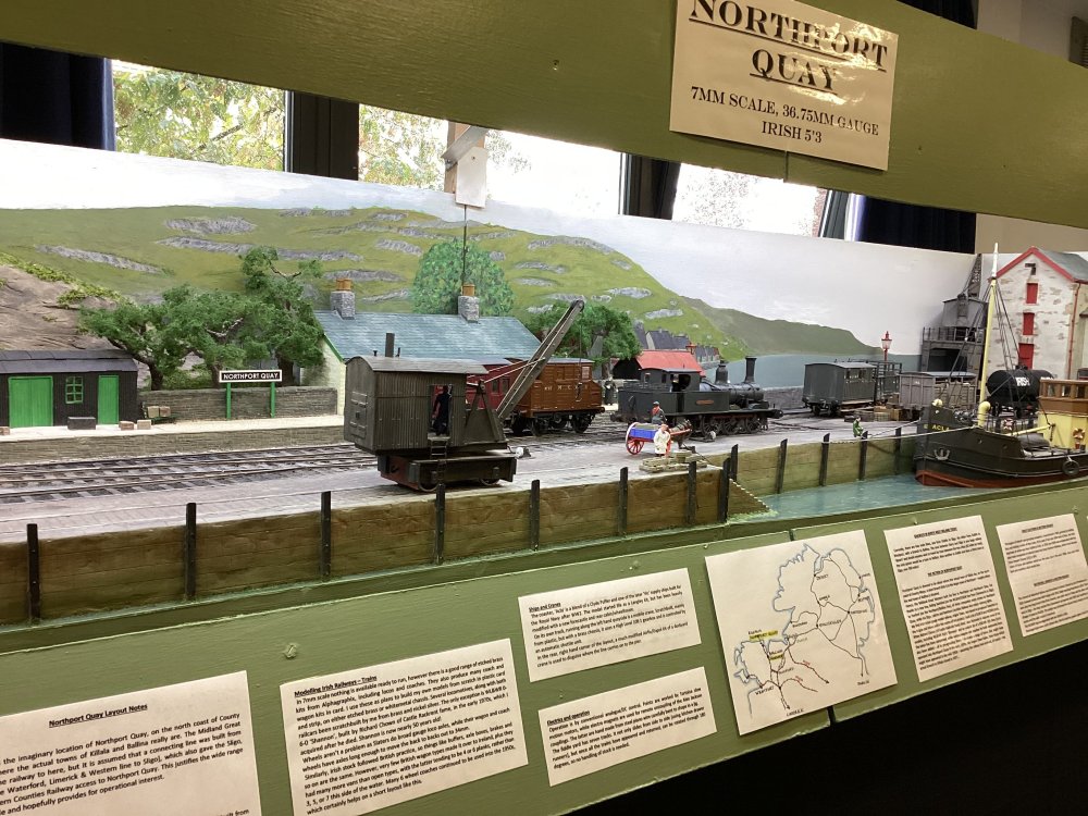

Northroader Posted October 21, 2023 Author Posted October 21, 2023 (edited) So today was a trip out, to Uckfield in East Sussex. The model railway club there have a reputation for organising outstanding thought out range of layouts, and so it is this weekend. A star attraction for me was Northport Quay, David Holmans line, and seeing it in the solid was most enjoyable. Edited October 22, 2023 by Northroader 9 1

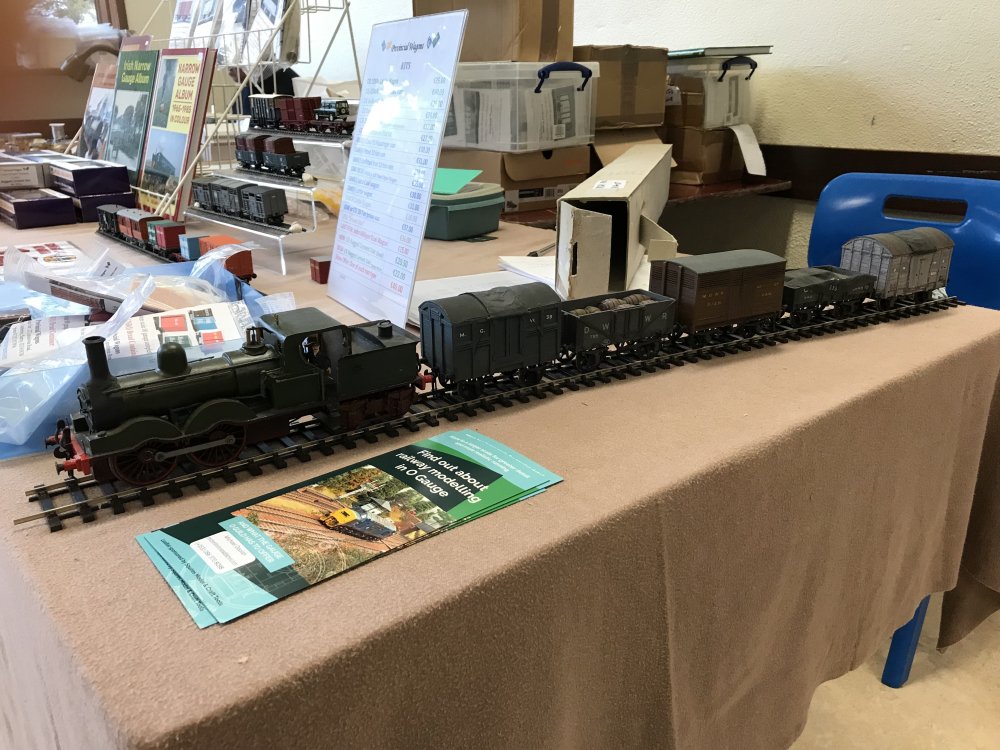

leslie10646 Posted October 29, 2023 Posted October 29, 2023 Handover Day. A little photo for Bob, so that he can see KMCE and Yours Truly transacting the Deed. I displayed Bob's J15 (157) and train on my stand at Blackrock until Ken turned up today - so this is the Handover. Bob, your GSWR 2-4-2T and Cattle Train took No.157's place. We'll get a photo of that train on "Ardmore" tomorrow. Needless to say, the passing folk greatly admired the train and one little man explained the relevant parts of the steam loco to his Dad. An enthusiast in the making. It was a privilege to display them. 8

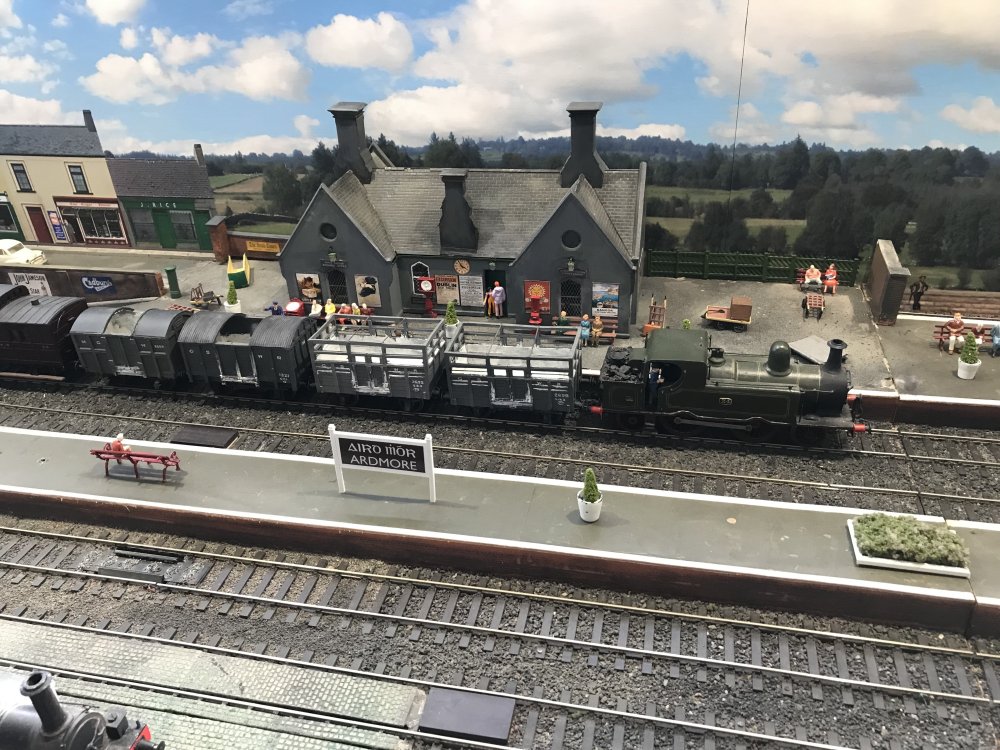

leslie10646 Posted October 31, 2023 Posted October 31, 2023 (edited) Handover N0.2. With the MRSI guys on "ARDMORE" admiring Bob's 2-4-2T and a cattle train. Later, after exhibiting it on my sales stand, I brought them the McDonnell 0-4-4T with its mixed goods set. Bob, I can tell you that they were delighted. Edited October 31, 2023 by leslie10646 10

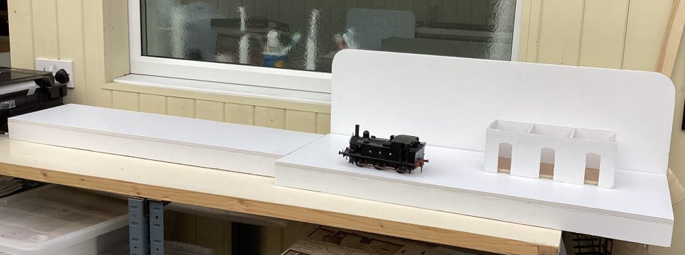

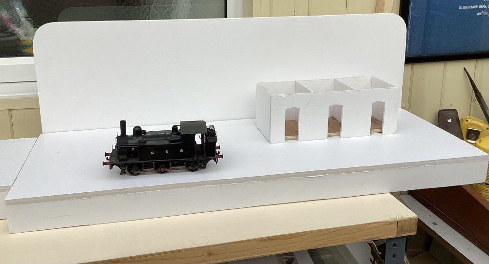

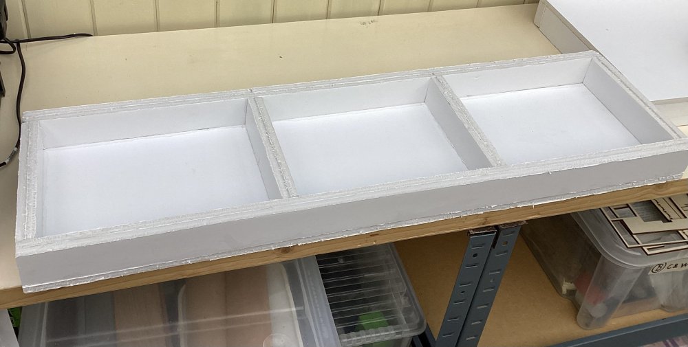

Northroader Posted November 4, 2023 Author Posted November 4, 2023 This small layout that’s been threatened is starting to take shape, beginning with a new baseboard, as all the old stuff went to the council tip before the move. Rather than doing it in 2x1 and chipboard, I thought I’d try foamboard this time, so I ordered a pack of 10mm thick foamboard, A1 paper size.(That’s 33.1” x 23.4”, or 840mm x 594mm) I only used two sheets for this job, so it’s quite competitive with using timber, though not so durable of course. I cut a strip 12” wide lengthwise off a sheet to give me the top for the main board, then the rest of the board went in six 48mm wide strips. These were glued together in pairs, using PVA Bond, and used for the reinforcing runners under the top. The other board gave me a 9” wide top for a three road fiddle yard, and the rest of the reinforcing strips. Here’s the two together, with a 7mm 0-6-0T and a small station building roughed out to give an idea of how it will look. Theres a 5mm thick foamboard to act as a backscene support. Obviously you can’t screw, nail, or use track pins, everything needs gluing, but the back sheet is bolted on, using 2mm thick ply pads glued on the outer faces. The two boards are just resting loose on a “tabletop”, an old door made narrow. The rail tracks will register across the join between the two boards, but the boards will stay loose, as I am treating the fiddle board as a single large cassette. 8
Galteemore Posted November 4, 2023 Posted November 4, 2023 Quick work Bob. Looking forward to seeing this develop. Nice little GER loco too…..
Northroader Posted November 4, 2023 Author Posted November 4, 2023 I fancy the rails will be a bit too wide for the wheels on that one. 1

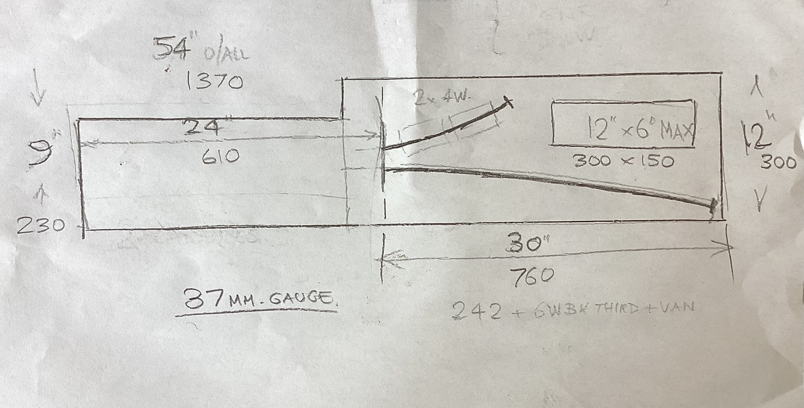

Northroader Posted November 5, 2023 Author Posted November 5, 2023 What I’m looking at is “Lyddlow Goods”, described in this “Despatch”. Very simple, but Jordan can spend a pleasant half hour shuffling a few wagons. https://micromodelrailwaydispatch.com/wp-content/uploads/2022/03/Issue204_finished-compressed.pdf I see you used to go to exhibitions with a version of “Halstead” (that’s what I take it to be?) much the same but with a kickback siding added. https://www.westernthunder.co.uk/threads/halstead.12154/ 4

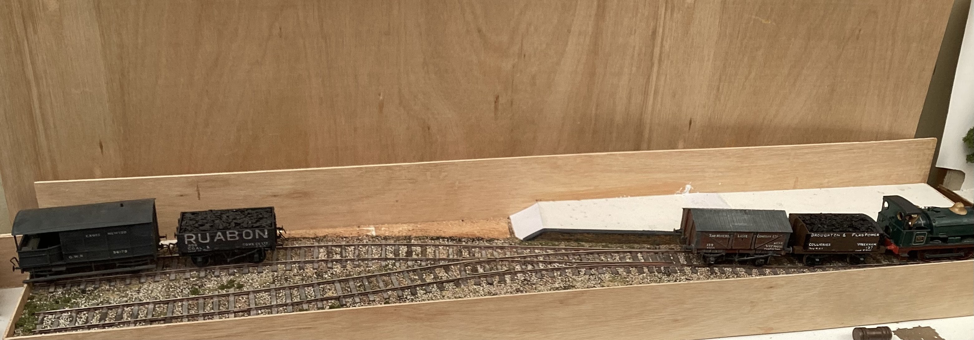

Northroader Posted November 9, 2024 Author Posted November 9, 2024 No post on here for too long, I’m afraid. There has been a bit of progress, for the track is now laid and ballasted, what bit of it there is. I’m using copper clad fibreglass strip and nickel silver rails from Marcway of Sheffield, laid to 37mm gauge. The main board is to the right, running line in front of the platform and a bit of a siding behind, then a fiddle yard to the left, one siding laid and at least one more needing track materials. There’s some Slaters wagon wheel sets waiting for bodies, The wheels pushed out over the axle a bit to the wider gauge and a drop of Superglue ploshed on in the hope they’ll stay there. The other item of interest is the loco, which is a runner. It’s intended to be a Fairbairn single driver tank, and as it’s a wider gauge I did it all in .060”Plastikard, chassis and body, rather than the more usual strip brass and machined brass spacers I use for 32mm. gauge. 10

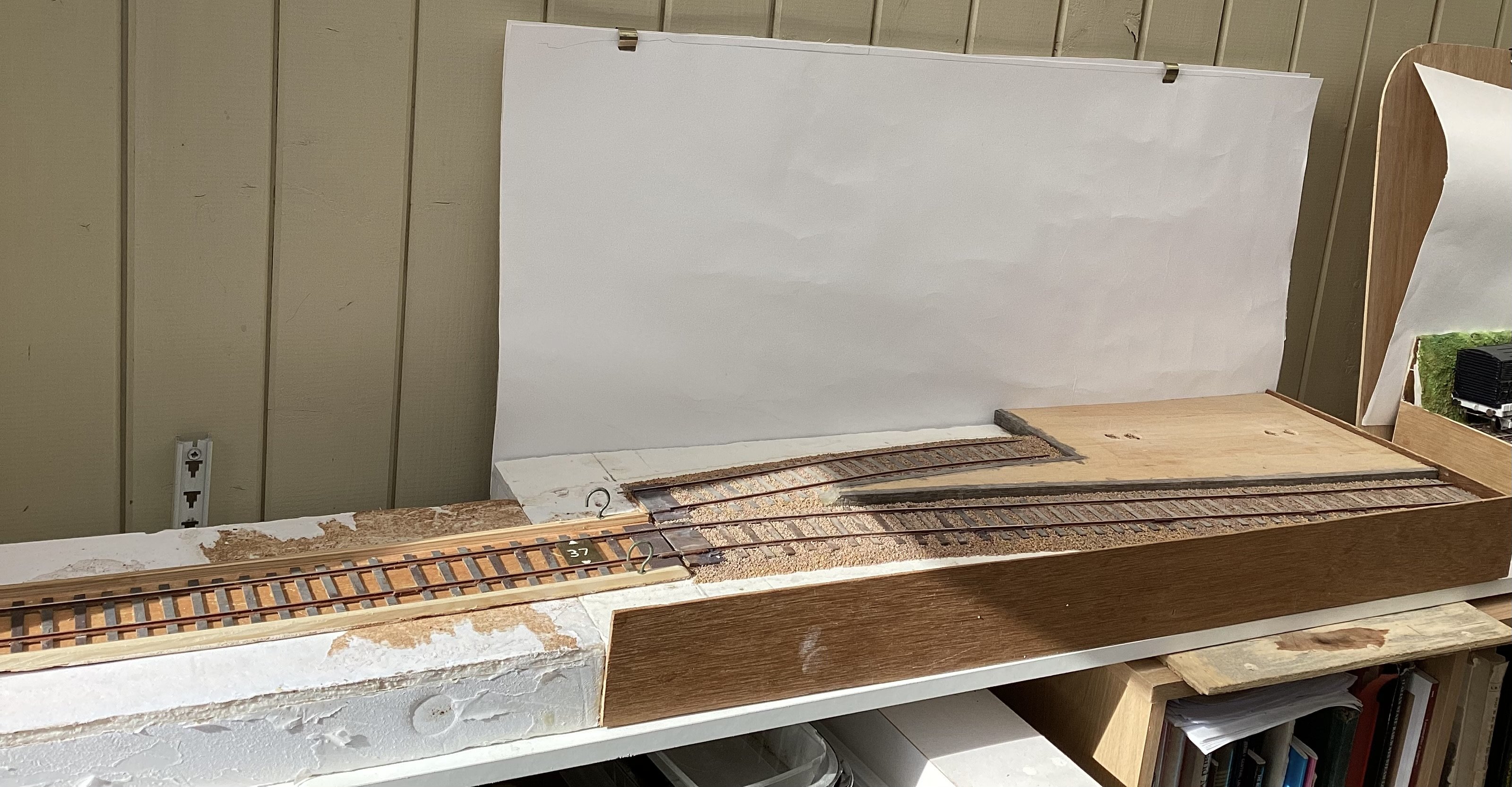

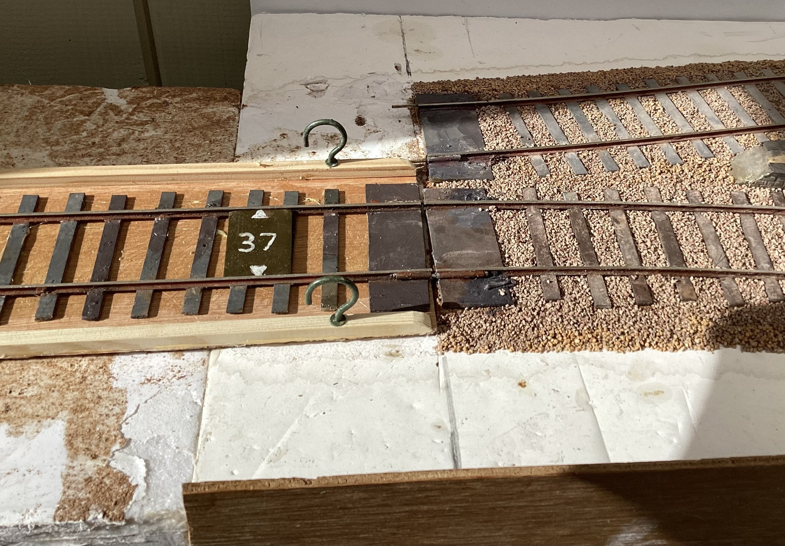

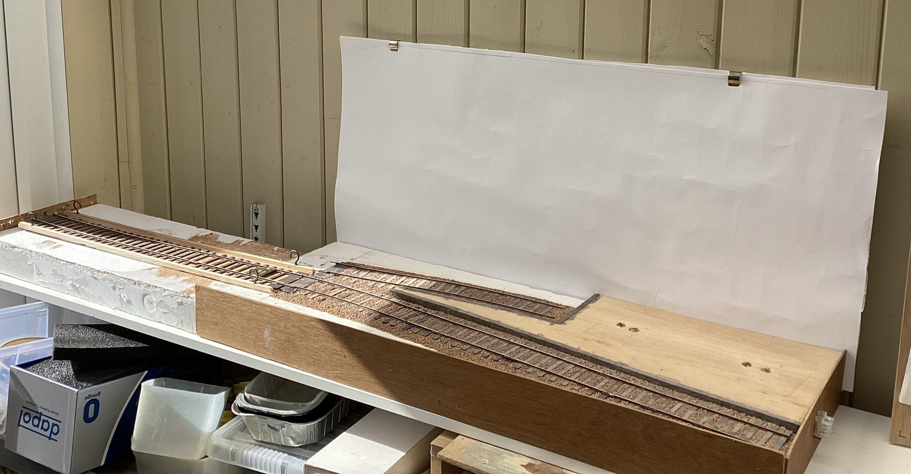

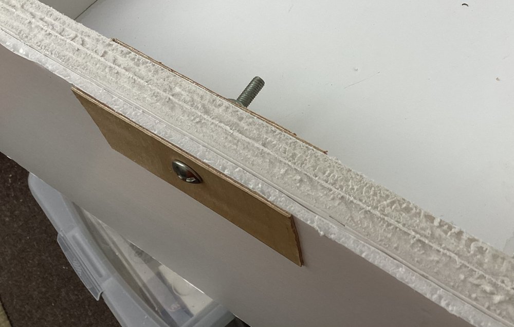

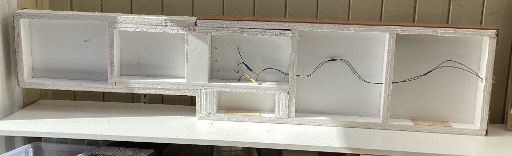

Northroader Posted September 12, 2025 Author Posted September 12, 2025 (edited) There’s a bit more been done on the line. I wanted to join the station unit of the baseboard to the fiddle yard piece, to get something that’s well aligned and giving a flat surface. The two units dimensions were off what you could do with a single sheet of foamboard, but Ive been splicing it to get a better single unit. I’m in my eighties, and building baseboards from 10mm foamboard suits me fine, as all I need is a Stanley knife and a pot of PVAbond, so I can go on kicking the can down the road for a bit longer. The layout is in an unheated extension to the house, so there’s a close season approaching when you need to bring the PVAbond into the warm house, and stop gluing over the winter months. So here’s a sketch of the layout size now, and what the underside splice looks like: It’s a bit shorter than it was, the two tracks in the station cut back a bit. The layout is faced with some 4mm ply, and there’s ply pads where the screws go through to attach the backscene support. The tracks in the station are laid on 4mm cork tiles, and the cassette has a 4mm ply base, so it all lines up. The tracks are stuck down with some Evostik. There’s stiffening strips along the sides of the cassette, and a hook screwed into each corner to help handling it. Here’s some views, with a closeup of the join, with a track gauge. Now I just need to make something with wheels to go on it. Edited September 12, 2025 by Northroader 7
