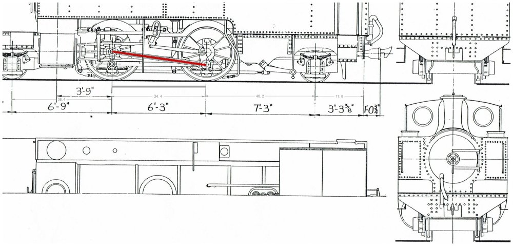

Mayner Posted September 19, 2022 Share Posted September 19, 2022 3 hours ago, David Holman said: Just be careful with the con rods on the S class, because they are outside the front drivers. On the real thing, clearance could be pretty tight, which on a model often equates to fag paper thickness. The good news is that, with a semi freelance model, nobody is going to notice of you move the cylinders out a bit. The other modelling dodge is to bore the cylinders slightly off centre to create more room. Achieving sufficient clearance between the coupling (grey) and connecting (red) rods outside the leading driving wheels may be challenging, on the prototype both coupling and connecting rods appeared to be the same or a similar length. This may be less of a problem with a narrow gauge loco using a rtr OO gauge chassis than a scratchbuild chassis with closer to scale running clearances. OO Gauge RTR chassis are designed with increased running clearance to reduce the risk of valve gear binding and run round small radius concerns The best option would be check whether its feasible to move the existing cylinder assembly closer to the driving wheels, before carrying out any modifications to the chassis. The 2-4-2Ts were 2 cylinder compounds the cylinder on the right hand side of the (going forward) loco were substantially larger than the cylinder on the opposite side., the Hornby Adams cylinders can be disguised/covered up with plasticard wrappers to look closer to the prototype. If your really adventurous the Hornby Fowler 2-6-4T valve gear looks very close https://www.petersspares.com/hornby-x1283-2-6-4-fowler-tank-valve-gear-left-hand.ir to the S Class gear, the Hornby Fowler gear and cylinders may be an option if you can locate a 'dead" Hornby Fowler or source the spare parts, Peter's only appear to have th LH valve gear in stock! 1 Quote Link to comment Share on other sites More sharing options...

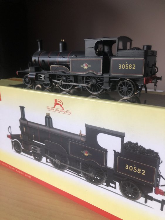

Patrick Davey Posted September 20, 2022 Author Share Posted September 20, 2022 10 hours ago, Patrick Davey said: Just bought a black Hornby Adams Radial off eBay - updates to follow! Thanks again everyone. Impressed - just received a dispatch notification for this so things are moving! Am not doing anything on this project until I have a working, and fairly reasonably accurate chassis........always tempting to start the scenics.......... Quote Link to comment Share on other sites More sharing options...

Patrick Davey Posted September 23, 2022 Author Share Posted September 23, 2022 It has now become a frightening prospect to try and butcher an otherwise perfectly fine locomotive….. Quote Link to comment Share on other sites More sharing options...
Horsetan Posted September 23, 2022 Share Posted September 23, 2022 59 minutes ago, Patrick Davey said: It has now become a frightening prospect to try and butcher an otherwise perfectly fine locomotive….. If you're only going to be messing with the chassis, I'd suggest selling the bodyshell untouched. Hornby China bodyshells are not available as spares, so eBay is pretty much the only way you can obtain any. You'd be getting some money back. A Radial body on a Martin Finney Radial chassis makes a decent model in EM or P4. 1 Quote Link to comment Share on other sites More sharing options...
