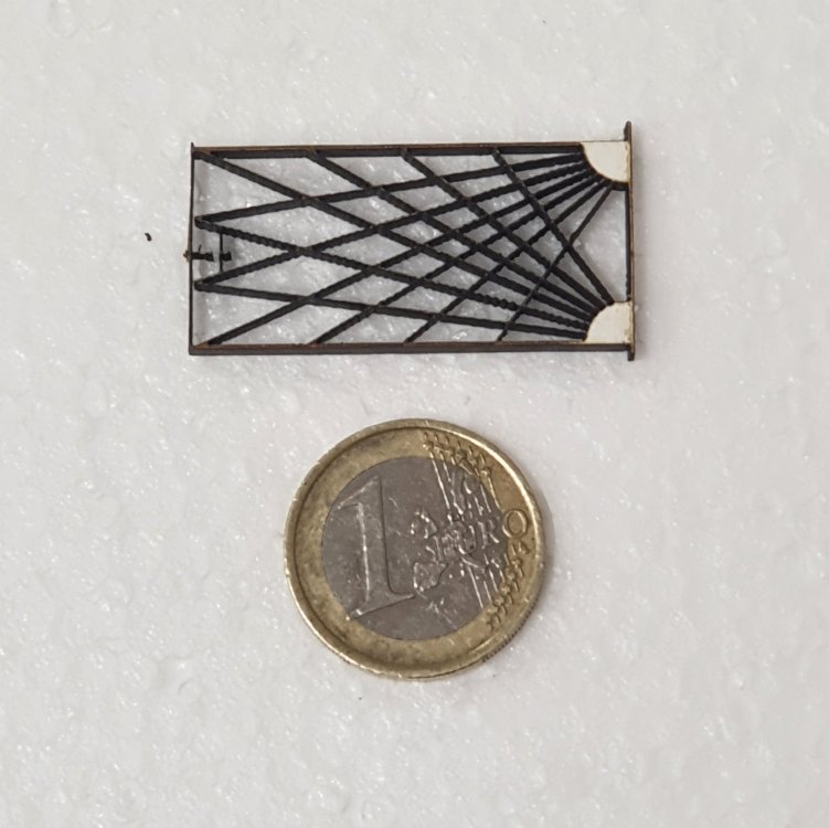

A couple of weeks ago I tried laser cutting a 'Sunburst' gate out of 3mm MDF, this was successful to a degree but not true to scale as it's to thick.

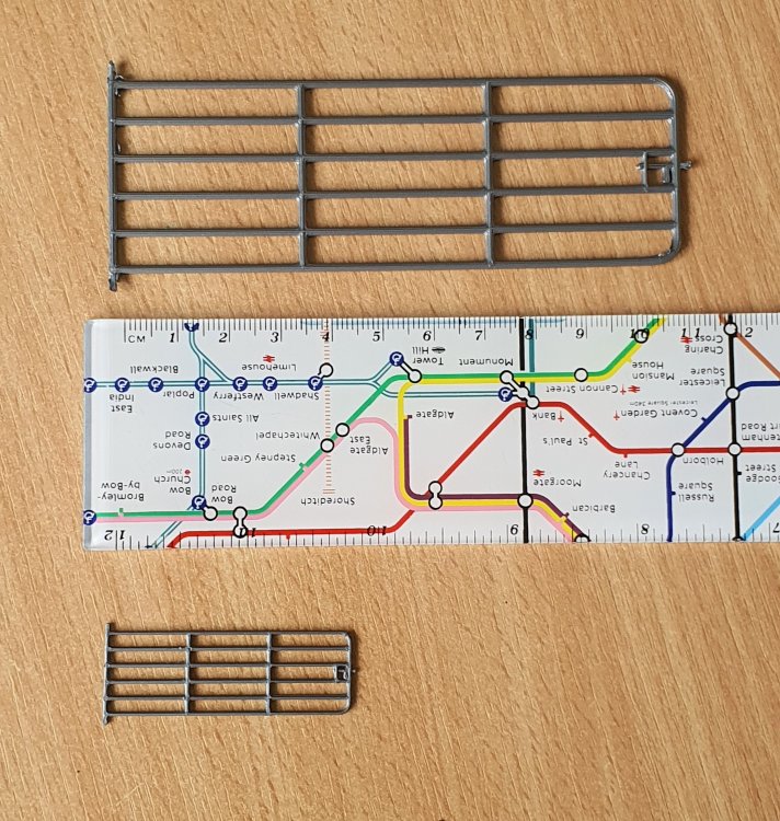

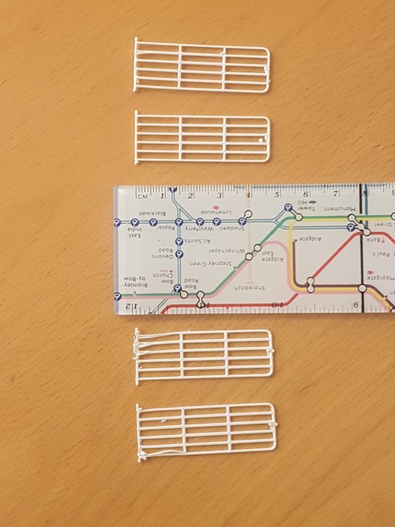

I thought that I'd give 3D printing a try and designed a farm field gate 12' wide x 4' high, in real life the galvanised tubes are 48-50mm diameter which is 0.6mm at OO scale.
The printer did manage to create them (gates under the ruler) however they aren't particularly good with stringing even after 2 attempts.
I made the gates slightly thicker ( 0.8mm picture above the ruler) they're better and a little more 'rigid'.

Hi Fran. That’s very fine work! Depends what the item is. If you are making, for instance, working level crossing gates to be motorised, then making them able to move is important, and may involve some compromise of scale to make it robust. Generally though, the emphasis in a railway model is scale fidelity. This is where physics comes in and some materials such as plastic have limitations - they are simply too fragile when very thin. The sunburst gate you have so beautifully drawn would work best as an etching on brass, which would be thin enough to get the right definition but also strong enough to stand up by itself.

I agree with the above but there are plenty of areas where items are made a little over-scale thickness to ensure that they are robust, so I wouldn't worry too much about a small percentage increase.
Something to think about is the typical viewing angles, especially for static scenery items. You probably wouldn't be looking down on the gate, it's more likely to be in the distance and looking across at it. So an increase in thickness in one direction is more noticeable than in the other, and I think you have done the right thing in this case - the gates at the top of your image look great.
On the tubular gate the thickness can also be made less obvious with a bit of weathering or toning down the colour.
For the sunburst gate, I agree that etching is the way to go because the wrought iron is so thin. It's something that would fit nicely in Weshty's scenic range.

I made a few modifications/compromises to allow for the small scale and changed the filament colour to silver/grey, there's a little clean up required but it's getting there.
