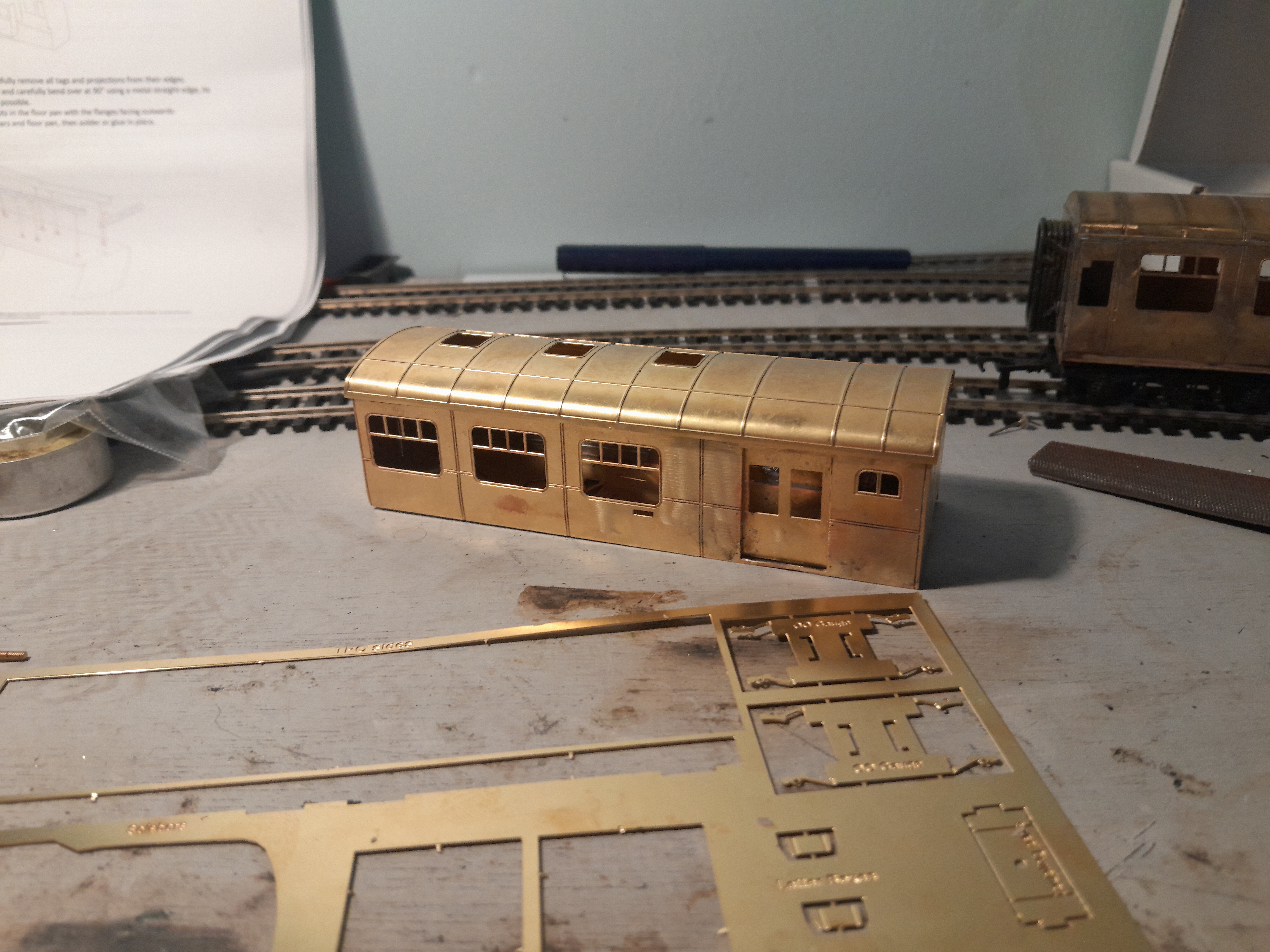

Work done tonight, sides soldered on, doorways soldered in also.

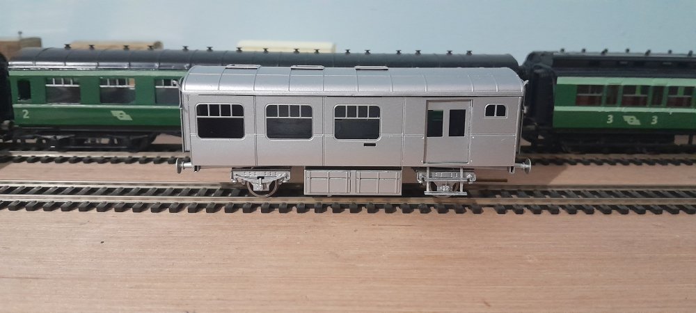

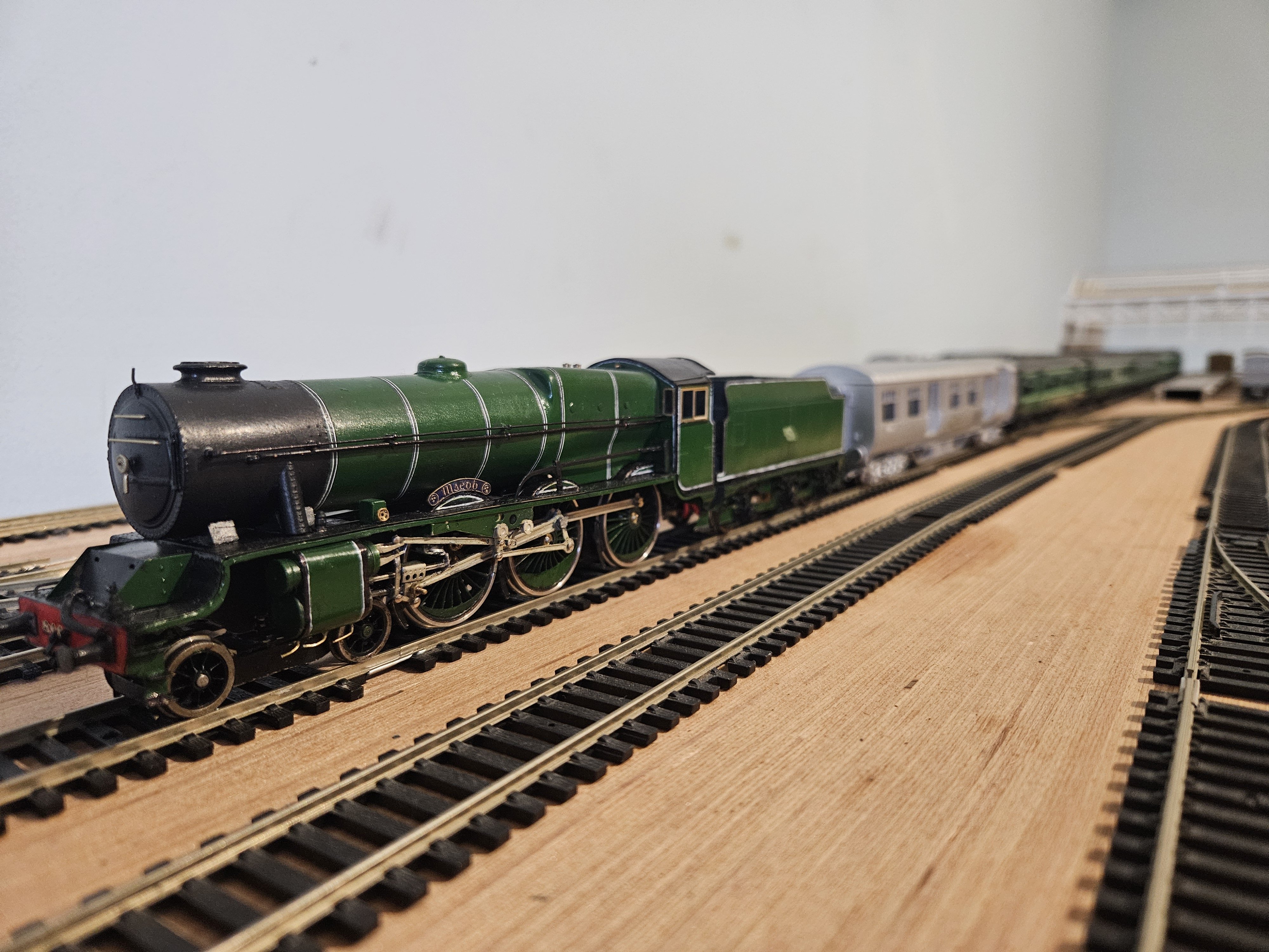

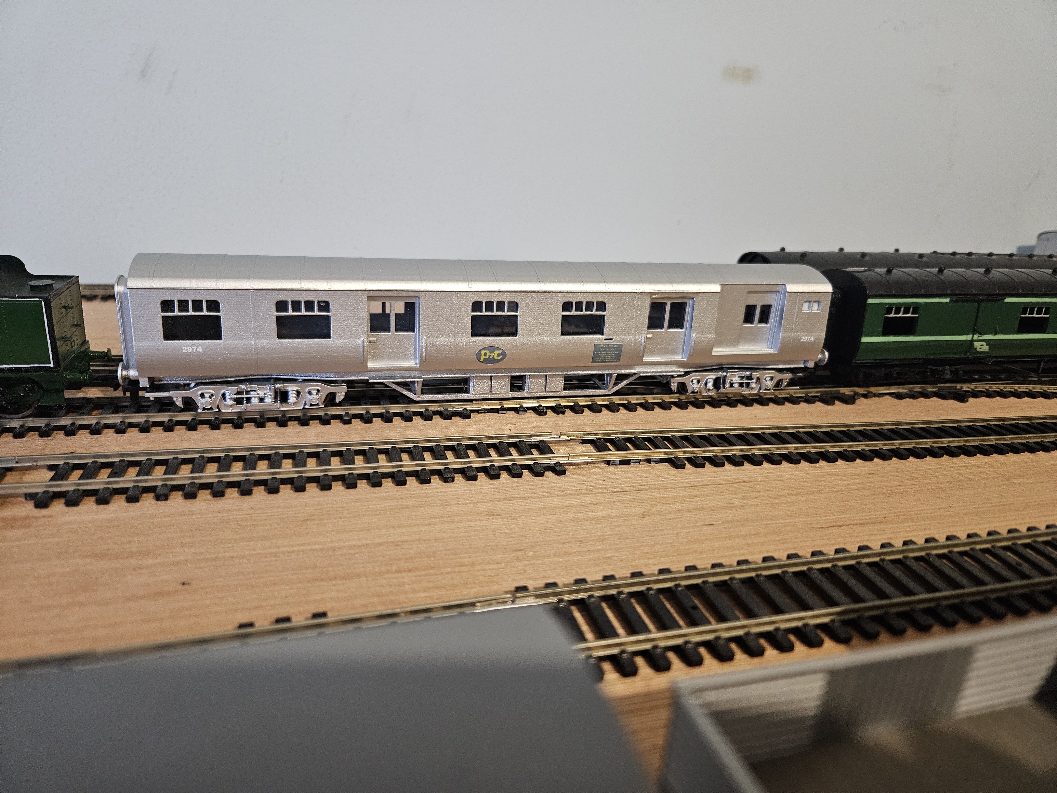

Getting there with the TPO. Went with a rigid chassis, have the roof in place with two straps of brass soldered to it acting as springs. Next up will be battery boxes, then buffers, springs, axle boxes, the works!
  • Like 6
Details added to the TPO, corridors, axle boxes and springs, roof lights, battery boxes, buffers.
Then it was off for a bit of a cleaning to remove any residue!
Placed next to a 3d printed (IFM?) TPO.
Few more details to add yet, but I think I'll paint her in silver when I get around to it.
Edited by GSR 800
  • Like 9
Very neat job Harry
I settled on Tamiya "AS-12 Bare-Metal Silver" aerosol for silver/unpainted aluminium CIE coaching stock after several unsuccessful attempts with different 'silver" aerosols.
I finish with a Tamiya semi-gloss aerosol to seal the model after applying the transfers.
  • Like 7

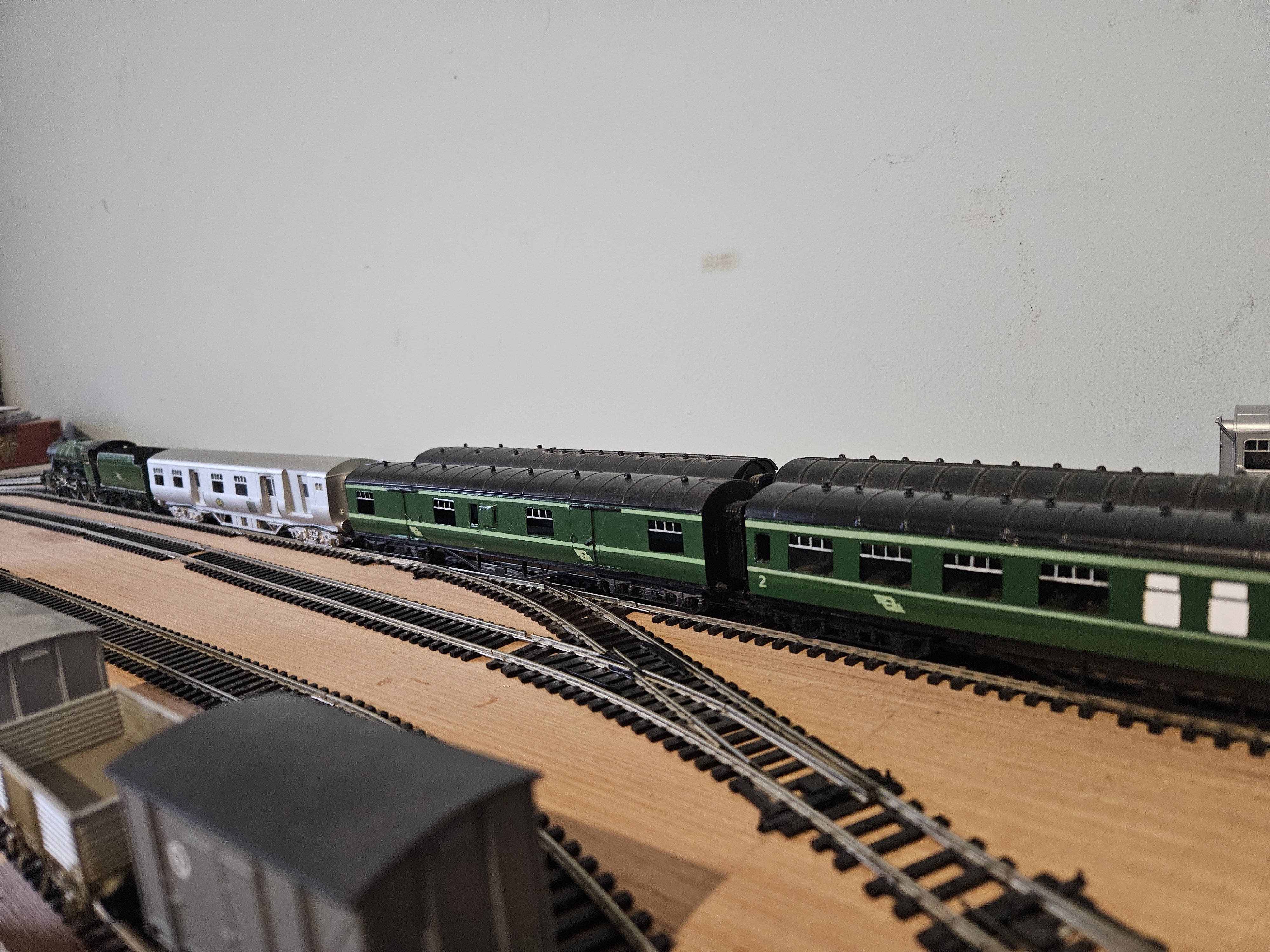

10 hours ago, David Holman said:
A fine ensemble. There is something rather nice about a mixed take of vehicles and certainly more interesting than a fixed unit railcard set...
Many thanks David, have to agree regarding a mixed rake.
Certainly plenty of variety on the Midland during the period. Clements notes a train of 10 bogies with some 5(!) vans behind, and many photos in the IRRS show similar.

I'm thinking of painting the other side of these in the later light green to have "more" coaches for little effort!
I5 or so years ago i painted one side of my Worsley Works Laminate & Park Royal CIE late 50s green opposite side in Black & Tan and picked out the windows on a SSM Bredin in silver, I finished my Bredin set (1 Full Brake, 2 Comp) in late 50s green, though none of these (21mm gauge) coaches have ever operated on a layout, perhaaps some day?
Some more work done today. The clerestory and the Bredin Mk2 got some lining, decals and detail picked out. Once again picking out the windows in silver on the Bredin Mk2 was a tedious process!
And with that they now join the train!
Longterm I'd like to change the roof vents on the Bredin mk2 to something smaller, the dapol ones are enormously overscale.
