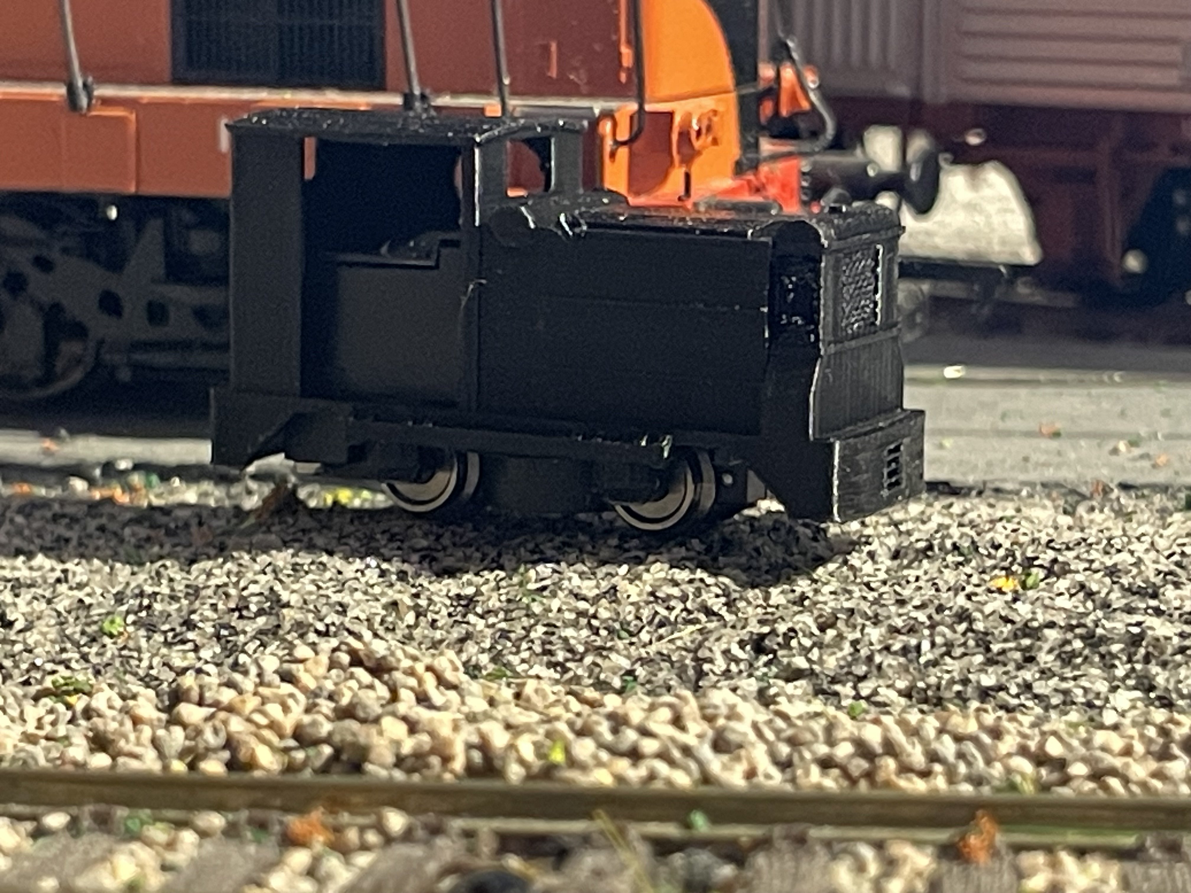

Flying Snail Posted October 28 Posted October 28 11 minutes ago, Sean said: ive ordered a 0.2mm nozzle which should actually increase resolute detail even further but the print times will double and this little guy took 3 hours as it is! still not too bad once your patient. That looks good - I'm looking forward to see how the 0.2mm nozzle performs

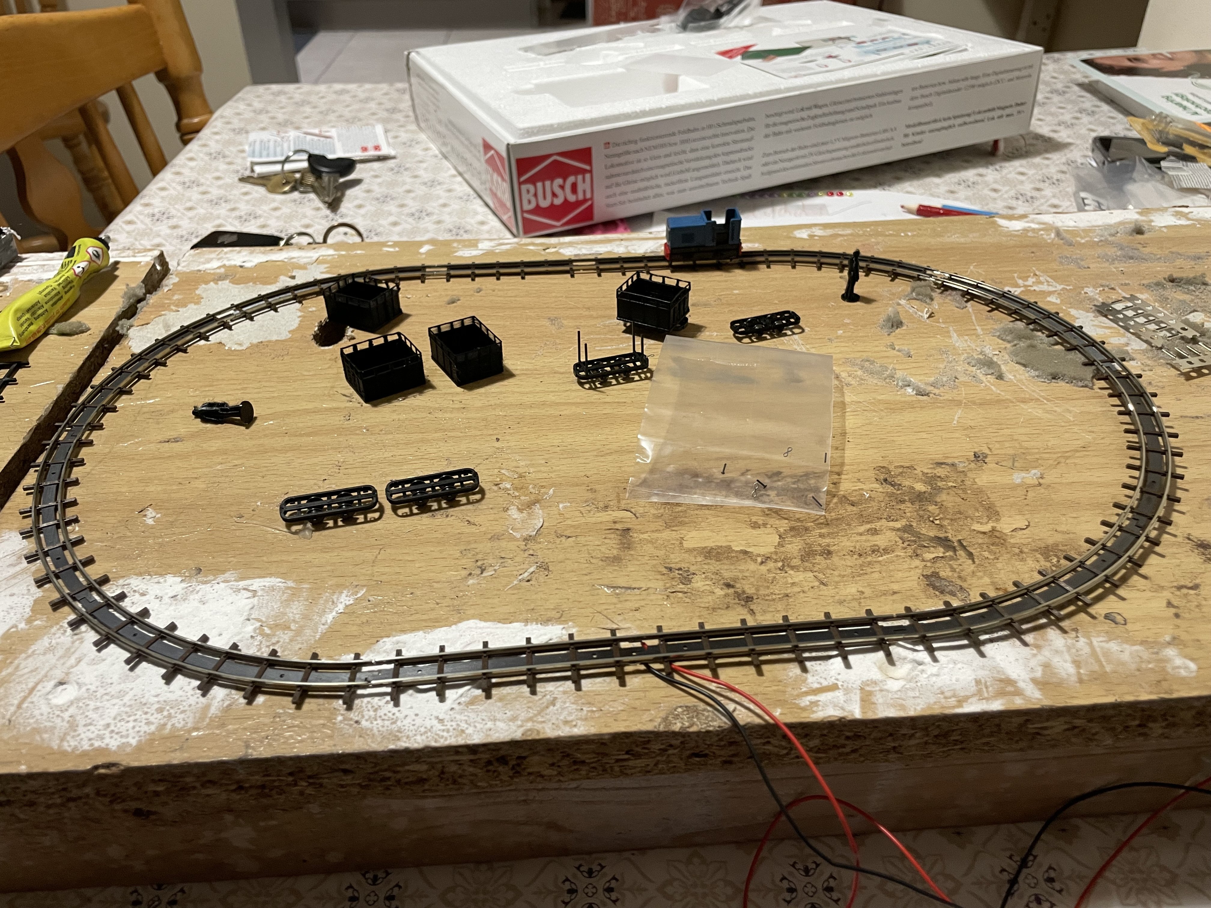

Sean Posted October 29 Author Posted October 29 certainly in this case it has been beneficial to begin with the loop of set track. this system is a little unorthodox in that there’s a magnet on the bottom of the loco and the black strip is steel that is used to pull the loco onto the track for adhesion! my own track will have somthing similar hidden in the scenery however it was certainly mind boggling trying to see how it worked without actually having some on hand to play with! the loco is running in and I am assembling 4 wagons on the Busch kits. This way I can get a feel for how the couplings work before I try to add them to my prints! 3 1

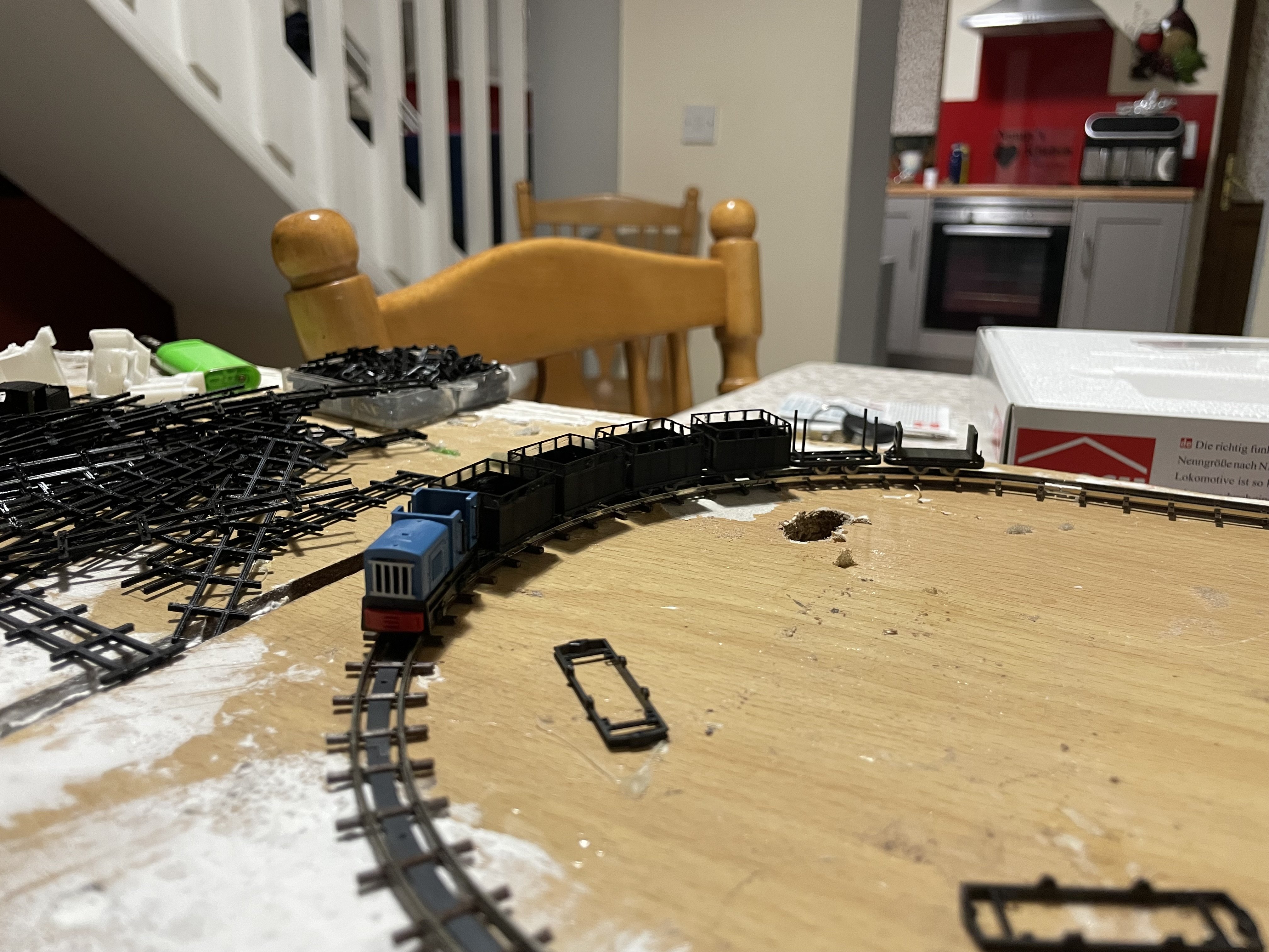

Sean Posted October 29 Author Posted October 29 IMG_2923.mp4 And a little while later we can finally add some wagons pretty happy with the curves too despite how narrow they may be 6

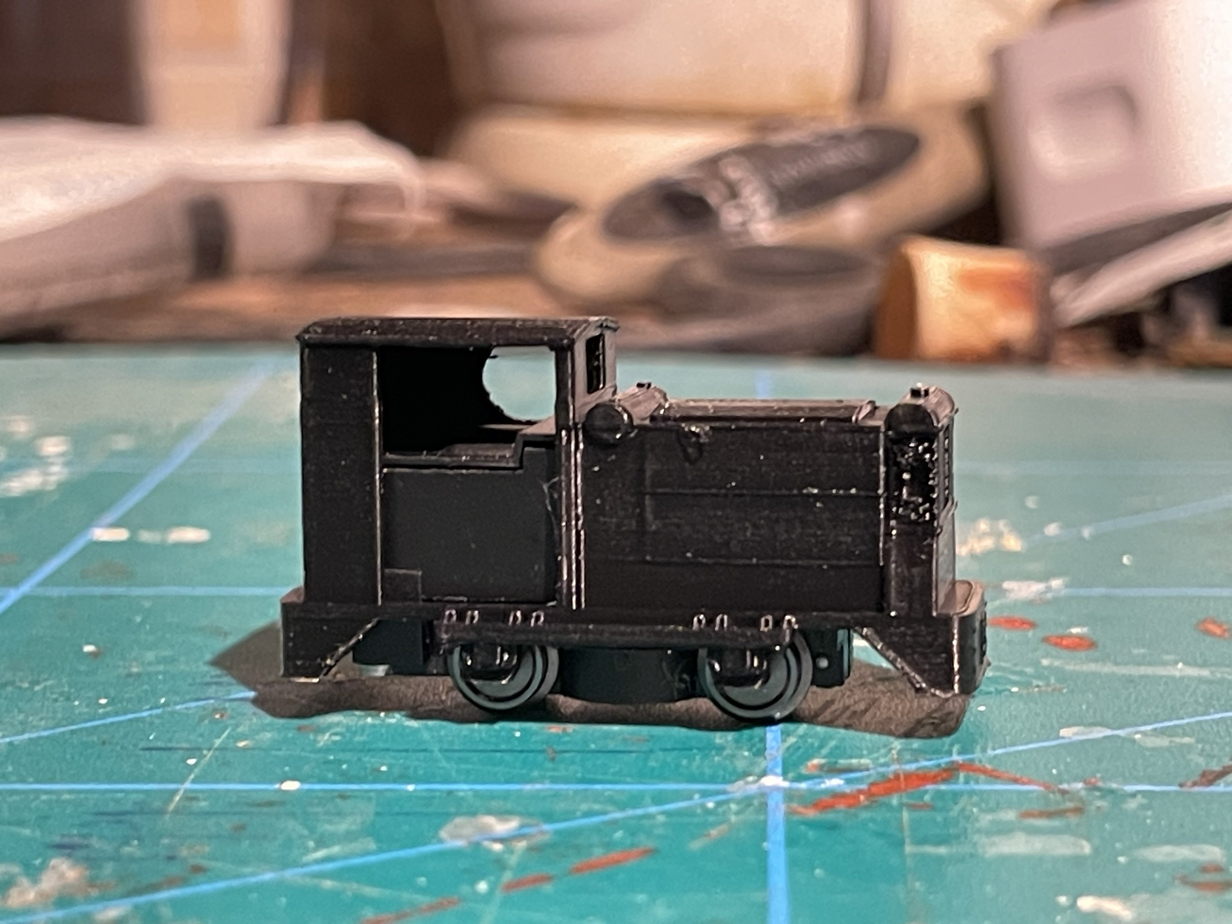

Sean Posted October 31 Author Posted October 31 (edited) Spent far too many hours altering this last night to suit the chassis, glad with the overall fit though and it should be easier the next time i need to do such a thing! This is printed with the 0.2 and otherwise default settings, took about an hour so not much longer than the 0.4 settings I had been using. the most obvious thing is with the roof and the top of the radiator, the stepping on those curved layers iis much less noticable now another print was done on finer settings which took around 5 hours, but honestly I did not see much if any improvement to that except for a smoother roof and the radiators didnt work on that either. very happy with this overall, the front grille looks great and the one to the side of the radiators is not reproducing all that ell yet. Edited October 31 by Sean 6 1
Flying Snail Posted October 31 Posted October 31 Very nice indeed Sean! The 4mm stock in the background behind it gives some idea of how small this little loco really is! 1

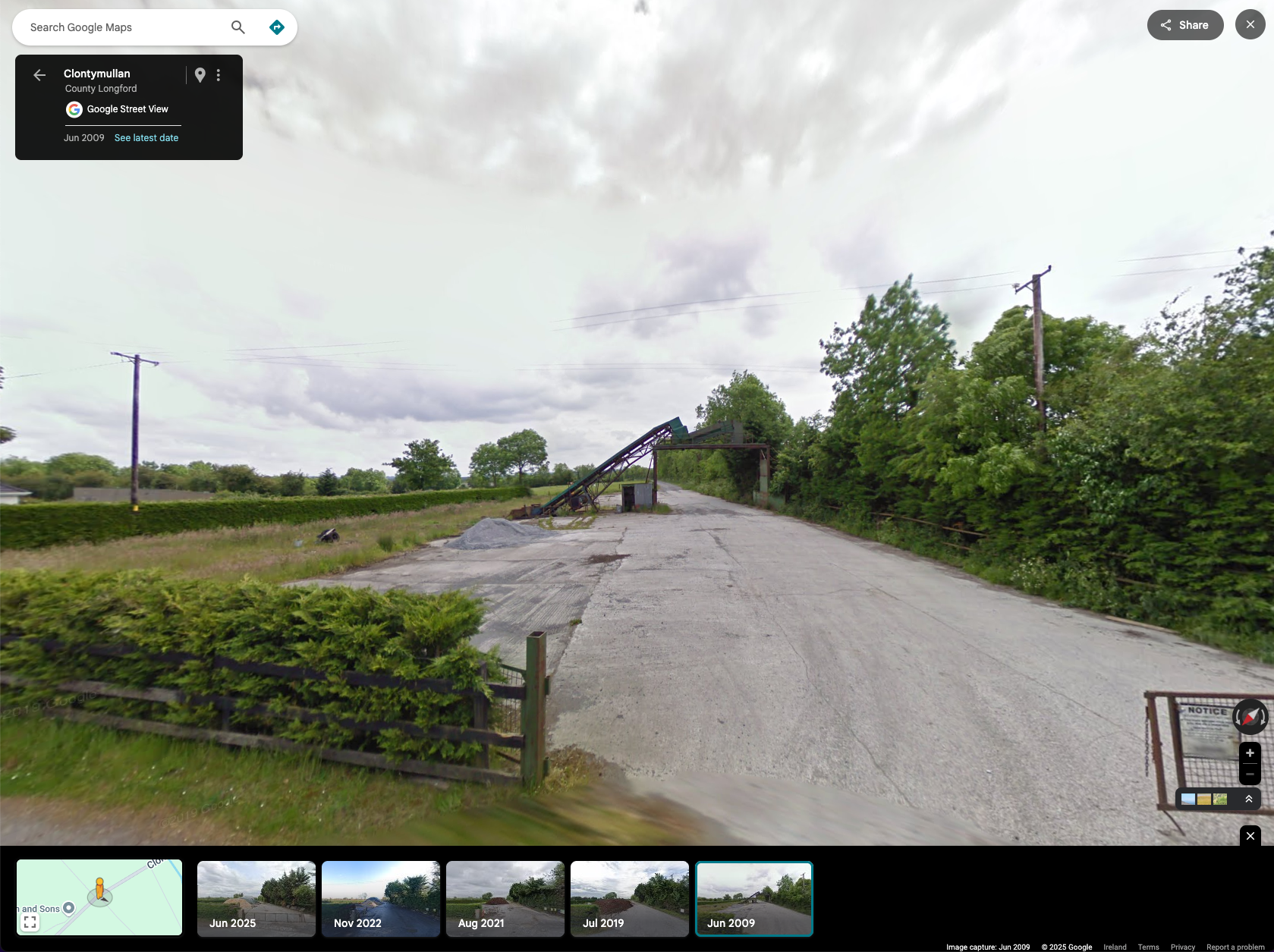

Sean Posted November 1 Author Posted November 1 So this is where the confusion begins. The Lansdale yard branch of the system is the most documented part, and along with that, the most interesting part, however in the available photography the location is credited as being at the works. There a permenant way documented that is around a mile long however with some sources saying there no rail link to the works. a little contradictory! Having searched the works area many times and coming up blank, as well as the area around smiths bog for any trace of anything I FINALLY had a breakthrough. A long time was spent trying to geolocate any trace the elevator in this photo around the works and I just could not make sense of it being anywhere on or near the main plant. After another while of searching I focused my attention on smiths bog. still after another few evenings of looking i could find no trace of anything, then by chance i set the map imagery to 2024 over a random area and FINALLY I managed to spot a set of rails which were not visible on any other map and sure enough I was able to follow these back to a fairly nondescript yard, set street view to 2009 .... AND https://maps.app.goo.gl/YNqCSkfhH1pabVCV6 THIS is lansdale yard. THIS is the proof! the 2 tracks are still embedded just like in the flickr photo above! https://maps.app.goo.gl/VCSP532Zt194LtAZA from What i can make out, this is a surviving level crossing. you can follow the tracks down to smiths bog and back into that yard but you can see where it breaks up at one point, it is said that this branch line flooded and this was the final nail in the coffin for the railway here. 4

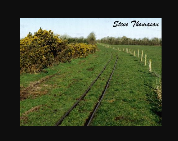

Sean Posted November 1 Author Posted November 1 Here are the known photos of the permenant way that i have. I have spent far too many nights on this, so to be able to match all of the images to locations on a map has been a big thing for me heh. 4
