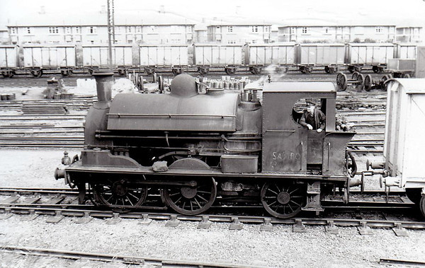

minister_for_hardship Posted August 15, 2013 Posted August 15, 2013 The GSR had an 0-4-0ST, ex Allmans Distillery. A broad gauge version of Peckett's 'Beaufort' type. Hard to tell what it livery it carried from pics in GSR ownership, being covered in gunk latterly. May well have carried lined green, probably what Peckett's painted it as delivered. Doubt the GSR would have bothered their barney painting it.

minister_for_hardship Posted August 15, 2013 Posted August 15, 2013 (edited) Not the Allman one, but of the same type in lined Works Grey. http://www.martynbane.co.uk/images/peckett/locos/1011-peckett.jpg There's a pic somewhere of the aftermath of it colliding with a horse and cart, horse went to stable in the sky I think. Didn't last too long in CIE ownership, withdrawn in '49-ish and rather camera-shy. Used on the quays in Cork after GSR purchase. Edited August 15, 2013 by minister_for_hardship

jhb171achill Posted August 15, 2013 Posted August 15, 2013 Dix points to Minister for Hardship! It was owned by Allmans, then the GSR acquired it. They affixed a standard Inchicore number plate to it (299) but it retained its makers lined green - in very shabby state - right to the end. Good possibility for a dock shunting type of layout. I always thought a layout based on Albert Quay terminus would be fascinating!
jhb171achill Posted August 15, 2013 Posted August 15, 2013 Guinness loco's were originally dark green, but all received the dark blue carried by the survivors at some stage, possibly immediately post war. Correct, the RPSI's No. 3 only acquired its name within its preservation era. The loco is currently being restored having spent many recent years as Whitehead shutter, and before that a spell on the DCDR. The reason that the brewery's loco's were originally green is probably the same as for Allmans in West Cork, i.e. this is what they were delivered in from the makers. Few breweries were concerned with adopting a formal corporate livery image for their locomotives, any more than a builder would repaint all his JCBs, tower cranes and wheelbarrows in his house colours. Look at the Derry Harbour Commissioners loco no. 1 in Cultra; it carries its original livery to this day. And it is different to that on its erstwhile stablemate, the RPSI's "R H Smyth".
