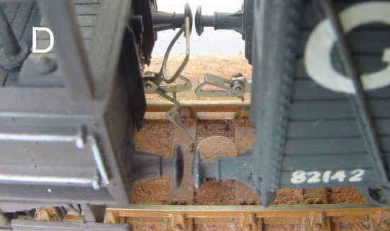

0 DiveController Posted May 16, 2015 Posted May 16, 2015 Photo of the Dingham coupler flipping to the uncouple position when the track magnet is energized From Dingham website here http://www.dingham.co.uk/how_it_works4.htm
