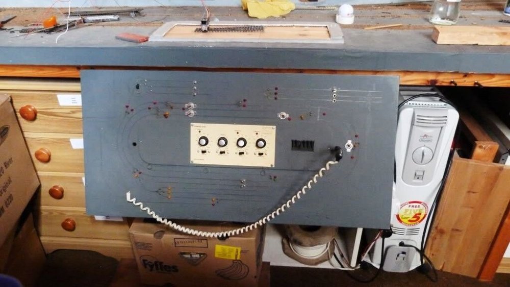

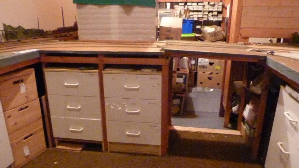

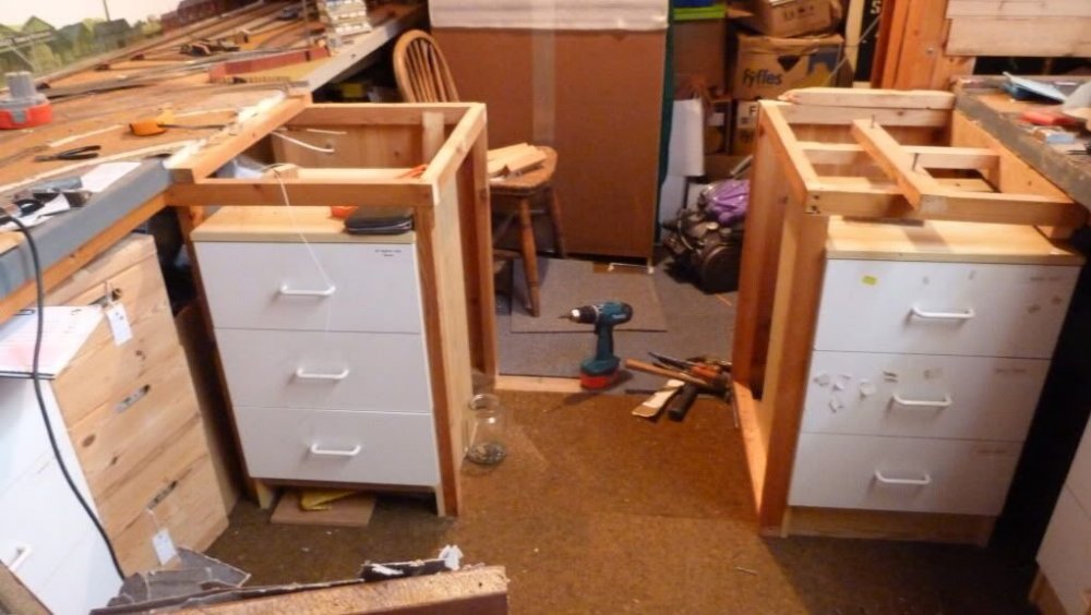

WRENNEIRE Posted April 19, 2012 Posted April 19, 2012 (edited) Decided to convert to DCC Had a couple of issues with the old layout which I fixed first Trapdoor entry was never succesfull where it was, so I moved it to the centre of the opening I think the current Mrs Bracken must have left her hoover there when she was cleaning the attic for me!  General view of the layout   Looking back down    The trapdoor     The new one        Old Control Panel    New one     Edited July 27, 2018 by WRENNEIRE

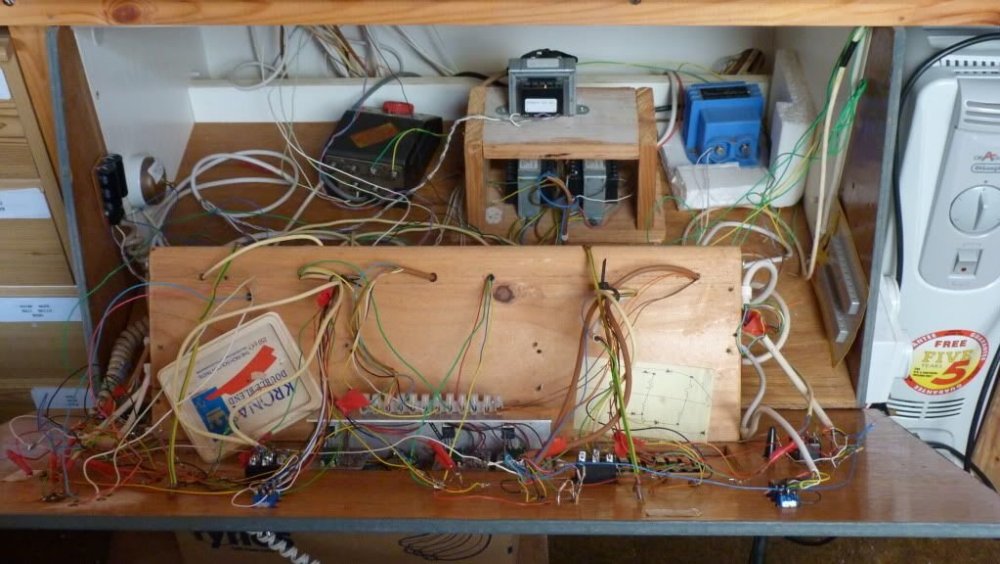

WRENNEIRE Posted April 24, 2012 Author Posted April 24, 2012 Another few days work and nothing to see Fitted the bus wireing As I never thought the layout would be rewired, I had fixed the presses and shelving permanently so every meter under the baseboards was a long drawn out struggle, indeed most of the screws had slot heads! Found this building while looking through some stuff Does it look Irish enough? Â

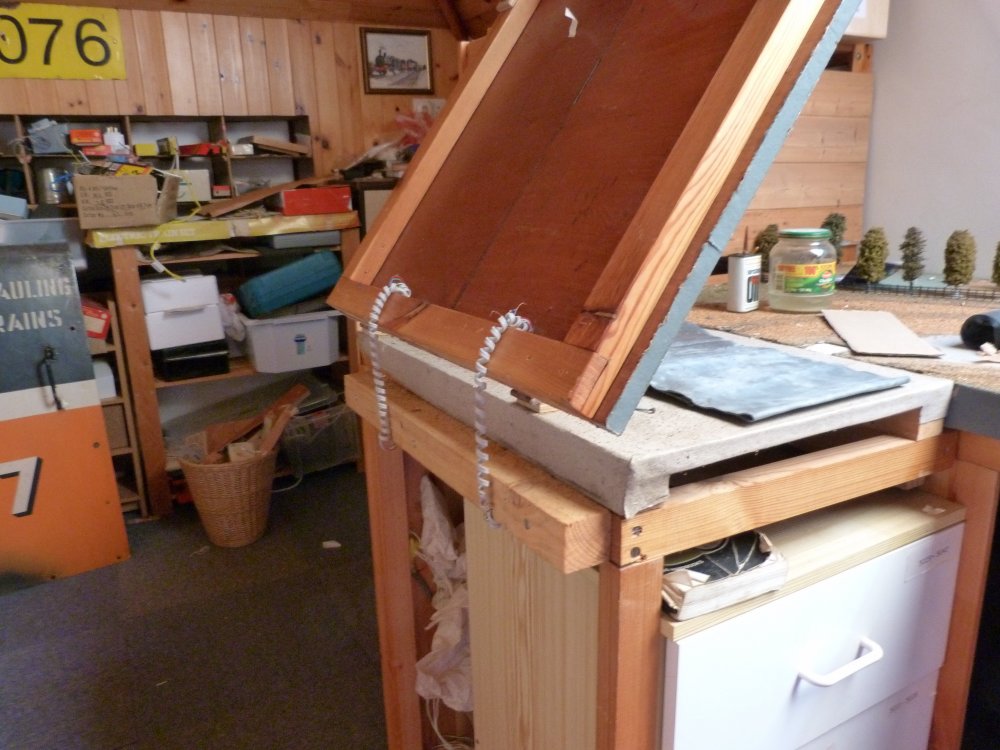

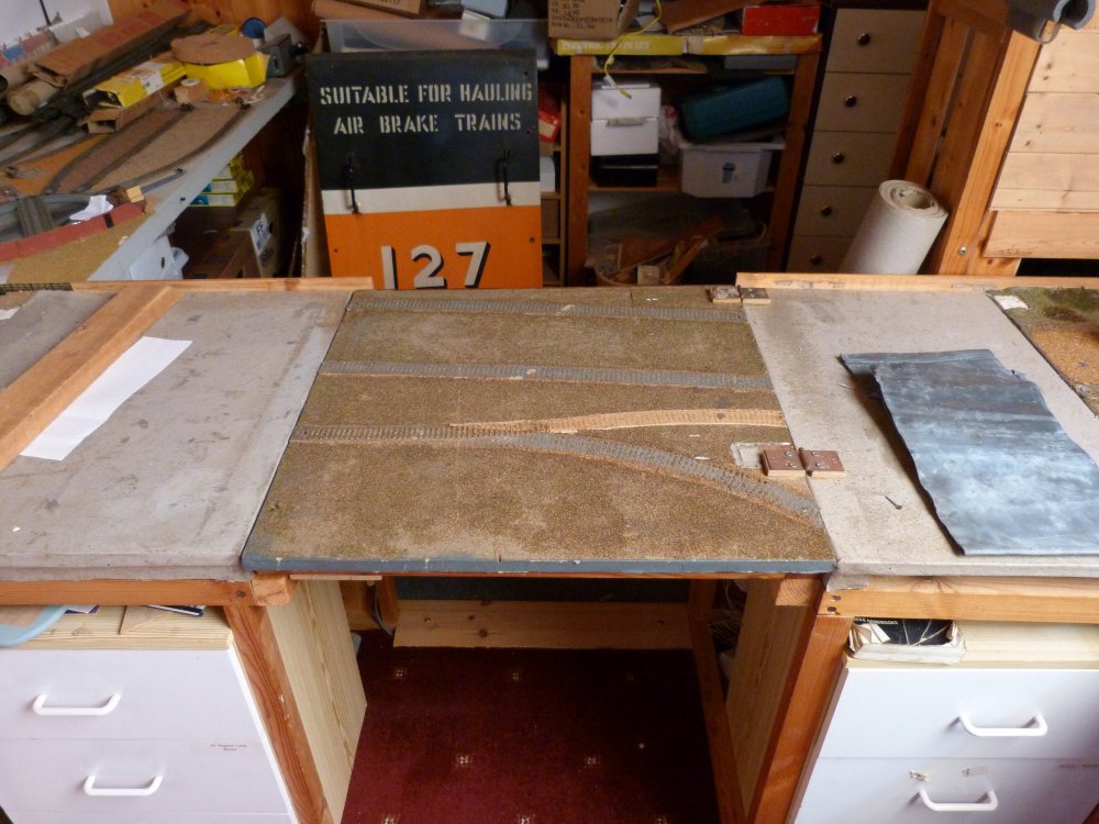

WRENNEIRE Posted April 25, 2012 Author Posted April 25, 2012 (edited)  How do run the track over the trap-door?  Couple of pics from the old layout Trapdoor in closed position    Underneath shot Basically just brought the power via the old telephone cable and wired it to the track on the trapdoor The small piece of timber on the left hand lip is why the trapdoor looks out of line in the first shot.    Underneath of trapdoor Edited April 25, 2012 by WRENNEIRE
djkonore Posted April 25, 2012 Posted April 25, 2012 Thanks for the pics Dave, but how does the track hinge? Are you using flexi track? If so, does it just bend when you lift the trapdoor? Or is there also a gap on the hinge side?
Broithe Posted April 25, 2012 Posted April 25, 2012 (edited) Thanks for the pics Dave, but how does the track hinge? Are you using flexi track? If so, does it just bend when you lift the trapdoor? Or is there also a gap on the hinge side?  The usual thing is to have the hinges mounted just above the board surface - see the blocks in the picture - this allows the track by the hinges to rise without clashing with the fixed track. The track is cut on the break-line where the door joins the fixed top.  A picture of the top of the door when it's open would explain it... Or try http://www.brian-lambert.co.uk/Hints%20&%20Tips.htm#Lifting Bridge Section   And, is it Hazelwood or Hazlewood? I think we should be told.. Edited April 25, 2012 by Broithe
djkonore Posted April 26, 2012 Posted April 26, 2012 The usual thing is to have the hinges mounted just above the board surface - see the blocks in the picture - this allows the track by the hinges to rise without clashing with the fixed track. The track is cut on the break-line where the door joins the fixed top. A picture of the top of the door when it's open would explain it... Or try http://www.brian-lambert.co.uk/Hints%20&%20Tips.htm#Lifting Bridge Section   And, is it Hazelwood or Hazlewood? I think we should be told..  Ah yea, now I got ye. Brilliant, thanks Dave, might end up making one if I ever go full circle. As for the Hazelwood/Hazlewood debate, I live in America, where they can't spell anyway. My computer constantly underlines things that are correctly spelled using the queens english!
Broithe Posted April 26, 2012 Posted April 26, 2012 Ah yea, now I got ye. Brilliant, thanks Dave, might end up making one if I ever go full circle. As for the Hazelwood/Hazlewood debate, I live in America, where they can't spell anyway. My computer constantly underlines things that are correctly spelled using the queens english! If the Americans want to speak English then they should have to pay a licence fee, and pass a test - otherwise it's Navaho, or something like that, for them... Just wait until I take over.  The lifting bridge is quite do-able - but the slightly raised hinges are an important feature for a successful device.

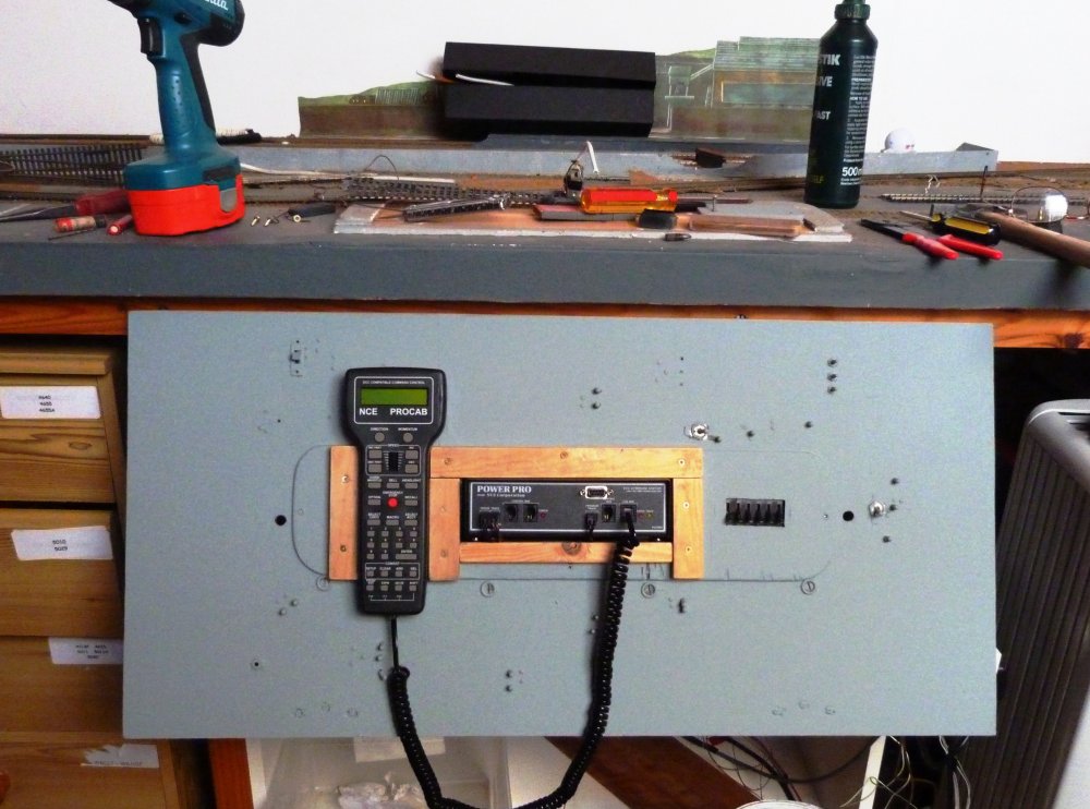

WRENNEIRE Posted April 29, 2013 Author Posted April 29, 2013 12 months on (exactly!) Got a bit in at the weekend Went for a DCC Controller So went from this: Â Â To this: Â Â Maybe this time next year there may be some locos running
Weshty Posted April 29, 2013 Posted April 29, 2013 Dave, very impressive, even if it looks like it plugs into Pulse and could order a taxi at the same time!
WRENNEIRE Posted April 29, 2013 Author Posted April 29, 2013 Looks good Wrenn - does it power any track yet? Jasus Bosco, gimme a break Trying to get the stuff to run without taking it out of the box!
