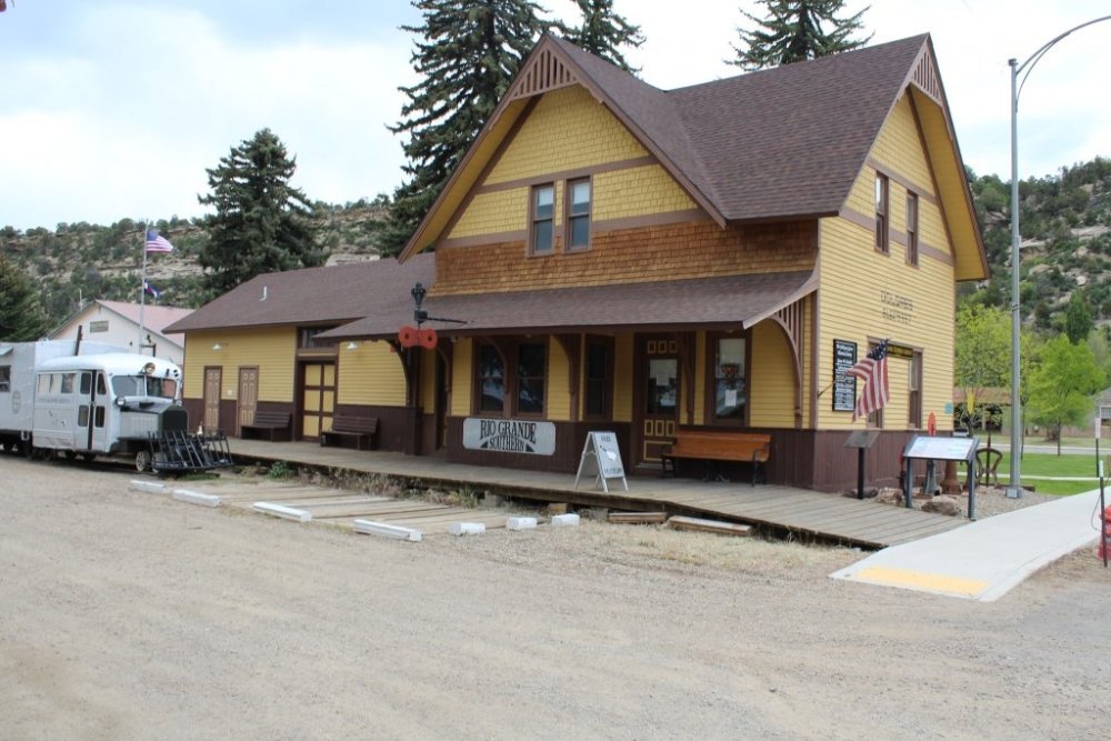

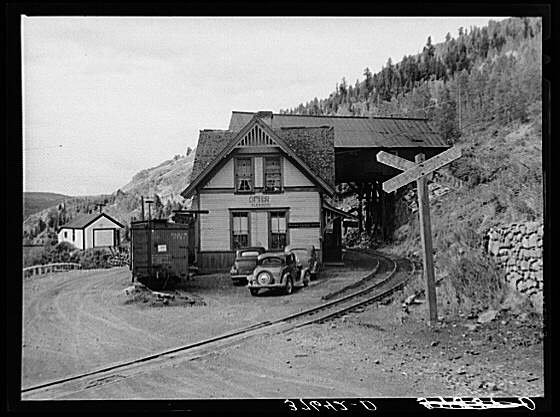

Not in the Irish or British sense. Basically a boarded area at track level at the front of the depot, similar to the existing decking.
The replica Dolores depot is a mirror image of Orphir, it was built as a starter project by the local community (pop 900) before they took on the restoration of RGS Motor 5 and a short demonstration track.
Unfortunately we were running late on the day and did not get a chance to check out the museum, I will have to go back sometime and spend more time in the area.

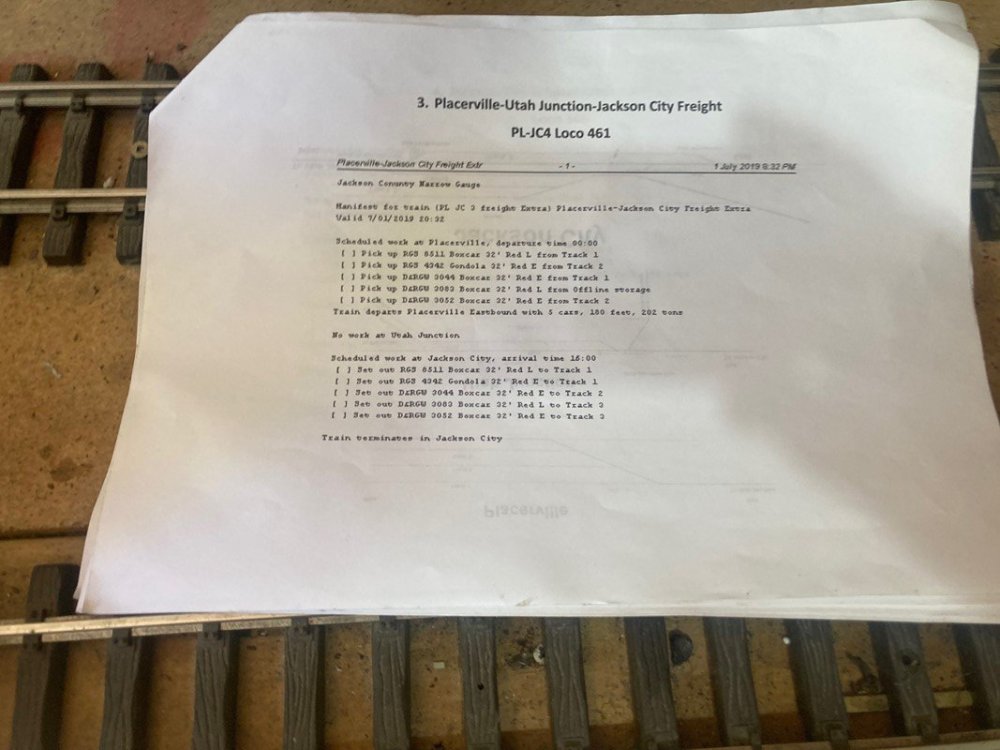

I have been experimenting with JMRI Panel Pro ---Operations to create manifests and switch lists for freight trains in preparation for regularish operating sessions. Seems to work despite the limited number of cars with trains loading to 70-80% of capacity, one of the advantages of large scale is that its easy to read the numbers of the cars🙂
Manifest for a way freight (pick-up goods) train spends a lon-ng time of the road!

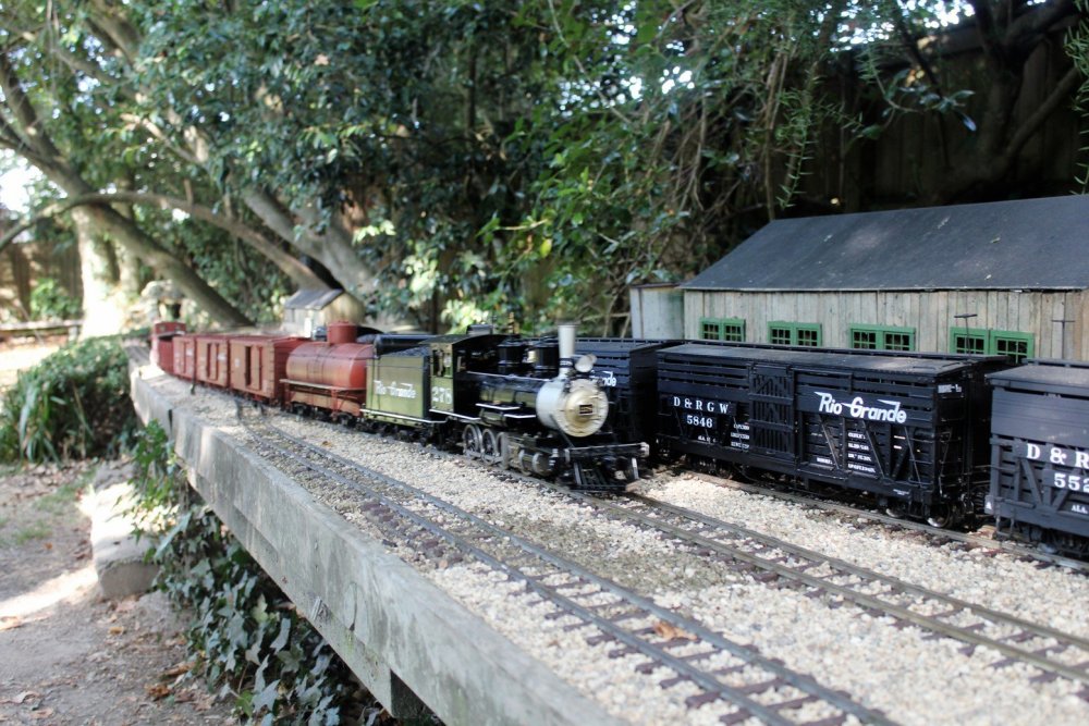

Yesterdays schedule required 3 locos K27s 2-8-2 463 & 464 for the long distance freights, C19 2-8-0 for switching and trip working out of Jackson City and all available freight cars.

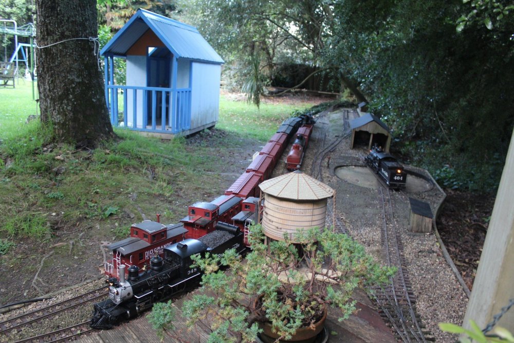

348 has cleared the yard and made up two freights for departure and waiting to depart with a caboose hop to collect stock cars and gondolas from towns further up the line.
463 has backed on to her train on the departure road 464 is coming off shed and will work the next westbound freight.

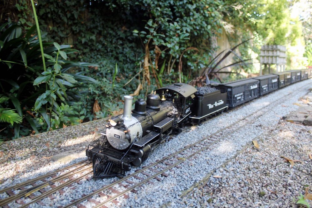

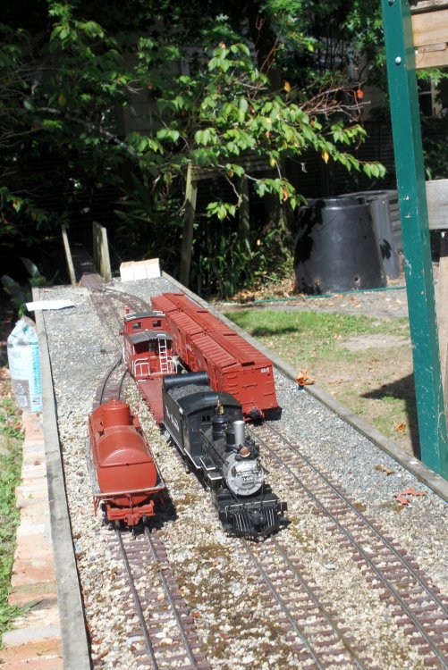

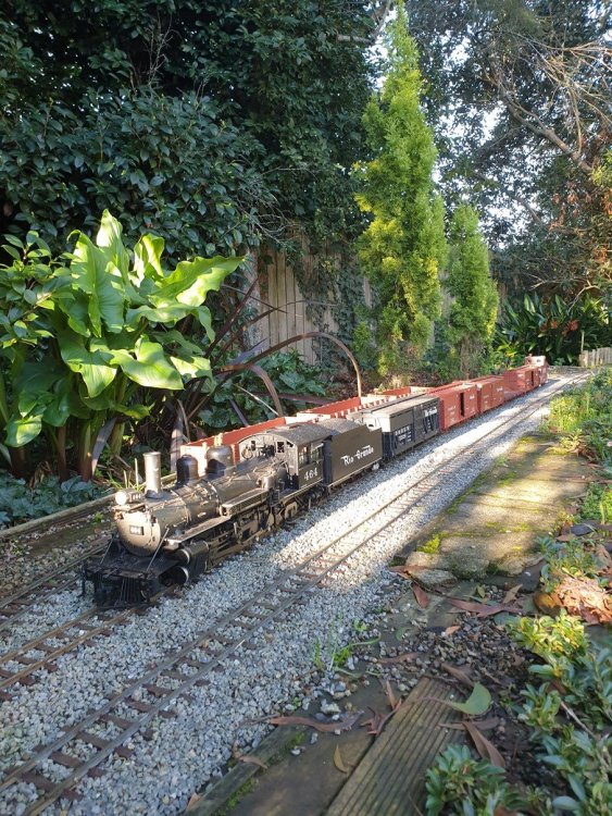

Meanwhile 463 is working her way westwards with a train of stockcars and boxcars. Trains carrying livestock and perishable traffic had a higher priority than general freight traffic.
348 has turned and is now working back with a train of gondolas and a flatcar. The dwarf wall includes a large broken plant pot which looks a bot like part of an old furnace or coke oven.
The plantings in the background were added about 3-4 years ago, the large trees were supposed to be slowing dwarf plants!

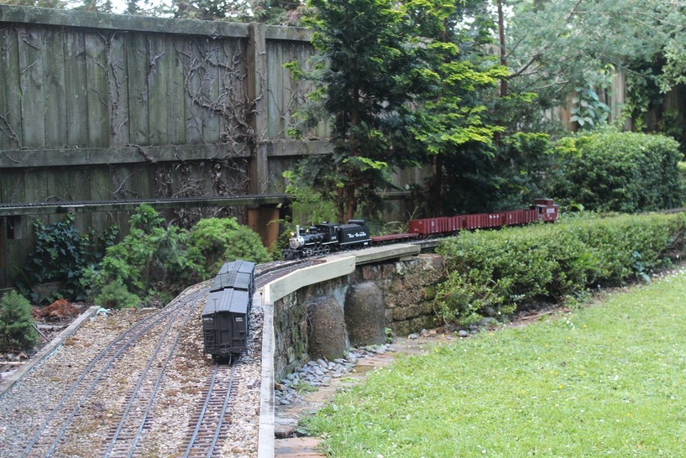

348 has attached the 3 stockcars to her train which puts her well (60%)over the load limits for the high line in the background for the run to Placerville (the staging)

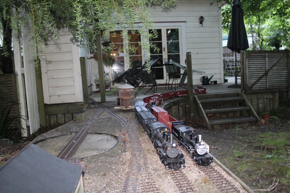

464 & 348 ready to depart Jackson City.
On arrival 348 uncoupled from her train, switched a cut of 4 cars stored on the main line to the departure road clearing the main for 464 to couple on to the recently arrived train.
464 then departed followed later by 348 (didn't want to chance leaving her outside overnight!)

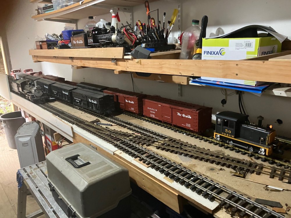

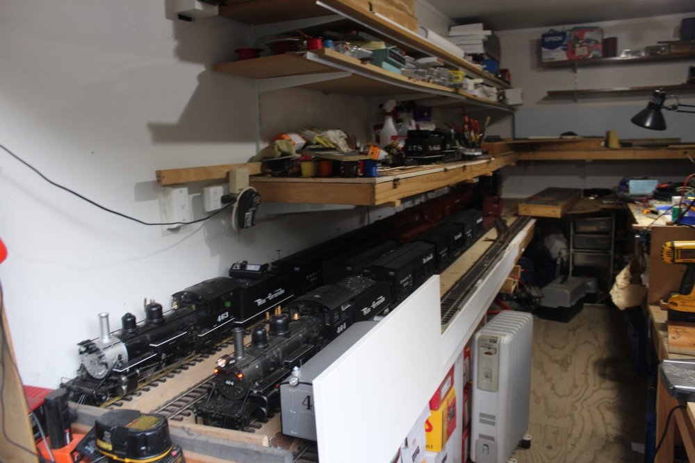

Starting to put the trains away! Large Scale staging tracks lower level, baseboards for 4mm Irish layout at intermediate level storage above and below. N Gauge baseboard plonked on top of large scale turntable.

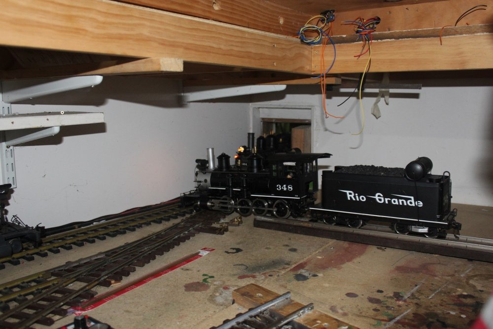

Oops!!!!!!!!!!!!!!!!
Classical mishap while turning 348 yesterday just as 464 was waiting to be flagged into the yard.
348 just rolled forward as she was being turned, luckily she did not roll the other way and fall onto the floor.

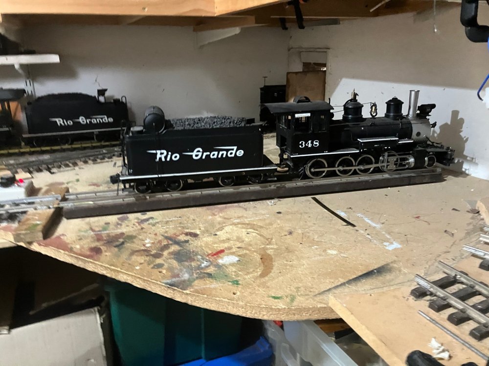

I had to re-build the pilot beam of 348 after she fell from a raised section of line about 7-8 months ago.

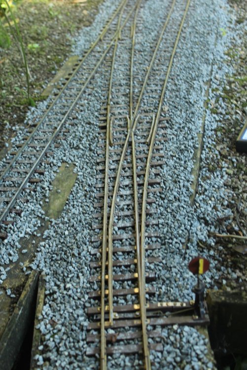

I finally got around to ballasting the main line through Utah Junction following the track re-lay. Ballasting is basically a much more expensive scaled up version of small scale loose ballasting techniques using screened stone chips and 50% diluted concrete bonding agent. Glue applied using a large syringe and a length of clear plastic tube rather than an eyedropper 😄.
Waiting for some rain to wash away the stone dust from the rails and sleepers.
Big improvement in overall experience , though I need to build up the ground around the water tower. There is a noticeable bump/change of level in the main running line opposite the water tower where I replaced a decayed section of decking/track support. I  improved cross levels on  a section of the main line in this area where the cross levels were badly off leading to excessive swaying and pitching as trains ran through at not quite speed.

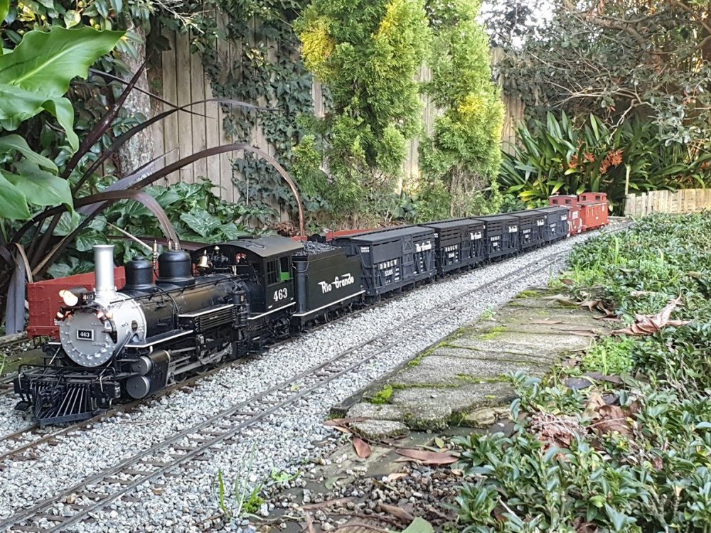

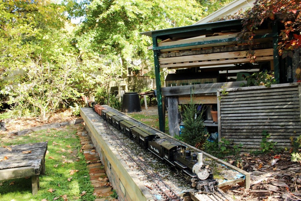

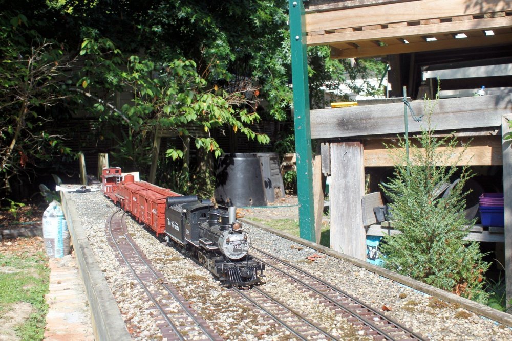

463 hauls in the empties on the 1st special of the season with an empty boxcar and a laden tank car to make up a full load for the K27.  A cut of cars for the Arboles Turn is stage in the yard in the background.
463 pulls into the yard while 348 waits to work the Arboles Turn and 464 waits on shed to work a Westbound freight. The turntable is a piece of decking timber pivoted on a coach screw and plate washer packers and really-really works.
I re-ballasted the main line and through tracks in this area over the Christmas.

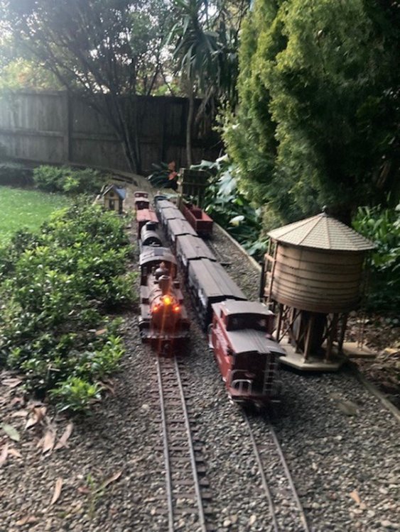

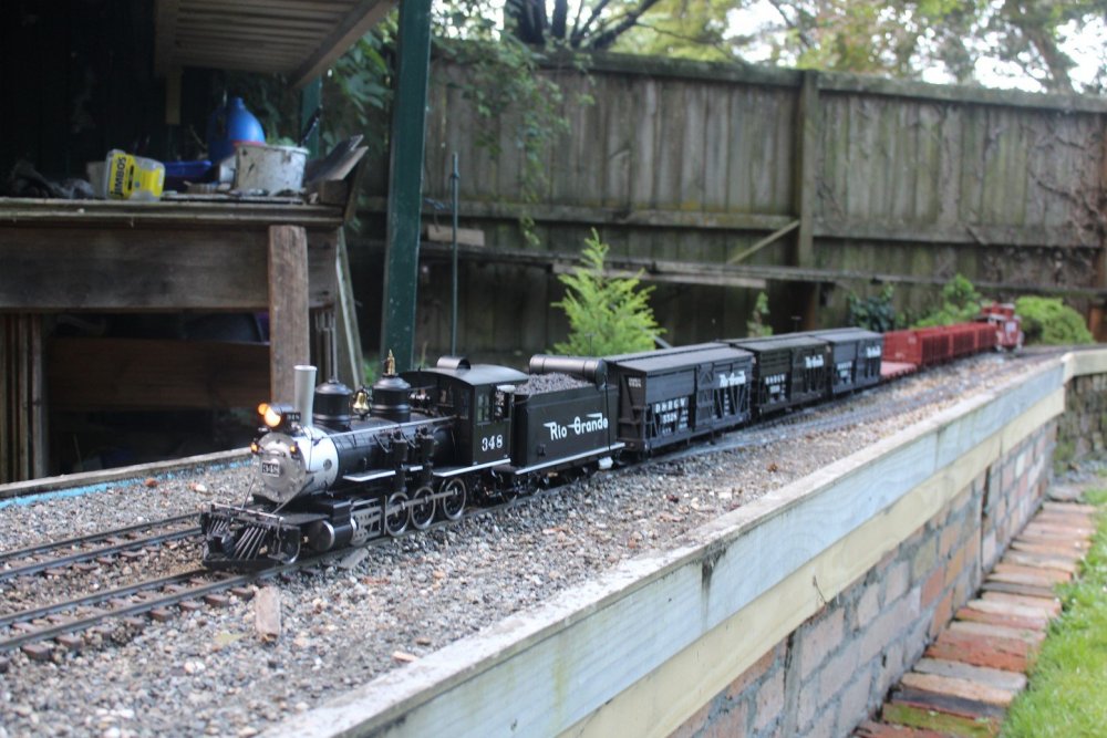

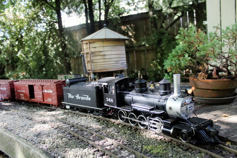

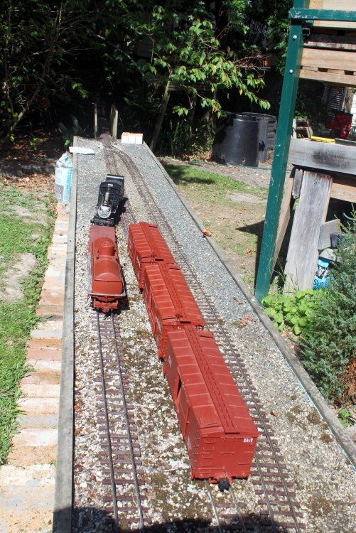

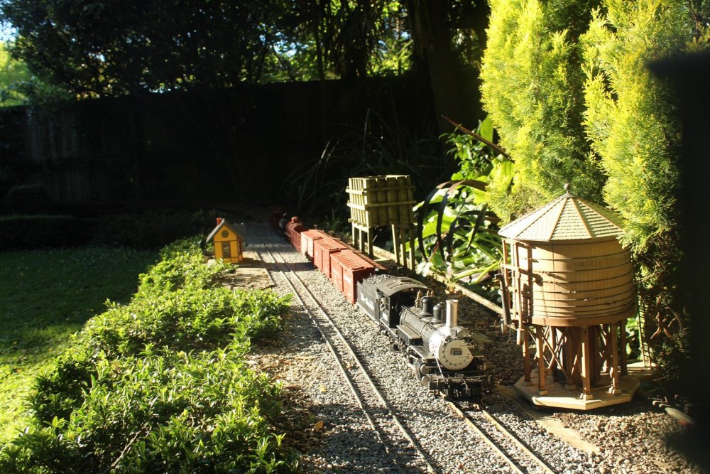

348 takes water before leaving on the Arboles Turn a locoal working. The DRGW used small 2-8-0s on branch lines and lines with restricted axle loading concentrating its narrow gauge 2-8-2s on steeply graded lines with heavy traffic.
348 arrives at Arboles before switching the yard. I am hoping to tidy up the area on the right with better screening between the outdoor work area and railway.  Town is named after some trees planted 2-3 years ago.
Upon arriving 348 set back with her train dropping the caboose on the other side of the bridge so the conductor could get some sleep/do the paperwork while the rest of the crew (2 brakemen, engineer & stoker) switched the train.
The loco ran round the train via the siding to place the tank car on a dead end spur. I used JMRI Panel-Pro Operations Programme as a car sorting and dispatching programme. 348s cars came in on an earlier train behind 464 which included cars for Jackson City, Arboles and Utah Junction.

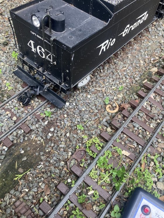

463 bites the dust having split the points at Utah Junction not an uncommon occurrence on the full size Rio Grande Southern.

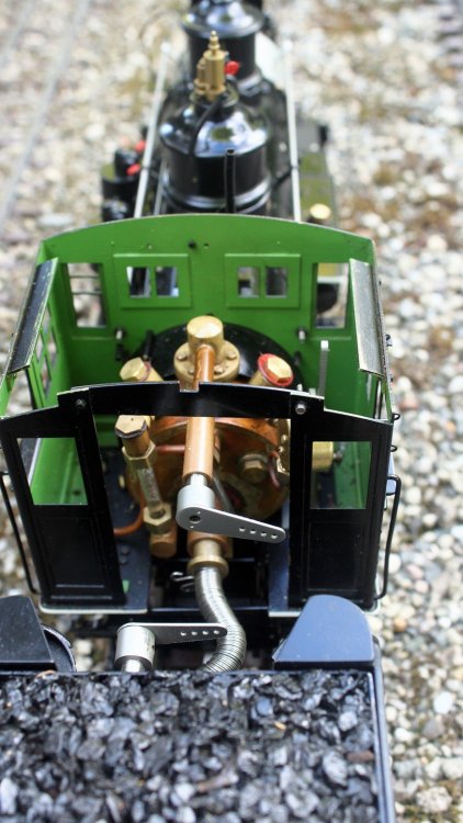

Playing trains live steam Accucraft C16 passing Jackson City
The live steam loco has been challenging both in learning to drive because of the grades on my line and finding track defects. 278 turned out to be a good buy, although the loco was second hand she never seems to have been steamed running in nicely capable of hauling 6 cars and a caboose.
278 with slightly scorched smokebox door
278 is quite controllable by small scale live steam standards and not too hot to handle once you keep your fingers well away from the cylinders, smokebox and hot bits inside the cab.
The biggest challenge like Waterford's Jumbo is to avoid blowing off and wasting steam while switching.

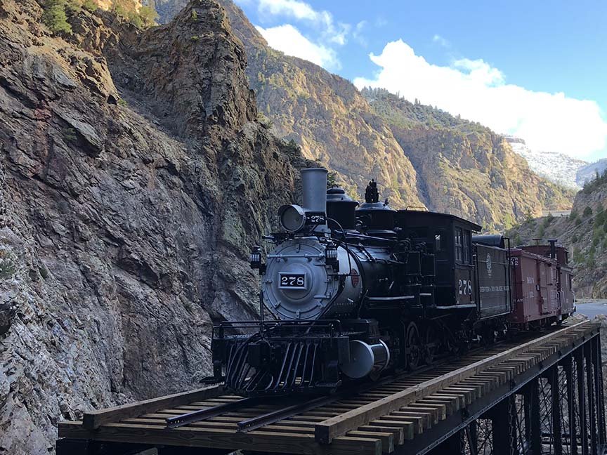

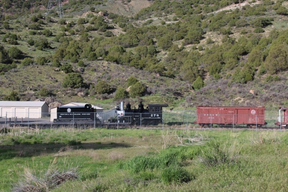

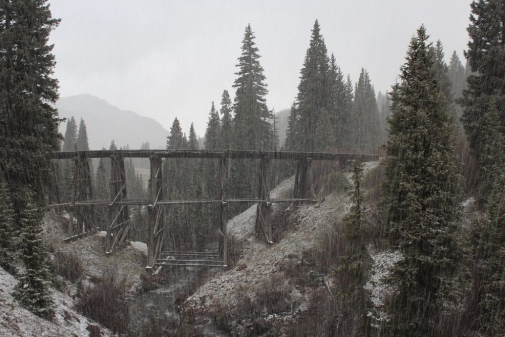

On the trip that inspired the change to 1:20.3 the real 278 undergoing cosmetic restoration in a National Park Compound at Cimarron Colorado.
The C16s were basically a narrow gauge equivalent of the J15, but largely replaced by larger 2-8-0 and 2-8-2 locos. The DRGW  retained a few for lines with light axle loading, several sold to other railroads and industrial lines that fed the DRGW & RGS
The two surviving DRGW C16s  268 and 278 were preserved locally when the DRGW abandoned its narrow gauge lines in the Gunnison area in the mid 1950s in 268 in a Gunnison and 278 on a trestle in the Black Canyon.
278 has since returned to her perch on the trestle, unfortunately we did not have time to check out 268 at the Gunnison Pioneer Museum

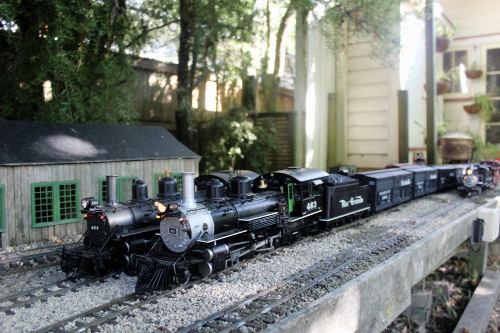

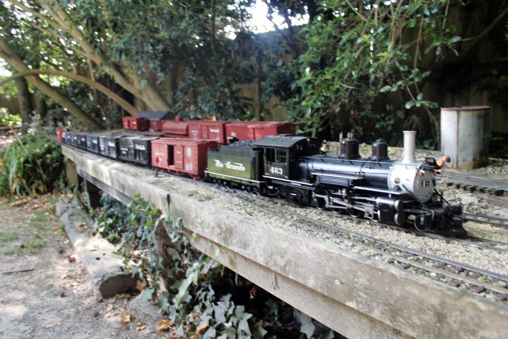

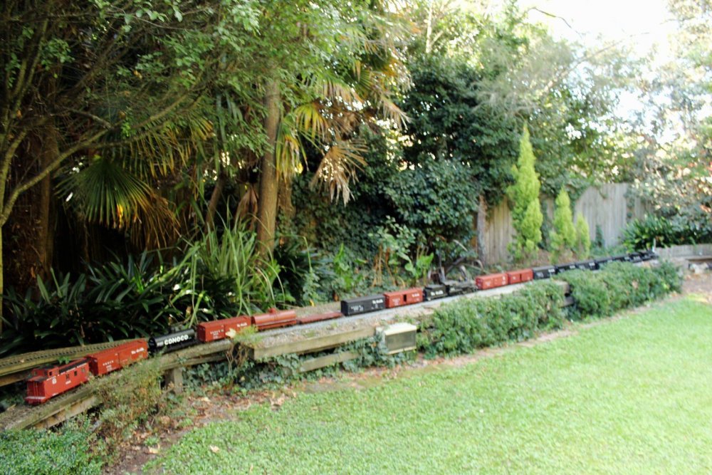

Although we have been running relatively short single engine freights, I could not resist running a 2 engine freight with a pair of leased K27 Mudhens in a similar to RGS.
In its final years the RGS relied mainly on pairs of leased DRGW K27 Mudhens to move freight traffic on its heavily graded Northern Division over Dallas Divide and Lizard Head Pass. The second loco was usually ran through from terminal to terminal, cut in as a mid train helper on the up-grades then running ahead light ahead of the train on down grades. (The crew of the helper were paid a higher rate when their loco was coupled to the train).

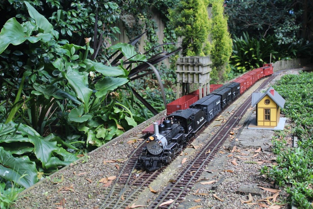

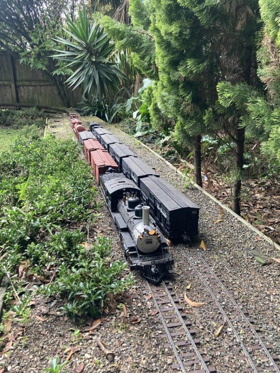

Arboles: Lead loco 463 about to enter the single track section to the next town, 464 has just crossed the bridge (lift out) 7 cars and caboose behind tender.
The passing loop here is two short to pass two long freights without a saw-bye maneuver.
The train is nearly 30' long almost scale length for a RGS Northern Division freight, 7-8 freight close to the load limit for a single 2-8-2 over the grades on the more easily graded sections of my line.
Utah Junction. Junction with longest crossing loop on the main line and wye for turning steam locos. Station buildings have been removed for winter.
The train is longer than the longest passing loop or siding or spur so an interesting exercise in reversing the train  to run up the high line above the caboose.

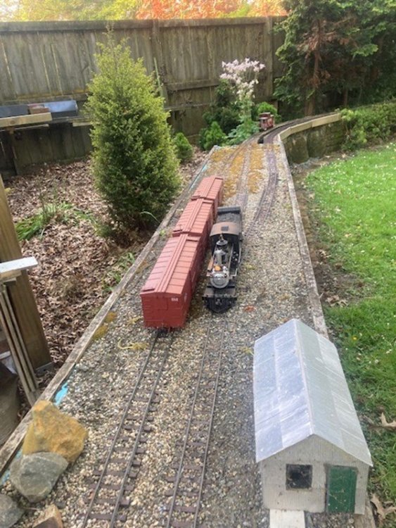

278 on the 2% 1:50 grade from Utah Junction to Jackson City.
The loco is on the most difficult curved section of the grade between the wye switch and the tunnel
Steaming rate improves as demand for steam decreases as alignment improves/grade eases once through the tunnel and trains tend to speed up as they climb towards the crest of the line.
The last section of the grade into Jackson City yard is also demanding with 278 almost slowing down to a crawl as it crests the grade, the loco and first caboose have just crested the grade the yard tracks on the left are level.

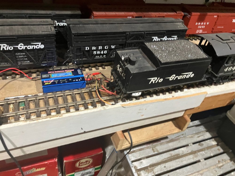

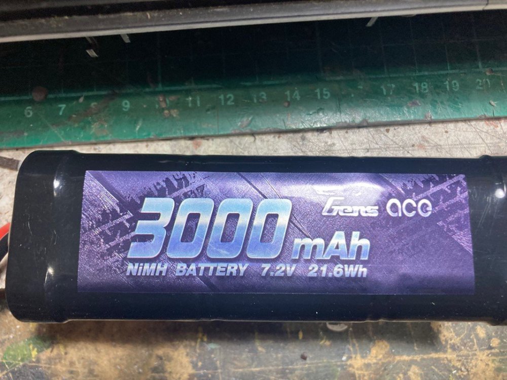

With about 30 minutes light left stage 278 was low on water and gas. I usually use a battery loco to haul in the train, allowing enough time to allow 278 to cool down to be handled for cleaning and servicing before being put away.
On this occasion things did not go to plan battery powered K27 461 refused to move forward for no apparent reason half way around the line and I had to call in my trusty Bachmann Connie 2-8-0 to haul the train in after clearing a space on the work bench for 461. At first I though that there may have been a gear box problem, but on closer inspection one of the leading crankpin bolts had worked loose and fouled on the rear of a cross head while running forward, but re-tightened while running in reverse.

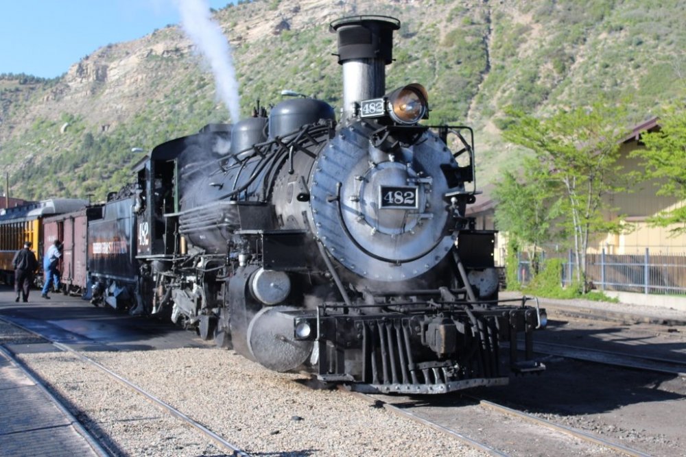

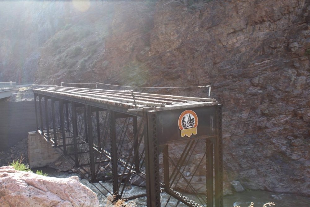

Spent a very enjoyable week in Colorado in 2016 for me the highlights was not quite getting caught in a snow storm at Trout Lake water tower and trestle while tracing the remains of the Rio Grande Southern between Telluride and Lizard Head Pass.
IMG_0945.thumb.JPG.27ae37383f8f1f385f40aca1705fbf3e.JPGIMG_0946.thumb.JPG.af83025c5ddc1f3a1a383f8942ae87f0.JPG
Daughter mainly interested in Thomas & Friends set ups at every museums & railroad depot we visited.
Holiday worked out mighty expensive when I replace nearly all my LGB & Bachmann stuff with 1:20.3 after seeing the sheer mass of full size American narrow gauge equipment

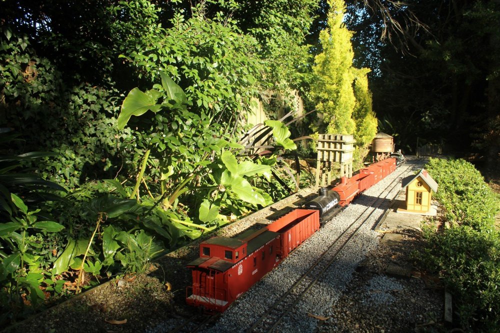

This area is shaded for most of the year with a brief window of sunlight in late afternoon during winter time but well worth the wait. The train is a mixed freight returning to storage, the gondolas (opens) in the backrgound will be picked up by a clean up run.

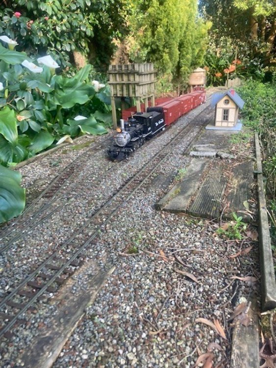

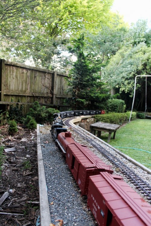

463 with a stock train, this is close to the maximum load for this loco on the 4% grade to the shed.

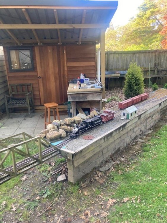

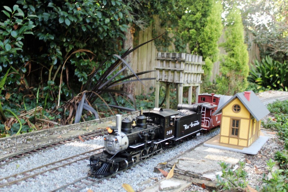

A couple of weeks later 348 arrives at Arboles with a mixed freight (I planted tres arboles 3-4 years ago but they take time to become established). The track was laid on re-cycled ballast (fied with concrete bonding agent) on pond liner on 18mm treated ply and the moss takes over during the cooler, damper months (most of the year!) The train is a positioning run to deliver cars to this yard before I run the sequence.
The caboose waits on the main line while the loco positions the cars on the siding (loop).

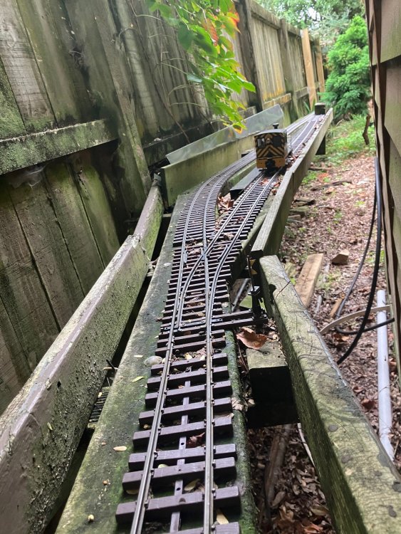

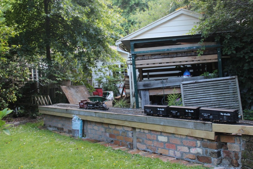

Grading and tracklaying finally started on the Utah Extension extending the tail of the wye track.
Not sure if it will go much further like a lot of planned extensions, but its already added another useful source of traffic and greatly simplifies reversing complete trains without a lot of time consuming switching.

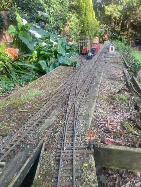

Something unusual: more realistic derailments or the challenges of Large Scale modelling?
I sometimes run a train while I am working in the garden, after circuiting the main line several times this happened. The tank car appeared to uncouple from the rear of the train near the tree in the distance, then apparently de-railed at a facing point, partially de-railing a gondola before the train drew to a halt. The Tank Car (Bachmann Spectrum) had a tendency to rock from side to side on curves when running downgrade so further investigation was required to identify the initial point of the de-railment
The red tank car initially appears to have partially de-railed on the approach to the viaduct passed trough a tunnel and the facing turnout to the wye before totally de-railing on a trailing turnout.
The tank car had a greater tendency to rock from side compared to the Accucraft freight cars, which I tried to correct by fitting side bearing pads to one of the bogie, leaving the other to take up irregularities in the track which appeared to have largely eliminated the problem. The Bachmann bogie pivots on a sleeve secured to the body by a self tapping screw with a large washer, Accucraft originally used a turned bolt with a compression spring arrangement, but recently changed to a similar arrangement to Bachmann.
While I initially treated the rocking as a problem with the design of the bogie/tank car, wheel profile may be a factor https://en.wikipedia.org/wiki/Hunting_oscillation although Bachmann use a similar bogie pivot arrangement for its Big Haulier range of G gauge stock hunting/oscillation is not a problem although the High Haulier coach freight car wheels are smaller dia than used with 1:20.3 stock.
The next step is to inspect the tank car bogies and wheels and possibly swap wheel sets or bogies to see if it makes any difference

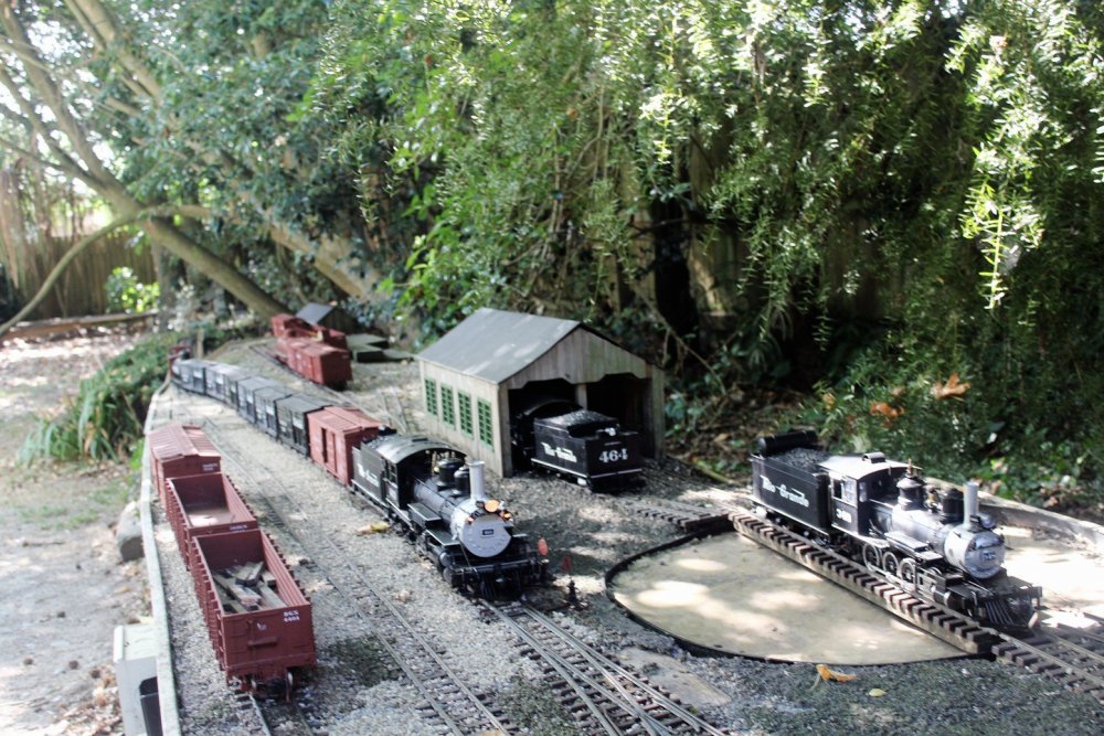

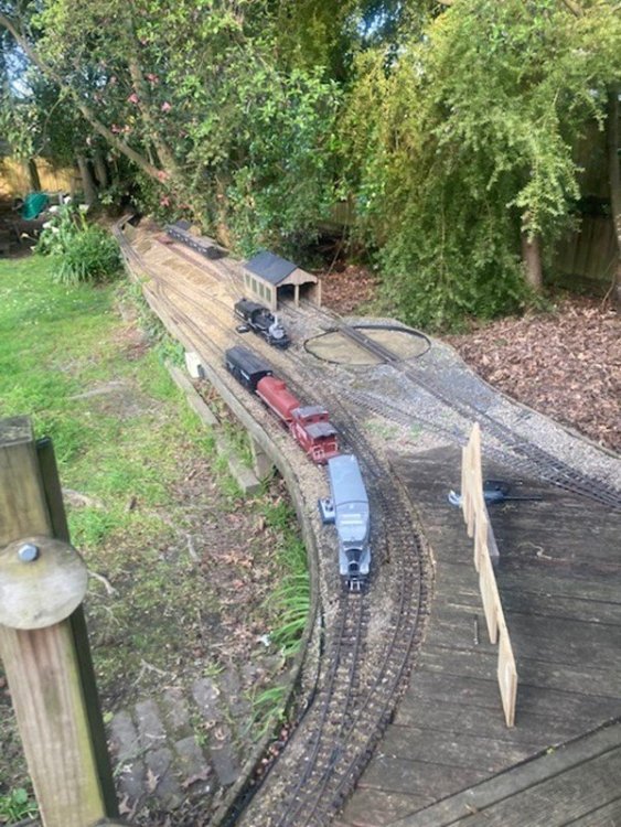

Line up of railtrucks at the loco depot. I moved the shed back from its usual position for the line up but will probably leave the shed in this position as it works well both visually and operationally, though I will need to extend the supporting framework.
The K27 just about fits on the turntable which really works. My largest locos was a 2-8-0 when I installed the turntable.
The train is on one of the 1st sections of track installed in 2007, although I had to replace the sleepers or ties in this area the treated timber framing has stood up well to the weather and will probably last another 12-3 years.

C19 346 & K27 463 await their next assignments in the loco yard while Motor 4 hides behind and under plant pots on the loco yard lead in the far distance.
464 has completed her switching having coupled the caboose on to the departing Westbound freight and pulled the train clear of the siding switch allowing 463 to couple on and prepare for departure. 348 has turned and is waiting on the loco yard lead to couple on to her two cars and caboose once the departing train and 464 have cleared the east end of the yard.
348 finally on her way has uncoupled from her caboose and her cars and is about to couple on to the stock special on the siding.
348 pushes the gondolas on to a dead end spur before setting back and departing with the special.
This section of the railway uses the nearest to conventional baseboard construction with plywood on treated timber framing with glued ballast and ground cover using a concrete bonding agent with a waterproof membrane to protect the ply.  Station building is based on Pen y Mount on the WHHR.

348 and her train have turned on the Wye and reversed direction and are about to take the "High Line'
4 cars and a caboose are just about the limit on a dry day for 348. 463 & 464 both needed assistance with 11 cars while putting the trains way later in the evening.
Staging yard switcher No 50 has released 348 to back down to the turntable to turn and for charging.
Charging Stations! Locos are fitted with 2 NiMh 7.2V model racing car battery packs as standard and are good for approx 1hrs running on a standard charge.
Charger & transformer  lives in a pocket under the staging yard lead is long enough to reach any point on the loco ready/servicing track.

The first was a 'positioning run" with K27 463 for a Livestock Special with some general freight tagged on stopped for water at a rather green Utah Junction.
I had set up the water tower and Depot building just before the shot!
The jungle (New Zealand Bush) is starting to take over behind the railroad.
Train is approx. 20' long.
Climbing towards Jackson City (named after original 1924 owner of property). The curved upgrade from Utah Junction to the tunnel is one of the most challenging section of the railroad requiring full throttle to avoid stalling with a heavy train.
This area originally featured a pond and waterfall which was a major maintenance challenge, now a dry stream bed! Originally a 2 span truss bridge, visually works better as a piled trestle, have to add more trestle bents to reduce the span.
Arriving at Jackson City. Loco shed spent winter indoors which should help extend its life!
Switching the stockcars to the House Track, I will have to add a stock yard some day!
Meanwhile 348 worked another 'positioning run' with Gondolas for loading with coal traffic at Utah Junction and Boxcars for lumber loading at Arboles.
348 and her train have turned on the Utah Junction wye and reversed direction for the run to Arboles, having positioned the gondolas under the hopper.
In a way the train is a tribute to operations on the DRGW Gunnison division in the mid 1950s when small  2-8-0s handled coal and lumber traffic North and West Of Gunnison.
348 has placed the Gondolas under the hopper and is now ready to depart with the road site for the Arboles line, the track on the left is the "High Line" to the staging, a bit like Foynes Trains at Ballingarne crossing trains to and from the High Line involves a switching movement due to the layout of the Siding (Crossing Loop).
Arboles is starting to live up to its name 348 has dropped the Boxcars in the Siding  and now is now backing down to pick up the Caboose and head for Jackson City
Late afternoon K27 464 heads overnight symbol freight (scheduled) PL-JC 2 (Placerville (staging)-Jackson City) through Utah Junction.

348 departs Arboles for Jackson City, outdoor workbench and toolshed in background

The first task was to position some stock on the layout so there was the outgoing trains did not return with the same freight cars!.
K27 463 & RM 4 on shed stock cars positioned on Track 3. 463 had worked a freight from the staging to Jackson City with stock cars and General Manifest (Boxcars, Gondolas and a Tank Car the latter are positioned in the yard hidden behind the Engine House. No 4 worked an empty Mail/Passenger and will return with the next days scheduled train.
Caboose parked on Track 3 opposite the Depot. 1:20.3 stock has a lot of (easily damaged) detail
Manifest for Freight PL-JC4  The train number/designation follows American and New Zealand practice. Even numbered trains are usually South or East Bound
Placerville is a real place on the Rio Grande Southern, most Railroads in Colorado planned to reach the Pacific or at least cross the state line into Utah, Jackson has a family connection and the first person to occupy our house almost 100 years ago was a Jackson, hence Jackson County & Jackson City.
Train made up and ready to go, its easy to read the individual car numbers in 1:20.3! 348 is working the train as 461 is un-available & 464 is waiting for a new set of batteries
PL-JC4 arriving at Jackson City the train is approaching the summit of on a 2% grade which can be challenging with slipping by both 2-8-0 and 2-8-2 locos in greasy rail conditions.
The yard in the background is level, the boxcars are due to be spotted outside the Freight House (Goods shed) for loading with ore (silver or possibly uranium) Silver ore was transported loose in box cars (to avoid freezing) on the narrow gauge, the last box car may be transporting beer and other essential supplies for the local inhabitants. Beer tended to be transported in Reefers or refrigerated cars to avoid freezing in winter and over heating in summer the Colorado Rockies have a rather extreme climate!
348 pushing her train into the yard having already dropped her caboose on Track 3

Moving the stock out to the garden gave me a chance to change 464s batteries as after 4 years the batteries were no longer holding a charge and the loco was unable to haul a 8-10 car train up the 4% grade to the staging.
All locos use pairs of 7.2v RC car batteries the majority 3000mAh capacity.
There is no real equivalent of NMRA DCC plug and play in large scale battery RC, the nearest was a standard interface used by Bachmann on its K27 all my brass locos are hard wired. The object on top of the Bachmann board is a power regulator/speed and direction controller. The purple yellow brown and white leads connect to a Phoenix sound decoder hidden below the tank filler. The small "decoder" with the red antenna and the untidy leads is the actual radio receiver.

464 awaits to depart with the Stock Train as 463 arrives with a Way Freight (West) and 348 makes up 463s train (East) for departure.
Nearly Tea Time! 463 has drawn her train into the clear to allow 464 to depart with the Stock Special.
The next move was for 463 to either reverse or draw forward clear of the yard to allow 348 to position her cars on the Departure Road (at left of 464). Unfortunately rain was forecast, it was getting dark,  and we had to abandon the session for another day!

I decided to run a couple run a stock train and a freight with K27 2-8-2s 464 and 463 on Sat. afternoon but had to postpone until Sunday afternoon after the coupler pulled out of the tender dragbox on 464 on the empty Stock Special.
464 had earlier rolled over on the High Line just like RGS 455 in 1944 https://digital.denverlibrary.org/digital/collection/p15330coll22/id/61596/ luckily without serious damage (landing in a bed of mulch), was re-railed and continued her journey until the coupling failed on the first stretch of level track! She managed to back her train up to the staging with some manual help, leaving only 348 a small 19th Century 2-8-0 and 463 to work the Stock Train and the Freight as opposed to the two 2-8-2s and the 2-8-0 as planned with the 2-8-2s as train engine on both trains and 348 as "Helping Engine" on the "Hill"
In the end it was decided to combine the two trains and run with a helper loco throughout and divide and "Double the Hill" with the return train, although it was dry the rails were greasy and 348 slipped and stalled with 5 cars and a Caboose even on a 2% grade.
C19 (16 actually!)348 departing Jackson City with stock cars with K27 463 cut in behind heading the general freight a reasonable representation of an RGS freight in its later days though usually hauled by a pair of hired DRGW K27s
348 is actually an Accuracraft DRGWR K16 bought second hand from the States, the owner had neatly re-numbered as a similar though larger K19. The RGS bought 3 K19s from the Rio Grand during the early 1900s but I am not going to bother changing the livery or running number!
Passing the Summit section of the line with the locos on a 2% down grade the train is stretched out over 20'
The trees behind the train were bought as 'miniatures" about 10 years ago! 2024-2025 firewood weathering beside the railway.

I haven't had time to do anything on the model railway front since July  as a result of a family crisis, though I finally made time this weekend to carry out an overdue inspection of the Jackson County.
I first started work on the Jackson County in 2007 using treated timber piles and track supports which have held up fairly well to local weather conditions (high humidity -high rainfall.
Most serious immediate problem was a 6"X2" splice plate had rotted right through at a trackbase joint on the High Line effectively severing the Staging Tracks in the garage from the rest of the railway. More long term problem is that some of the posts that support the garden fence are beginning to fail requirieng expensive replacement although the fence rails and boarding is still in reasonable condition. I originally fixed the track base directy to the fence rather than independent foundations to get something up and running quickly. I still have a good stock of treated 6X2 in stock, usually nail with annular gun nails, though the nicad charger for the the nail gun is kaput and replcements unavailable.
Two sections of track-base had rotted through above supports on the main line, though the supporting structure appears ok. Possibly installed the trackbase  with the grain facing upward trapping moisture.
Utah Junction looking scruffy, needs weed and moss treatment and hedge trimming. Once a sunny sport this area is in the shad for most of the day a small native shrub planted 15-16 years ago has grown into a medium size tree, because of our humid climate trees (and Grass) grows at a faster rate than the UK or Ireland, we have a 40' tall 15 year oak close to our house.
The Tunnel and bridge are holding up well though we gave up on the water feature because of falling leaves and tree debris
Though we would run RGS Motor 6 on the inspection trip though the motor appears to have overheated. The Motor is a Berlyn Locomotive Works Korean Brass rtr model bought mint second hand on e-bay for an eye watering price by Irish standards several years ago. Planning to convert the model to battery RC operation some time during the next 12 months after several years in a display case. Figures are Woodland Scenics nicely modelled though brittle Engineers (driver) right hand snapped off.
Motor 6 on the main line High Line in the background border shrubbery in this area died off shaded by a tree several a couple of years ago.
Into the "Jungle" this area was originally a Sun trap planned as the site for a large wooden trestle similar to those at Ophir on the RGS, but taken over by lillies during Spring before dying off during the Summer. Took the photos on a sunny Spring morning before heavy rain and thunderstorms in late afternoon evening.
Obstruction faced by Motor 6 ivy grew across the track during the last 2-3 weeks with new Spring growth, apart from trackbase repairs, trimming back the shrubbery, next big job is weedkilling (residual weedkiller backpack sprayer) depending on the weather forecast.
While the railway is 1:20.3 scale weather, vegetation and animals are all 1:1 scale and call the shots.
