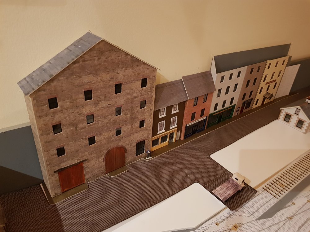

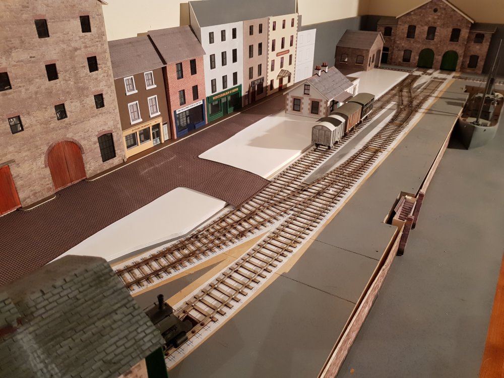

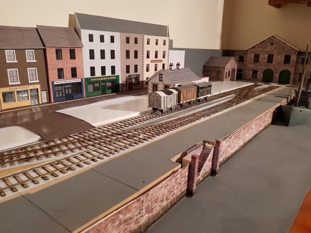

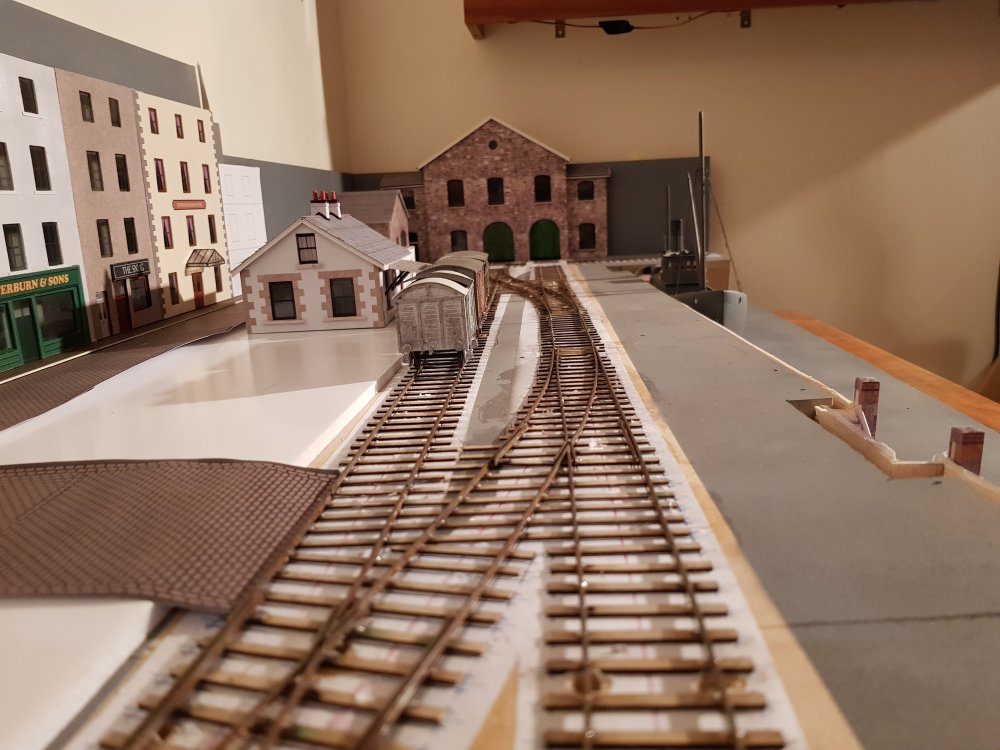

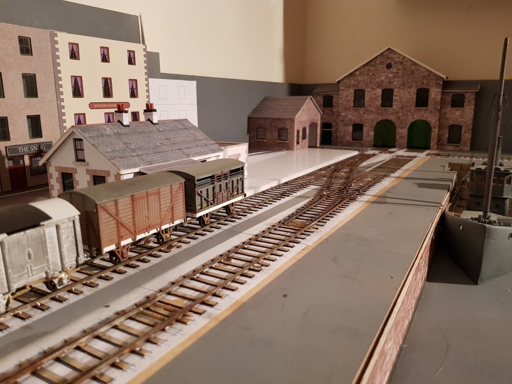

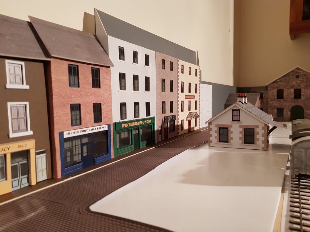

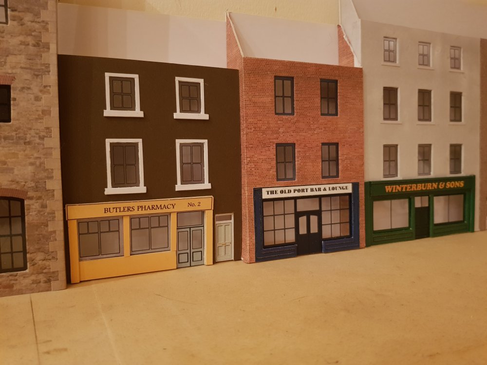

Still a way to go, but getting there.  More detailing, roofs & weathering to mute the whole lot down.  Some form of road would be useful - perhaps cobbles with a basic footpath......
Getting there!
Ken

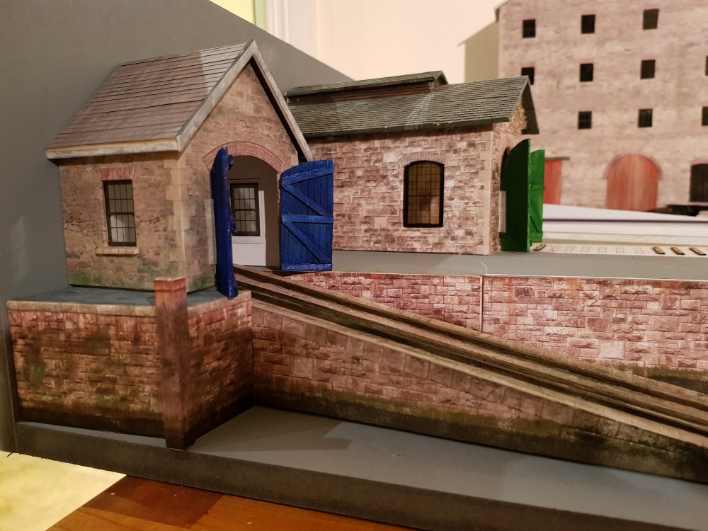

The main factory / warehouse got a little more work & I started on the goods shed.
20180311_224336.thumb.jpg.7561ae42c9f88dd5e50a7b5eaab1ef82.jpg20180311_224342.thumb.jpg.e46cbc30de2a281855798dbc6197f13f.jpg20180311_224352.thumb.jpg.6c0a21ec10504c56eea6b53df12643df.jpg
Shortened goods shed, as there is not much space between the backboard and the wagon turntable - still plenty of work needed to compete.  The platform is an old one I put in place for context.
Really need to put some window sill on that factory!!
And what every good port should have - A lifeboat station.
20180311_224610.thumb.jpg.afcb143a60afd94a5cd13d19849c9711.jpg20180311_224617.thumb.jpg.7a3df859fabbf903d2f646c8a69bb6d3.jpg20180311_224624.thumb.jpg.cec4ff405ea10ff628aaa2a5be4212f9.jpg
A lot of detailing required on the slip and to tie the boathouse in.  Obviously a lifeboat just poking out of the boat house will set it off nicely.
Masking tape hinges until I can make up a few suitable hinges!!
Cheers - till the next one....
Ken

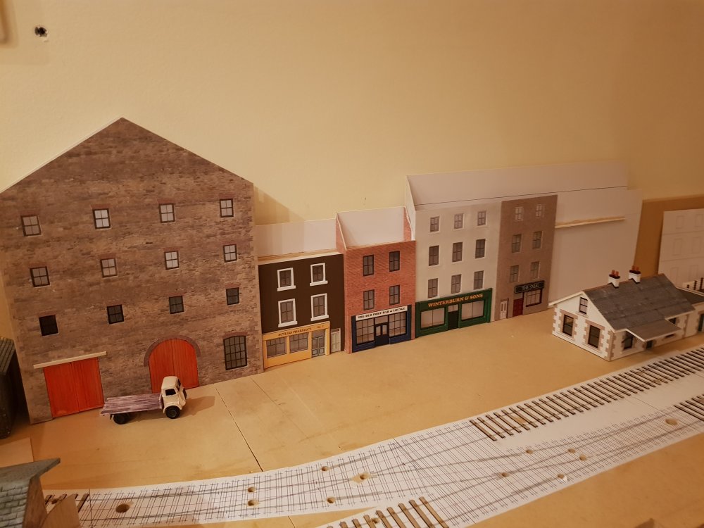

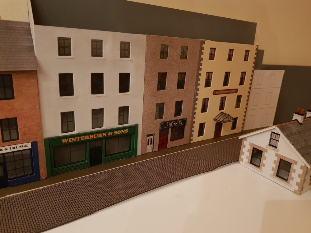

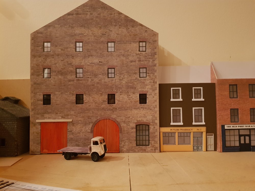

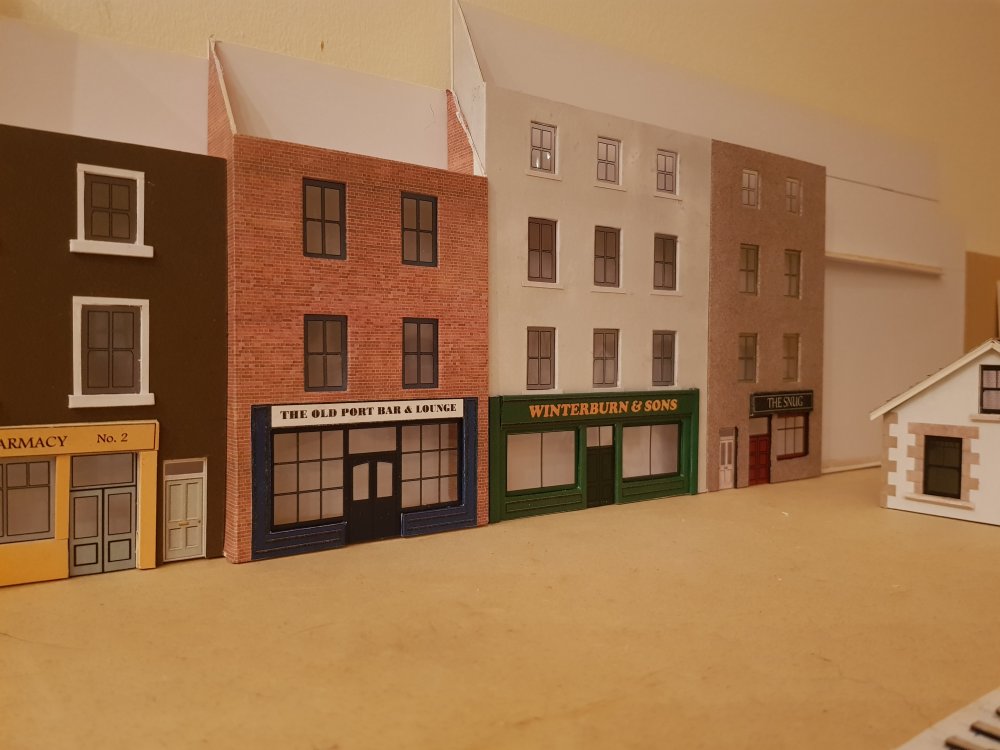

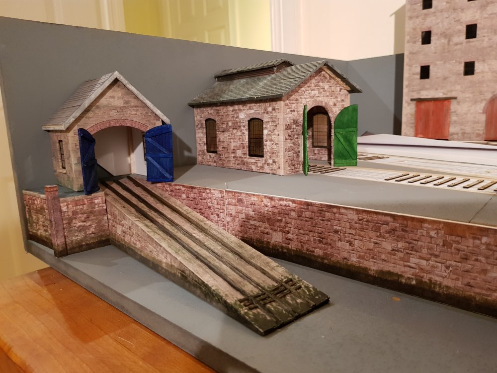

A little bit of progress.  Painting the base boards and backs does make quite a difference.
Lifeboat house is getting a little more detail and is nearly ready to dress into the layout properly - I'll probably leave it until I'm sure I don't need to lift the base again.  Strand Street is starting to take shape - cobble lock street looks a bit better, but will need some distressing as it looks a bit fresh!
Trying to add a little colour through door painting etc, otherwise it is all going to look a little drab!!
20180412_225208.thumb.jpg.b1048ac7f58b1615bbe497441b3b5490.jpg20180412_225220.thumb.jpg.cc1ed91a607722bea17e1c6cb8d387c5.jpg20180412_225643.thumb.jpg.9ee1bb7c4d0a23cbf31cd9efcacc2553.jpg
Footpath is a little narrow - may need to bring it slightly forward.
Window cills needed for the hotel to improve the look, as its a bit plain at the moment.
Getting there & enjoying the journey........

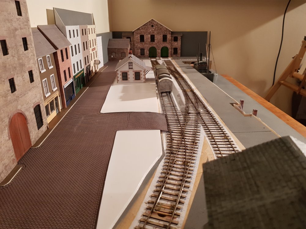

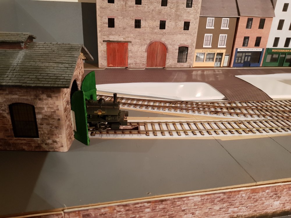

That track was not going to fix itself, so I took my brave pills, put on the man pants and went at it!
The copper clad PCB does make the tie rods etc easier to do, especially when you trim away some of the copper at the ends of the tie rod, so it runs under the rails without catching.  One point is still giving some trouble with the switch rail not sitting against the stock rail properly - works fine in trailing direction, but de-rails in facing direction.  Just needs a little fettling.
The ash pit in front of the engine shed, needed longitudinal sleepers with plastic chairs added to the rail to fix and hold the rails.  Looks better than the rivet construction, so I can see long days of cutting chairs to fit over the rivet and solder....
Lots of drop cables under the rails for power, however the wagon turntables are going to need a little thought to ensure I get power in both directions without shorts - not sure on that one yet; the gaps between rails may need to be generous to ensure I don't get a short across the tyre when crossing at 90 deg.  Something else to fuss about later.
It's really starting to come together though!  The gauge and sleeper distances really looks well.
20180417_225211.thumb.jpg.38f020387ca9722aa87631207fdeac91.jpg20180417_225232.thumb.jpg.a4179f23c507582c074a0c514adfa9e7.jpg20180417_225311.thumb.jpg.a7a1bdbc6ca1fd54a815802620915e3c.jpg20180417_225322.thumb.jpg.661b17238d00d444aaf84336b0829aa8.jpg20180417_225349.thumb.jpg.02ad293d03152779b75ba593ba608114.jpg20180417_225334.thumb.jpg.0a7563c95d20e570a6e1e0740e6bd93f.jpg
BTW, the rust on the rails is real.  The flux used to solder the rail to the rivet seems to remove any protection and rust starts to develop quickly - it will give an authentic look, except it will be necessary to keep the top of the rail clean for electrical conductivity purposes.
Point motors and wiring to be done before I can set the base in more permanently.
