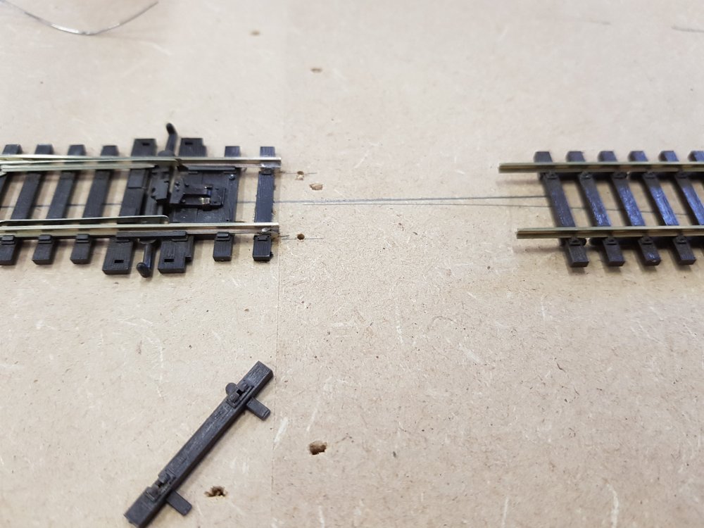

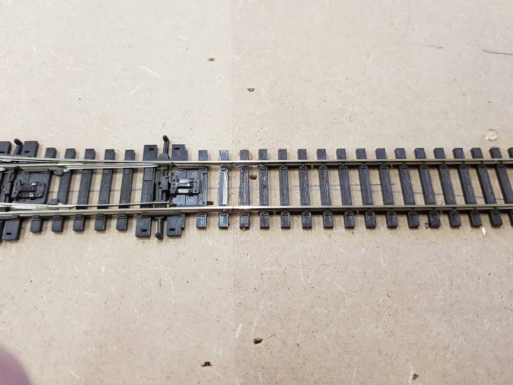

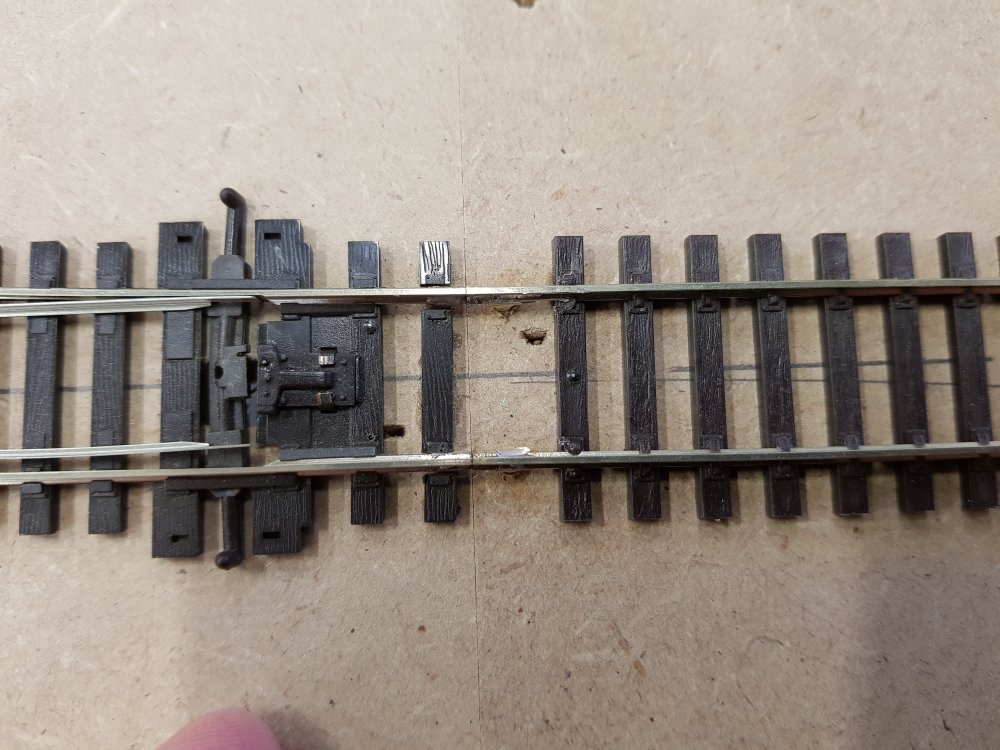

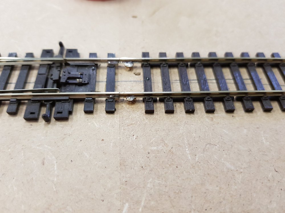

A lift up section is well worth doing. Yes it's a bit of a pain soldering track but once it's done you will be happy you did it. Most of the layouts I do that go around a room have a hinged lift up section.
I wouldn't use copper clad sleepers, they can come away from the baseboard over time. I use brass screws, once soldered I trim them down to the width of the rail with a dremel then fill in the gap with sleepers. The best thing about using screws is once they are soldered to the rail they can't unscrew and come back out. Iv'e seen people use nails but they just come back out with expansion and contraction.
Here's some pics of how I solder track across a baseboard joint, same principal applies for a lift up section.  (There is a joint there, it's perfectly joined together!)

Dave, a very nice piece of work there, a clever technique. In my case I have a double track going around the corners of the lift out section and it's not my cup of tea. However, I don't need to do it now, I can think about as it become absolutely necessary. Thanks
