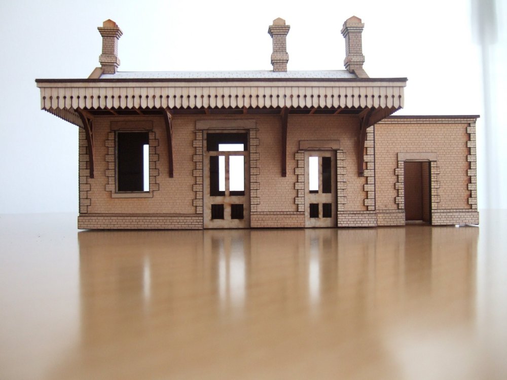

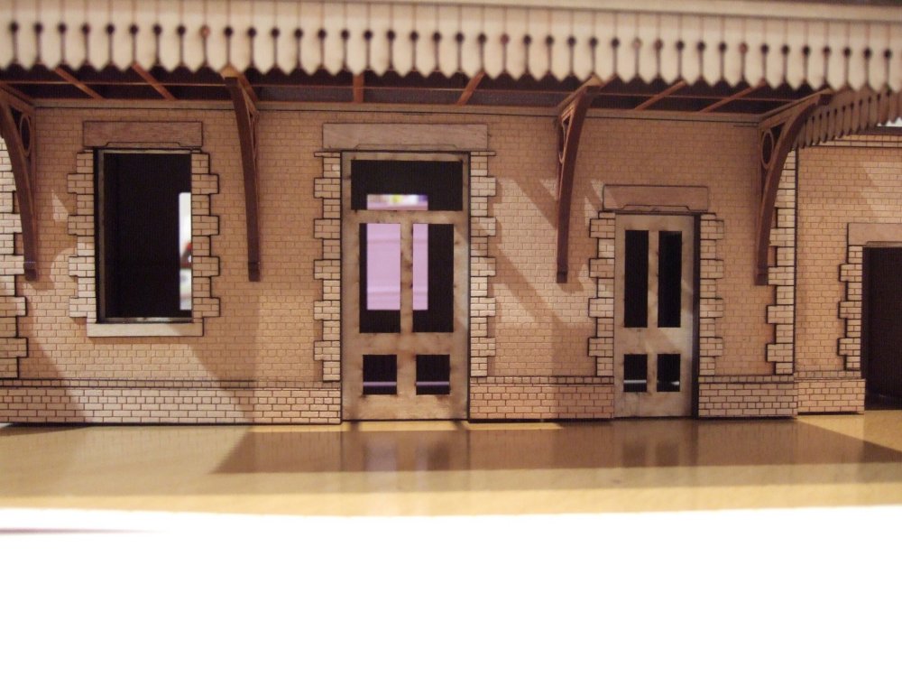

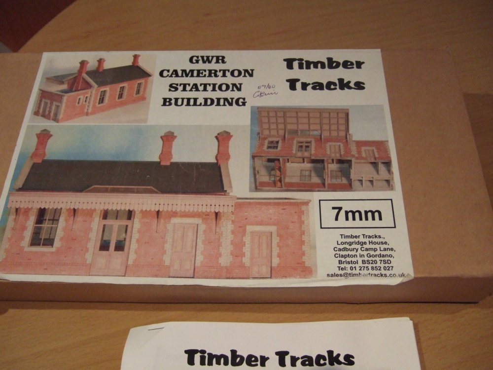

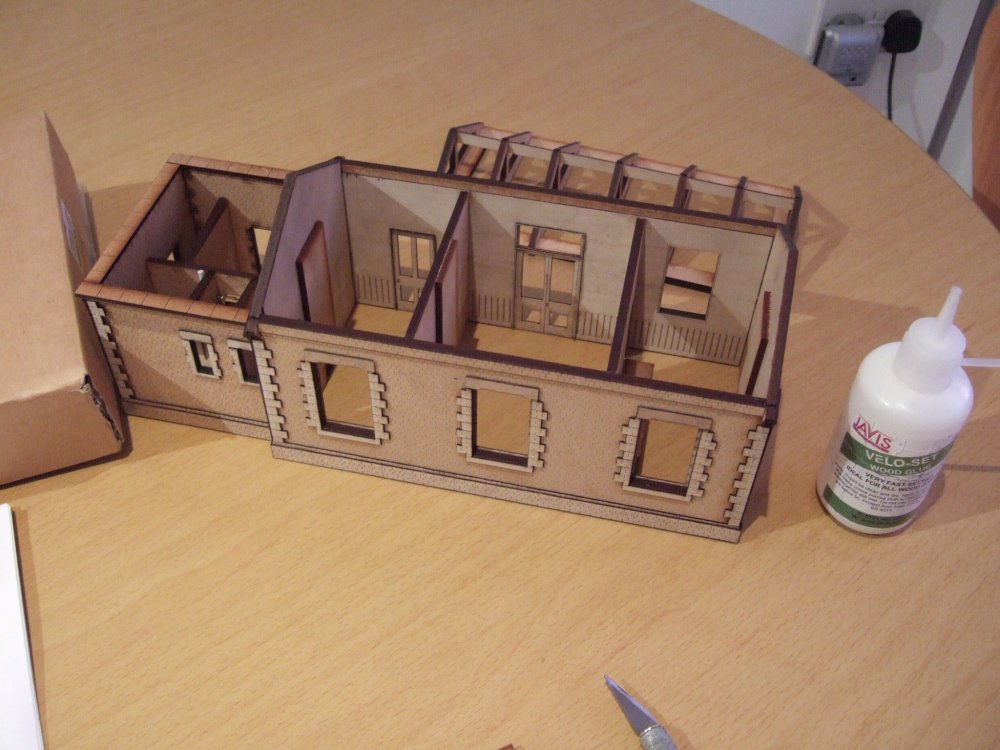

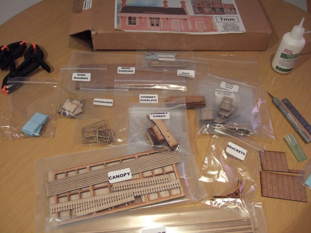

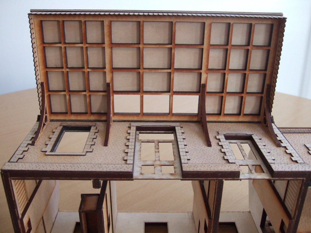

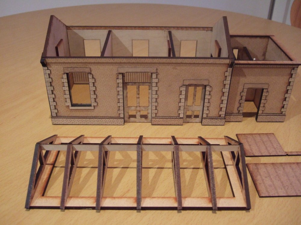

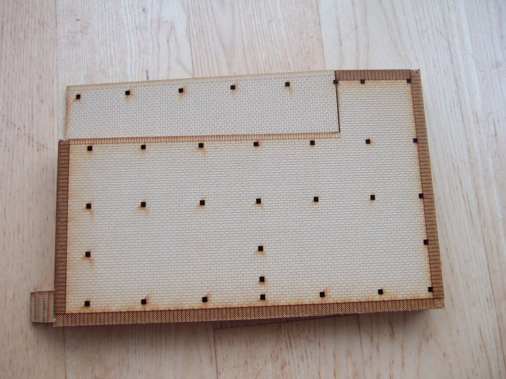

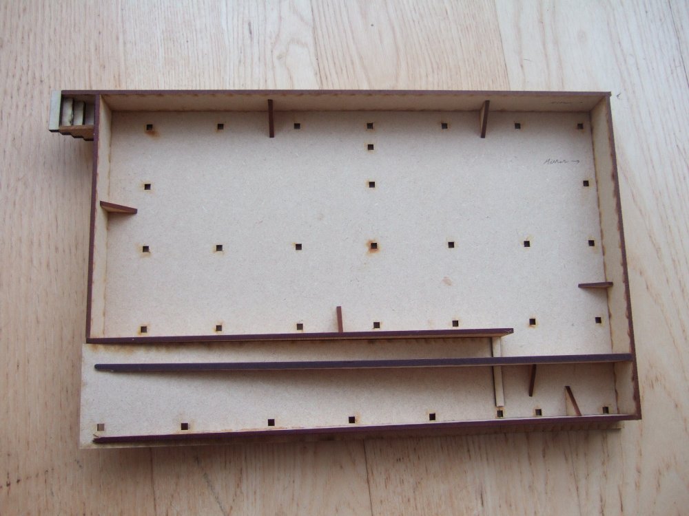

Irishrailwayman Posted December 6, 2019 Author Posted December 6, 2019 Work progressing on assembling GWR station: 7

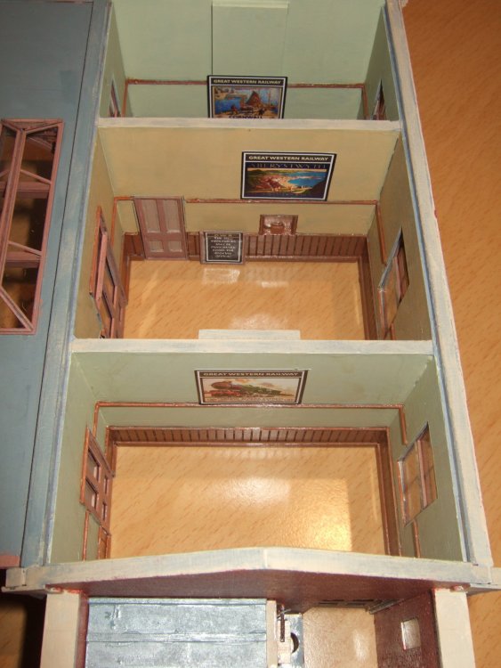

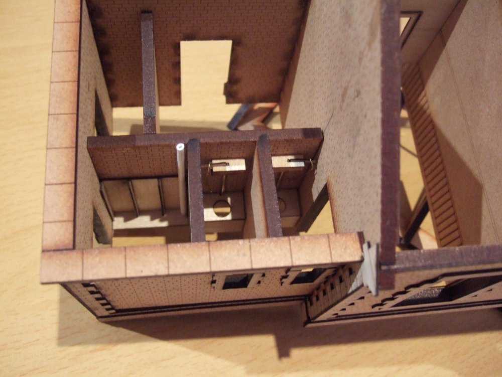

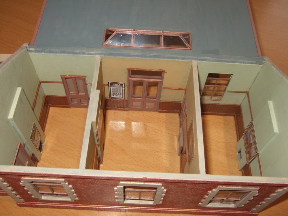

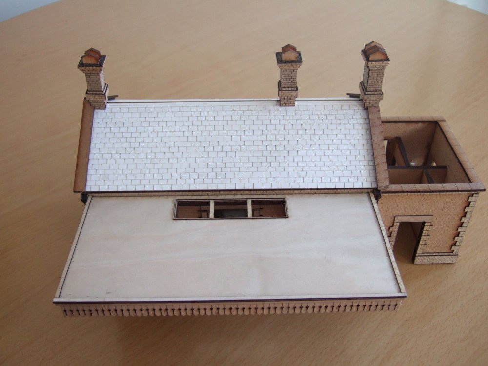

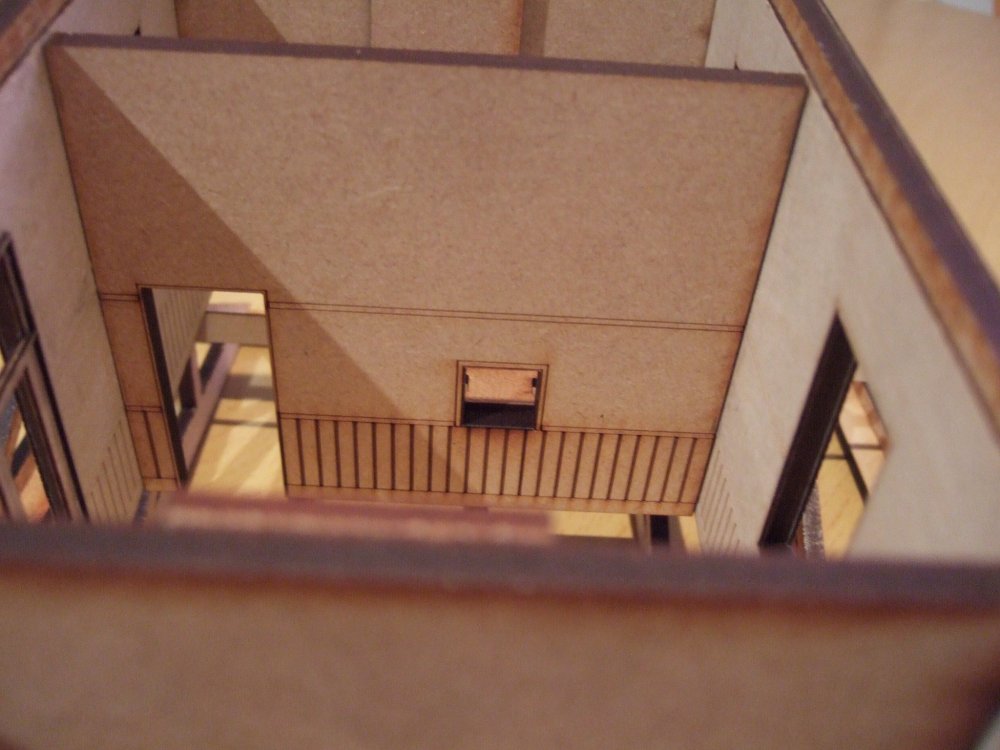

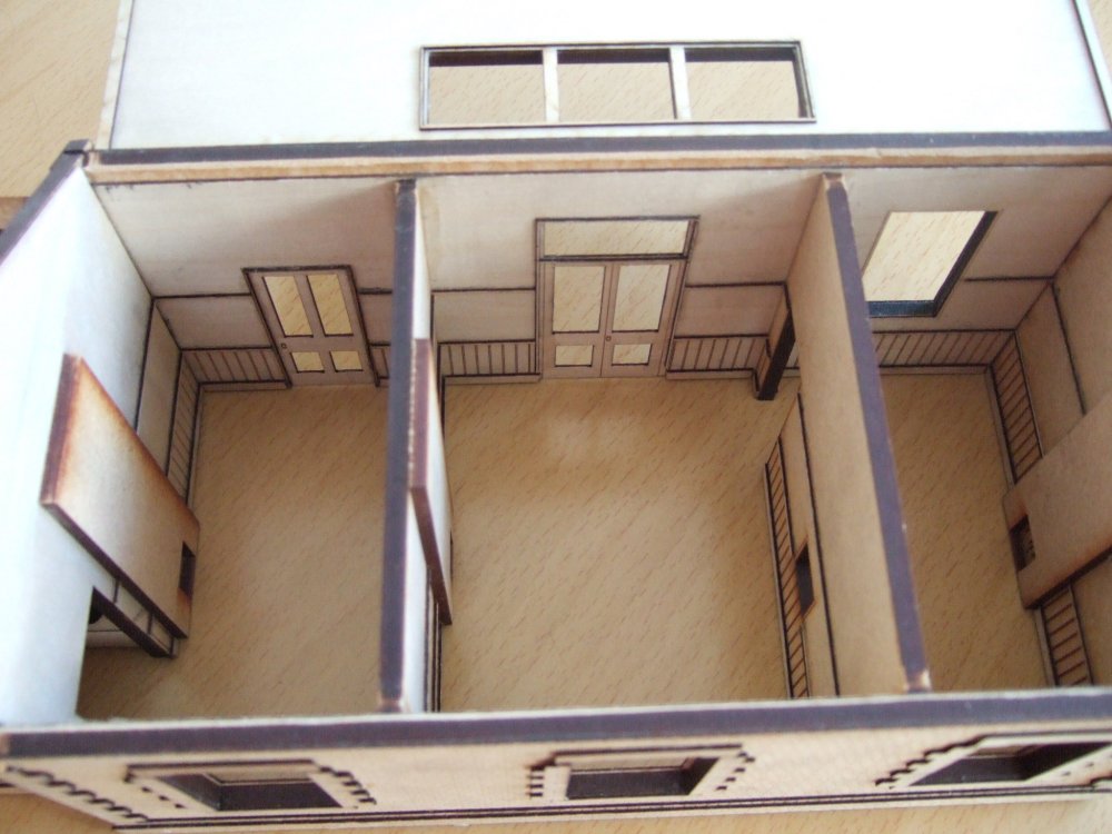

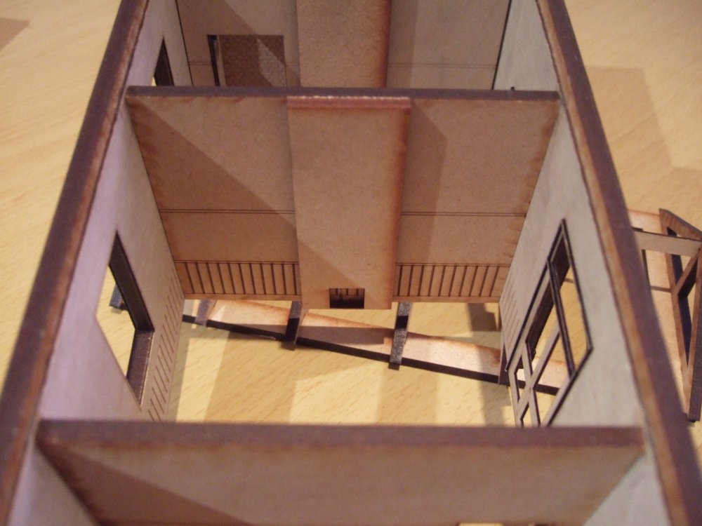

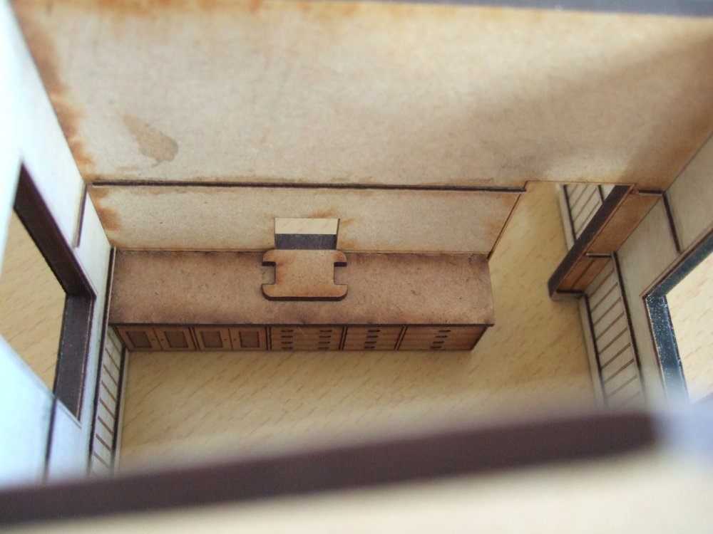

Irishrailwayman Posted December 20, 2019 Author Posted December 20, 2019 More progress on Camerton Station Building with internal skirting, dado and picture rails added! Ready for painting after which doors/windows will be added. 7
jhb171achill Posted December 20, 2019 Posted December 20, 2019 What sort of a kit is that? I presume laser cut wood? Looks very well. Is the detail printed on or is it low-relief? Presumably door frames can be painted in a suitable colour?
Irishrailwayman Posted December 20, 2019 Author Posted December 20, 2019 19 minutes ago, jhb171achill said: What sort of a kit is that? I presume laser cut wood? Looks very well. Is the detail printed on or is it low-relief? Presumably door frames can be painted in a suitable colour? Hi JHB, yes this is a laser wood product from timbertracks.co.uk - beautifully presented with section parts in separate bags and comprehensive instructions. They do a range of 4 mm and 7 mm products but are closing down and selling off their stocks at present. The detail is low- relief and the windows and doors need to be separately painted before fitting to the model. 1 1
jhb171achill Posted December 20, 2019 Posted December 20, 2019 Many thanks, irishrailwayman. Just looked them up - very nice stuff, albeit perhaps a little pricey. Pity they're closing, all the same - might order one or two items.
Irishrailwayman Posted December 20, 2019 Author Posted December 20, 2019 (edited) 40 minutes ago, jhb171achill said: Many thanks, irishrailwayman. Just looked them up - very nice stuff, albeit perhaps a little pricey. Pity they're closing, all the same - might order one or two items. Pricey yes but the kit fits together really well and are very well thought out with exquisite detailing. They are also extremely strong when built and should transport well to exhibitions etc in suitable boxes. I also have their cattle dock and a Goods Depot for Buffers Lock so I will detail in time how these are building up on this forum over time. Edited December 20, 2019 by Irishrailwayman 1

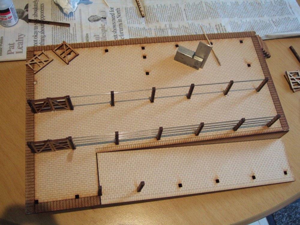

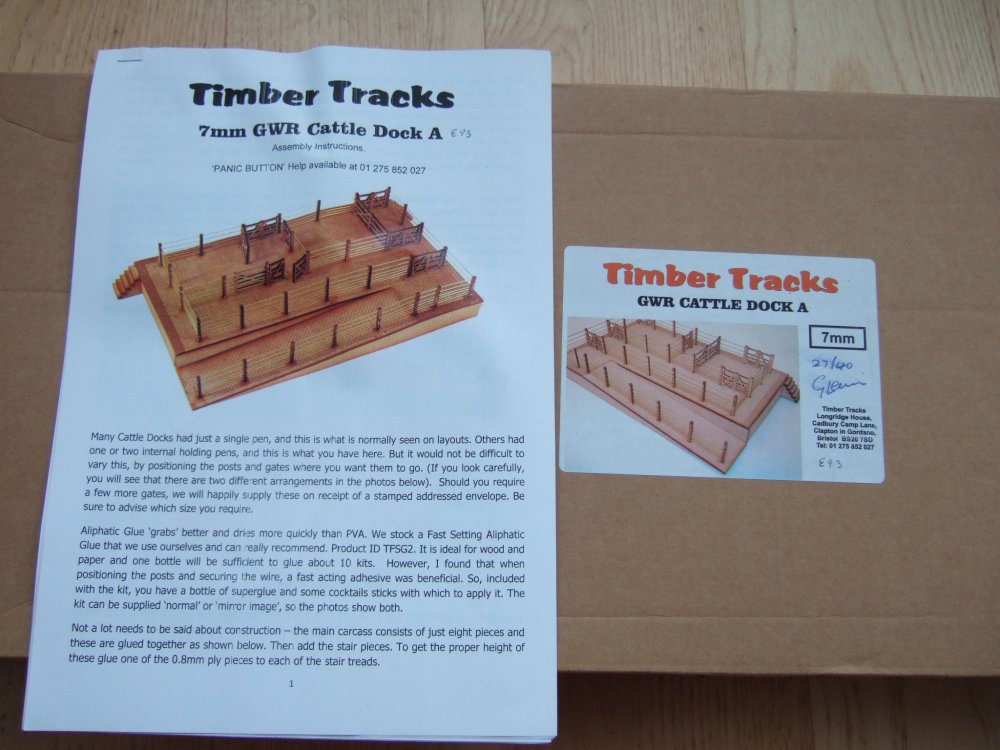

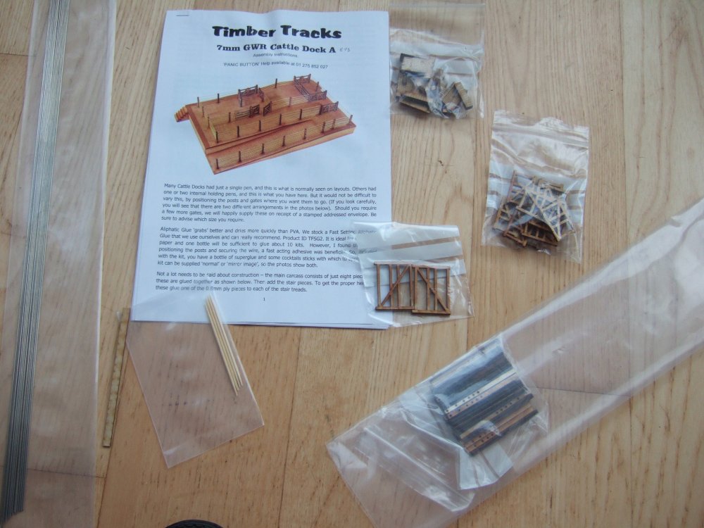

Irishrailwayman Posted December 23, 2019 Author Posted December 23, 2019 Starting work on the O gauge Cattle Dock from Timber Tracks. A simpler kit overall, nicely presented with parts in individual bags: 1

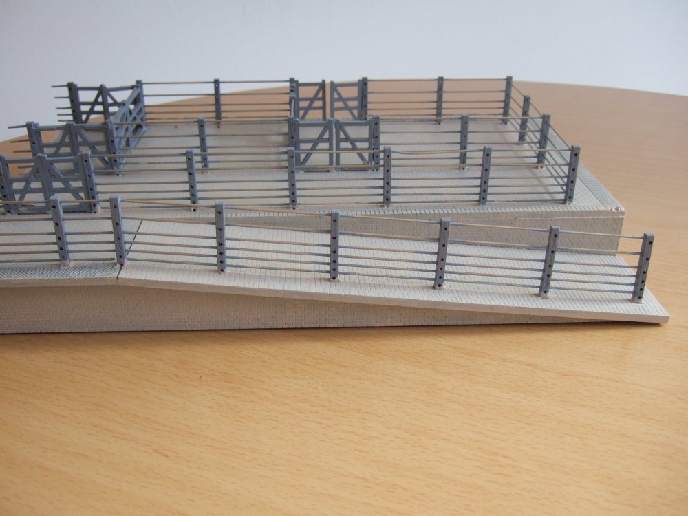

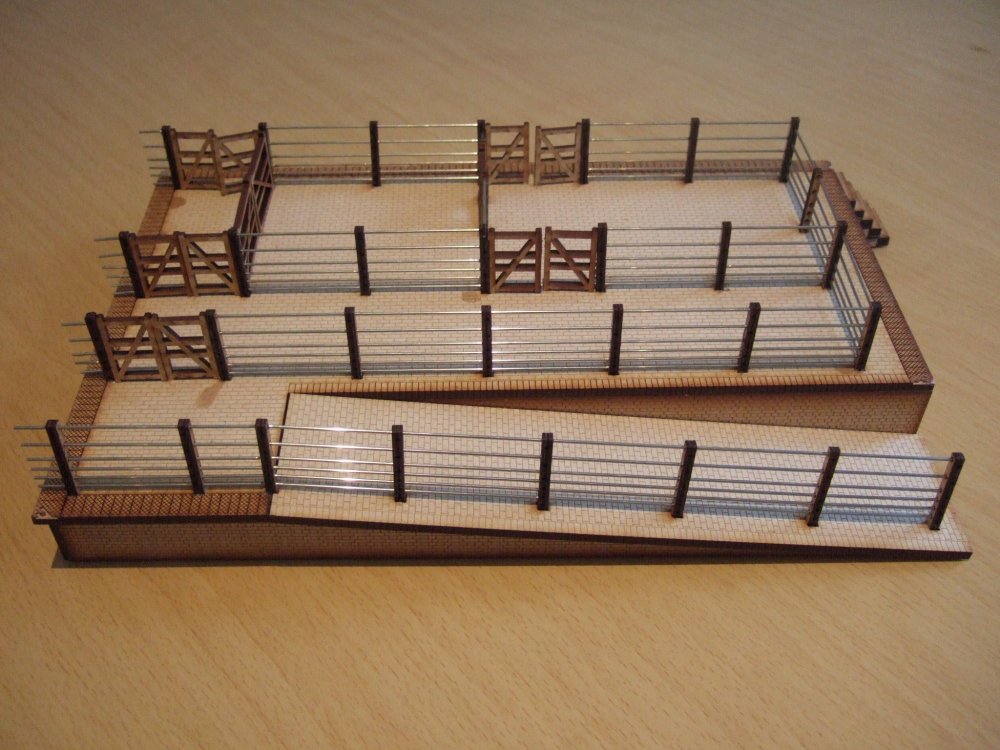

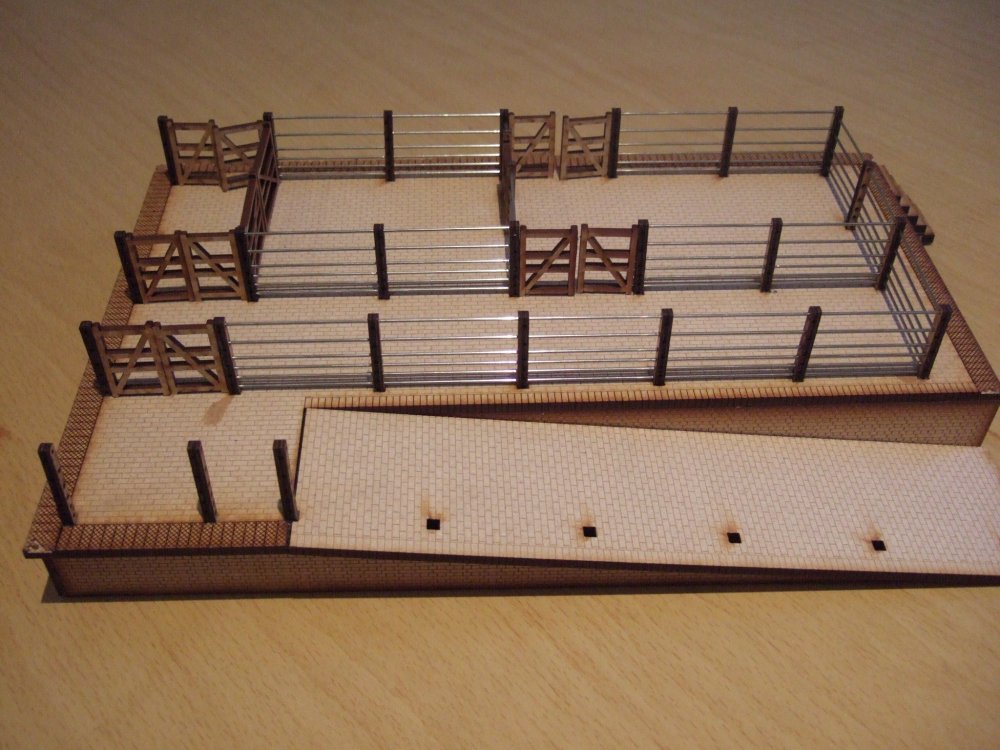

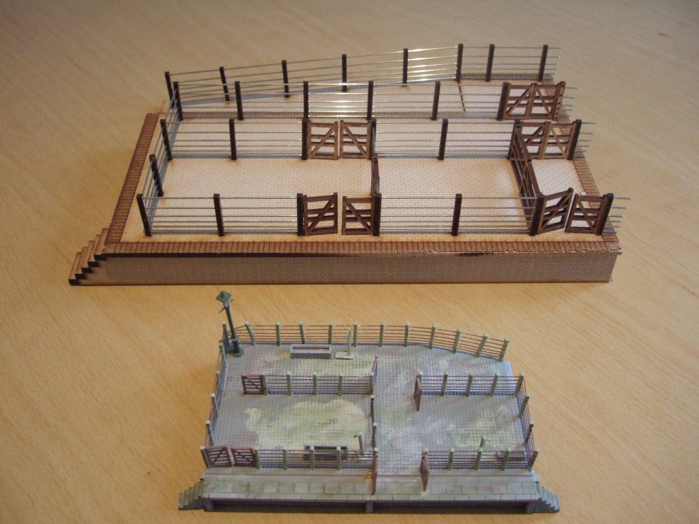

Irishrailwayman Posted December 27, 2019 Author Posted December 27, 2019 (edited) Good progress on assembling the cattle dock now ready for painting (OO model pictured for size comparison): Edited January 17, 2020 by Irishrailwayman Note re OO model 7

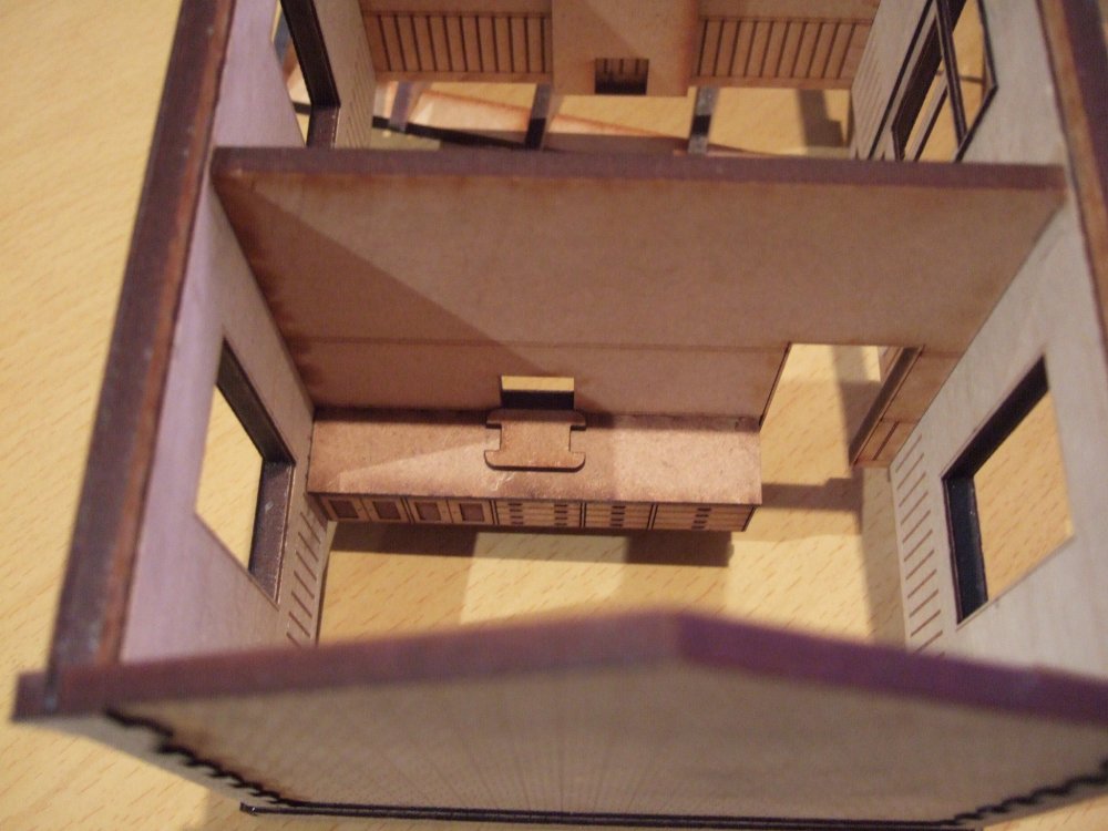

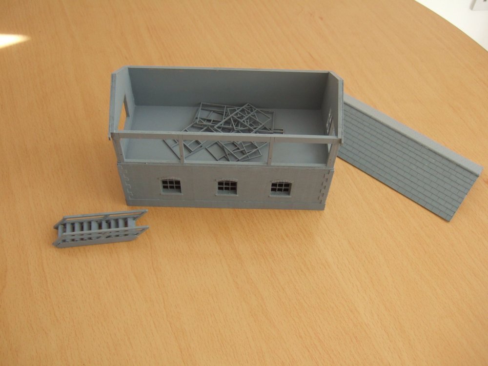

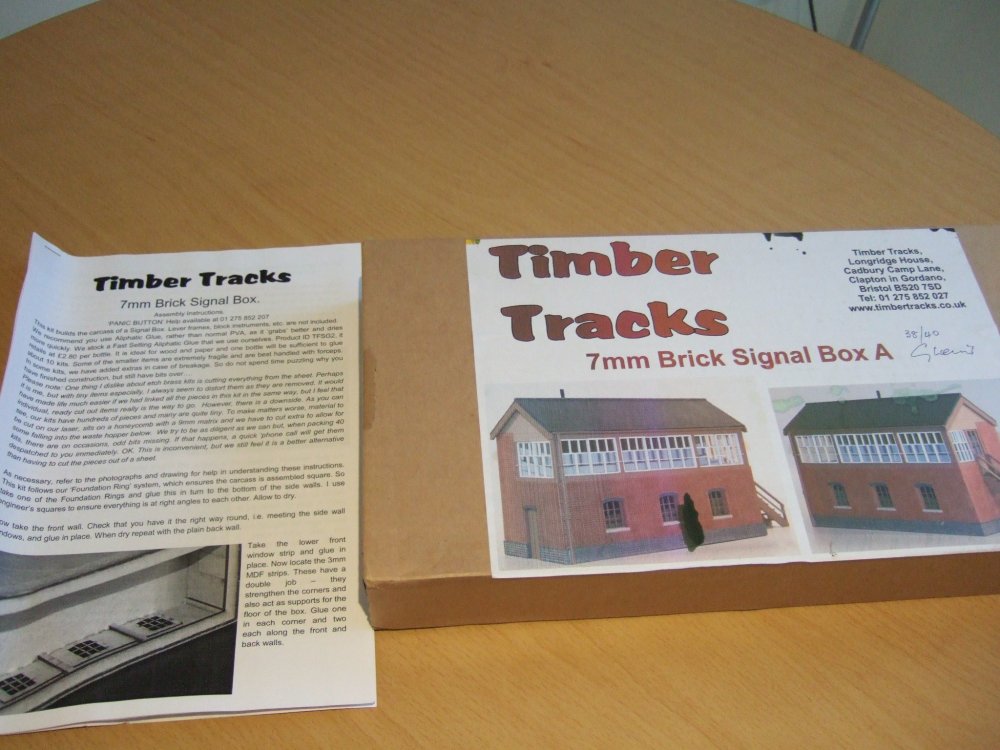

Irishrailwayman Posted January 11, 2020 Author Posted January 11, 2020 Started work on a Timber Tracks Signal Box kit to adorn Buffers Lock! The kit is presented as well as the others described above with good instructions and well fitting parts each group of which are supplied in separate bags for ease of identification. 3
Irishrailwayman Posted January 14, 2020 Author Posted January 14, 2020 Progress on that signal box: 3

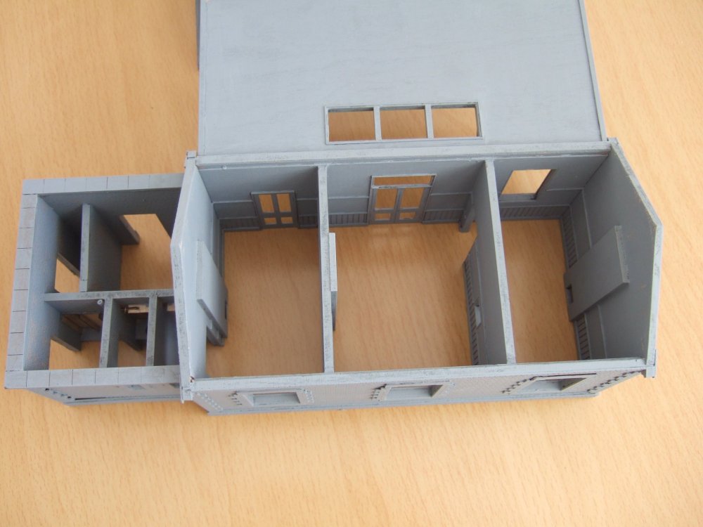

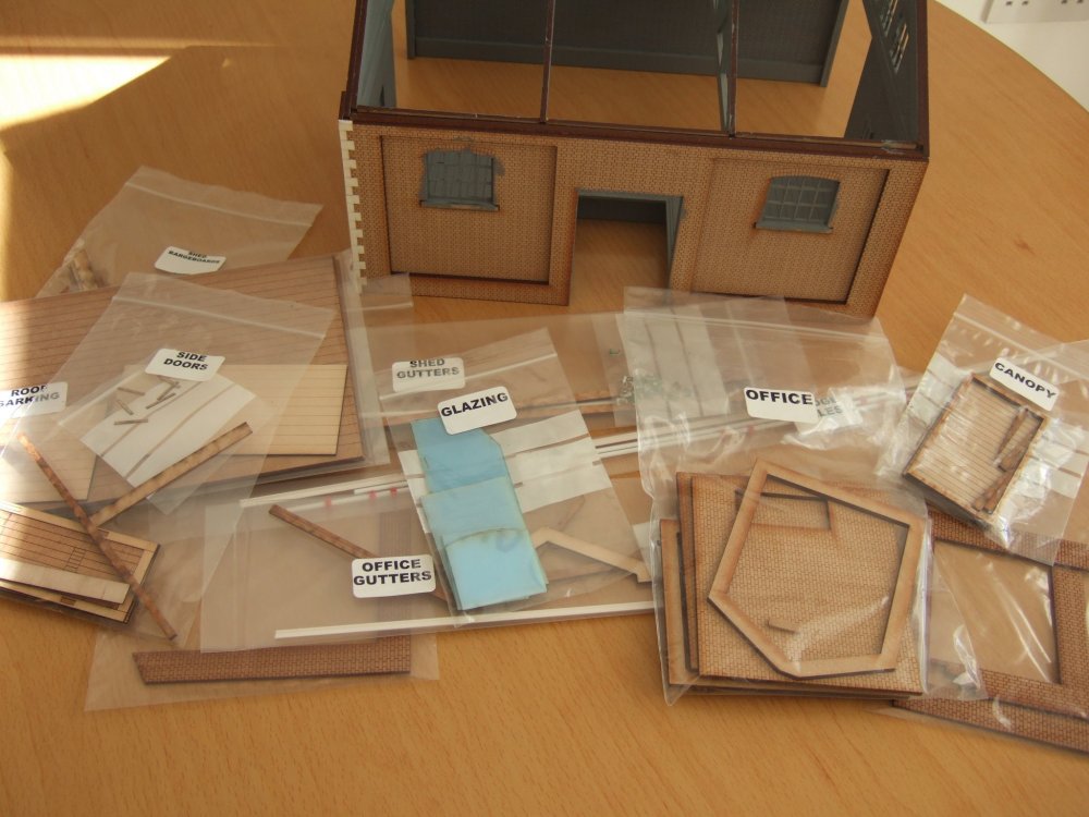

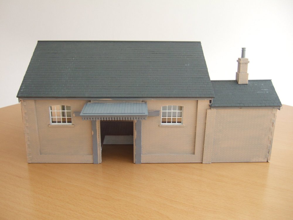

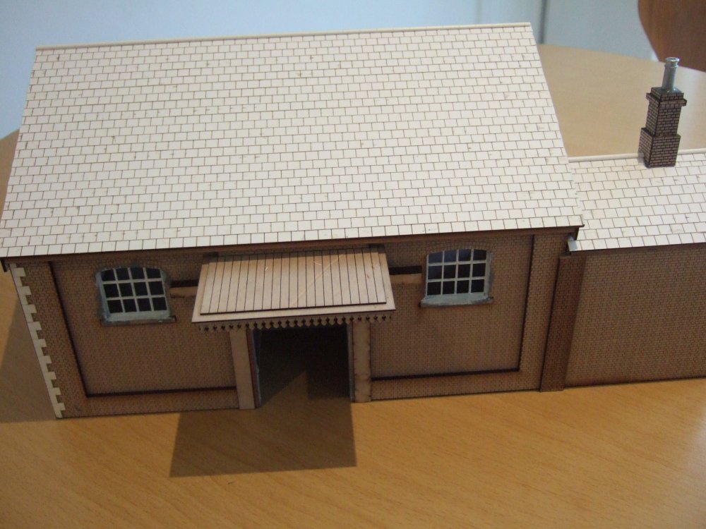

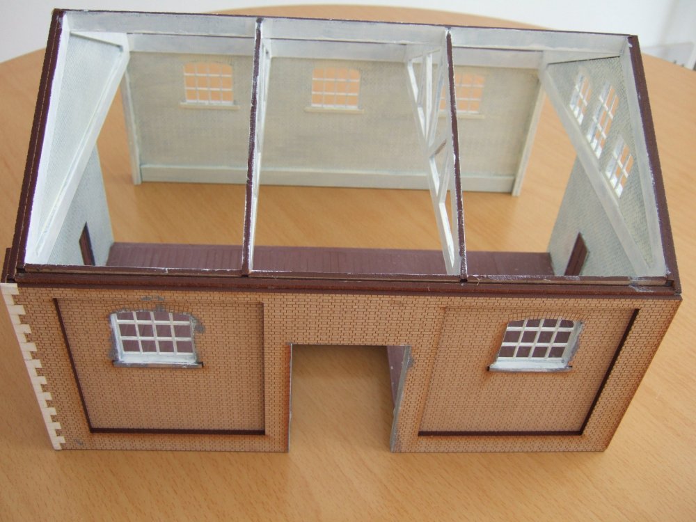

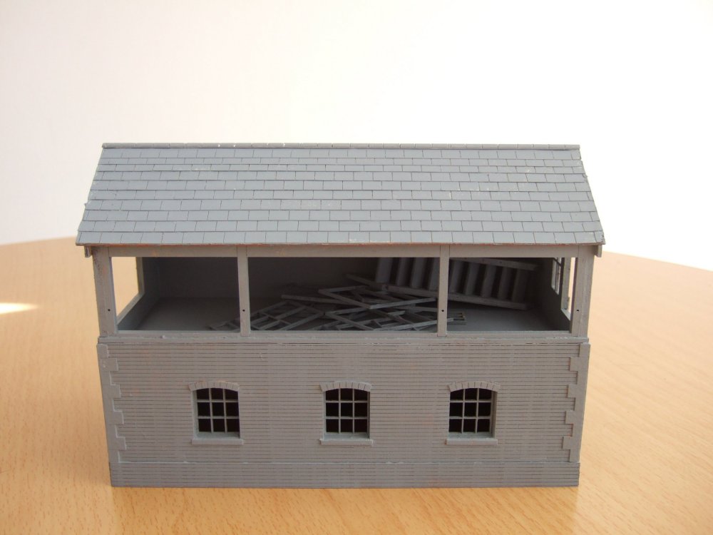

Irishrailwayman Posted June 2, 2020 Author Posted June 2, 2020 With the lock-down got time to undercoat some of the O gauge buildings underway: Also got time to start assembling and painting a Timber Tracks Goods Shed: 2

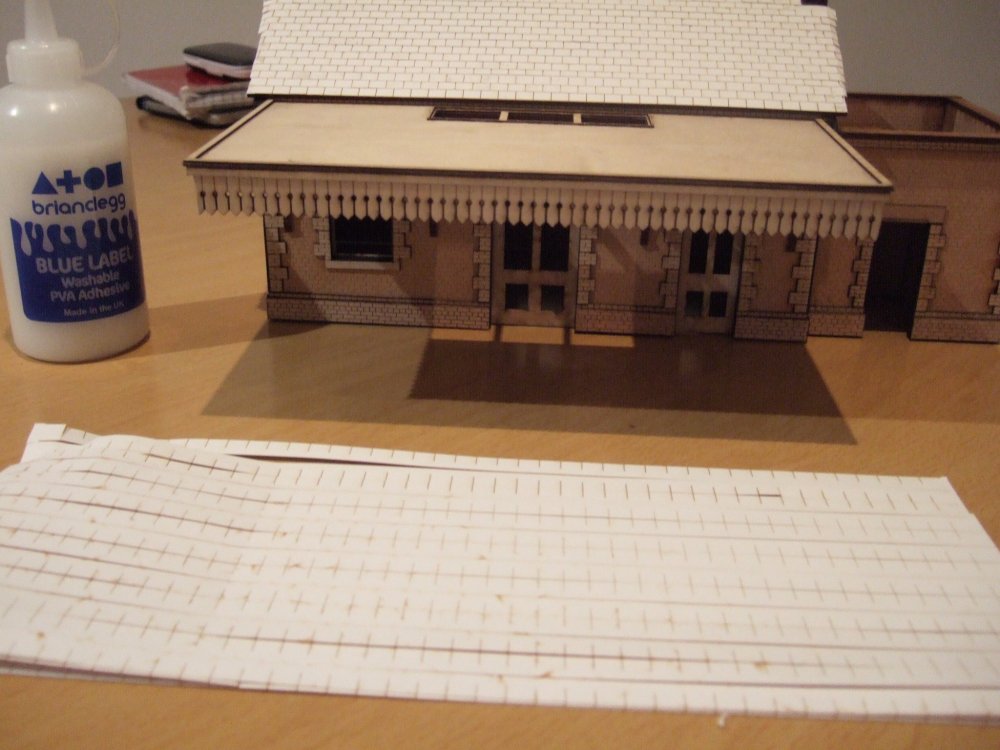

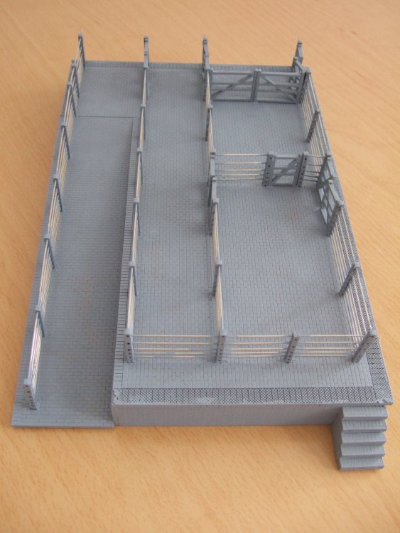

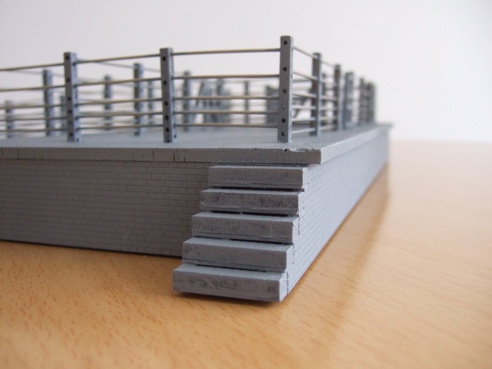

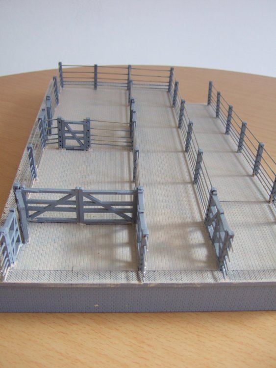

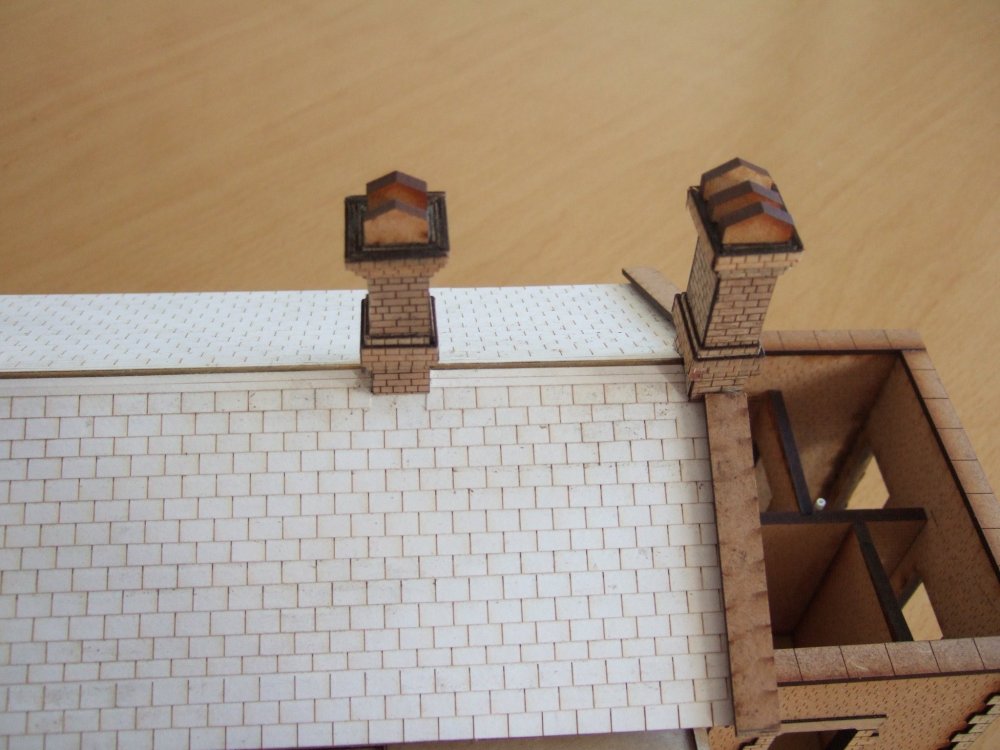

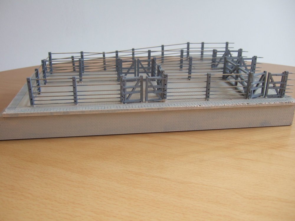

Irishrailwayman Posted June 10, 2020 Author Posted June 10, 2020 Timber Tracks Cattle Dock gets a coat of primer: Roofing strips added to simulate tiling on the Timber Tracks Goods Shed now ready for primer: 4 1
Noel Posted June 10, 2020 Posted June 10, 2020 Beautiful models. Love the cattledohck? Is that bound for LS? Do you mind me asking are they card, wooden, or plastic?
Irishrailwayman Posted June 10, 2020 Author Posted June 10, 2020 59 minutes ago, Noel said: Beautiful models. Love the cattledohck? Is that bound for LS? Do you mind me asking are they card, wooden, or plastic? Thanks Noel. These are laser-cut wood kits from Timber Tracks which are beautifully presented and straightforward to assemble with their fast-setting wood glue. They are amazingly strong when complete. These models are destined for my new O gauge steam outline layout "Buffers Lock" which is in planning - a cross between my "Shunters Yard" and "Diesel Depot"! The boards and wiring will be done to the same high standards as "Little Siddington". The idea is to have an interesting O gauge layout that can be set up quickly for play at home/clubroom and easily transported in two cars to exhibitions. 1 hour ago, Noel said: Beautiful models. Love the cattledohck? Is that bound for LS? Do you mind me asking are they card, wooden, or plastic?

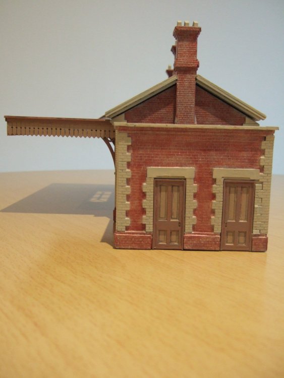

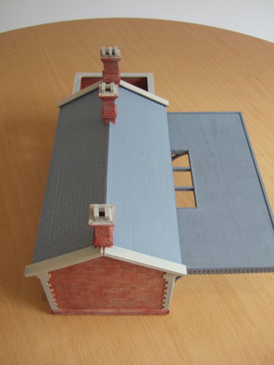

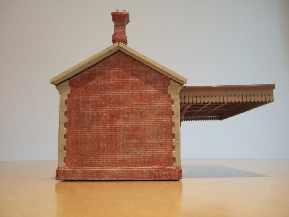

Irishrailwayman Posted June 17, 2020 Author Posted June 17, 2020 Started painting the station building using a base-coat and dry-brush technique with the base-coat showing through as the mortar! 4 1

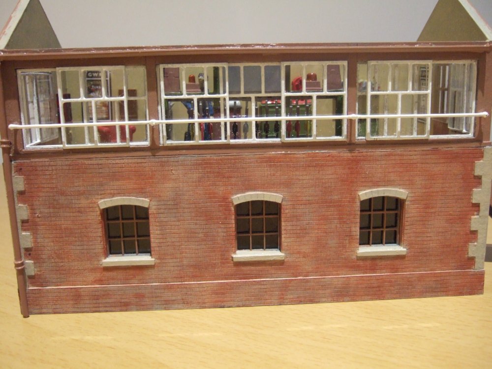

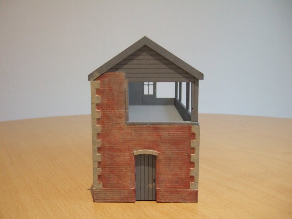

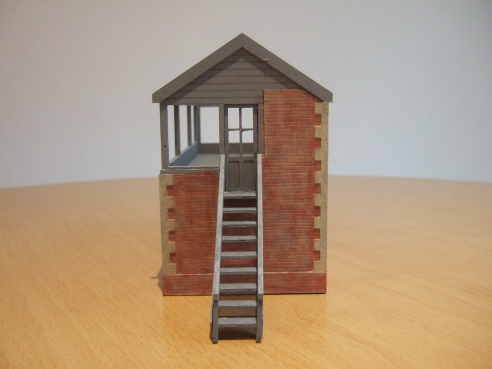

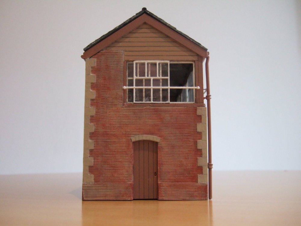

Irishrailwayman Posted June 18, 2020 Author Posted June 18, 2020 Buffers Lock signal box gets the dry brush treatment on its brickwork to match the station building: 1 2

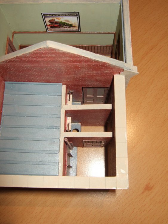

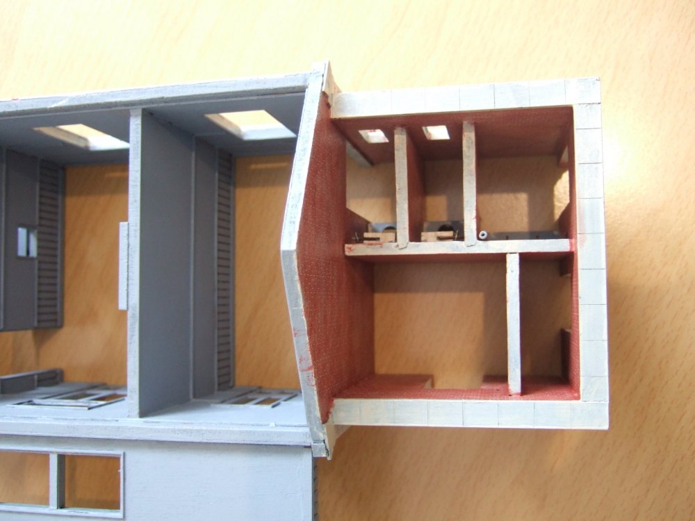

Irishrailwayman Posted July 8, 2020 Author Posted July 8, 2020 "Buffers Lock" station building is now virtually complete apart from some weathering and details. Note extensive interiour detailing including toilet areas! 5

Irishrailwayman Posted August 23, 2020 Author Posted August 23, 2020 The Goods Shed and Cattle Dock have been given their undercoat of Humbrol 121 prior to dry-brushing with red brick colour: 2
Irishrailwayman Posted August 29, 2020 Author Posted August 29, 2020 The Goods Shed has had it "dry-brushing" with red brick colour leaving the "mortar" colour showing through: 1

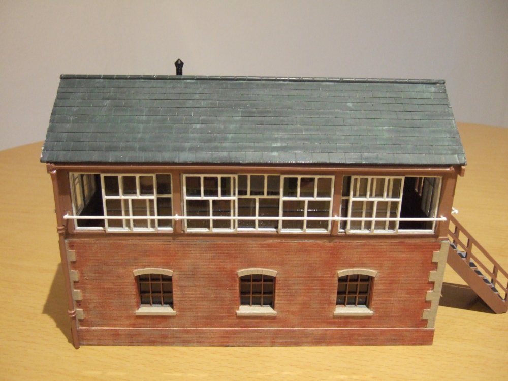

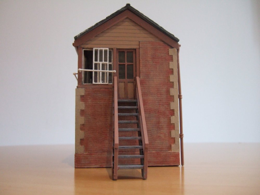

Irishrailwayman Posted September 2, 2020 Author Posted September 2, 2020 Signal box exteriour complete interiour details underway: 5 2

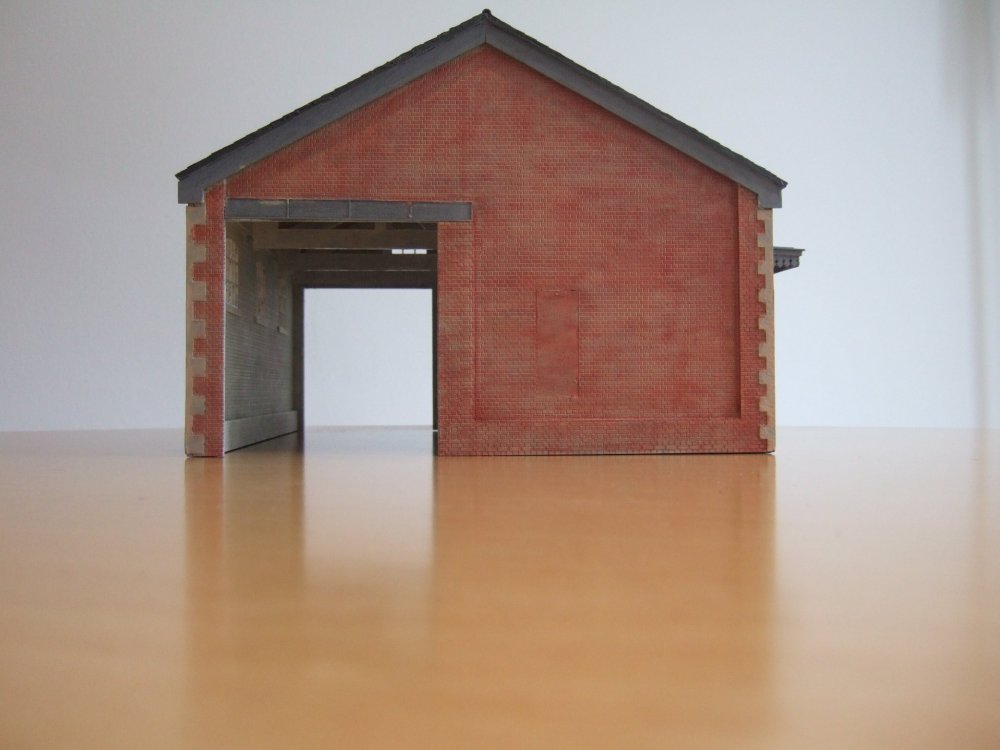

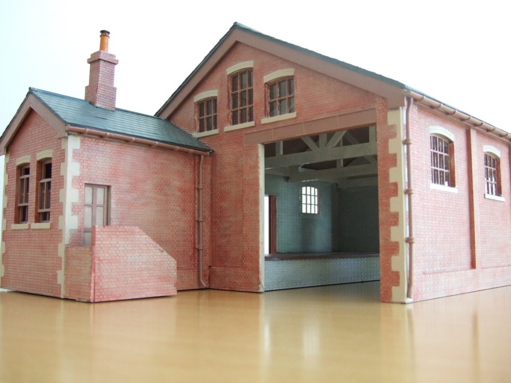

Irishrailwayman Posted September 5, 2020 Author Posted September 5, 2020 The Goods Shed is now complete: 4
popeye Posted September 5, 2020 Posted September 5, 2020 Very nice, how about a little bit of dirt here and there? 1
Irishrailwayman Posted September 11, 2020 Author Posted September 11, 2020 Signal box interiour now completed: 2

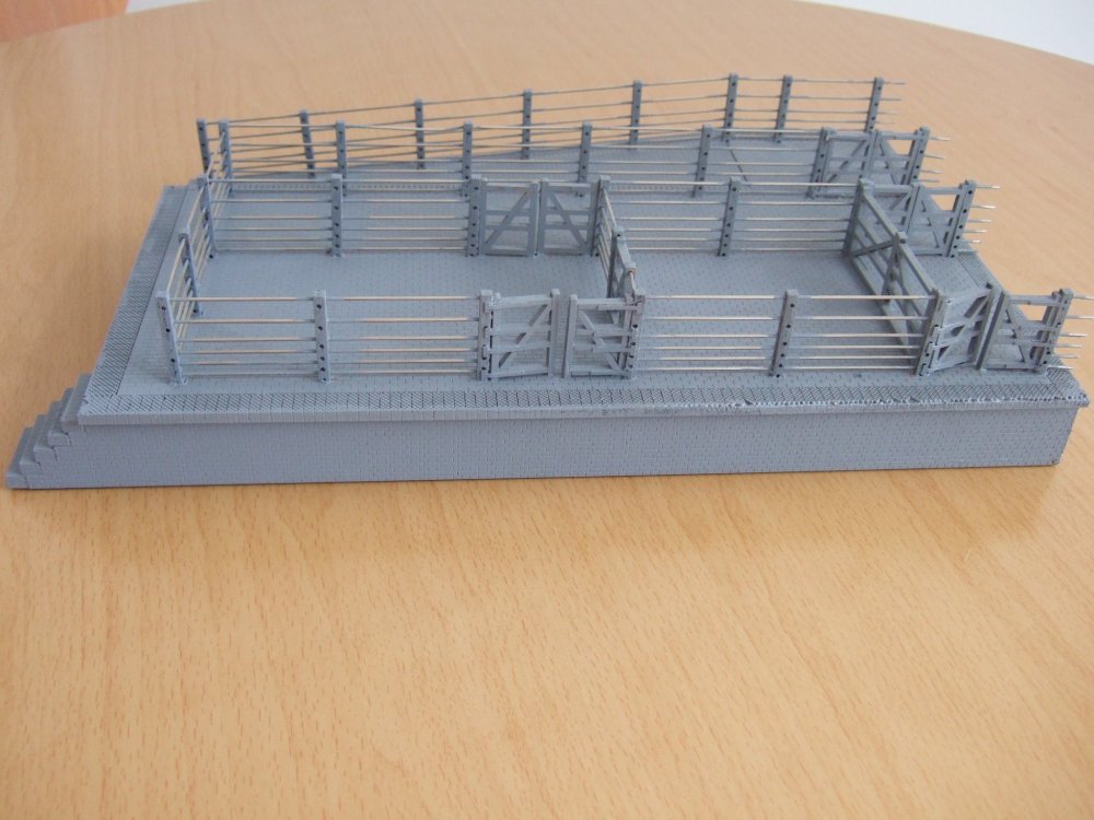

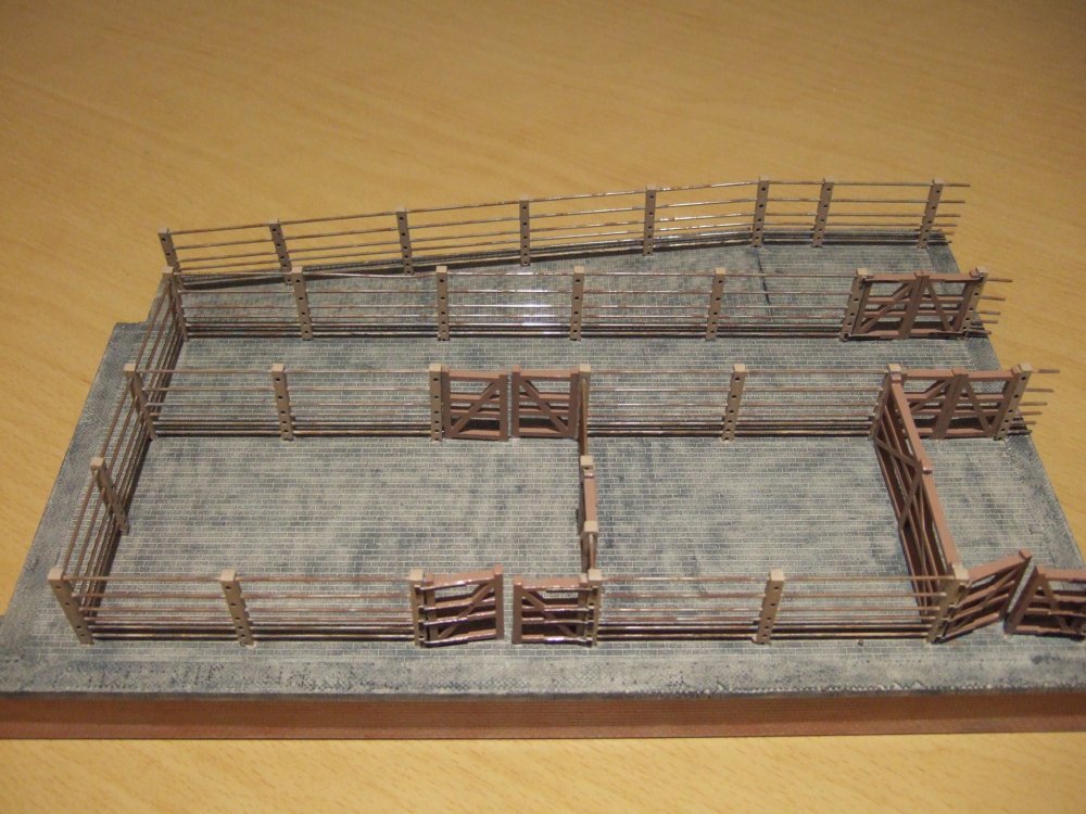

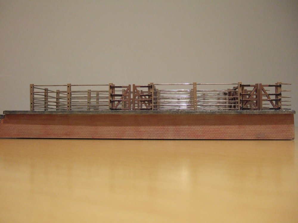

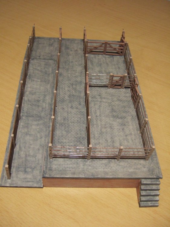

Irishrailwayman Posted September 20, 2020 Author Posted September 20, 2020 Timber Track's cattle dock painted and now complete: 3

TimO Posted February 7, 2021 Posted February 7, 2021 Another very interesting thread. Have you used Humbrol paint for the red brick? It looks quite light in colour on here, is that what you planned or is it darker in reality? The signal box looks very large for a twelve lever frame. The directors must have been in generous mood the day they signed that one off! Love the interior detail. As others have said your buildings are perfectly constructed and look fabulous, I am sure I’m not the only person on here that is eagerly awaiting your track plan.

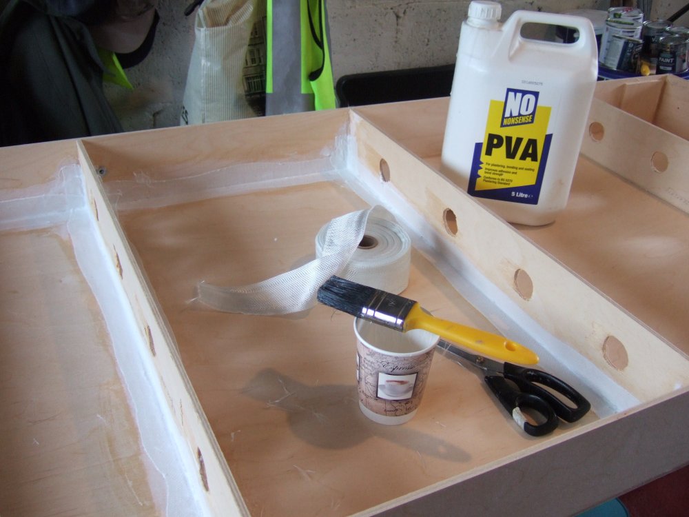

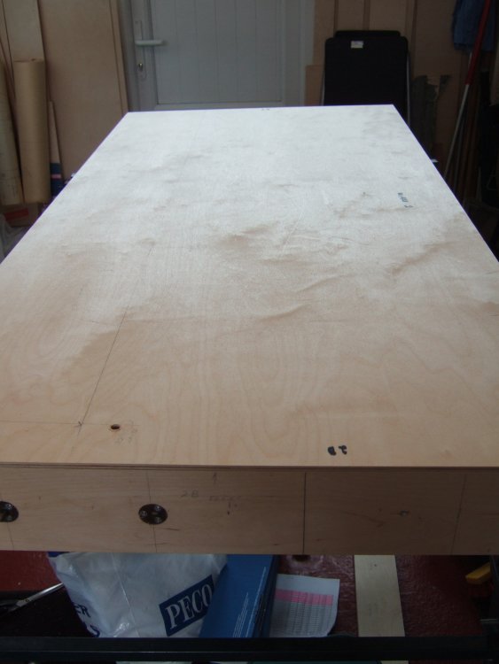

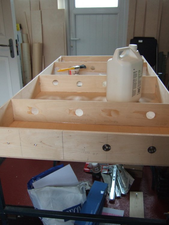

Irishrailwayman Posted May 9, 2021 Author Posted May 9, 2021 I have started on the first (of two) baseboards for "Buffers Lock" at last. This is approx. 4.5 feet by 2 feet. Construction is by the now well tried method developed at Wexford MRC: 6 mm birch plywood (precision cut by Woodworkers in Dublin) sections are hot glued together on a dead-flat workbench then glass fibre tape is glued in place at all intersections underneath with builders' PVA for strength. Two 6 mm sections are glued together with wood glue for the face sections and precision dowels added. T-nuts are added to enable back-scenes, baseboard covers etc to be assembled easily and rapidly at exhibitions. 2
