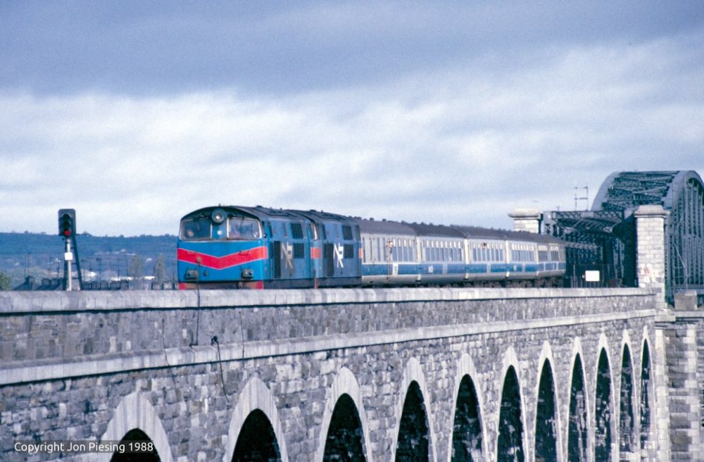

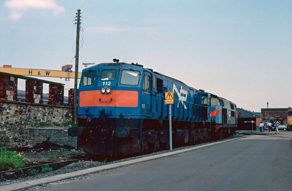

As suggested in the many answers, the yellow panel came with the darker blue, with the red / orange before that on the light blue.
This was never actual RED, as such. What it was in reality, was a "day-glo orange", which like its equivalent on the fronts of many (but not all) IE locos, often looks red in photos when clean and new, but which faded to a more orangey colour in a relatively short space of time. Thus, there was not a distinct "red" and "orange" - as in separate colours at different times; it was the reddish-hued dayglo orange fading, and doing so a great deal quicker than its adjacent blue paintwork did.

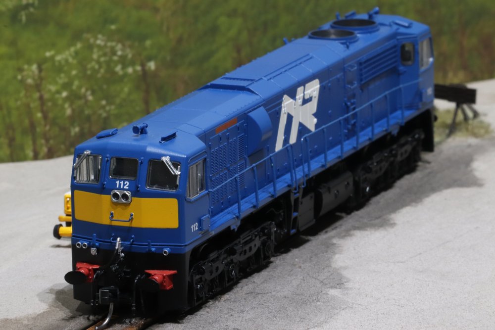

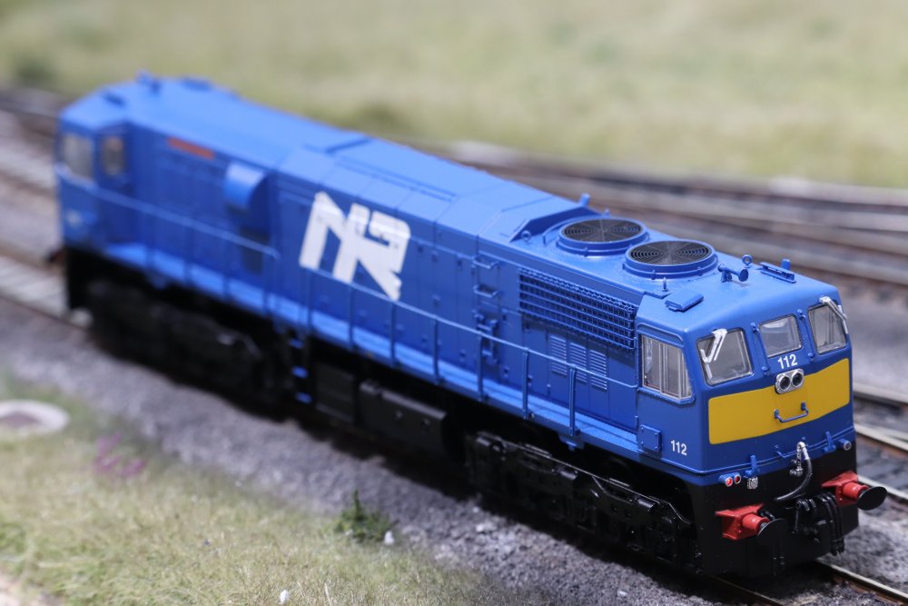

Was that MM0112 and MM0113 merged together to form that particular type in the photo or how did you achieve it? A release of this livery variant by MM would be epic right about now.

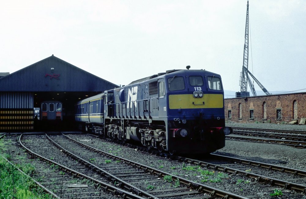

111 liveries - Its all quite simple-ish. Keep in mind theres 1 livery that Murphys didnt do, and its unusual that he didnt do it.
Theres only 2 basic liveries, granted the second one has been modified over the last 30 years but the basics are the same almost
As delivered - light 1978 blue with orangeyreddy ends and 'stencil' NIR logo
111 - 1981-1989 (as produced by Murphy Models)
112 - 1981-1992
113 - 1984- 1989

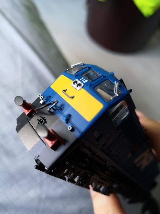

Second Livery - darker blue with yellow ends, and chunky NIR logo - not modelled by Murphy Models, the only gap in the 071/111 range....
111 - 1989 - 2010 (approx)
112 - 1992 - 2003
113 - 1989 - 2003 (approx)
Later changed with larger warning panel and larger LED lights along with '8' prefix on the number, (112 still has not got it so its still 112) 8111 and 8113.
8113 also spent a time running around with its NIR logo on the side missing

Everyones fave, 112 while on long term loan to IE - 2003 - 2006 - (as produced by Murphy Models).
Look closely to see its missing the IE drivers window frames. Was repainted in 2006 in the same livery but slightly different, main change being the name plates are now red/white with red text. Still has the IE window frames

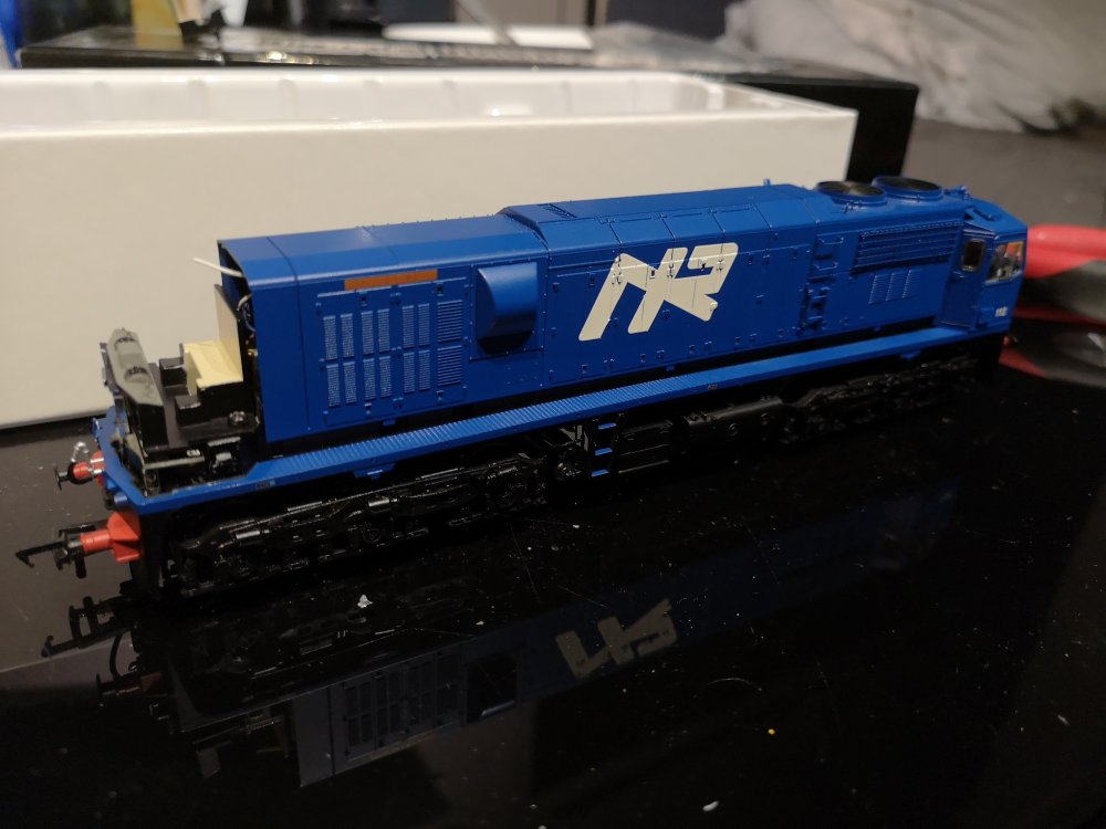

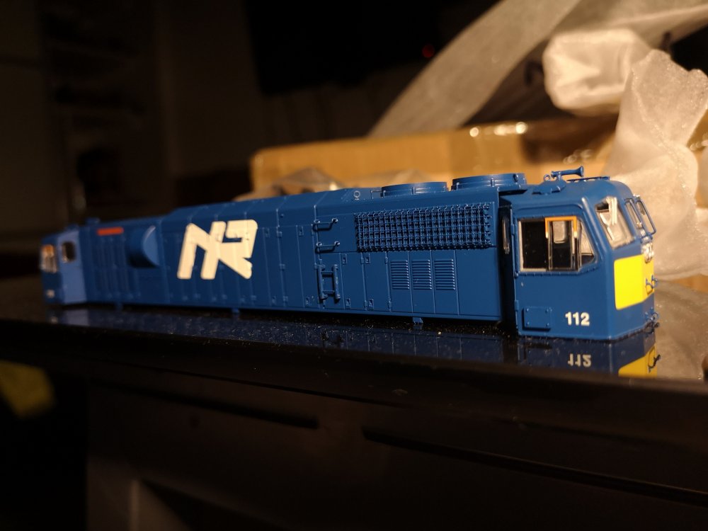

The ebay listing is offering a choice of either 112 or 113, but neither of these are suitable for hauling the NIR Mk.2's as they depict a mid-2000's livery variation for 112 and 113. The correct 1990's livery was never released by MM and can only be achieved either by a repaint or merging the top of MM0112, the bottom and glazing from MM8113 together to depict a 1990's version, which makes for a very expensive project at current prices.
Dont forget you also end up with 8113 in mid 2000's onwards condition with LED lights. If you want to be really strict a dab of red onto the sides of the light clusters
