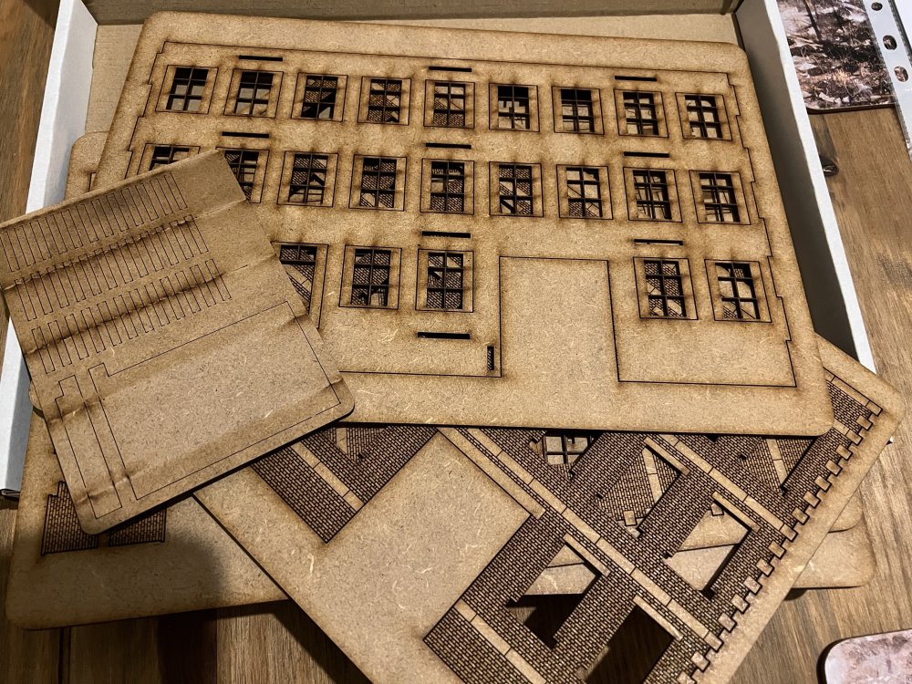

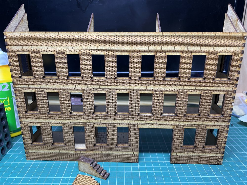

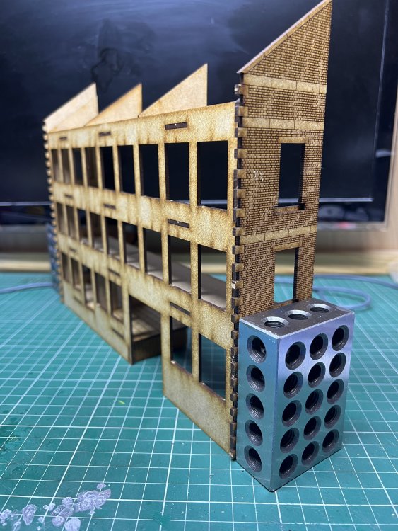

First up is a new kit, yes there will be a few of them as well, that I picked up at the Manchester exhibtion in 2023. The JS Models warehouse kit. This is going to go on a future project that i have in mind and thought it would be a good place to start. Made a start on cutting out the windows and and side parts ready for gluing
And yes the eagle eyed amougst you will have notice.......... I decided to do this on a leap year!!
Edited by Si2020
  • Like 7
Day 2 of the crazy idea.
Put most of the main frame together for the warehouse and its seen here waiting for the glue to dry.

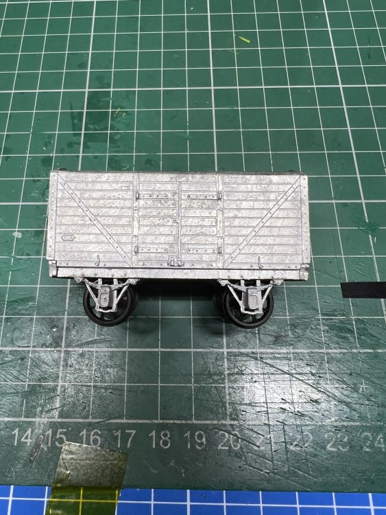

So first up on Day 4 is a white meatl kit for a L&YR sliding roof van. Can't remember off the top of my head the Dia number but I think its a 10 ton one. May be wrong on that one.

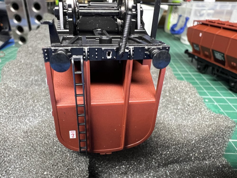

Day five,  I made a start on installing the instantor couplings on some COVHOPS and gain hoppers.

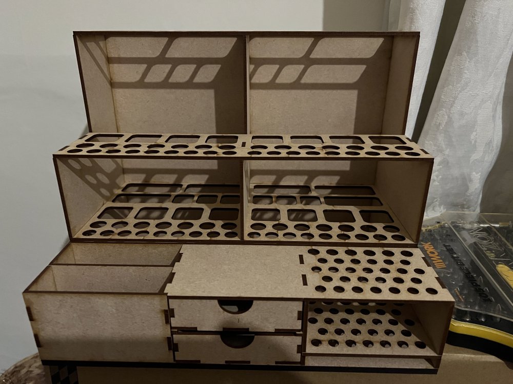

Next up has been this wire and rod holder. Up till now Ive been using a plastic box to keep the various packets of wire and rod in and its always been a bit of a mission to locate the wire that I need as its always the last packet you come across. So whilst at the Manchester show I got one of these to keep everything more organised and make it easier to know when stocks are running low to give chance to get more supplies.

On 14/1/2024 at 4:56 PM, Broithe said:
Good move!
"There's no point keeping stuff that you can't find".
Also stops the over ordering/lack of wire. I go from having so much .45 wire in stock to having none at all and this will mean I can keep an eye on it.

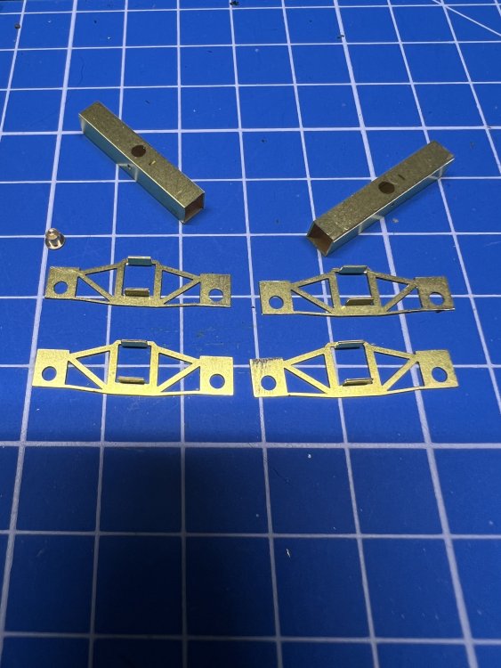

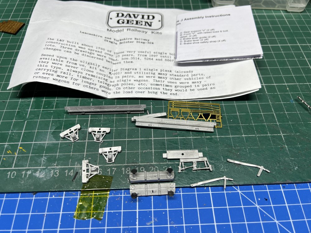

So the next wagon up is a L&YR single bolster Dia32a for a David Geen kit.  This will be run as a single empty wagon for trips to the yard on Wainthrop Bridge. I will be updating the brake gear as I find the white metal stuff is to thick for the rodding and blocks, so I will be fitting some etched parts along with some brass bar and some 3d printed brake blocks. Well thats the plan.

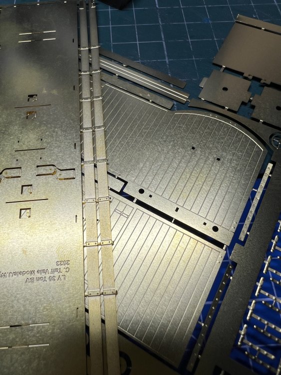

A couple of new kits arrived and as I have a show in April with Wainthrop Bridge I thought I would make a start on them as the one item I'm missing is a bogie van.
With most rolling stock I always start with the wheels first as then I can make sure that all the cleanaces are good.

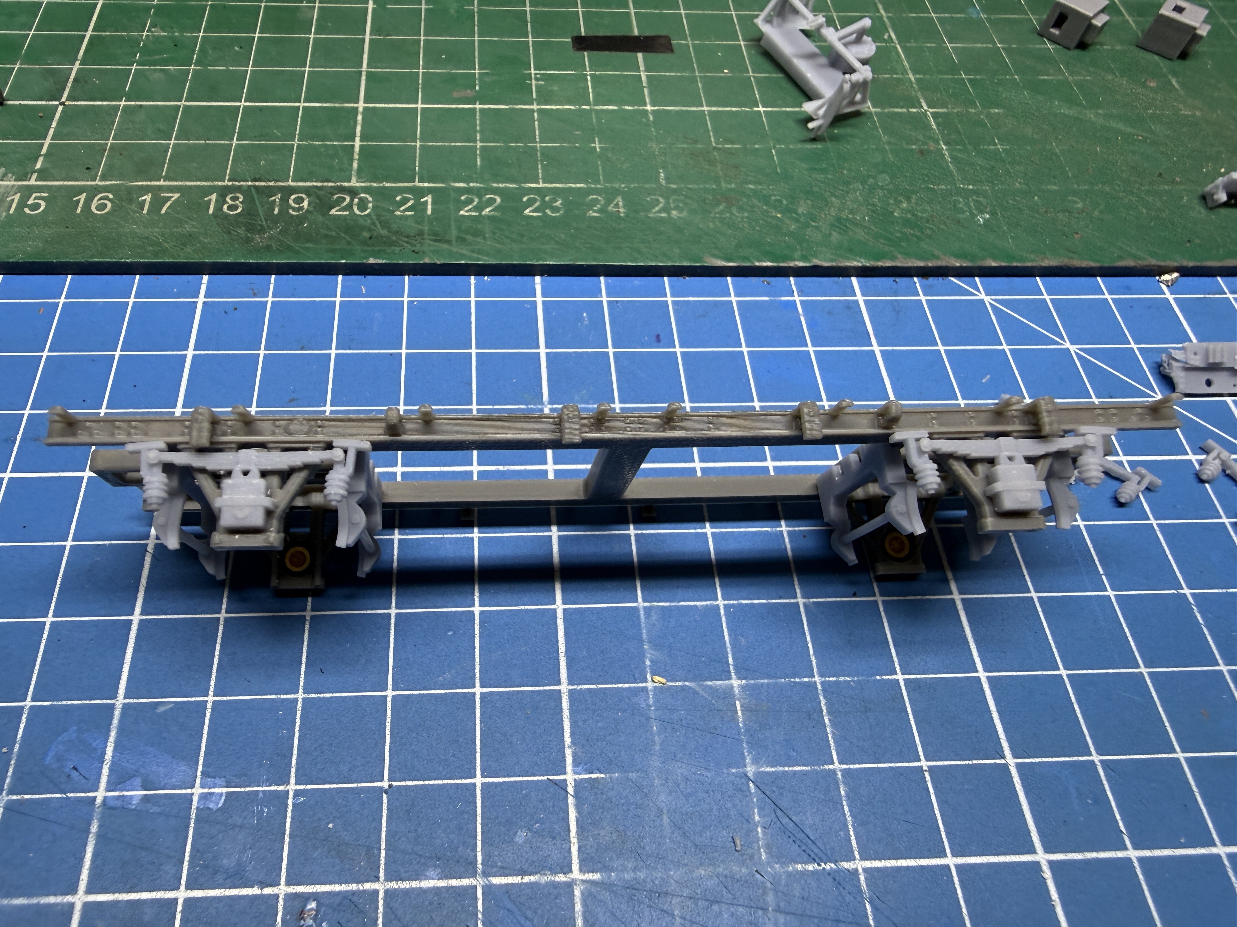

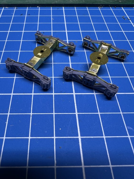

After a bit of work with the bending tool and the soldering iron the 3d printed side frames where added. They will need a bit of work as they are bowed

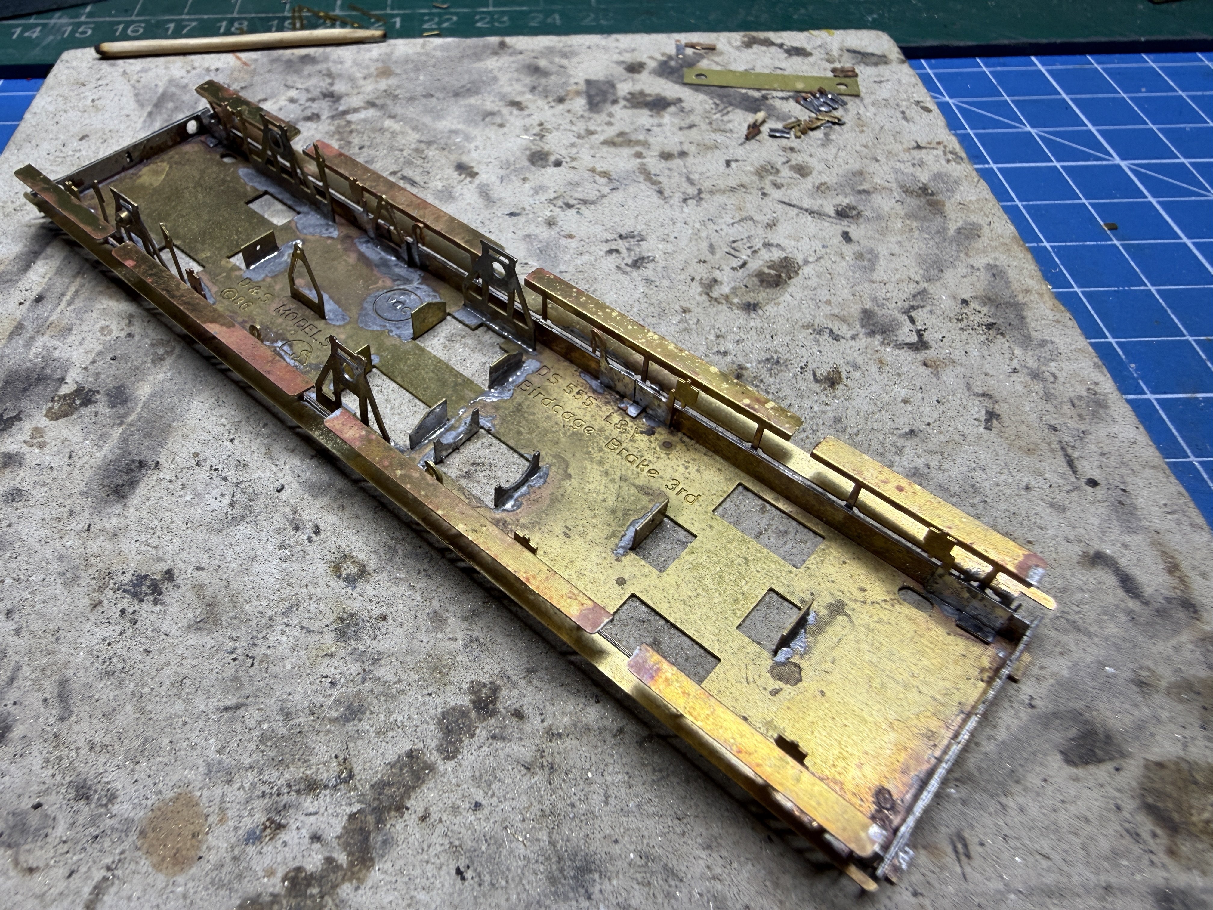

Did a bit more on the chassis. I had hoped to get the chassis fully done in the time i had at the bench that day but due to the slots and tabs not fitting together and after a bit of file work, I finally got the solebars to sit flush and the floor straight.

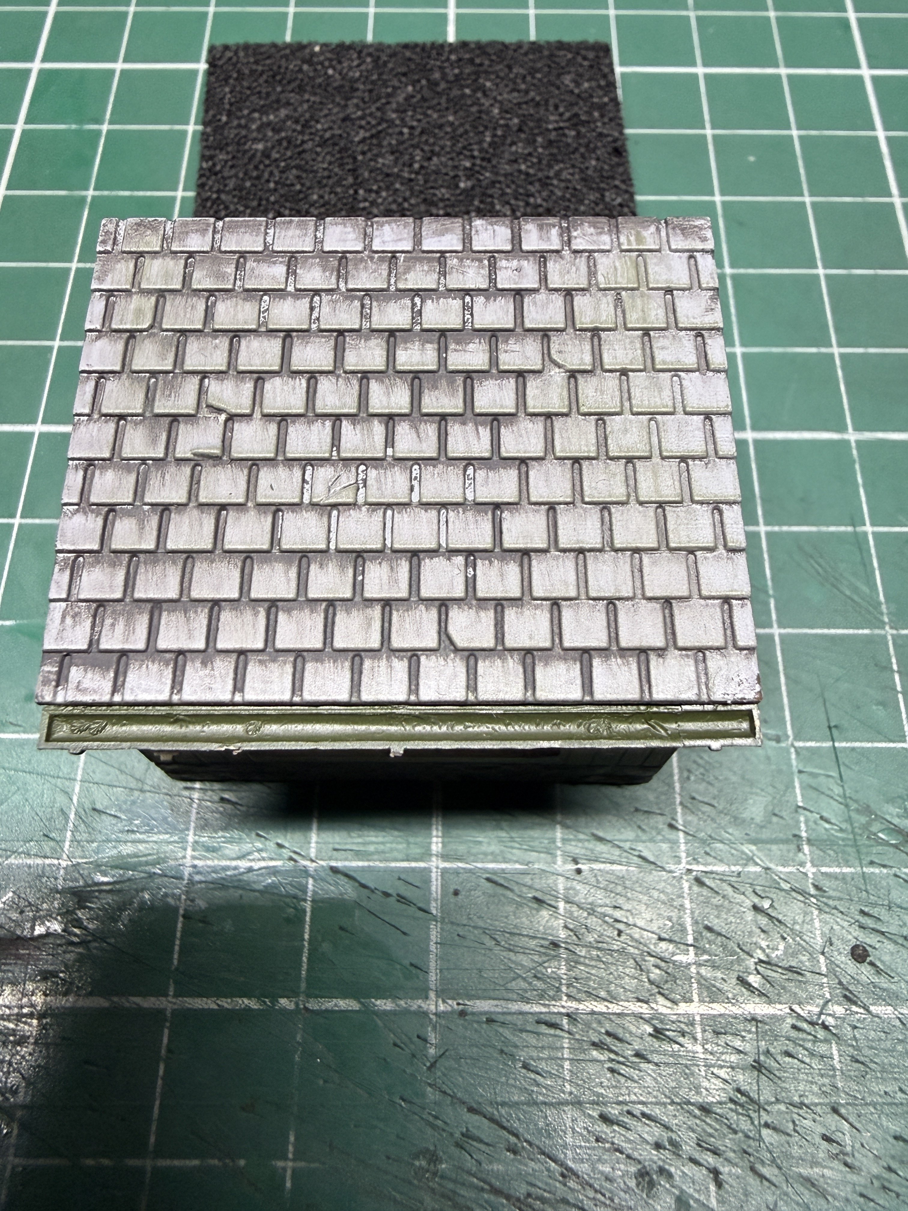

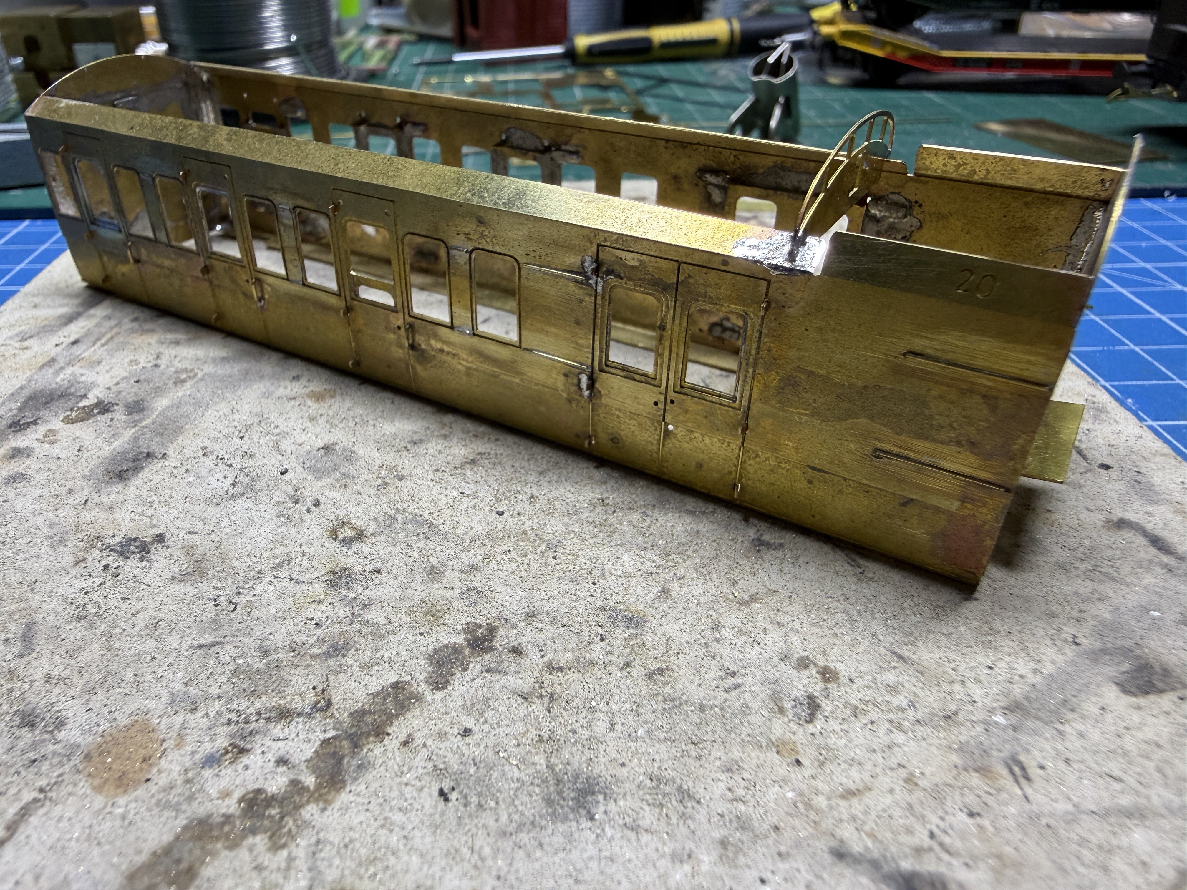

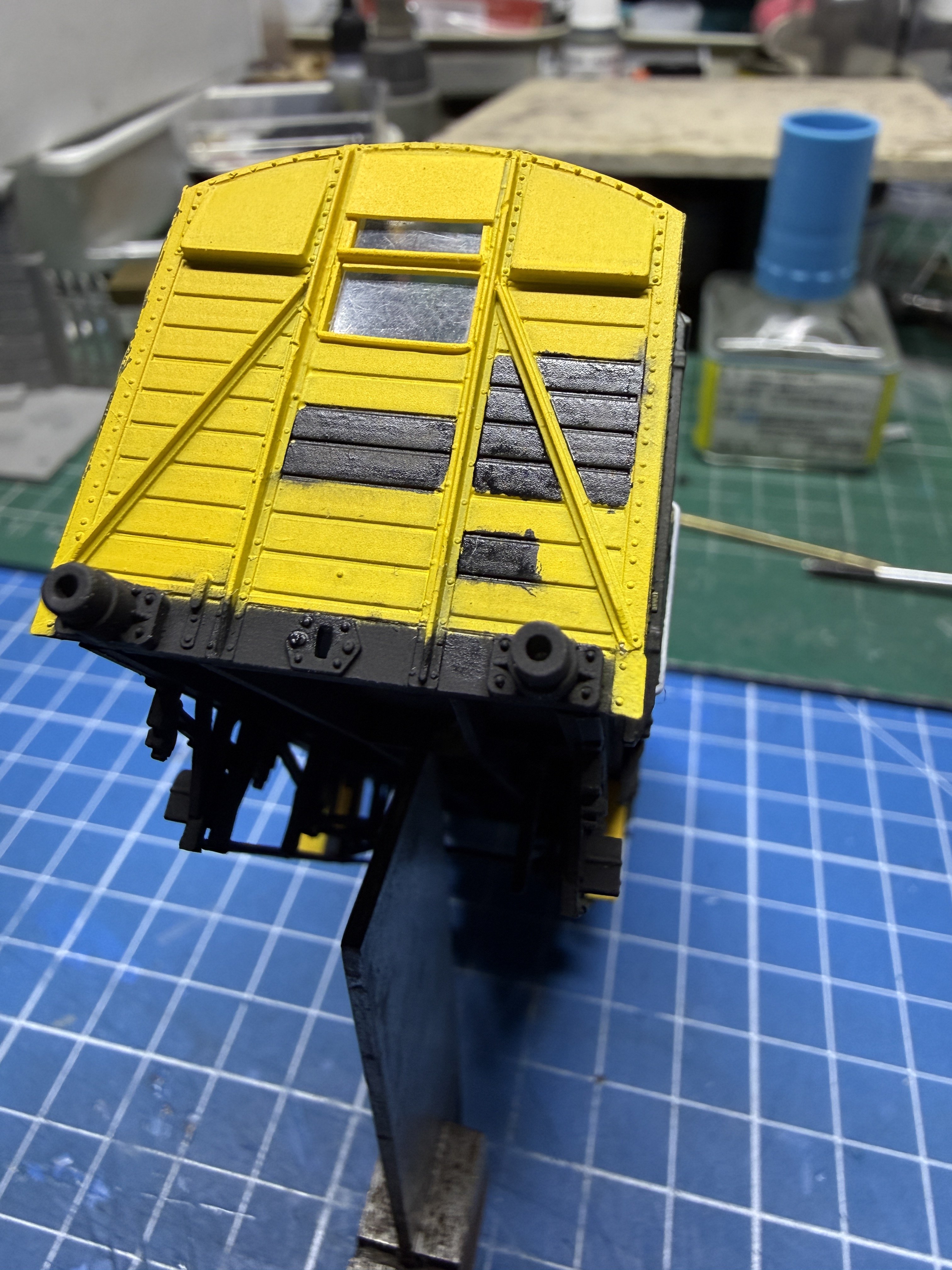

Progressing along with the 30T L&YR van. Body has been soldered together and test fitted on the chassis.

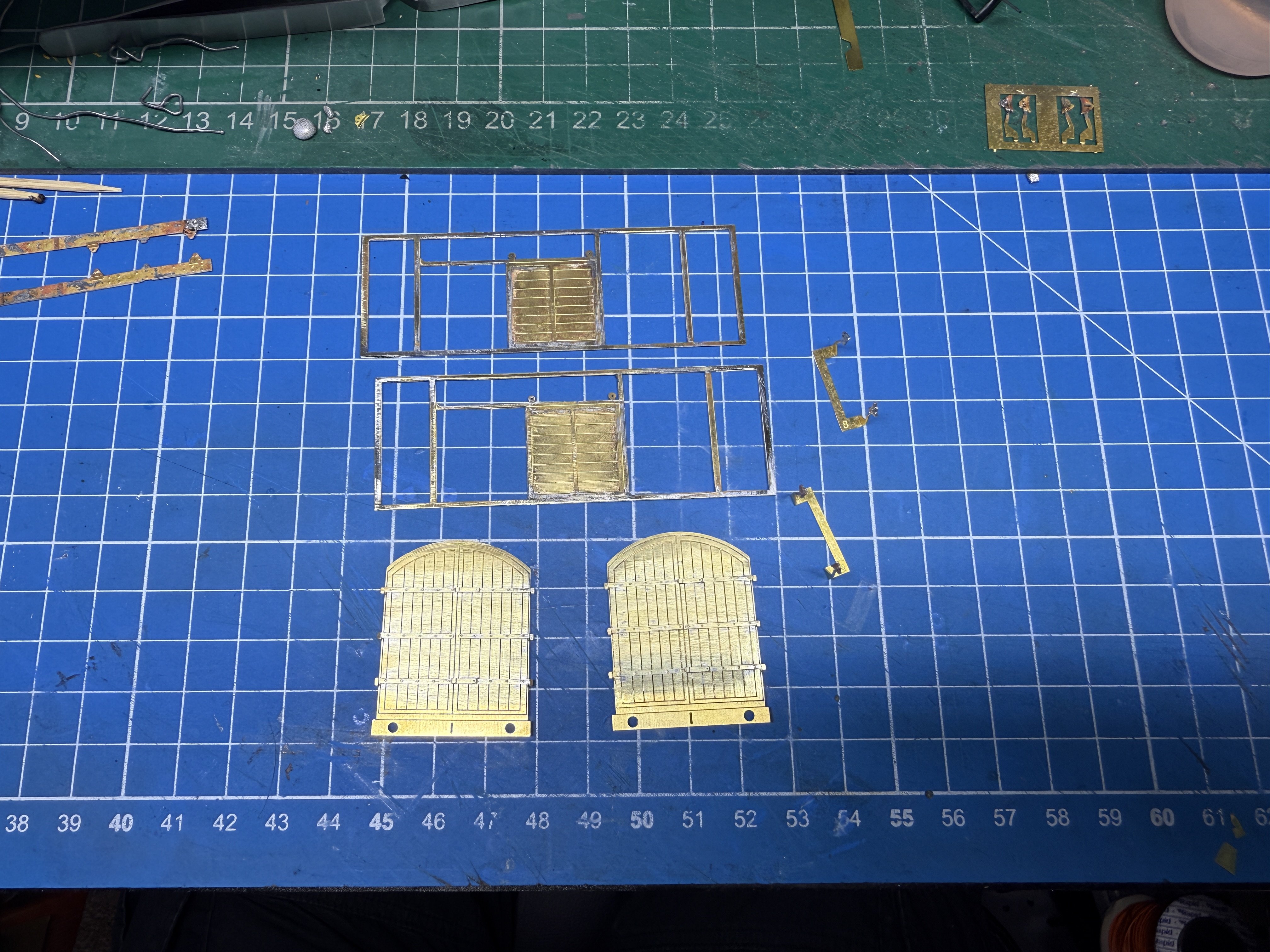

The door hinges were fitted next

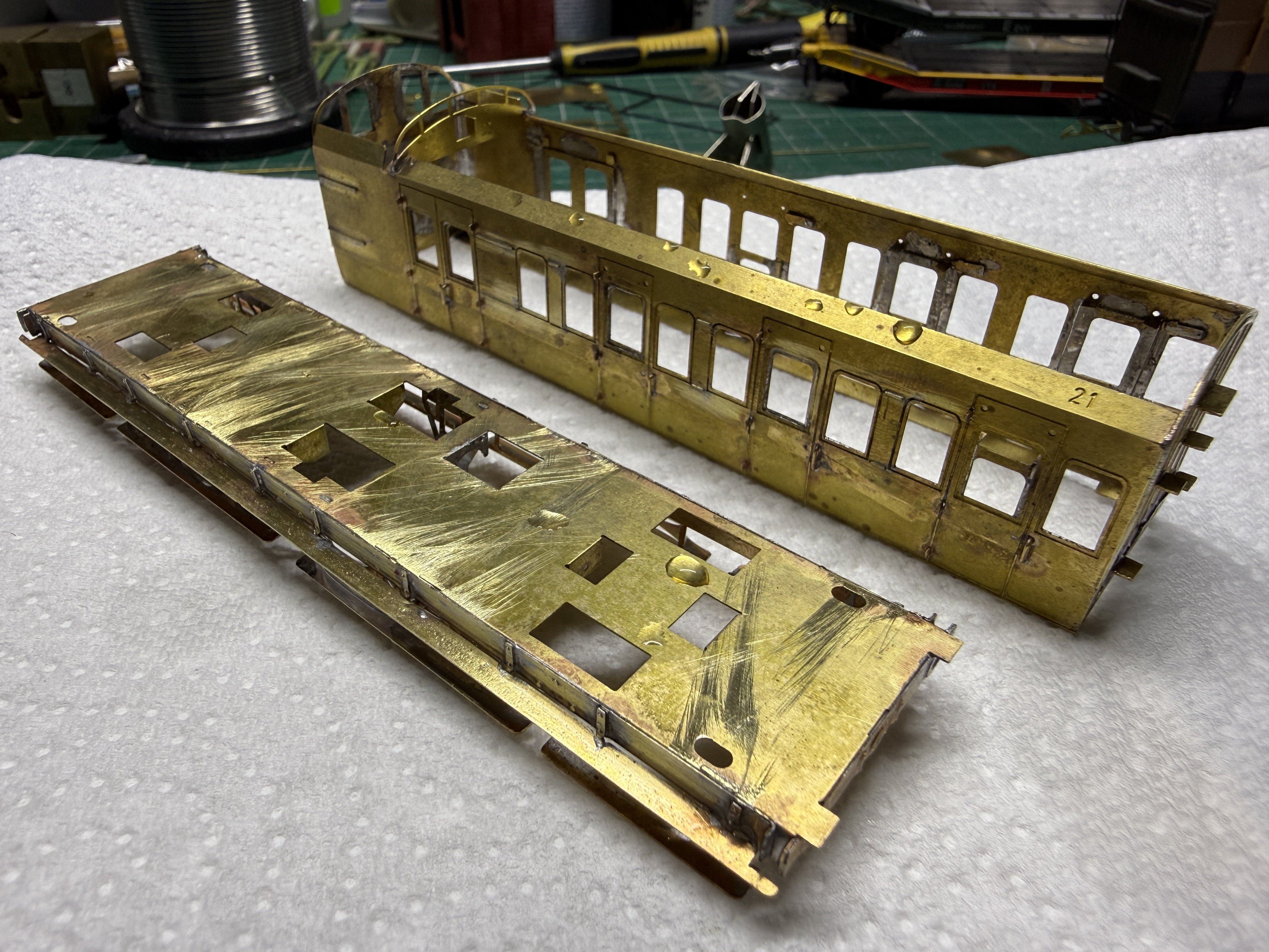

Been a while and a few thinsgs have been progressing along. Need to remember to keep you all updated.

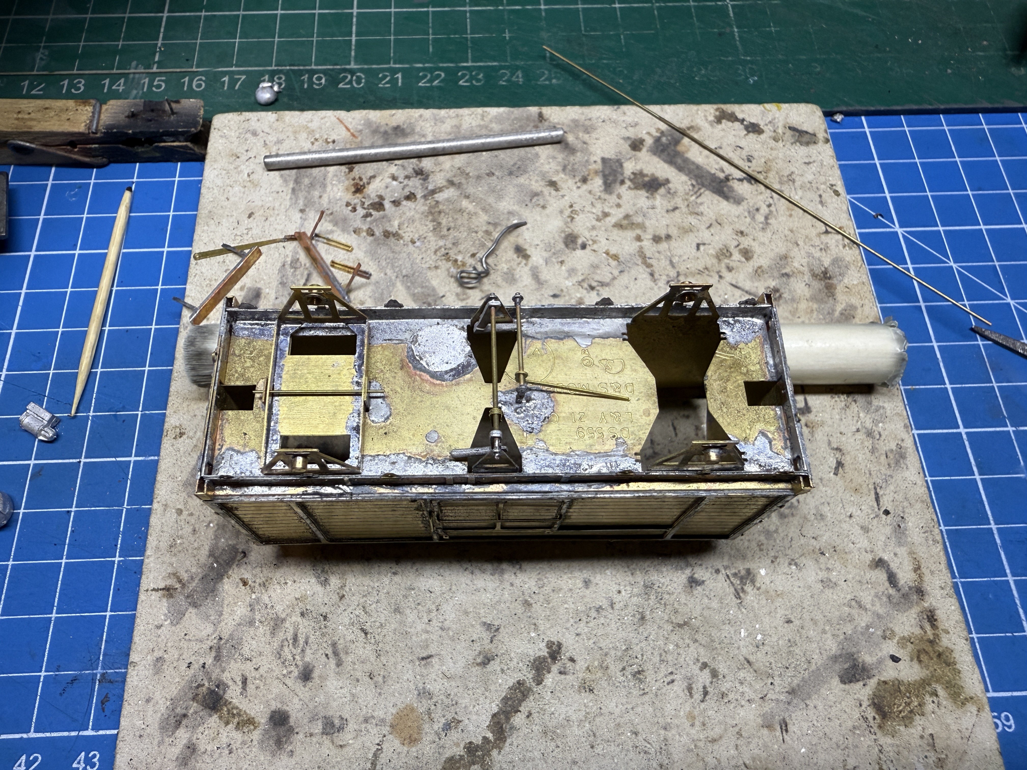

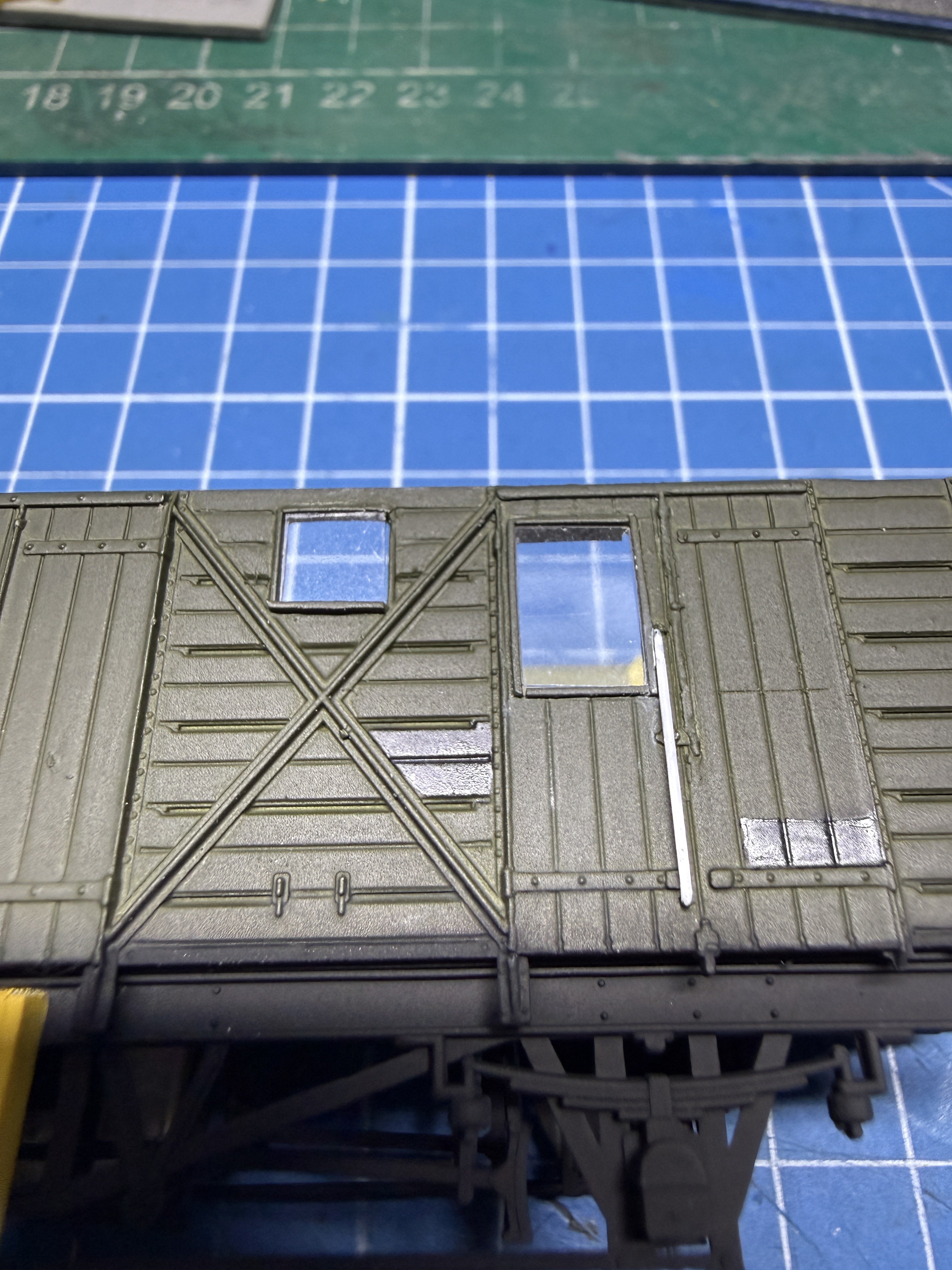

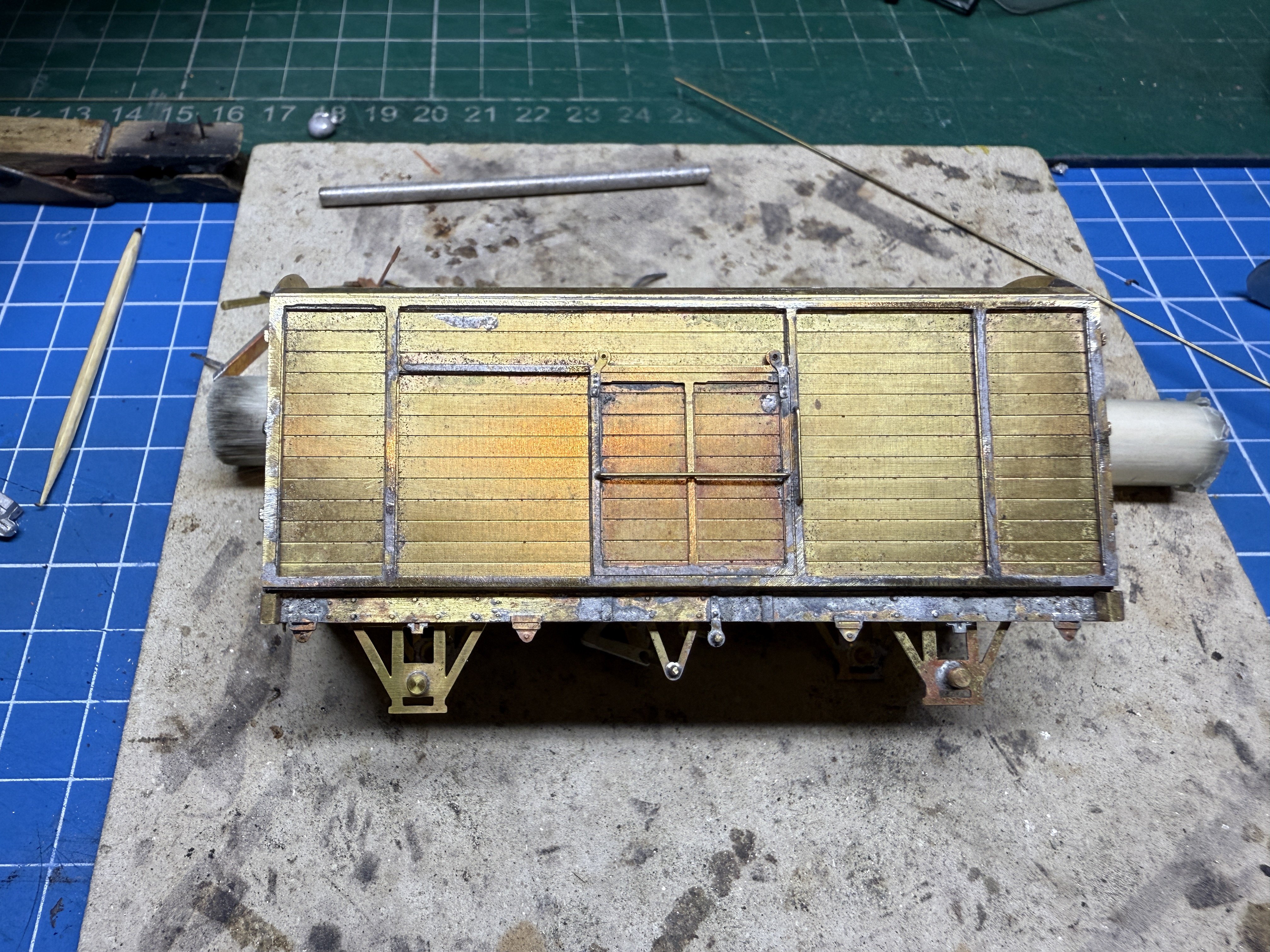

One such item is this L&YR CCT, one of 2 kits that I have to do. Made a start on the side frames and ends
Edited by Si2020

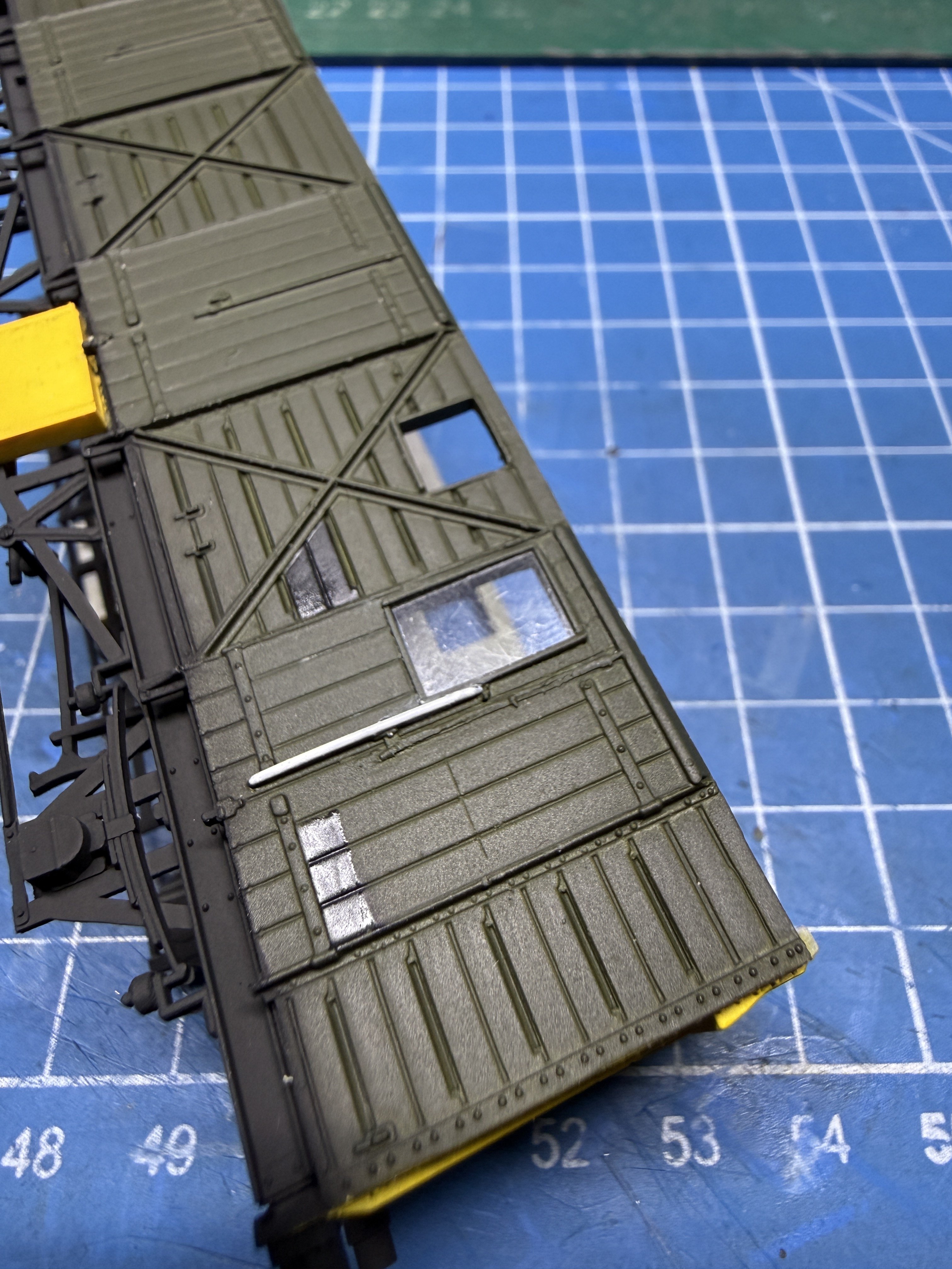

Had the chance to spend a bit more time on the body of the CCT

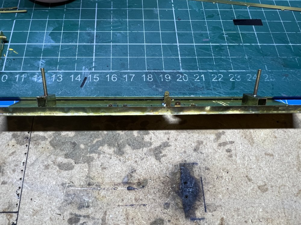

Then moved on to the underframe, with the beginings of the brake gear being fitted.
