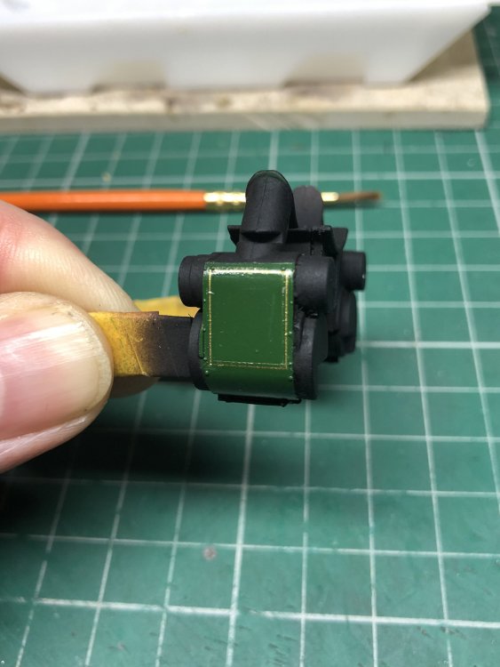

Si2020 Posted October 27, 2020 Author Posted October 27, 2020 11 hours ago, Warbonnet said: Welcome Simon! Thanks, Hopefully I wont bore you all too much So first up is a LNER 3500 Gallon tender kit. Here is the lower section 10

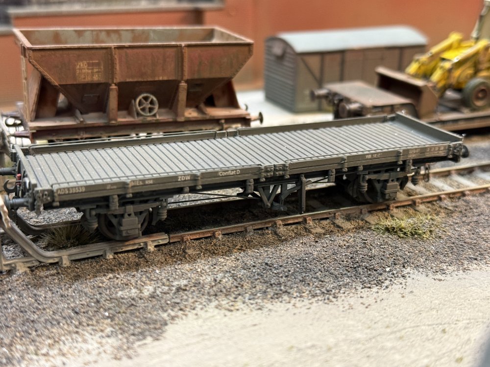

Si2020 Posted October 29, 2020 Author Posted October 29, 2020 21 hours ago, Galteemore said: That makes the work - esp on the tender - even more praiseworthy ! Thanks. Next up is a Conflat P. I've had the kit for a few years now so before I make a start on the big winter build project i thought i would do this one as small filler build. 3

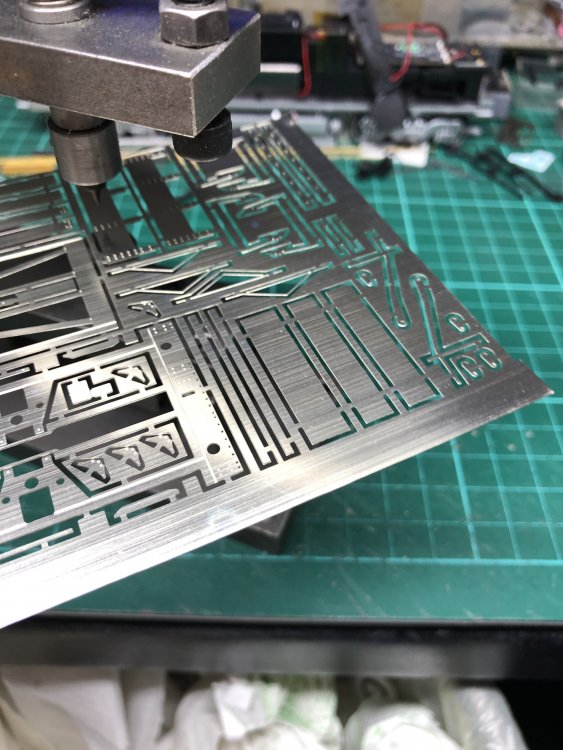

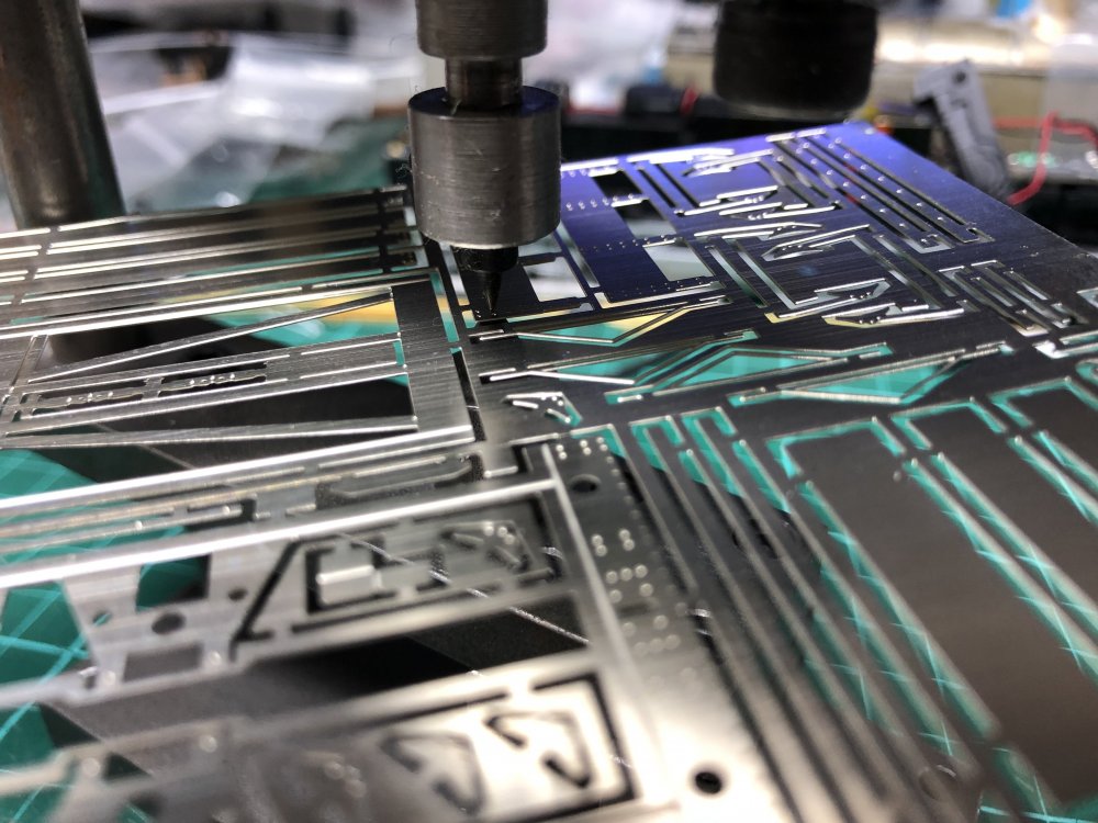

Si2020 Posted November 20, 2020 Author Posted November 20, 2020 Its been a riveting time here in the workshop recently 4
Galteemore Posted November 20, 2020 Posted November 20, 2020 (edited) A sheet of NS etches and a GW models rivet press - quality combo. Nice work. The GW press is a beautiful piece of machinery, once you get used to its little ways! Edited November 20, 2020 by Galteemore

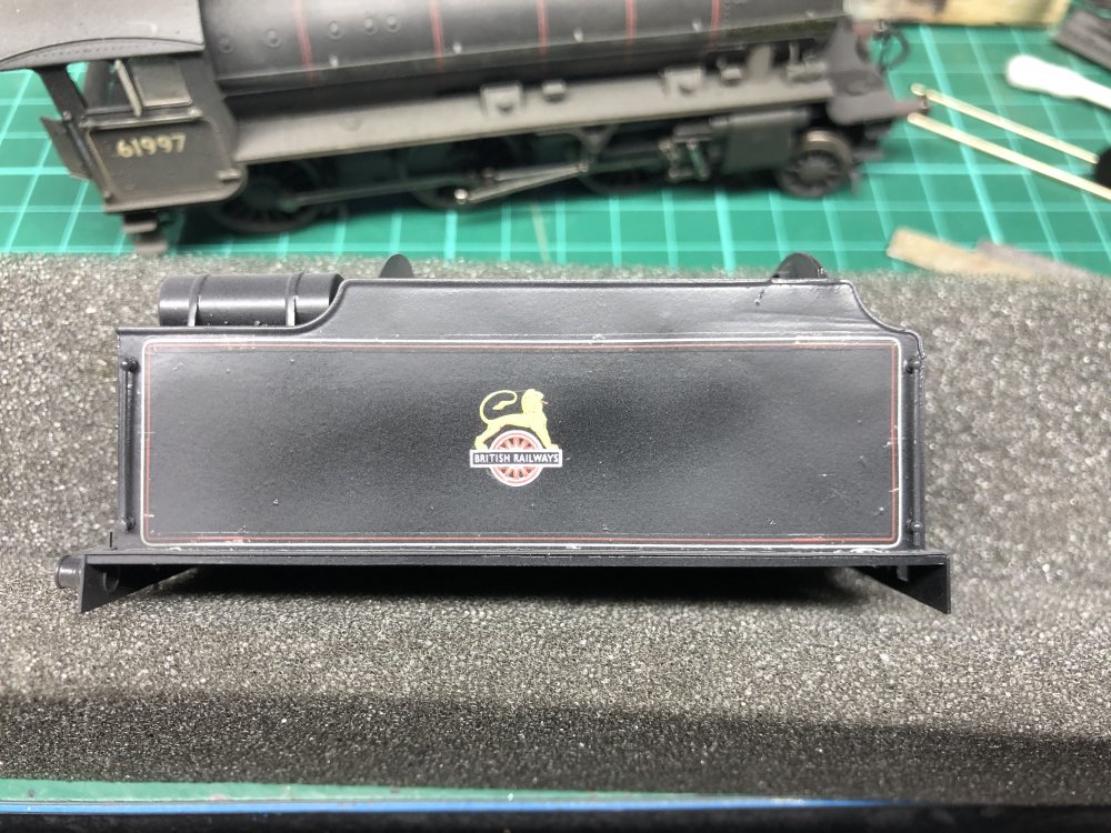

Si2020 Posted November 20, 2020 Author Posted November 20, 2020 (edited) 10 hours ago, Galteemore said: A sheet of NS etches and a GW models rivet press - quality combo. Nice work. The GW press is a beautiful piece of machinery, once you get used to its little ways! I wouldn't be without it these days. I did get one of the gravity versions whilst I was at a show demoing after i forgot the GW one but even after marking on the rod where to drop it from I struggled to get the consistany right on the finished rivets. Its one of those bits of kit that you look at it and think do I really need one buts its paid for its self about 30 kit builds ago. So remember the tender chassis at the start well here is the body for it in a cruel close up Edited November 20, 2020 by Si2020 3

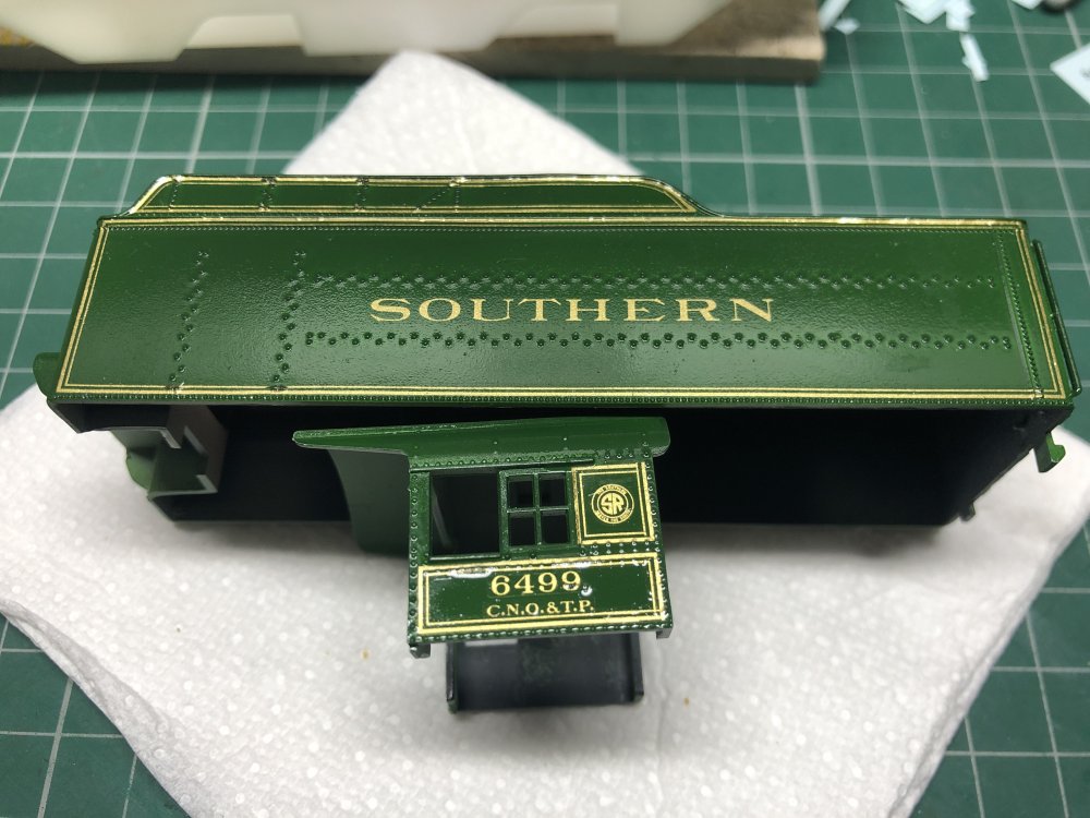

Si2020 Posted November 30, 2020 Author Posted November 30, 2020 Hi all, Another model I've been working on has been this 5 3

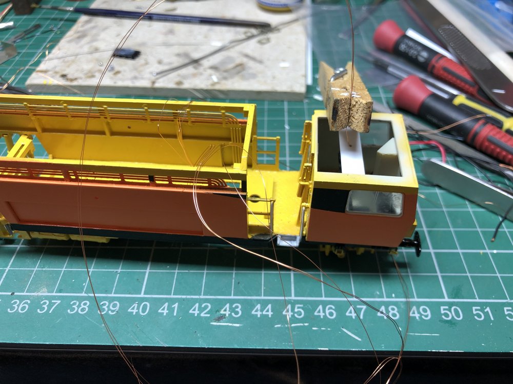

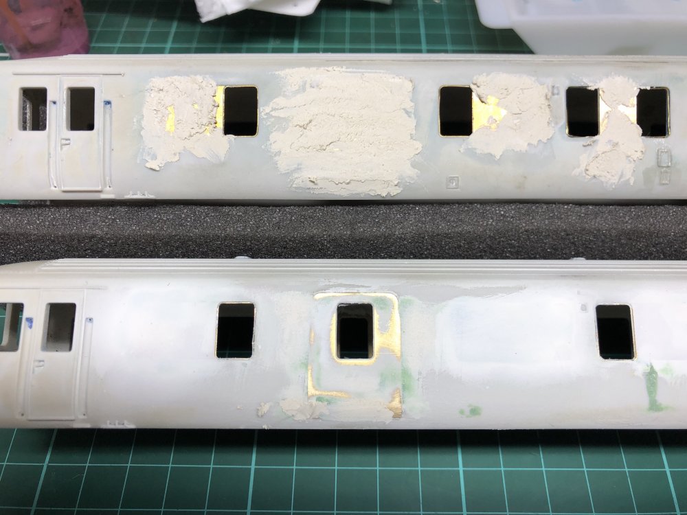

Si2020 Posted December 6, 2020 Author Posted December 6, 2020 Been working on a couple of netwrok rail 950 units, 2
Robert Shrives Posted December 6, 2020 Posted December 6, 2020 My N version took a lot of filling and a second one sits haunting me or perhaps taunting would be better. A fun build of something seen widely on the notwork. I look forward to progress. 1
RedRich Posted December 6, 2020 Posted December 6, 2020 It's great to see such an amazing level of modelling on the forum Simon. Thanks for sharing. Rich, 1
Si2020 Posted December 6, 2020 Author Posted December 6, 2020 (edited) 3 hours ago, Robert Shrives said: My N version took a lot of filling and a second one sits haunting me or perhaps taunting would be better. A fun build of something seen widely on the notwork. I look forward to progress. 1 hour ago, RedRich said: It's great to see such an amazing level of modelling on the forum Simon. Thanks for sharing. Rich, Thank you for the kind words guys Edited December 6, 2020 by Si2020
Si2020 Posted December 6, 2020 Author Posted December 6, 2020 8 hours ago, Robert Shrives said: My N version took a lot of filling and a second one sits haunting me or perhaps taunting would be better. A fun build of something seen widely on the notwork. I look forward to progress. Ive got a part built one for my 2mmFS layout that I'm building. One shell is done and I really need to get on with the other one one to finish the unit off as the layout is provisonally booked to appear at a show next October and would look good sitting in the siding next to the signal box.

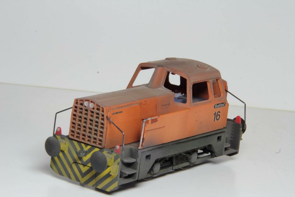

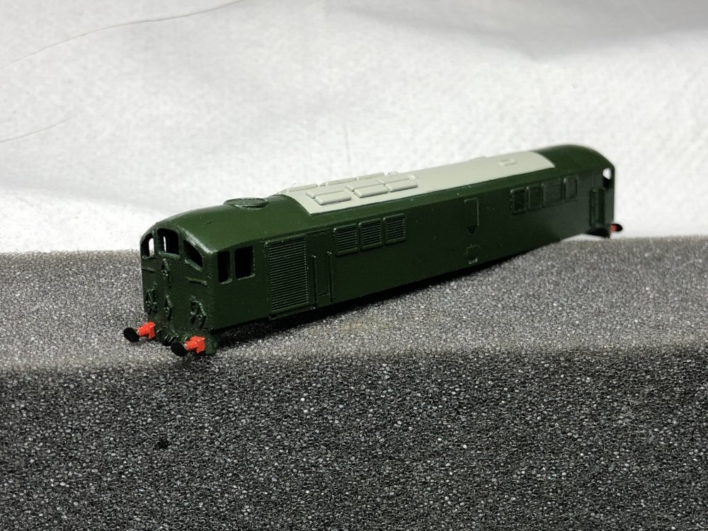

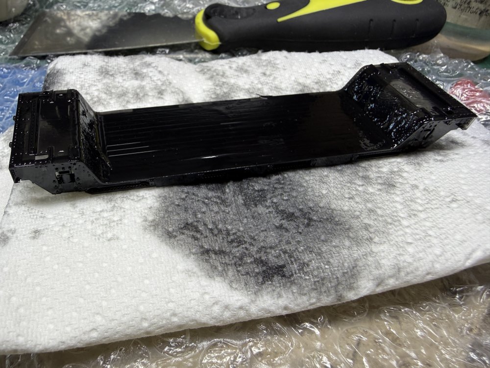

Si2020 Posted December 29, 2020 Author Posted December 29, 2020 Next up is a N gauge class 28 3d printed body which came in to be painted. After several hours of sanding the body to remove the print lines in places it was treated to a few coats of phoenix BR Loco green post 54. 3

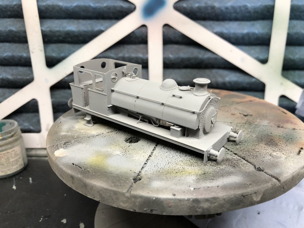

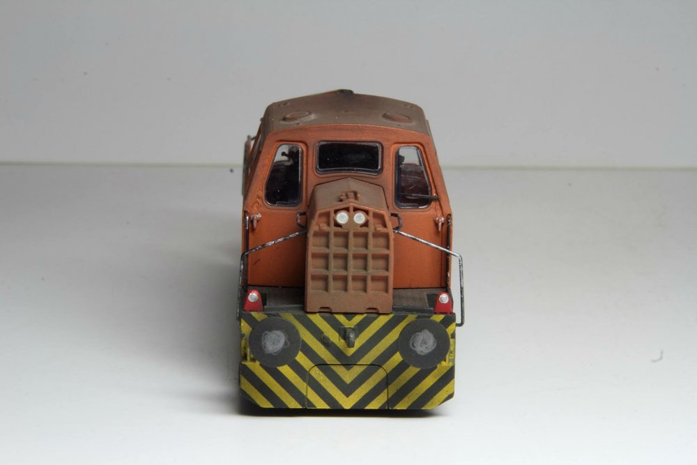

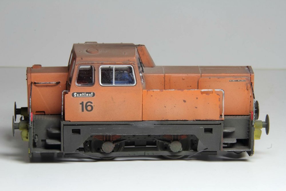

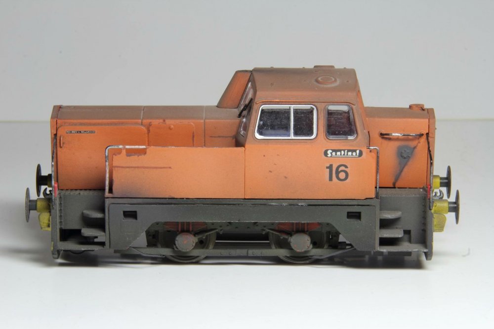

Si2020 Posted February 5, 2021 Author Posted February 5, 2021 Been a while due to varous factors, some of which I will go into in the future. Has this on the bench recently a re-spray of a Hornby sentinel. I'm currently on with another one that is going to be a bit different. 7

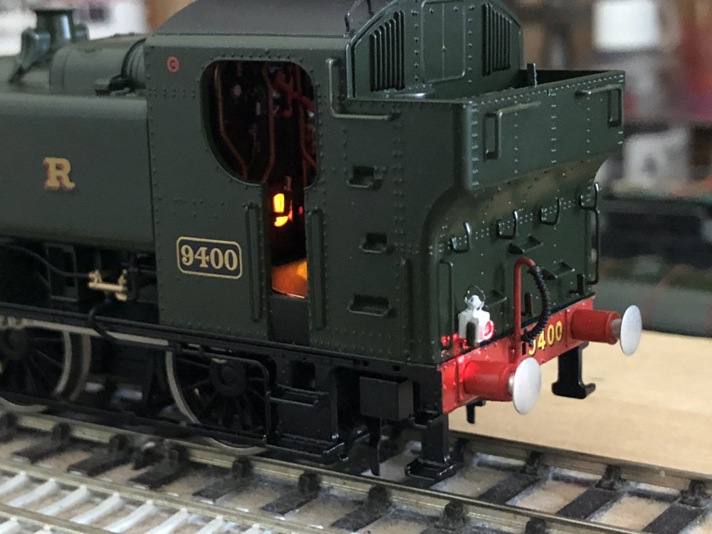

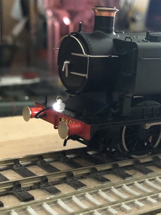

Si2020 Posted February 21, 2021 Author Posted February 21, 2021 Had a couple of sound fittings come in recently. One was the new Bachamnn 94xx and Bachamnn 9F. The 94xx had working lamps fitted bth front and rear with the rear one being able to show both white and red depending on direction of travel. The 9F also had working lamps fitted with the lamps programmed to show either express passenger configuration or express freight. The top lamp will come on and off as part of the freight lamp code but can also be switched on and off as required. It also had a rear lamp with both red and white being able to be shown and firebox flicker. Unfotunaty i didnt take a photo of the lamps working or the firebox flicker working. 5

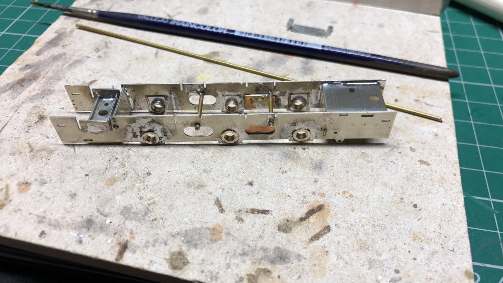

Si2020 Posted April 1, 2021 Author Posted April 1, 2021 (edited) Hello everyone, Been a bit busy with things recently so not had much chance to post anything up. Been working on this recently The chassis needs a bit of a clean up before the next step. Excuse the photo from the spray booth, it was the only place left to take a photo that doesn't have anything in the background your all not meant to see. Thanks Edited April 1, 2021 by Si2020 3 1
Si2020 Posted April 1, 2021 Author Posted April 1, 2021 Just now, Galteemore said: Very nice. Looks like a Hawthorne Leslie? Yes it is the High level kits verison.

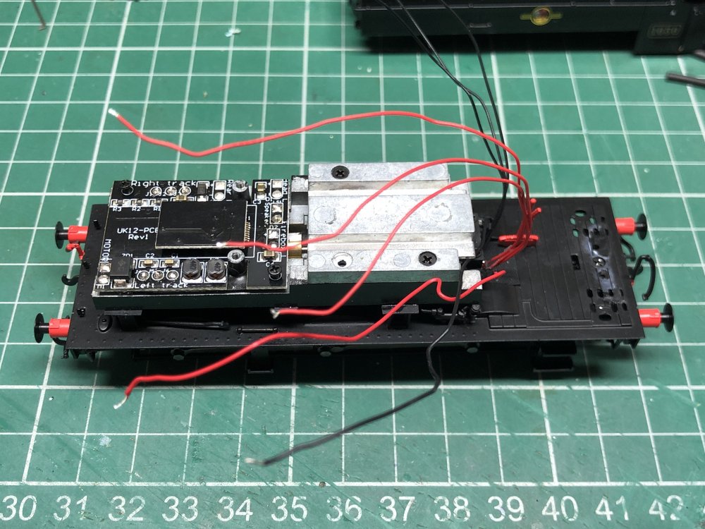

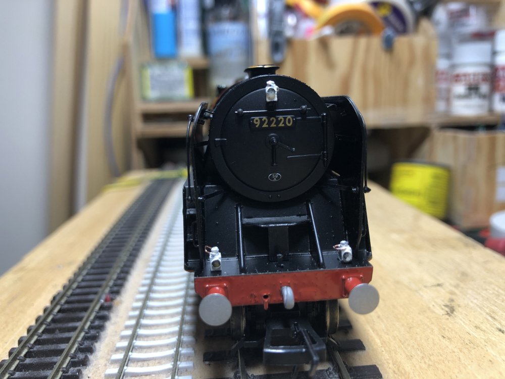

Warbonnet Posted April 7, 2021 Posted April 7, 2021 4 hours ago, Si2020 said: Spaghettie time........ Thought the layout was getting some knitting for forthcoming 92s.... 1
Si2020 Posted April 8, 2021 Author Posted April 8, 2021 11 hours ago, Warbonnet said: Thought the layout was getting some knitting for forthcoming 92s.... Sadly not, They fall a few years outside the time frame for the layout at shows plus there are enough wires under it to prevent extra being added to the top ....... However thats not to say that if you stood line side you might see one or possibly two of them in photos and videos in the future

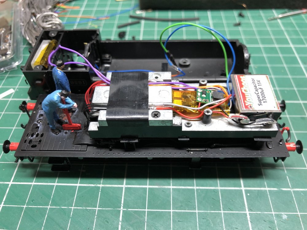

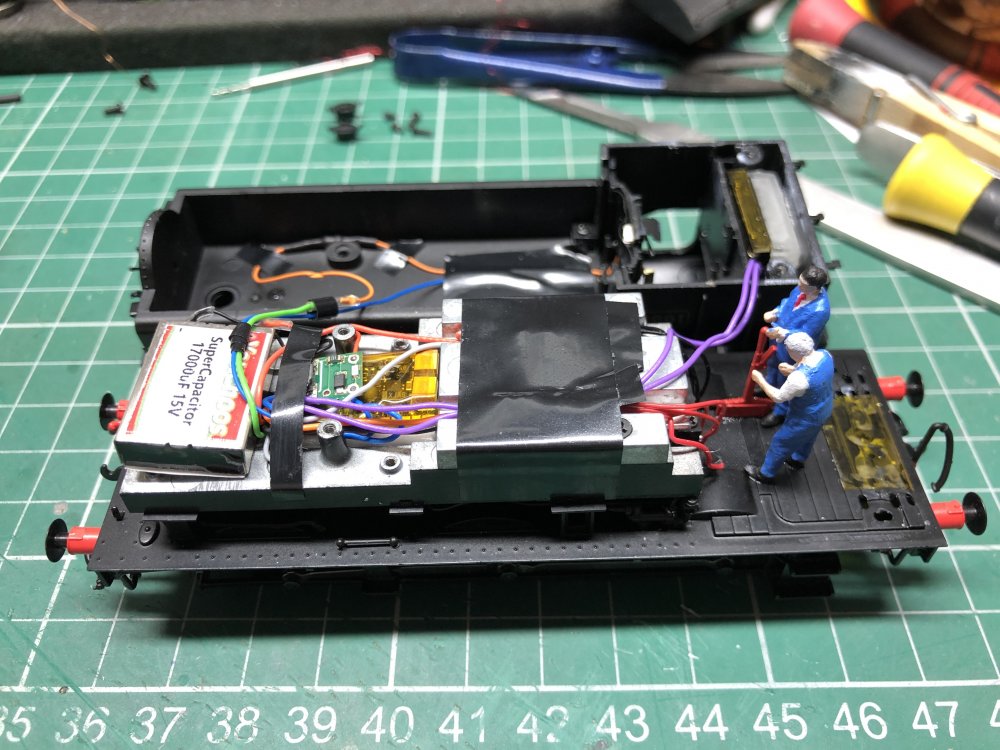

Si2020 Posted June 8, 2021 Author Posted June 8, 2021 HI all, Been abit busy recently but here is two of the Model Rail Mag 16xx. It was decided to remove the PCB and it was fitted with a Zimo sound decoder and stay alive. I also added some crew. 2
Robert Shrives Posted June 8, 2021 Posted June 8, 2021 Plenty of fun with the knitting ! neat work and hopefully stutter free. Robert
Si2020 Posted June 8, 2021 Author Posted June 8, 2021 9 hours ago, Robert Shrives said: Plenty of fun with the knitting ! neat work and hopefully stutter free. Robert Thanks Robert, It ran find before (got a couple of good ones) but the person I fitted it for wanted a stay alive and it now runs for 20 seconds without the sound on across the bench.

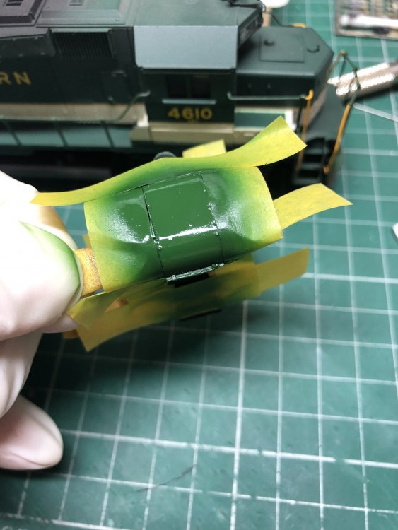

Si2020 Posted June 13, 2021 Author Posted June 13, 2021 (edited) Morning all, So keeping on with the american stuff (In the British section of the forum ) Here is a flat car that i weathered up Edited June 13, 2021 by Si2020 3 1
Galteemore Posted June 13, 2021 Posted June 13, 2021 Tutorial would be nice so the rest of us can see how you achieved such a great look! 1
Si2020 Posted June 13, 2021 Author Posted June 13, 2021 1 hour ago, Galteemore said: Tutorial would be nice so the rest of us can see how you achieved such a great look! HI, I will see what I can do as the only flat cars I have are in 1/35th scale 2

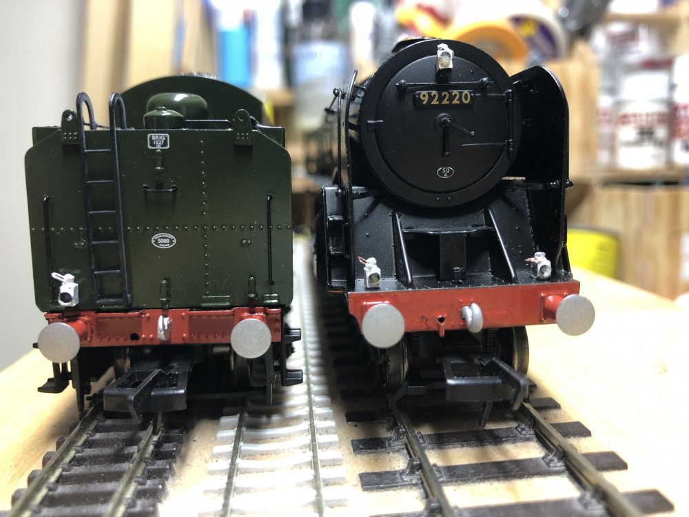

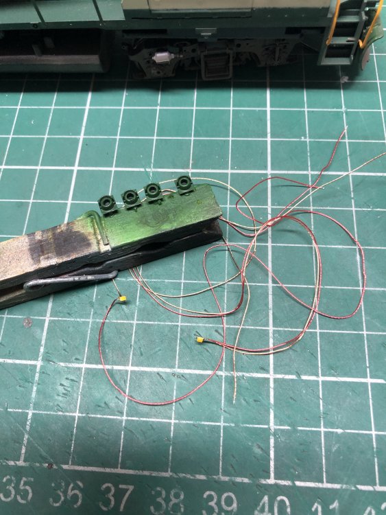

Si2020 Posted July 10, 2021 Author Posted July 10, 2021 Hi all, A mixture of things on the bench at the moment with lots of re-spray and lining work happening and some some ditch light fitting 5
