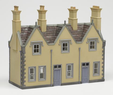

Hi ya thanks for that, I also came across this sometime ago to use on an isle on man based layout, but I now realise it could be used as an Irish themed railway station as well.
http://www.springsidemodels.com/id30.htm

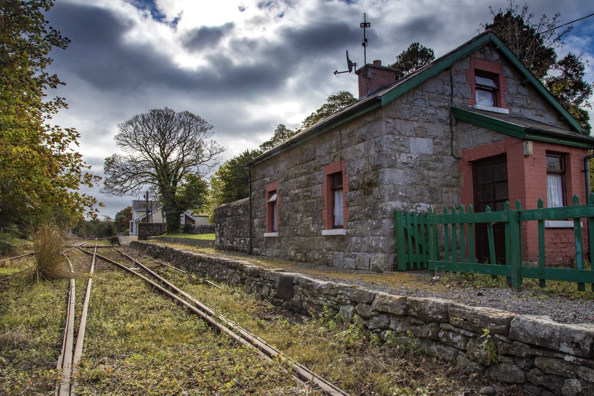

I am sure there are other building kits etc which could be adapted to get the Irish feel I am looking for I have just come across a station called Barnagh on the Limerick line which is now abandoned and the station track plan is just what I am looking for as something to start with in 21mm gauge.
I read somewhere this station was on the old North Kerry line as well, I am surprised to find it in this condition as I was under the impression that a lot, if not most of the ex old Irish railway stations had been turned in to private homes by now.
