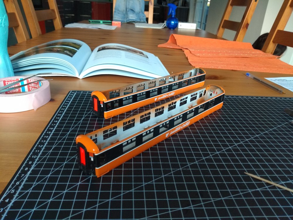

  1. Fantastic. The 4 IR Tippex ones are the ones I ordered. They look the absolute dogs you know whats. I never really liked the A or C classes in real life but the models have drawn me that bit closer to them.

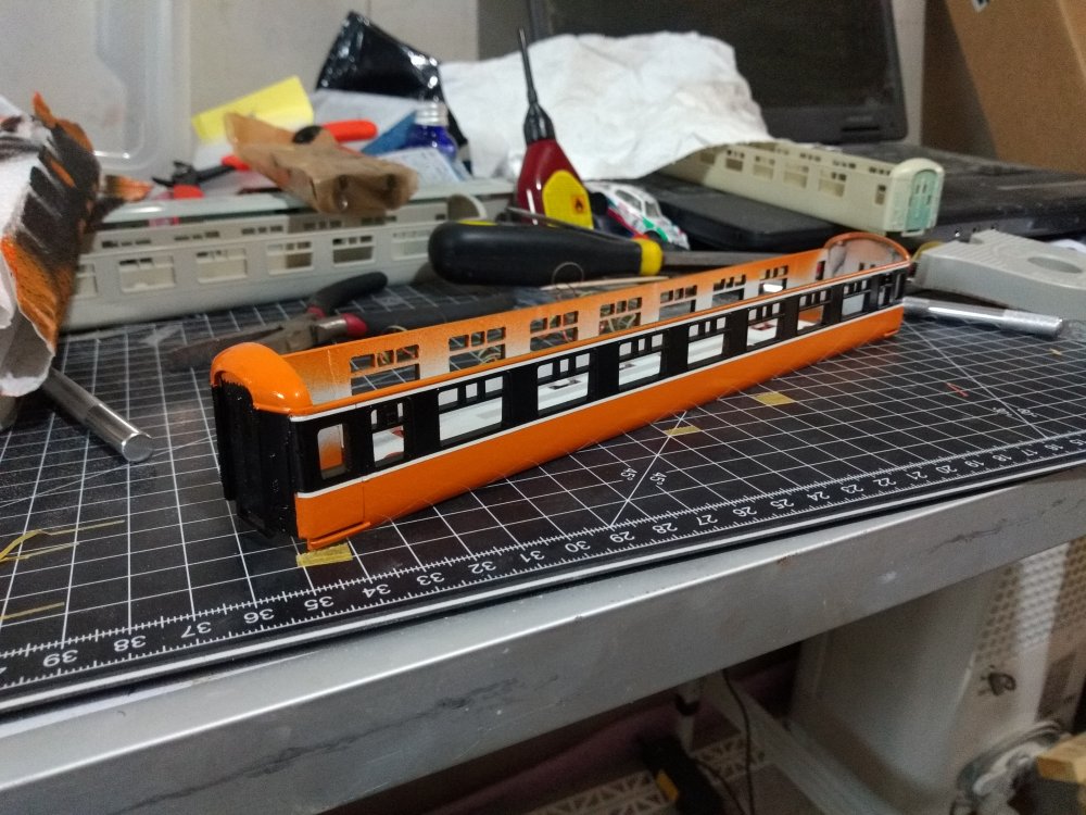

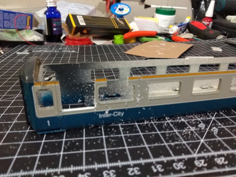

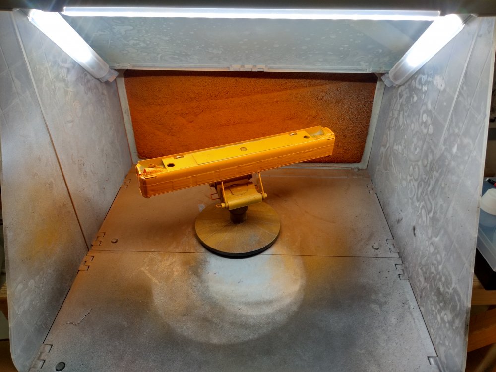

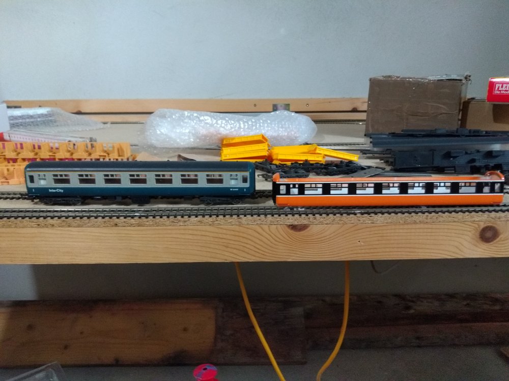

  5. So I primed that Bachmann coach and then paused again because i really do not want to use rattle cans any more. My environment is just not great for them. I like to work in my basement and it just seems that the rattle cans kick up too much dust in the spray booth. I much prefer the finish from the airbrush anyway. So my problem was I couldn't find a RAL2011 deep orange (which I find a very good match to the Bachmann/MM mk2a's) in a water based acrylic. In a rattle can, enamel or alcohol based acrylic it was available fairly readily but I struggled to find a water based acrylic until I found this small German manufacturer, Modellbau Oesling. I read a few reviews on German model rail forums and they all seemed happy with the products so I ordered a set to do IR coaches. I also ordered RAL 7030 which is a dead ringer for the toilet window grey on the Bachmanns when I hold a RAL colour swatch against it. For good measure I ordered a primer and a matt varnish. The paints come in 30ml glass jars and cost €4.30 each so similar per ml to Vallejo. They were extremely well packed. Every jar was wrapped individually in a sheet of newspaper and three jars were placed in each layer, separated by more newspaper. Probably the best packaged things I've ever received. I placed the order before the final on Sunday and they arrived an hour ago. That's some service. He seems to offer most colours in gloss or matt. If I can I take gloss to give a smother surface for the transfers without an intermediate coat of gloss varnish, then just dull everything down with matt at the end. I will report back on my experience using them. I suspect Herr Oesling could mix up any RAL colour if asked nicely. All the jars seem to have a serial number!

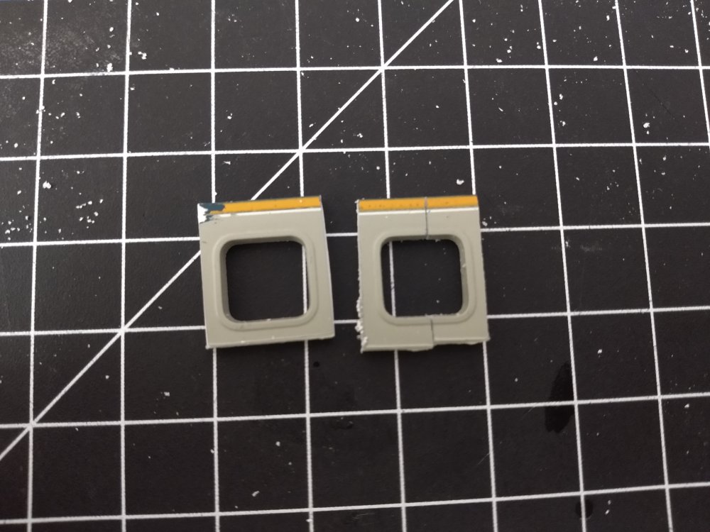

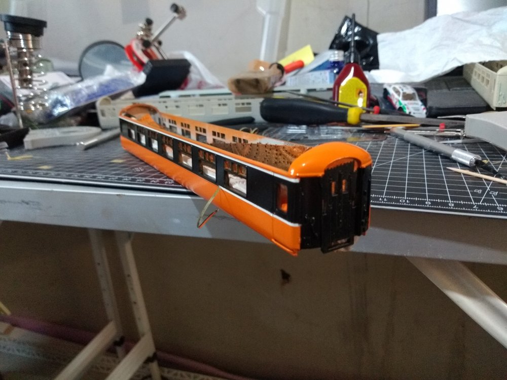

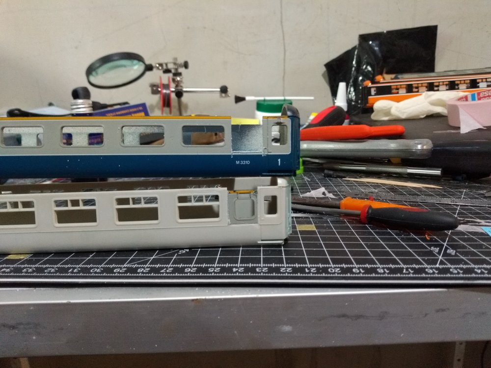

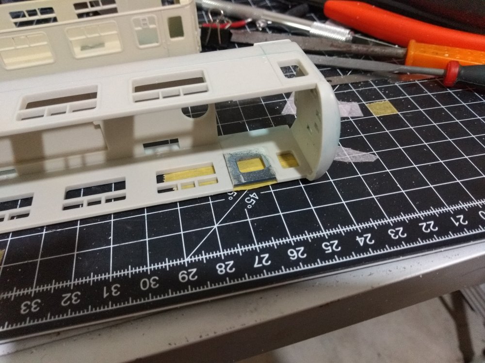

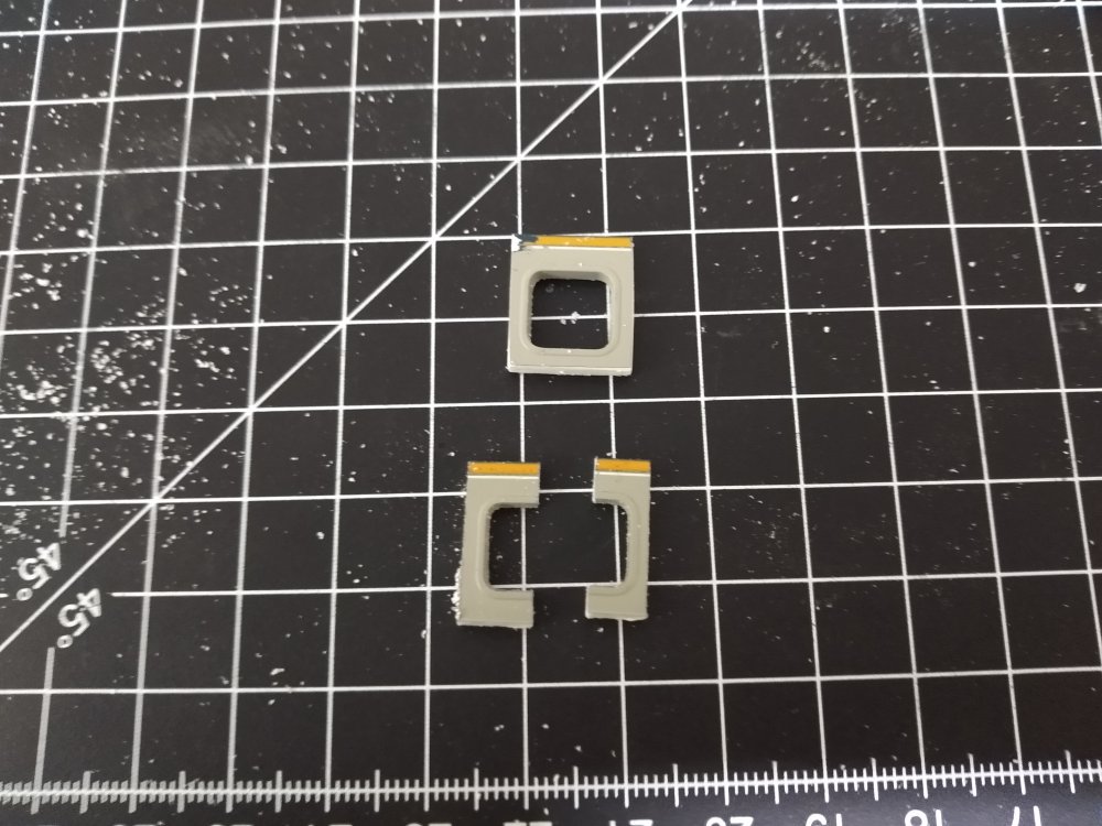

  8. Centre door filled with milliput superfine and sanded. I just used the glazing as a base for the filler. The gangway doors I had to cut out as they were firmly glued in place. I couldn't get the corridor connections off so just masked carefully around them. They'll stay black anyway. I'll remove the masking before the final coats of matt varnish. AFAIK the fawn colour on the Bachmann FK is an error and they were red in reality even with BR. The centre door is noticeably proud of the rest of the coach side, especially lower on the tumblehome. This can be seen in the pics where sanding shows the areas immediately adjacent aren't being touched by the sanding block initially. With a bit of patience however the door bulge is sanded away flush to the coach side. A first coat of primer applied after degreasing.

  11. As I'm largely blocked on further progress on the Limas due to not hearing anything back from Shawplan, I will turn my attention to the Bachmann mk2a's for now. These are the pair with the plated over centre doors. First step is to remove the wire door handle sand back the mouldings around the door frame. I think it's better to do this before filling the window and step because it's much easier to see when I am flush with the coach side as paint starts coming off.

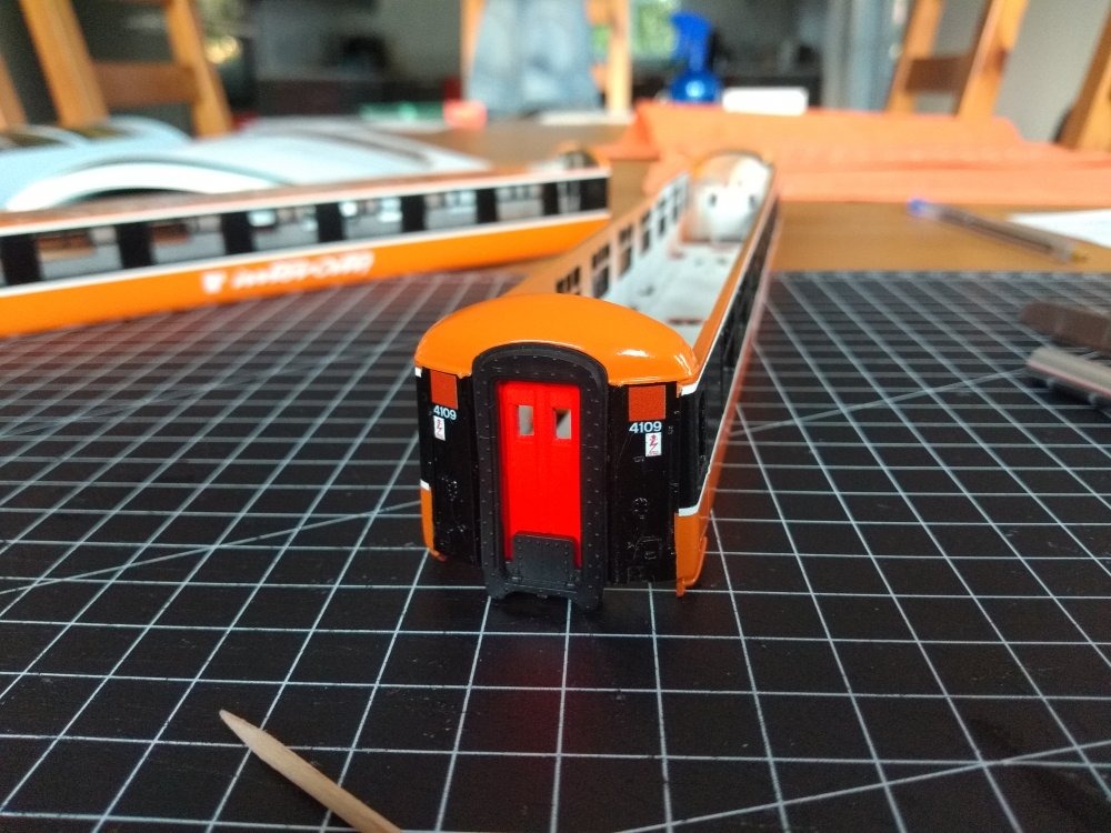

  15. First attempt at DIY transfer stripes. Created on some free SVG graphic tool on a Chromebook and shrunk down to scale then printed out on decal paper with an inkjet printer. Seen here after receiving clear coat of varnish to protect the water based ink when in the water bath: Test coach stripped and resprayed in just the "grey" (I've ordered something a touch darker) and blue: And with one stripe cut out using a scalpel and steel rule: I reckon I'm on the right track with this method. It's dirt cheap (costs basically nothing) and will be a lot less effort than masking the colours individually. I need to get a slightly cleaner cut though I am pretty happy with this I have to say. I made no attempt to get the correct shade of yellow here and the black printer cartridge seems to need a slight alignment but from 2' away that's not visible. Now that I know the method will work for me I can refine it a bit. The stripes are 0.8mm/1.6mm thick.
