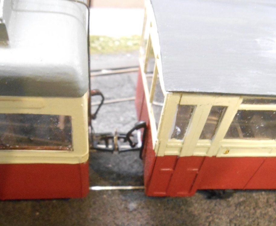

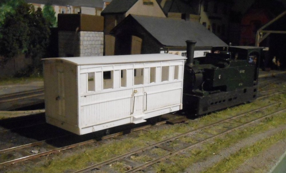

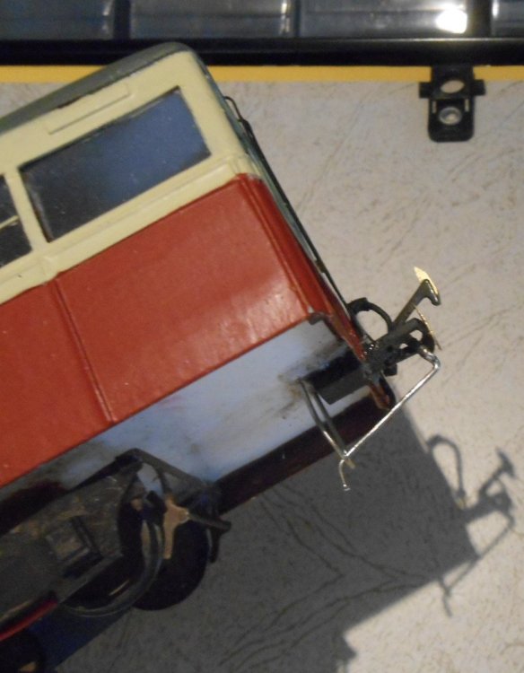

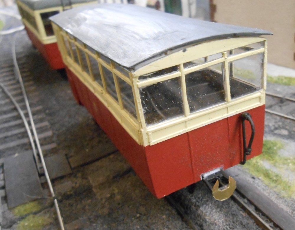

Well, the little Tamiya drill has proved its worth in drilling holes in plastic for hand rails, though it will work even better when I get some sharper bits. Anyway, certainly helped me move the tramway coaches towards completion. Couplings needed [still to grasp the nettle here], but painting and lettering finished today, along with roofs and interiors beforehand, including some cheap and cheerful Peco figures. Lettering is Fox and the crests are LMS from and old SMS transfer sheet. Use the crests for my Donegal stock too, though for the West Donegal Tramway, have put them upside down. The crests also nicely cover up the Clogher Valley logo on the loco. As you can see in the photos, work has begun on the fencing for the tramway platform.

Ordered one from Amazon Sunday evening, it arrived yesterday afternoon and put it together in front of the tv last night. The instructions took a bit of getting used to, but overall went together ok. As an intermediate drill, am hoping it will work well with plastic sheet, where my Proxxon is far too fast and melts its way through. First test later today, fitting hand rails to the tramway coaches.

Looks a very neat idea, an ideal middle path between a high speed mini drill and finger twirling a pin vice

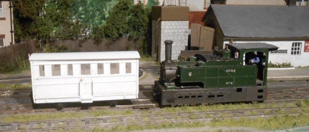

Been working on some rolling stock again. A Donegal 'red wagon' has joined the fleet, built from plasticard & based on the Alphagraphix card kit. The chassis is a suitably chopped etch intended for 4mm scale. Not sure if the wagon load will end being the one depicted, as much will depend on what Railcar 8 can pull. Which reminds me - must get in touch with Mark Clark as it is now at least six months since I gave him the bodywork in the hope of a working chassis... Next come the other two tramway coaches. Based on the Alphagraphix card kits from the Schull & Skibbereen, have increased the width of these two to 6'6 as the 3rd class coach looks a bit narrow at just 6'. One is a passenger brake van, the other a first class coach, now downgraded to a third, but retaining smoking and none smoking sections. Plasticard all round for these, including the chassis which are doctored Parkside ones - a real bargain at less than six quid. Speaking of bargains, have been looking for some detailing bits and pieces to furnish the quayside. Some more fish boxes from Skytrex have been joined by a dinky set of crab and lobster pots from Scenic 3D. 3D prints, they were less than a tenner [including postage]. Apart from some fancy etching, can't think of a better way to produce such things other than learning lace making & they paint up well too.
