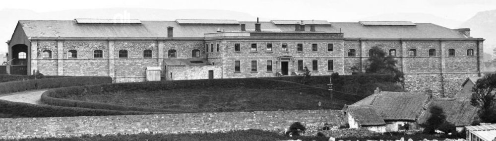

I once thought about this as a project. The tall walls are a big visibility issue though, even without a roof. I concluded that it would be better to have spectators viewing the model from the other side - its the only way you get a decent view of the trains in the platforms. https://en.wikipedia.org/wiki/File:Entering_Sligo_station,_1948_(geograph_5308005).jpg There are plenty of trees to make a scenic break. Just a very gentle opinion though - you should do it your way!
