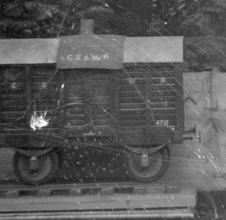

  1. Yeah, me too - though lining and lettering were never my strong point, to be honest! Yes, it’s an old Slaters kit. I might get another and put vertically-planked doors on it - that would better resemble what it’s meant to be an approximation of. But it’ll do for a quickie job!
  2. If you look at the original wagon, the doors weren’t full height. Obviously, on a real van, be it a “soft-top” or not, the door would be full height, so this had to be disguised; the solution being the canvas cover just about covering the top part of the wagon side, thus making it look like a full height door. Finally, painting. Next will be couplings, flying snails, numbers and heavy weathering.
  3. I spotted a Midland Railway (of England) high-sided open coke wagon as a kit, which I thought could be converted to a generic GSWR (or at a stretch, CBSCR) “soft-top”. So, off we go. First, cutting small curved bits of plastic to raise the (previously level-topped) ends. Next, the roof parts, each a curved bit of plasticard. At this stage I was going to leave the centre part open, as it would have been when carrying cattle, so I made the two end sections of roof. However, I could have saved myself a bit of work as I then spotted a glasses cleaning cloth and decided it would make a good canvas cover! So, a piece was cut out and glued to thin but very strong paper. Once set, it was shaped and glued in place.

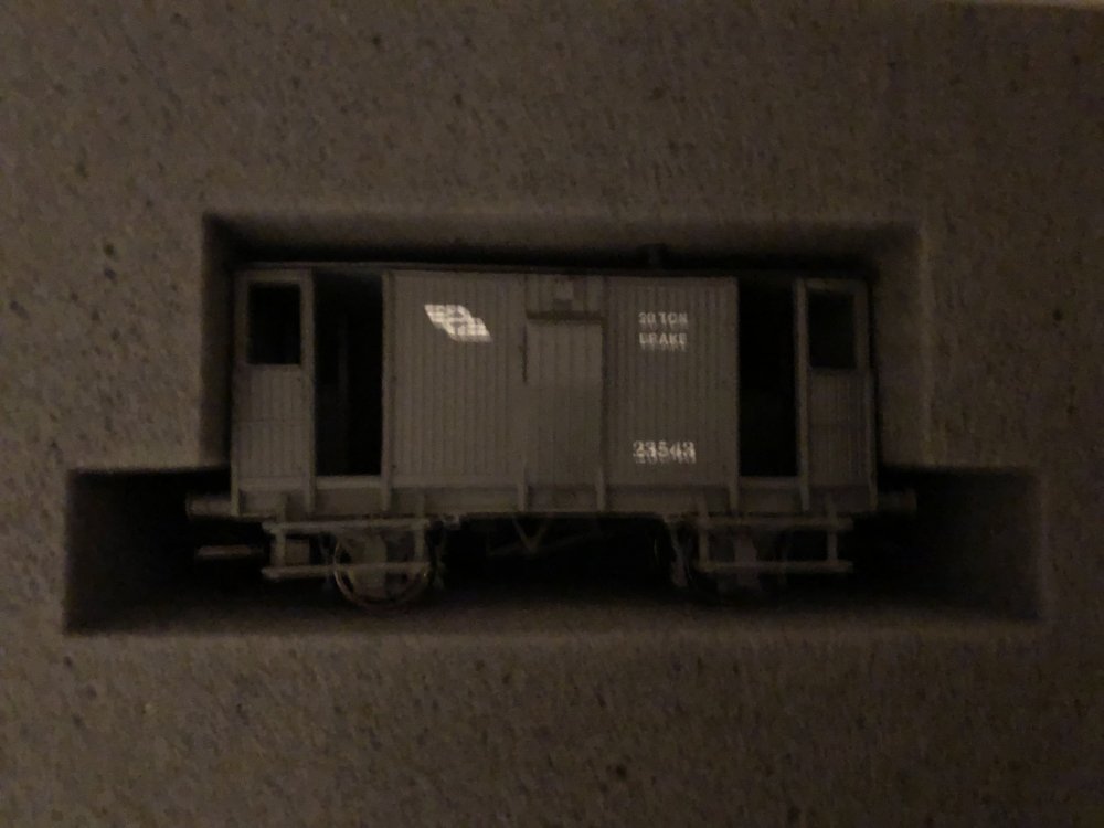

  16. Thanks, Tony. There’s been nothing much else happening in recent times as I’ve been busy elsewhere but I’m hoping for further progress soon.
  17. Is it DCC fitted? Sound or not?
  18. Ah, if it’s the 800 class you must buy seven, plus three of their 500 class and twelve of their NCC “Jeeps”. I thought that was a new nameplate. I was looking forward to seeing it on the wall of a Chicago bar in six months’ time……

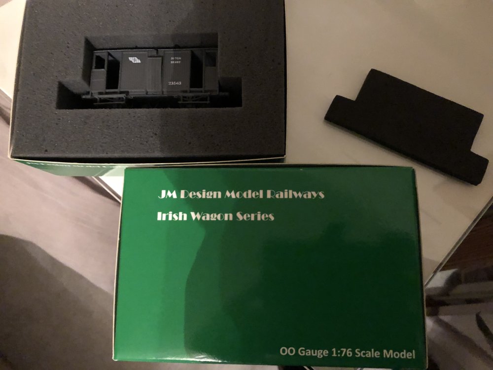

  19. Yes - this was commonplace in makers’ photographs, to provide contrast. While it was seen amongst a number of British liveries, it was very rare in Ireland for any type of wagon to have black ironwork unless the wagon was black itself, as many early GSWR, DSER & Donegal Railway ones were. The rule on Irish railways was almost always that ironwork was body colour. There were very few exceptions. Same with makers photos of locos with white connecting rods, or white rims on carriage wheels - they didn’t run like that. With no colour photography, black, white and numerous shades of grey were necessary on official works photos to show detail. Once photographed, the item concerned would be painted in its “proper” livery before delivery to its new owner.
