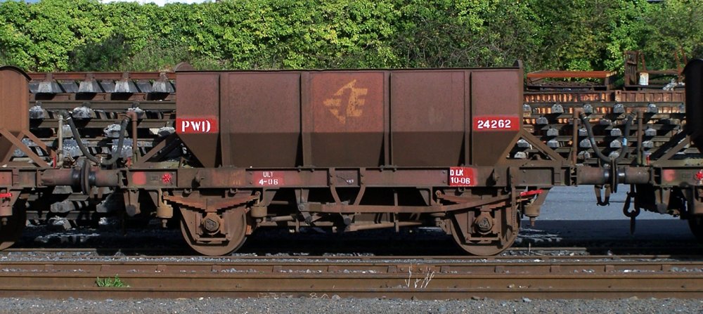

  11. I had a delve thru my archives and came across the photo of the IÉ Ballast Hopper, No. 24262. As an aside, I had a check thru some shots of the IÉ Fuel Oil Tank-Cars used for transporting fuel oil for internal use and the only one I could find was the IÉ liveried one depicted by DiveController in Limerick. While on the subject should IRM wish to make these models in the future the ones latterly used ran mostly on the same chassis as the Cement Bubbles, using 3x different types of tank design; two of which are depicted in DiveController's photo, with the third using an extended tank and were formerly Esso Oil tank cars (not to be confused with the class A tanks used on the Sligo & Claremorris Oil turns), which were utilised for IÉ fuel oil until the flow ceased in 2006. Anyway back to Ballast Hoppers, hope the photo helps.
  12. If I recall correctly there was 1x ballast hopper that had the IÉ plug & socket logo stencilled on the sides, as well as one of the tank wagons, used for transporting fuel oil for internal use around the network in years gone by. I’m struggling to think of any other freight wagons that carried the IÉ plug & socket logo with the exception of the weedspray train? PS: Superb work by IRM for yet another fantastic release! Edit: There were several tank wagons converted for Molasses traffic that carried the IR ‘points’ logo as well as at least one brake van I seem to recall.
