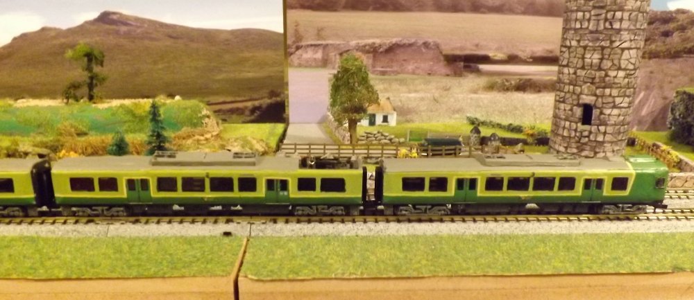

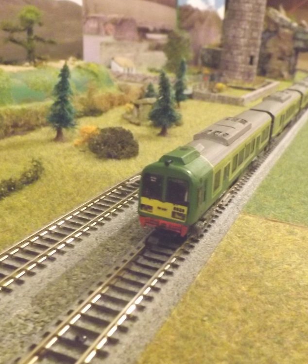

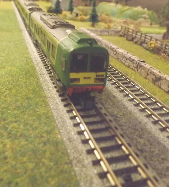

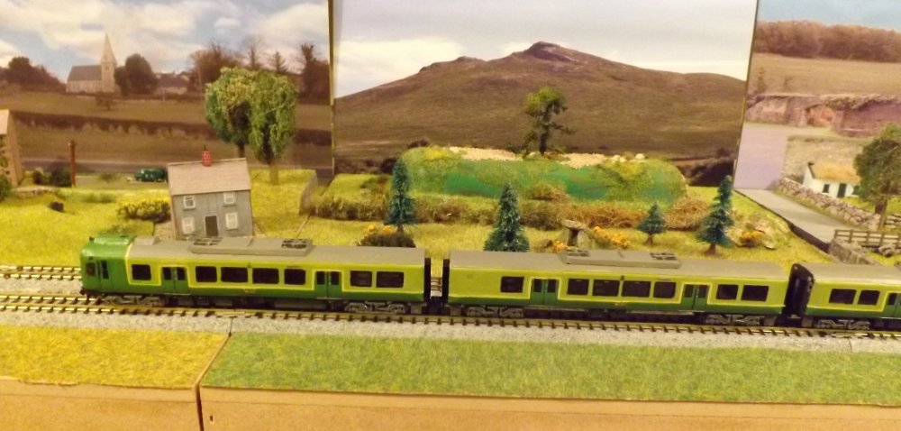

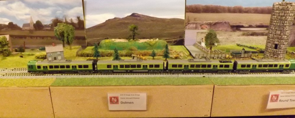

  1. Following the above information I decided to start converting my class 350/2 into the 8600 series DART. While the roof details and a number of others have not been fully done, I think that for N gauge there is sufficient to give a passable representation of this type of DART. As this will normally only be viewed at a distance it gives a reasonable impression of the DART. The following 5 photos show the completed model with all its short comings. MikeO

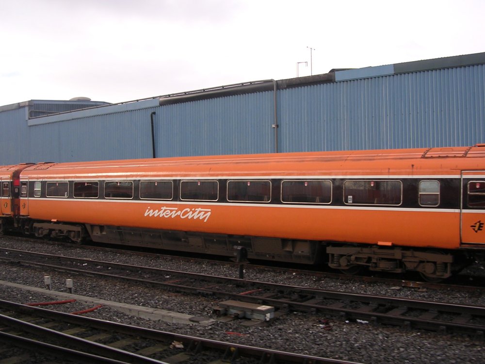

  23. You can certainly cross post any of the photos from my T-Trak thread. The photo you included above with my converted Vossloh G 2000 also shows the intercity coaches which have the Electra Graphics sides( referred to by Noel) added. The coaches are Graham Farish MK2 coaches with the paint work removed.. this needs to be done to ensure that the windows on the Electra Graphic sides are correct.
