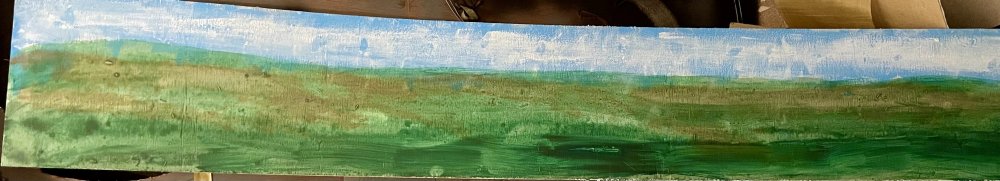

Galteemore Posted July 2, 2021 Share Posted July 2, 2021 (edited) Paint your own, JHB. It’s really not as difficult as it sounds. Barry Norman’s book on scenery tells you how. It’s based on ever thinner washes of green. Here’s a crude one I made this week. The idea of a backscene, I think, is to provide just enough depth to fool the eye into focusing on what’s in the foreground. Look at a lot of coloured photos of Irish railways and what you see in the background is a vague sweep of green and brown. Note that you will have to specifically focus away from the railway content to do that! As long as there’s a suggestion of. appropriate background, your brain will paint in the rest. It’s a basic camouflage technique - just providing enough visual clues for you to see what you are ‘meant’ to see. Photo backscenes are fine but sometimes too sharp and actually distract the eye towards them…well that’s my rationale anyway! The lowest layers of this one will have 3D scenery in front, but will hopefully give the idea of that classic Connaught high ground behind. Edited July 2, 2021 by Galteemore 6 Quote Link to comment Share on other sites More sharing options...

Galteemore Posted July 2, 2021 Share Posted July 2, 2021 (edited) Like this ? Just notice how the essence is reducible to varying horizontal bands of colour….the green-brown at the back is a lighter shade than at the front. Edited July 2, 2021 by Galteemore 5 Quote Link to comment Share on other sites More sharing options...
jhb171achill Posted July 3, 2021 Author Share Posted July 3, 2021 Yes, that’s similar to what I had in mind! Quote Link to comment Share on other sites More sharing options...

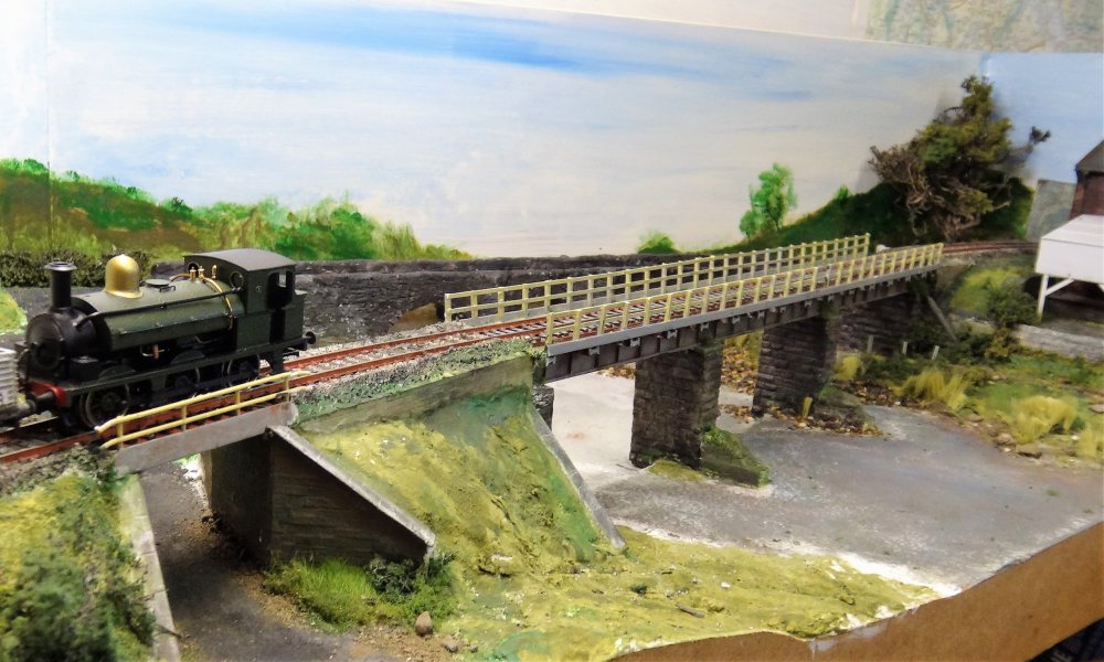

David Holman Posted July 4, 2021 Share Posted July 4, 2021 Photographic backscene are ok, but you are right, JB - the same ones crop up all over the place. As Galteemore says, it is not that difficult to paint your own, while photos can be too sharp and distract from the layout itself. Sometimes, all you need is sky, especially if the on layout scenery is rising towards the backscene. Nothing fancy ended here either. Currently, outside my window, it is a very pale grey, pretty much all over and certainly not difficult to reproduce. Indeed, translating Galteemore's photo of the brooding mountains into a layout backscene, only the top half would need to be painted. Three or four outlines and a few shades of blue/grey. Don't make the backscene too dark though, or you'll need some very bespoke lighting and that is a completely different ball game. 2 Quote Link to comment Share on other sites More sharing options...

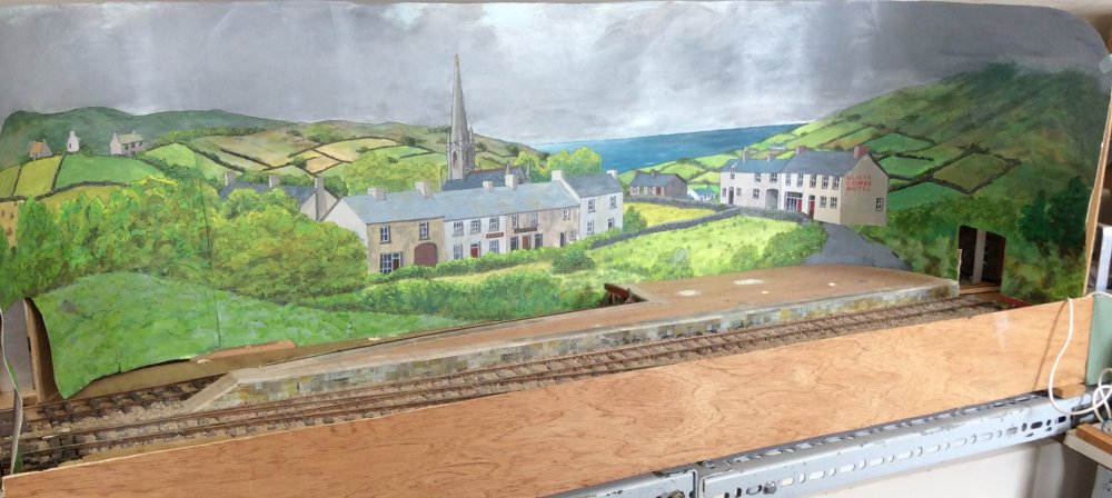

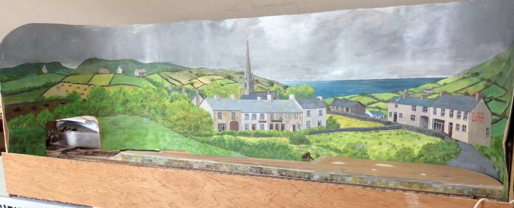

Northroader Posted July 4, 2021 Share Posted July 4, 2021 Here’s a backscene I’ve just wrapped up for my line, done in acrylic paint. You can start it off like a watercolour, using transparent washes, but overpaint into thick opaque layers, like oil, but the gain with pva is that it is very fast drying. Usually I paint for around an hour, changing the water frequently, then give up trying for a few days. Parts of it have been done as stick on patches, such as the buildings, rather than trying to get the whole thing right at one go. I do hope you guys agree it has an Irish look. The photo by Galteemore is wonderfully dramatic, could you have some sidings or a station in front, or is it too remote without any buildings? (Maybe Maam Cross) One source of inspiration I use is old railway posters. 5 3 Quote Link to comment Share on other sites More sharing options...
David Holman Posted July 4, 2021 Share Posted July 4, 2021 That's a wow then! Excellent work. Also worth adding that there is nothing wrong with mixing media. As well as acrylics, I also use crayons, felt pens and drawing pens. 2 Quote Link to comment Share on other sites More sharing options...
Galteemore Posted July 4, 2021 Share Posted July 4, 2021 (edited) Wow indeed !! Real look of Glenarm about it….lovely. I also think we need to hear more about this layout - and stock…. Edited July 4, 2021 by Galteemore 2 Quote Link to comment Share on other sites More sharing options...
jhb171achill Posted July 4, 2021 Author Share Posted July 4, 2021 53 minutes ago, Northroader said: Here’s a backscene I’ve just wrapped up for my line, done in acrylic paint. You can start it off like a watercolour, using transparent washes, but overpaint into thick opaque layers, like oil, but the gain with pva is that it is very fast drying. Usually I paint for around an hour, changing the water frequently, then give up trying for a few days. Parts of it have been done as stick on patches, such as the buildings, rather than trying to get the whole thing right at one go. I do hope you guys agree it has an Irish look. That’s a truly outstanding job, well done! Quote Link to comment Share on other sites More sharing options...
