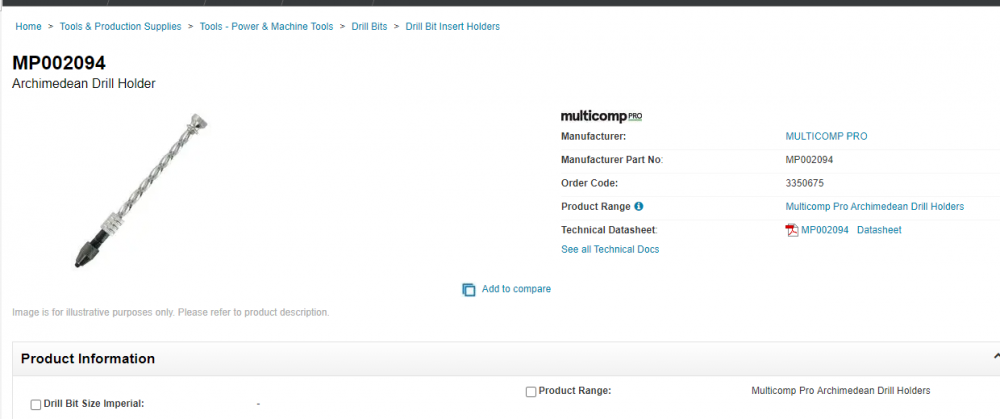

The answer is it depends! Have you tried an Archimedes drill? Dremel etc are good but really need to be in a stand for work like that. Am assuming you have dimpled the work piece first, and are using lubricant ?

If by 'hand drill', you mean this sort of thing, then a 0.5mm drill bit will struggle with the side-loads from the handle, however short it is mounted. The Archimedean drills are much safer, with fine bits, the driving force is along the drill axis, rather than across it.
Mini Hand Drill (2464) | Bromley Craft
These may have their uses, but they require care when using fine bits.
