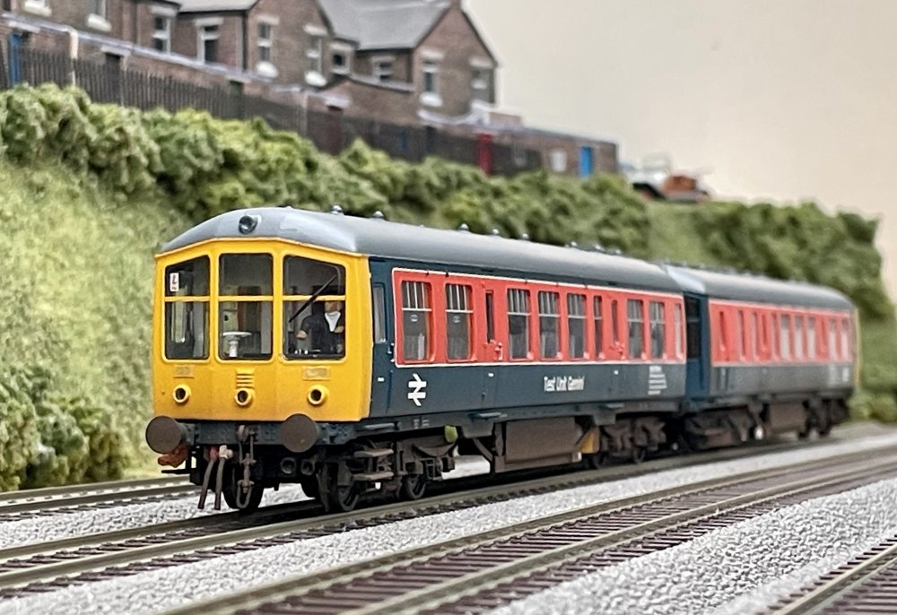

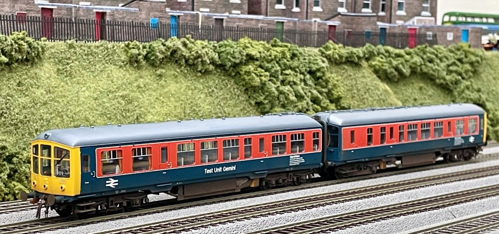

I have always been fascinated by the RTC fleet of locomotives, coaches and wagons.  When Rails announced that they had commissioned Bachmann to produce Test Unit Gemini, I duly placed an order.
The unit is nicely finished but a major issue is that the standard diesel traction undergibbons remain beneath the units as per the standard Bachmann Derby Lightweight unit where there should be the batteries that give rise to the unit’s BEMU description.

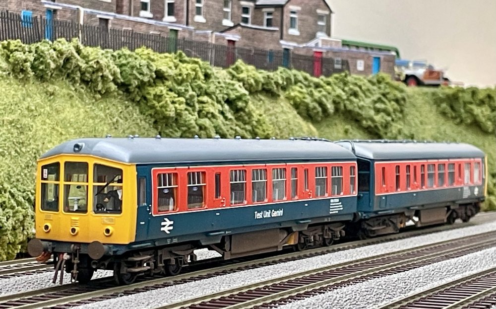

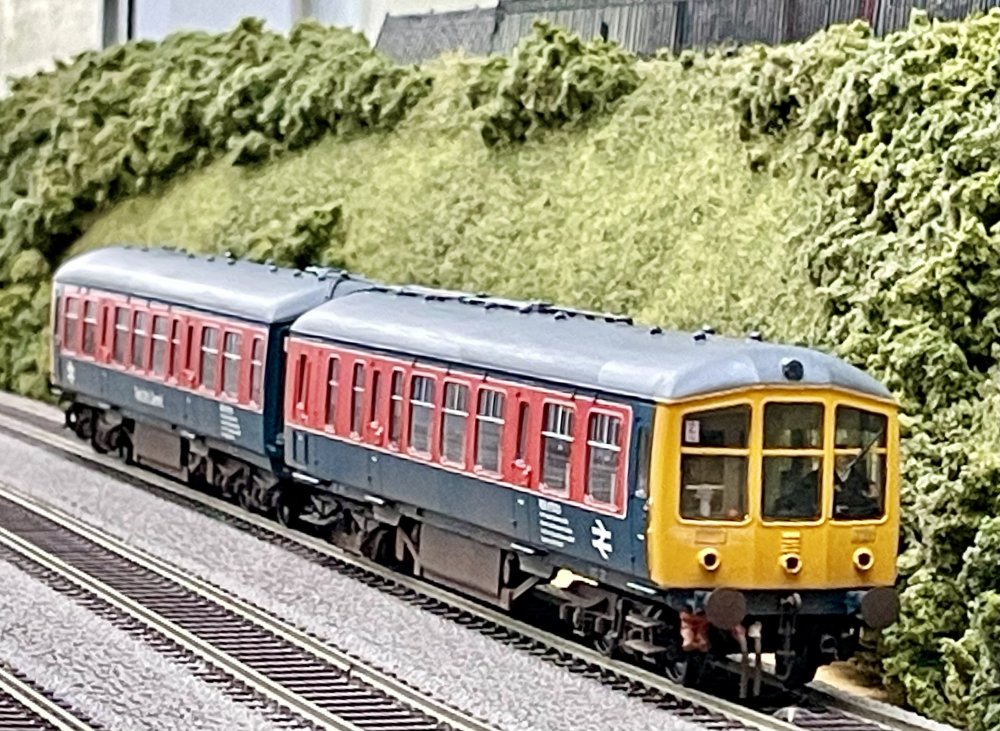

To rectify this, I first removed the standard undergibbons, which became useful additions to the spares box.

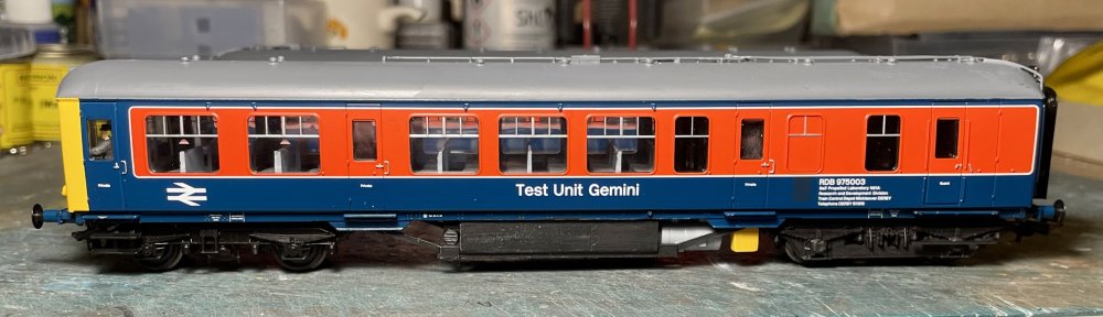

Using reference photos I made a card template for the battery box and framing that is a major feature of these units. This was tacked to the model and tweaked to make sure it looked right.
The template was then used to make model battery boxes and frames using plasticard.
Once assembled, these were primed, glued to the model and painted black.
There are more undergibbon bits to fit and the motor coach needs a replacement bogie frame - I have a spare one from a GWR railcar somewhere.
Cheers
Darius

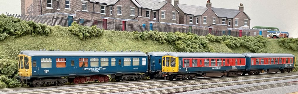

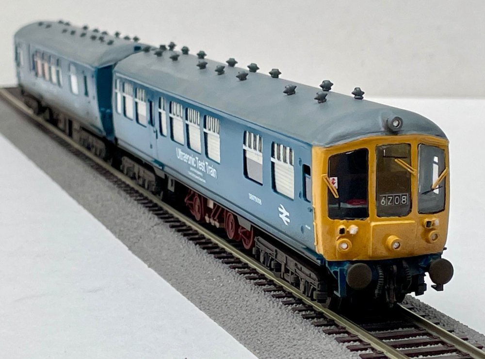

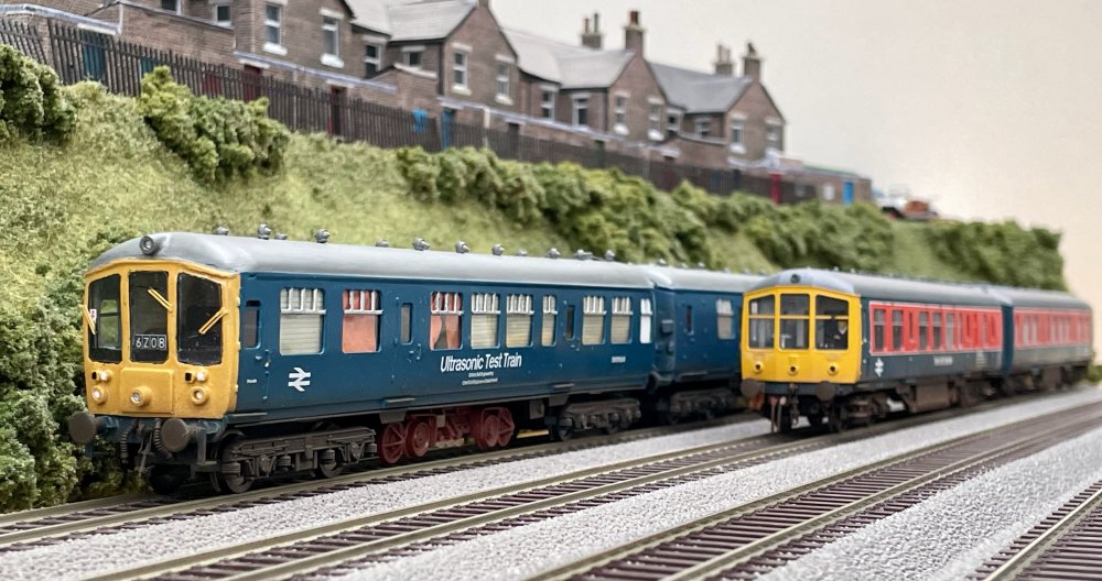

Thats nice, surprised they did it as the BEMU and not the 2 car 'Ultrasonic Test Train' which was diesel powered with the ultrasonic trolley under the trailer car. Bachmann tooled a few variants of the Derby Lightweight too so the 'green' livery was the correct one to use for the Ultrasonic one. Im sure one of the 3D printing firms will make the parts for Gemini in time, or Rails will heavily discount it as it is not selling......
I suspect the Ultrasonic Test Train would have been more of a challenge with respect to the undergibbons and more obviously incorrect if Bachman left the standard DMU kit in place as they have done with Gemini.

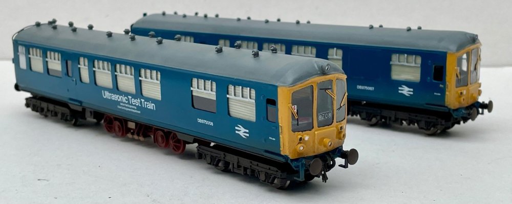

I built the MTK version of the Ultrasonic Test Train earlier this year.
Cheers
Darius

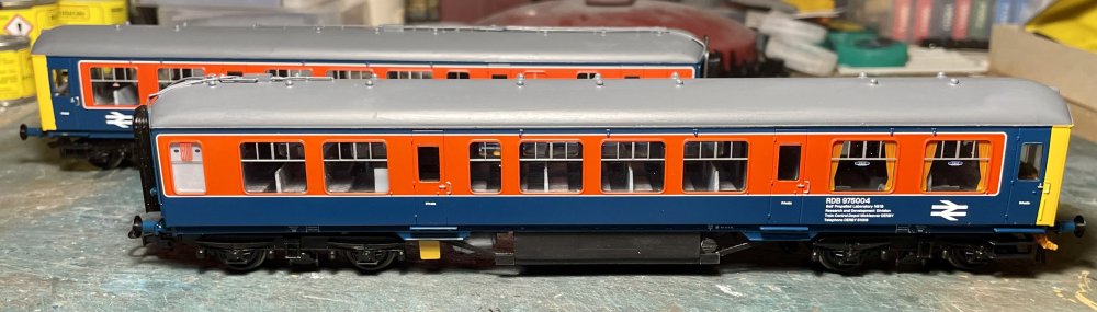

Hornby GWR railcar bogie side frames fitted to Bachmann motor bogie assembly.
Modified bogie assembly re-fitted and scratch built plasticard undergibbon parts fitted.
Cheers
