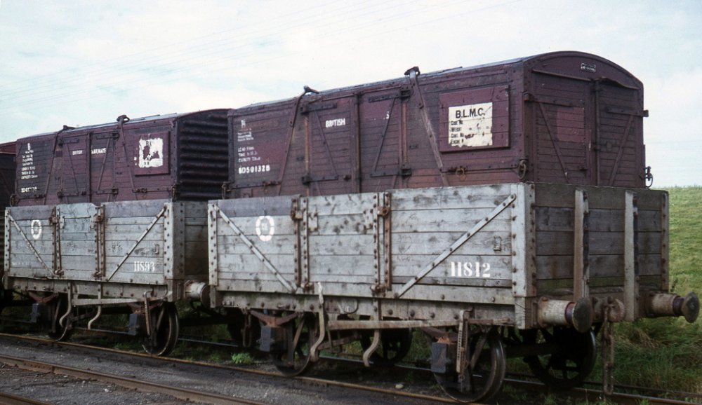

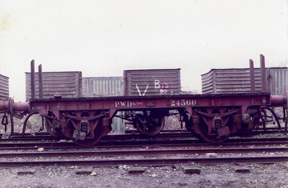

Mayner Posted January 15, 2023 Share Posted January 15, 2023 The GNR(I) & NCC built purpose built flat wagons for Bread Container traffic from the 1930s onwards Jeremy Suter produced a single run kit of these wagons about 20 years ago. CIE appears to have carried the older style containers in open wagons, before developing purpose built 20' Flat wagons for container traffic during the 1960s. The GNR and later CIE introduced aluminium bodied containers similar in outline but larger than the BR containers for Donegal freight traffic passing under customs bond through Northern Ireland BR containers in IRCH standard open wagons Studio Scale Models produce a whitemetal kit of the wooden underframe version of the open as seen in the photo. Industrial Alcohol containers on 20'-11'wb-12T capacity flats. These wagons were introduced for container traffic (including Guinness 3 containers) during the early 60s, but converted to PWD use following the introduction of 20'-12'wb-20T flats during the mid 1960s. The above photos were originally published on photo sharing site, I don't know the identity of the original photographer. 20'-11'wb container flat converted for PWD use. The Airfix/Dapol Cattle Wagon chassis would be reasonably close for one of these wagons. 2 7 Quote Link to comment Share on other sites More sharing options...

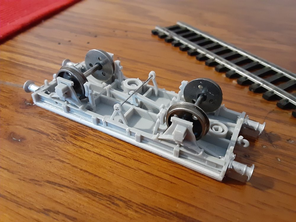

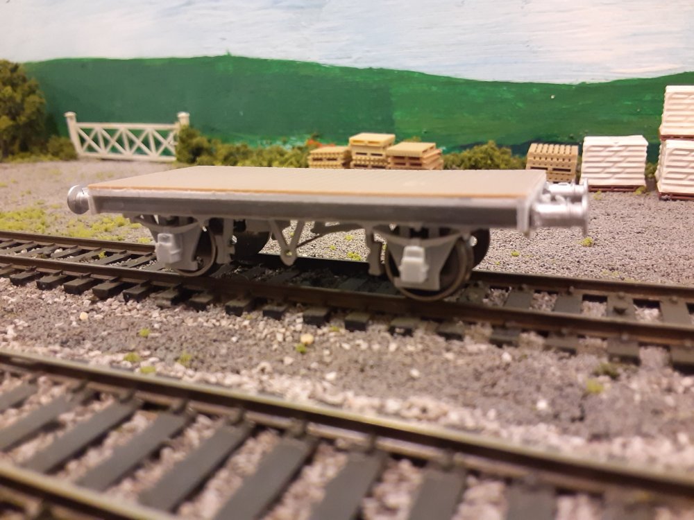

patrick Posted January 18, 2023 Share Posted January 18, 2023 (edited) Having two Dapol cattle wagon kits at hand I decided to have a go at building a representation of a 20' 12' wb flat following John's suggestion. It came out so well I am now sorry I didn't spend more work on the solebars. They will be painted brown as John's photo shows and will receive a load of sleepers. The end stanchions will be applied after the deck is painted in order to make painting easier. Edited January 18, 2023 by patrick 13 Quote Link to comment Share on other sites More sharing options...

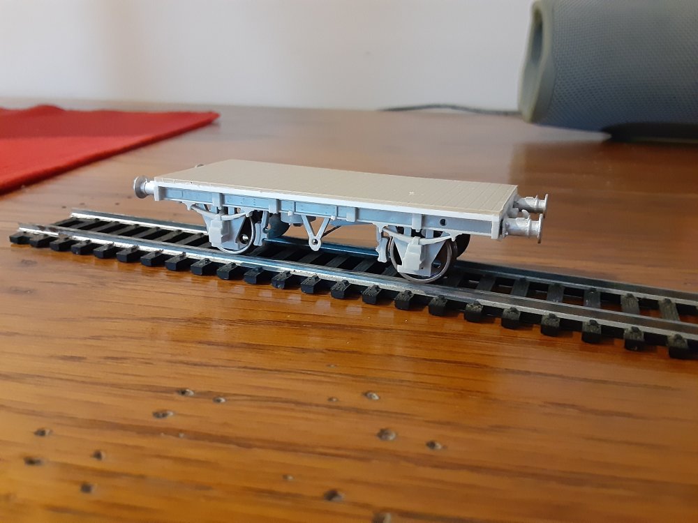

patrick Posted January 20, 2023 Share Posted January 20, 2023 The solebars started to bother me but this was soon sorted with the help of some filler, a chisel blade and sand paper. 7 Quote Link to comment Share on other sites More sharing options...

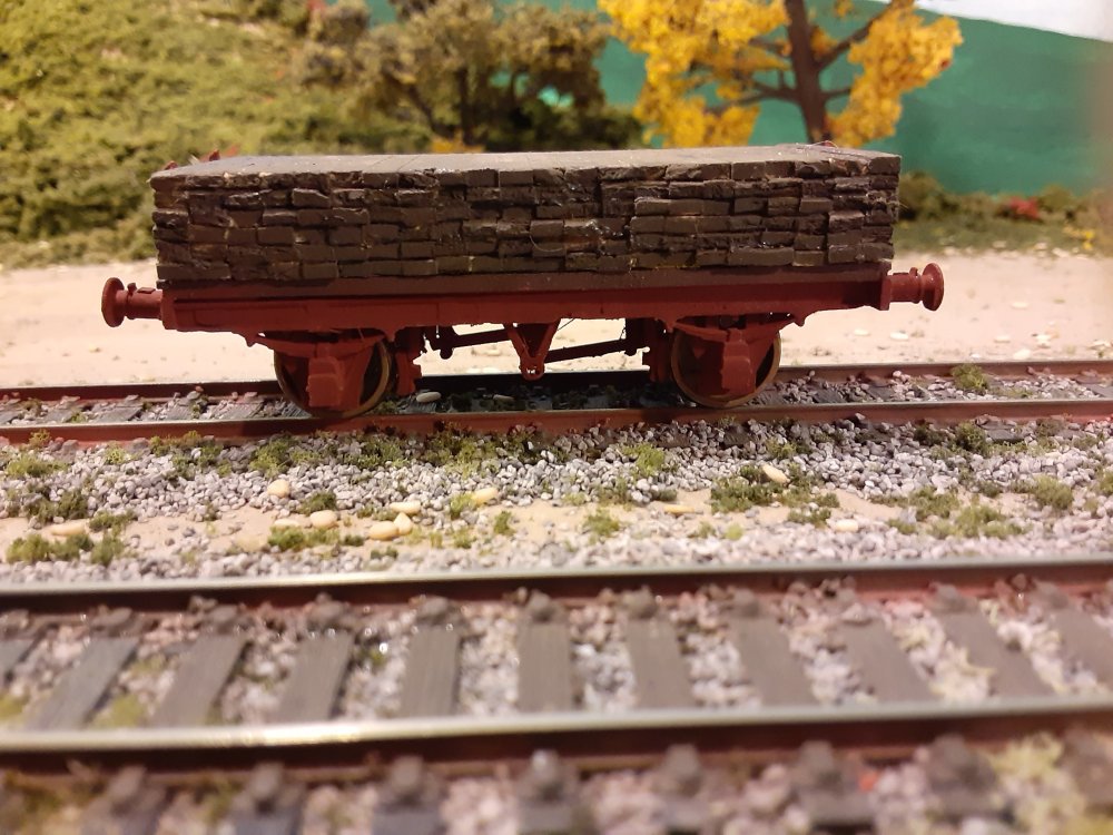

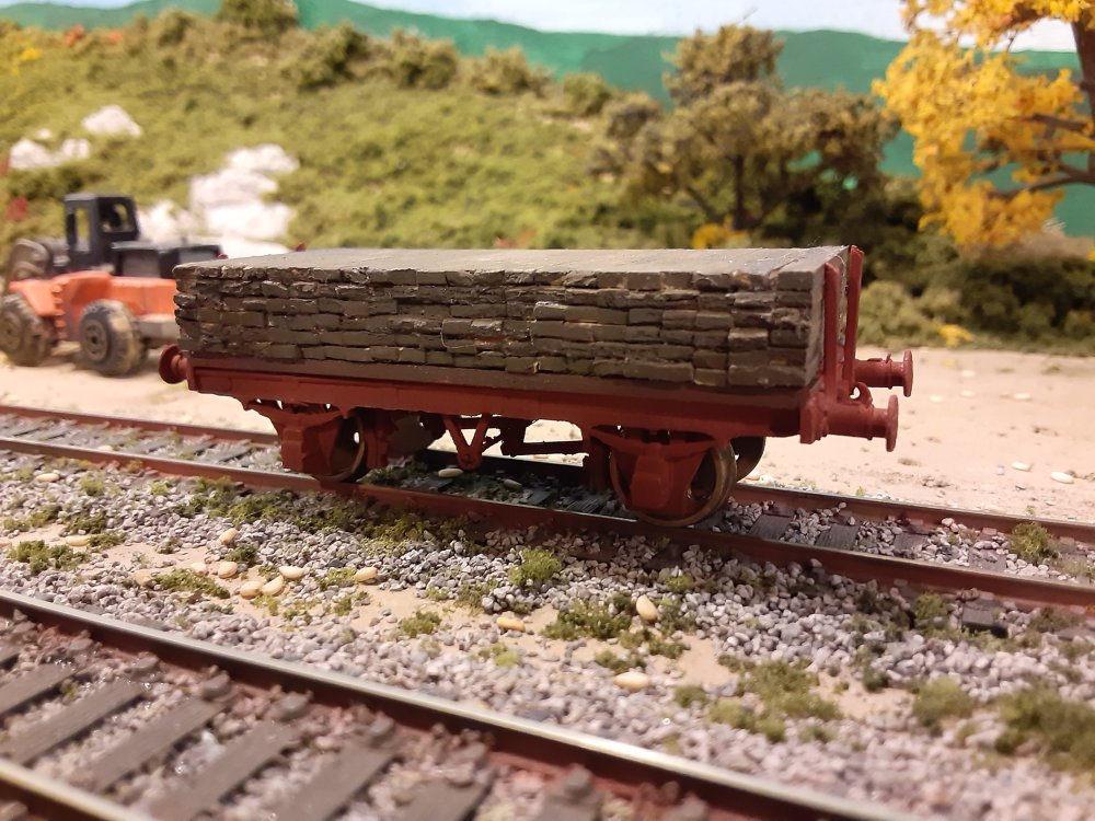

patrick Posted January 27, 2023 Share Posted January 27, 2023 20' 11'wb flat with sleeper load. 7 Quote Link to comment Share on other sites More sharing options...

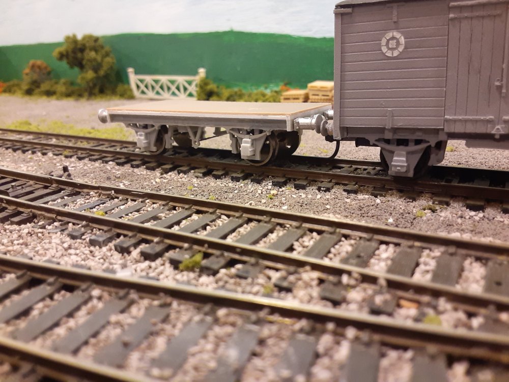

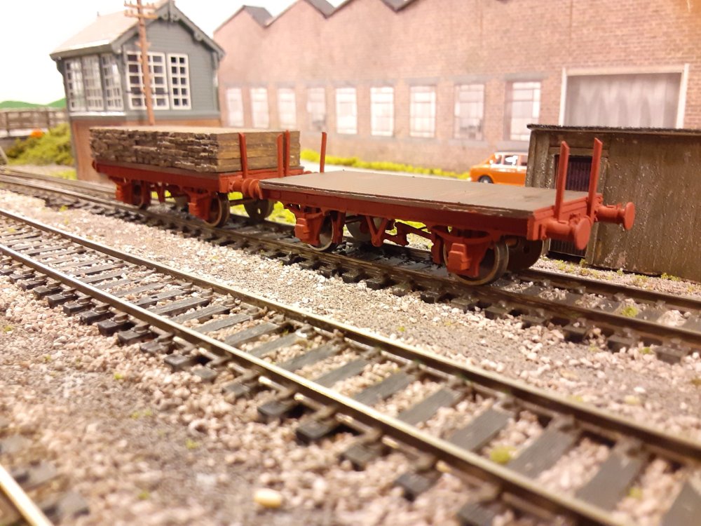

patrick Posted January 27, 2023 Share Posted January 27, 2023 The second flat fresh from the paintshop. 6 Quote Link to comment Share on other sites More sharing options...

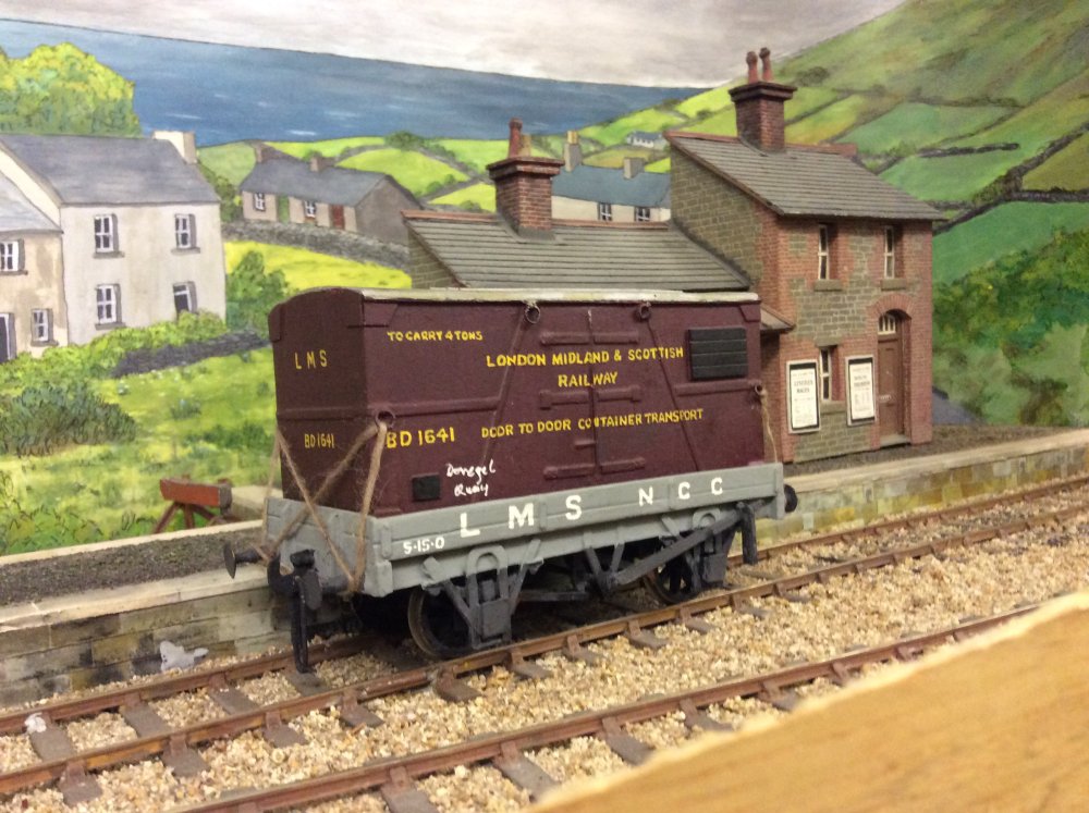

Dun Aucht Posted February 5, 2023 Share Posted February 5, 2023 Bit late to this thread. NCC Bread Containers were fitted to flat wagons. The NCC used a different system of fixing the bread containers to their wagons than the GNR(I). It is one of the reasons the Inglis bread containers were different shades on the GNR(I) and NCC. It was an easy way of making sure the right containers went to the right railway. Have attached photos and drawing from the album prepared by the UTA at the time of purchase of the NCC. As far as I am aware, the cattle container was an experiment to move cattle by road and not have to reload them into a wagon. There are two versions of container, the wooden one is marked for furniture and the steel one is just branded Ulster Transport. It obviously has had use judging by the dings in the body, but has been given a smart repaint for the photographs. I have also attached a Henry Casserley photograph of a VS Class 4-4-0 at Dublin with a Raleigh bicycle container to the left of the loco. There are not many photos of these containers known, but Raleigh Ireland did move a lot of the produce from their factory in Dublin by rail. 1 6 Quote Link to comment Share on other sites More sharing options...
