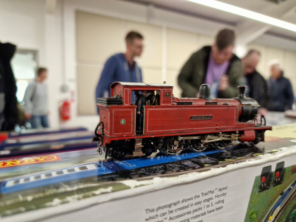

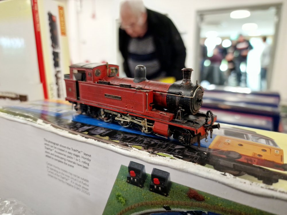

BomberCountyModels Posted June 6, 2023 Posted June 6, 2023 Hi folks, I had this model come my way the other day, not a irish modeller myself, but I trade in kit built items, a friend gave me some information on it as listed above, just wanted some more information if possible as I will be listing for sale. Thanks in advance 4 Quote
Horsetan Posted June 6, 2023 Posted June 6, 2023 This is a OOn3 (not actually TT gauge, even though it uses 12mm gauge track) model of the CDR's Nasmyth-Wilson Class 5 2-6-4T no: 6 Columbkille. The real thing still exists inside the Foyle Museum in Derry. Built from the long unavailable Backwoods kit, there's a bit of damage /distortion to the central buffer at the front - should be level, not pointing upwards. Rivetted smokebox is correct for no.6. Does it run? 2 1 Quote
BomberCountyModels Posted June 6, 2023 Author Posted June 6, 2023 Thanks for that info, very kind of you, it runs beautifully, been built very well Quote

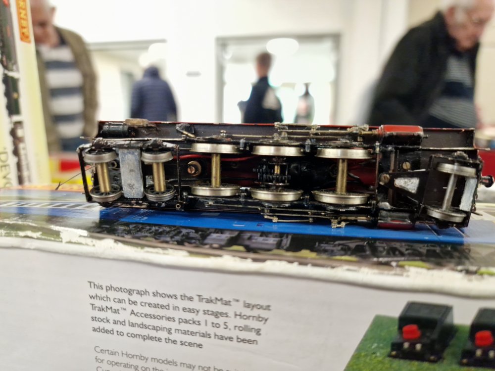

Horsetan Posted June 6, 2023 Posted June 6, 2023 The underside photo suggests it's been fitted with the "Porter's Cap" gearbox which was supplied as part of the kit and which is broadly similar to today's "High Level" gearbox kits. (I did wonder if "Porter's Cap" and "High Level" were related to each other.....) 1 1 Quote
BomberCountyModels Posted June 6, 2023 Author Posted June 6, 2023 I'll have a closer look at it tomorrow and see if it's fitted with a portescap motor, your knowledge us invaluable, thank you Quote
Horsetan Posted June 6, 2023 Posted June 6, 2023 10 minutes ago, BomberCountyModels said: I'll have a closer look at it tomorrow and see if it's fitted with a portescap motor... No, no, not Portescap, but "Porter's Cap" - a play on a name for what was a much cheaper, multi-stage worm and spur gearbox, as opposed to the RG4 with its bevel-and-spur reversible drive. 2 1 1 Quote
