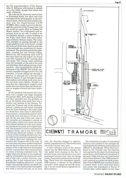

seagoebox Posted May 29 Share Posted May 29 From an article by D G Coakham. 4 1 Quote Link to comment Share on other sites More sharing options...

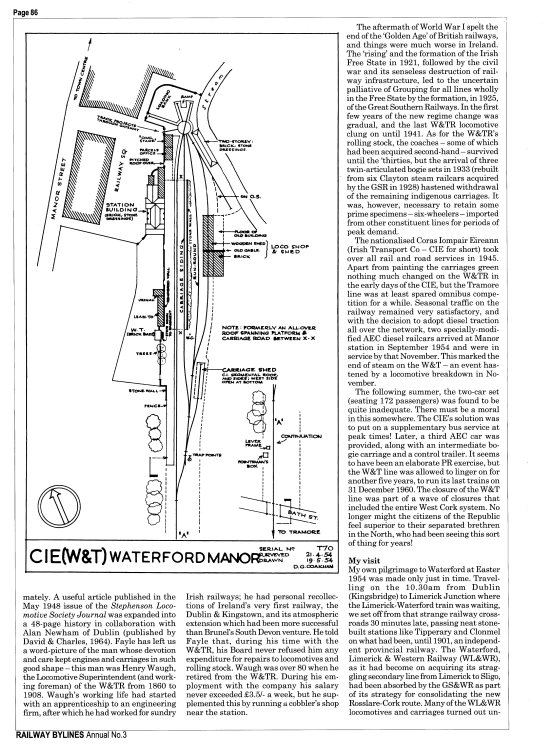

226 Abhann na Suire Posted May 30 Share Posted May 30 (edited) 1 hour ago, jhb171achill said: At the very end, the only points were at the waterford end, and there were (I think) just two! Tramore was a dead end. Waterford had the platform road and two sidings, one into the shed. Not even a run-round loop. the entire rolling stock was just three AEC railcars and two coaches, one fitted as a driving trailer. Had it survived, it's a reasonable assumption that today it would have but one set of points (at Waterford) and a pair of 2-car 26 class railcars! I could be wrong but I thought Manor Street had a run around loop outside of the trainshed (if you’d even call it that…) Not sure though… definitely were a few sidings though with one at the southern end of the station dropping down to the road on Bath Street for road access for removing the locos for maintenance. The AECs were delivered here too. Such a shame that it closed. I’m a Waterford native and the bus route that replaced it is jam packed at all hours of the day, especially in summer so the train would have done a roaring trade if supported by a local Tramore route that brought people into the station. I’ve already wondered would it have been connected to the network somehow if still around…? Probably not given that a large tunnel seems to be the only option of doing so… Still the line would have been an excellent test-bed for the new battery DARTS and in ideal candidate for electrification too! Very sad that it’s gone it was such a unique piece of railway infrastructure 15 hours ago, GSWR said: I'm looking into putting together a layout depicting Tramore Railway Station some time in the 1930s, but I can only find pictures of the exterior of the station and the platform. I remember seeing a diorama of the station years ago, and the only thing I can remember is that there was a turntable, although I'm not sure about the accuracy of this. If anyone knows anything, or has a layout map that could help me it would be fantastic. Thanks in advance! And hats off to you @GSWR for such a project! I’m jealous you got around to it before I did but please keep us all posted!! A couple of Studio Scale Models J26s and a Silverfox AEC will look gorgeous on it!! Edited May 30 by 226 Abhann na Suire 2 Quote Link to comment Share on other sites More sharing options...

RobertRoche Posted May 30 Share Posted May 30 11 hours ago, 226 Abhann na Suire said: I could be wrong but I thought Manor Street had a run around loop outside of the trainshed (if you’d even call it that…) Not sure though… definitely were a few sidings though with one at the southern end of the station dropping down to the road on Bath Street for road access for removing the locos for maintenance. That appears to be correct looking at this old map 2 1 Quote Link to comment Share on other sites More sharing options...
Irishswissernie Posted May 30 Share Posted May 30 (edited) On my Album https://www.flickr.com/photos/irishswissernie/albums/72157711590538817/ there is also a JW Armstrong negative at Tramore and you can just make out the end of a van off the turntable siding which was at the platform side end. There were 6 lines off the turntable, 3 serving loops for the platform, carriage shed and run round and 3 dead ends , one of which has space for 2 wagons on it. Edited May 30 by Irishswissernie 8 Quote Link to comment Share on other sites More sharing options...

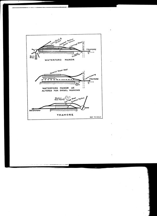

seagoebox Posted May 31 Share Posted May 31 3 Quote Link to comment Share on other sites More sharing options...
jhb171achill Posted June 1 Share Posted June 1 On 31/5/2024 at 6:05 PM, seagoebox said: At the very end, Waterford had the middle layout and Tramore was just a dead end…. Quote Link to comment Share on other sites More sharing options...
