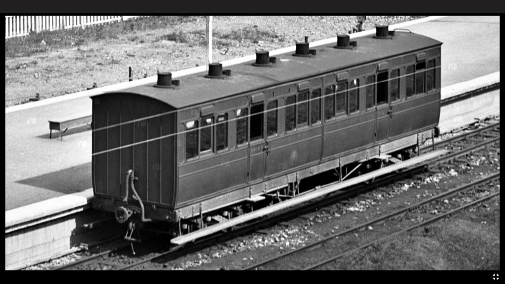

HI Rob.
Thank you for finding the album photos. It now poses a new problem, in that there is a photo in there of coach No 42 of the CB&PR. As far as I knew, they didn't have one with a number going that high but stopping at 36, I also knew that they missed out on a few coach numbers, but unless that is down to the research in the past, I think they only had about 28 coaches in total.

Is Coach 24 one of your missing ones, Colin? Henry Casserley photographed it in 1932 and as I (The Syndicate) have both a Glass negative of it and a normal negative of it, I should be able to oblige. I don't seem to have scanned it yet.
Let me know.
Leslie

If it’s of any help, livery details for CBPR carriages were - mud grey roofs, black chassis, dark green sides, probably with yellow lining but lining colour not reliably documented anywhere I’m aware of.
Ends almost certainly green too.
From looking at pigments, I believe the green was probably something like what British Railways had onnsteam engines in the 1950s.
Locos were black, with red lining.
On takeover by the GSR, the four locos were painted grey pretty quickly, and the carriages painted in full GSR maroon livery. Even many of the station signs were quickly replaced by standard GSR bilingual enamels.
On the subject of GSR coach B livery, while the standard was black coach ends, I’ve found quite a few instances of the dnds being maroon as well, often on narrow gauge types. With several Passage coaches having observation ends, I wouldn’t be surprised if all stock on that line was like that.
