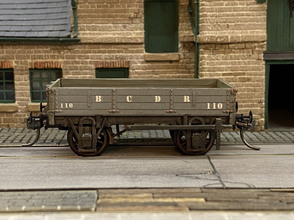

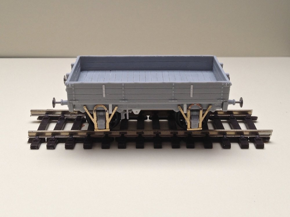

Tullygrainey Posted April 2, 2025 Posted April 2, 2025 (edited) As a modeller of the BCDR, I’m always on the lookout for RTR models or kits that could be hacked into something approximating County Down stock and I have to say the pickings are pretty slim both for locomotives and rolling stock. Honourable mention must be made here of @leslie10646's Dapol conversions of BCDR opens and EDSS coal wagons which were/are beacons of hope in an otherwise empty space. More often than not, scratch building is the better option. Even that Kernow brake van will need a fair bit of work. As regards rolling stock, one of the most prominent features but also one of the biggest modelling challenges is the outside W-irons commonly seen on BCDR stock. If these are present on a model, it’s already well on the way to being convincingly BCDR to the extent that other inaccuracies can become less noticeable. I have used an etch from Dart Castings’ MJT range to model W-irons but it requires a tedious amount of cutting and soldering to produce something convincing yet even then not quite accurate. I have searched in vain for ready made etches that might make the job a bit easier. To end on a less pessimistic note, a Midland Railways 8 ton 3 plank drop side wagon from Slater's 4mm range of plastic kits provides a reasonable basis for a BCDR 8 ton open. Alan Edited April 2, 2025 by Tullygrainey 10

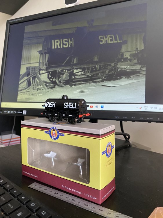

Mol_PMB Posted April 12, 2025 Posted April 12, 2025 I was looking at tank wagons today. I've come to the conclusion that the Oxford Rail tank wagon (which has been recently re-released) is near-identical to the smaller-diameter Irish Shell tank wagons, one of which is preserved by the RPSI. Here's the prototype, this isn't actually the RPSI one but it's the same; these are to the 1907 RCH standard and the photo dates from 1964 so they had a good long life: Here's the model: Here's the preserved one: For OO gauge this would just need re-lettering on the tank. I wonder how hard it would be to widen the frames for 21mm, and hide the join in the middle? 10
jhb171achill Posted April 13, 2025 Author Posted April 13, 2025 17 hours ago, Mol_PMB said: I was looking at tank wagons today. I've come to the conclusion that the Oxford Rail tank wagon (which has been recently re-released) is near-identical to the smaller-diameter Irish Shell tank wagons, one of which is preserved by the RPSI. Here's the prototype, this isn't actually the RPSI one but it's the same; these are to the 1907 RCH standard and the photo dates from 1964 so they had a good long life: Here's the model: Here's the preserved one: For OO gauge this would just need re-lettering on the tank. I wonder how hard it would be to widen the frames for 21mm, and hide the join in the middle? Yes, very much so. Unusually, some Irish tank wagons were actually built by British firms like Charles Roberts, whereas the vast, vast majority of non-passenger stock was built here. I’ve two of these things and they look the part. 1

flange lubricator Posted June 26, 2025 Posted June 26, 2025 On 12/4/2025 at 9:11 PM, Mol_PMB said: I was looking at tank wagons today. I've come to the conclusion that the Oxford Rail tank wagon (which has been recently re-released) is near-identical to the smaller-diameter Irish Shell tank wagons, one of which is preserved by the RPSI. Here's the prototype, this isn't actually the RPSI one but it's the same; these are to the 1907 RCH standard and the photo dates from 1964 so they had a good long life: Here's the model: Here's the preserved one: For OO gauge this would just need re-lettering on the tank. I wonder how hard it would be to widen the frames for 21mm, and hide the join in the middle? Here is an Oxford wagon I converted a while back. 4 1 1
jhb171achill Posted June 26, 2025 Author Posted June 26, 2025 (edited) 5 hours ago, flange lubricator said: Here is an Oxford wagon I converted a while back. Yes, I have two of those. They're near enough to what you'd have seen in the mid 1950s to mid 60s. My background is that at Dugort Harbour the local twice-a-day bus to the back'o'beyond was stabled at the station, a la Westport Quay, so every week or two a tank of diesel is attached to the goods to be dropped off there, and the empty one taken away....... it makes for an interesting extra light engine movement for the Castletown West pilot engine. Edited June 26, 2025 by jhb171achill 2
