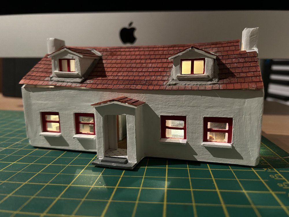

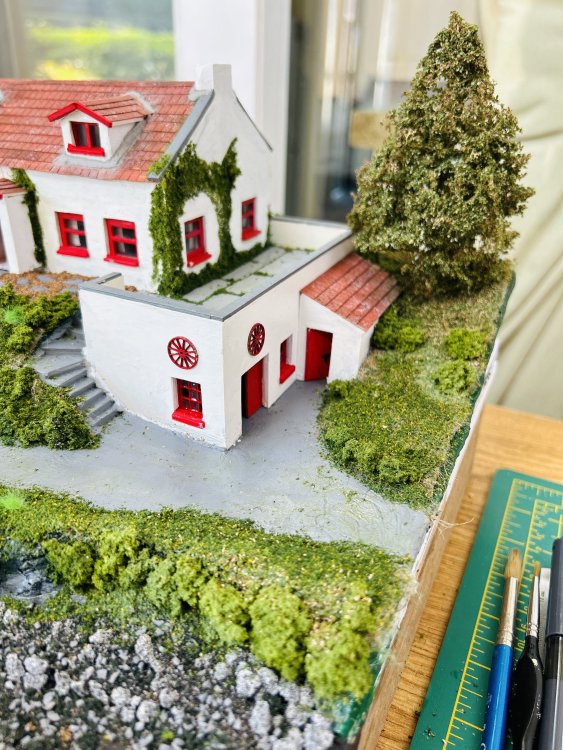

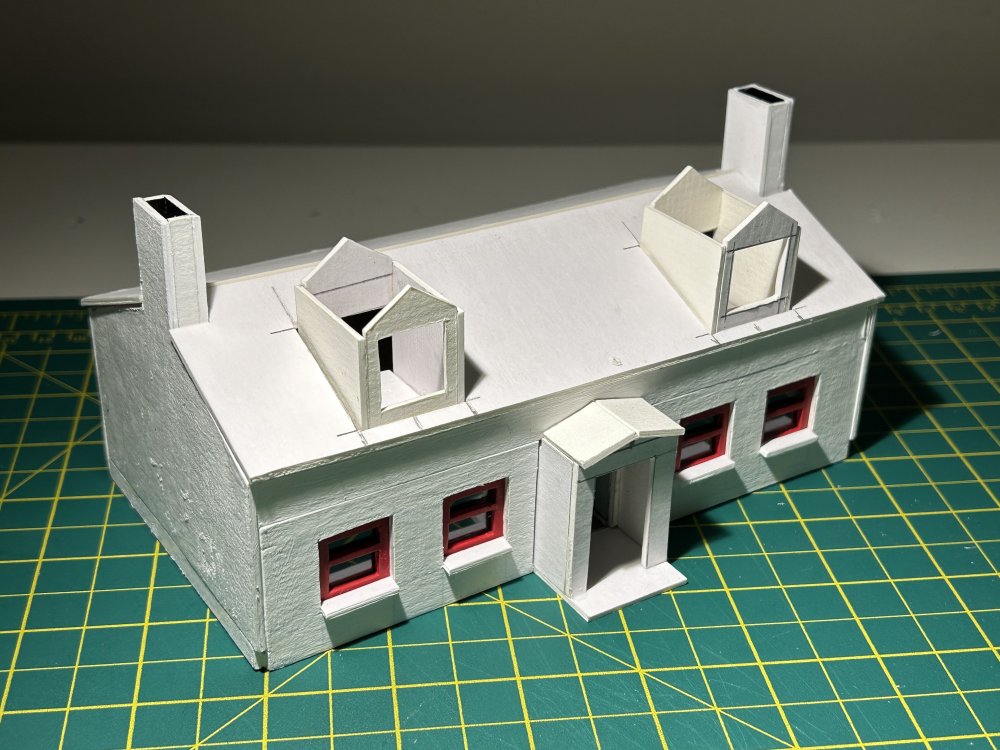

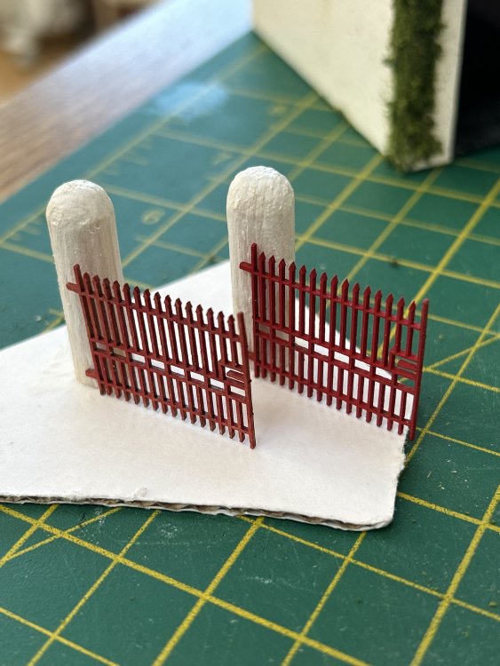

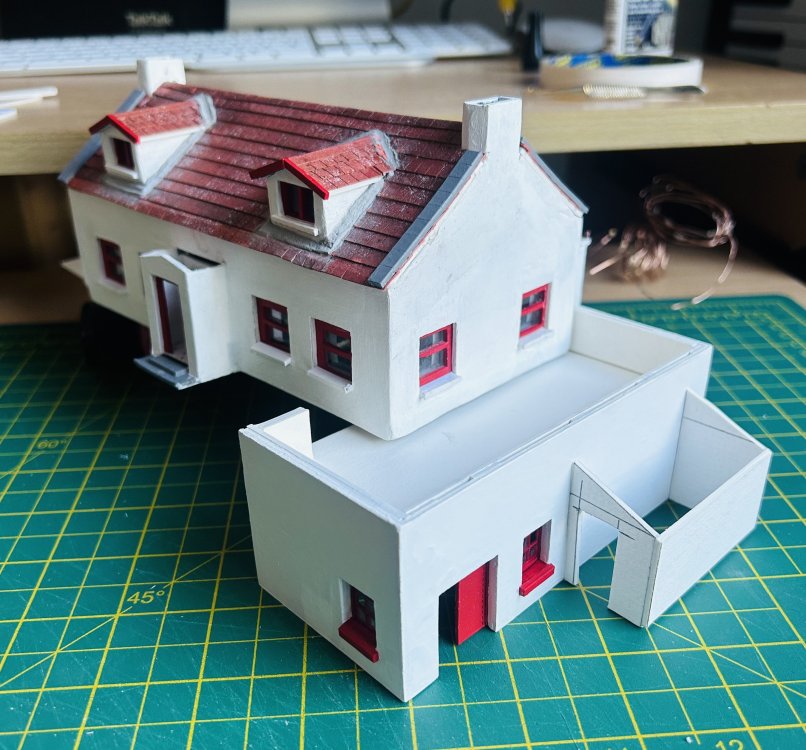

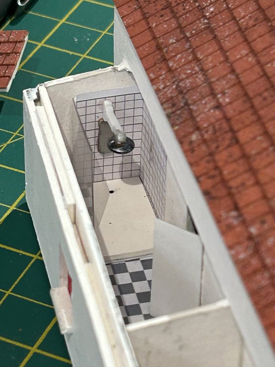

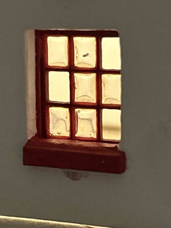

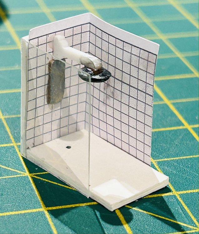

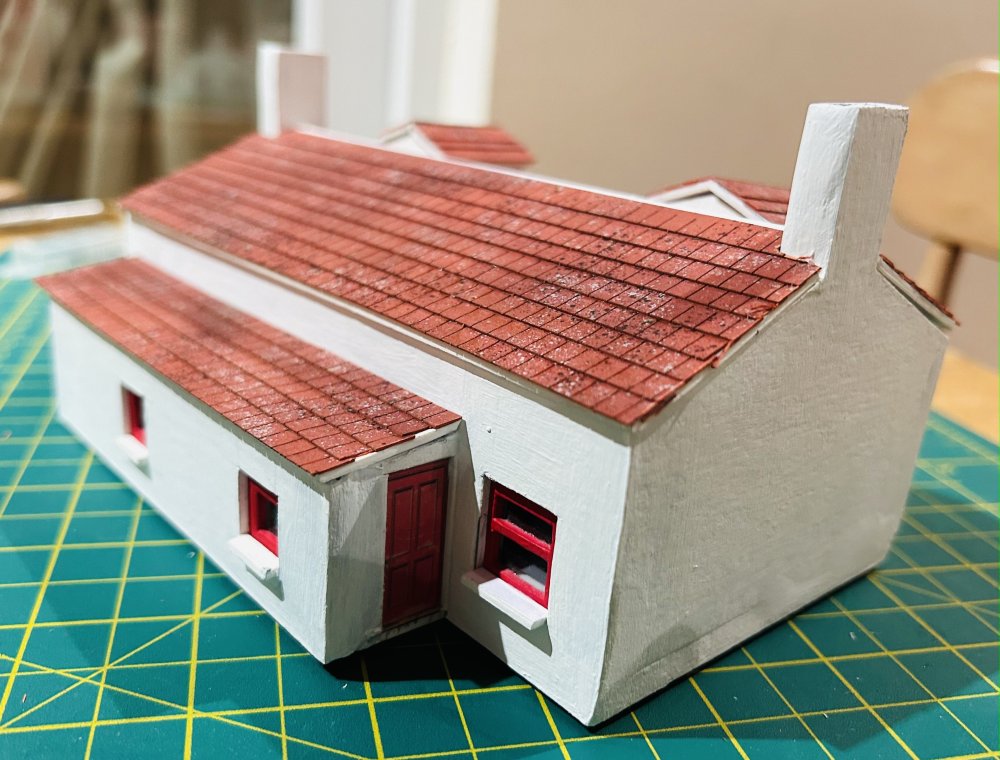

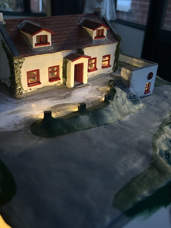

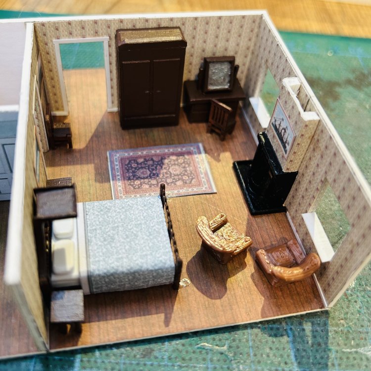

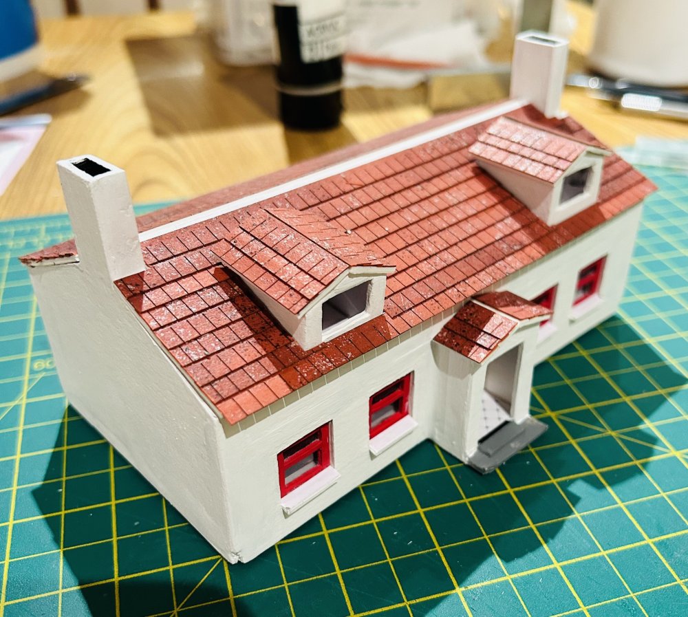

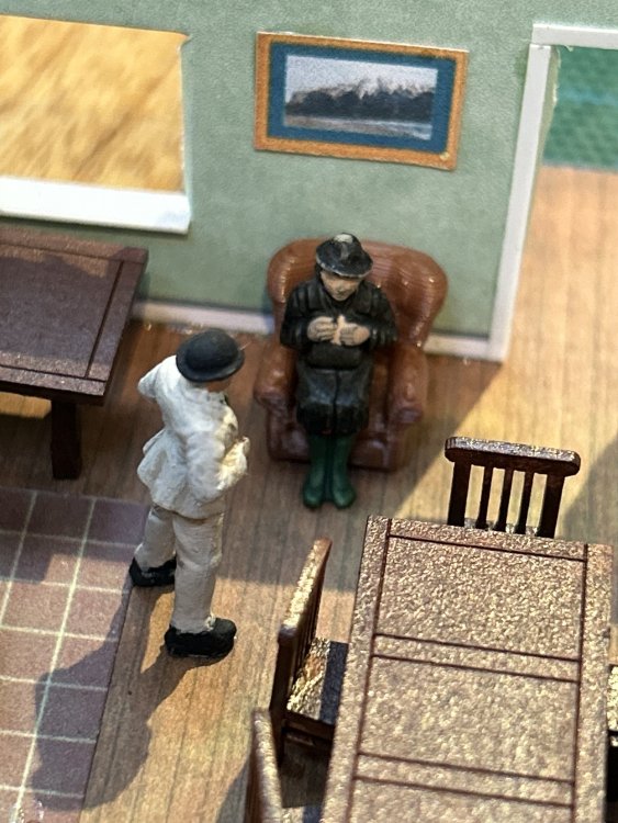

Patrick Davey Posted April 22 Posted April 22 Another of my 'banish the winter blues' projects was to have a go at building a cottage diorama, with an emphasis on including as much interior detail as I could realistically cram in. The interior is based on an original building once owned by my grandparents, which still stands today in King Street, Newcastle, Co. Down. The main building material for this project was 3mm mount board, with most details eg. furniture also built from this material. A few additional details are from Scale Model Scenery, including kitchen table & chairs, armchairs and terracotta roof slates. I have progressed the build sufficiently to share progress, as I reach the final stages. Some of the interior detail is known only to me (very obsessive) but most of it was photographed before the roof went on and interior lighting also shows much of it. Further updates will follow! 11 7

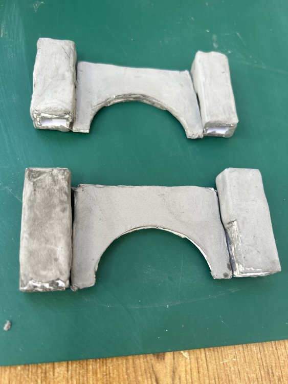

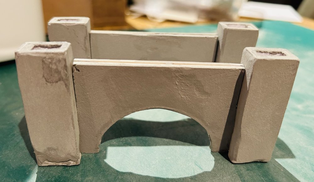

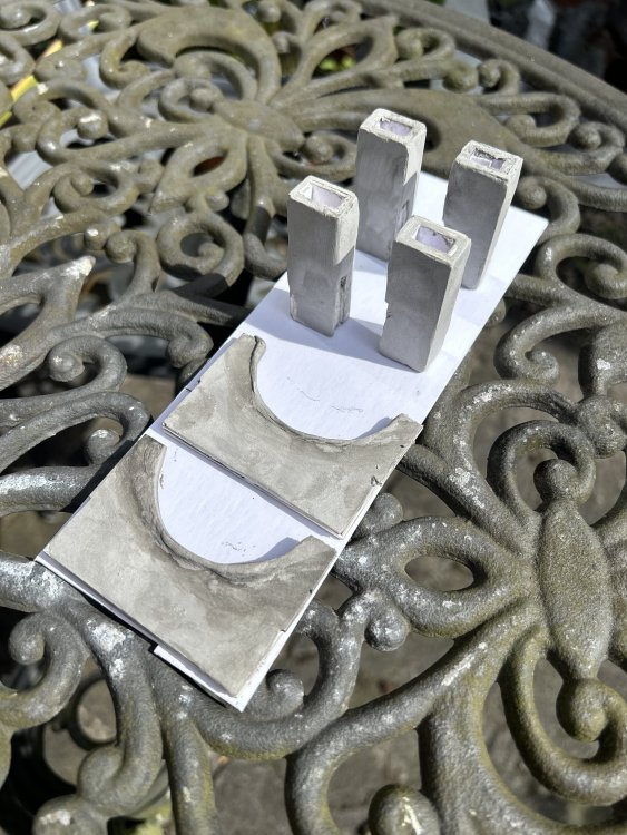

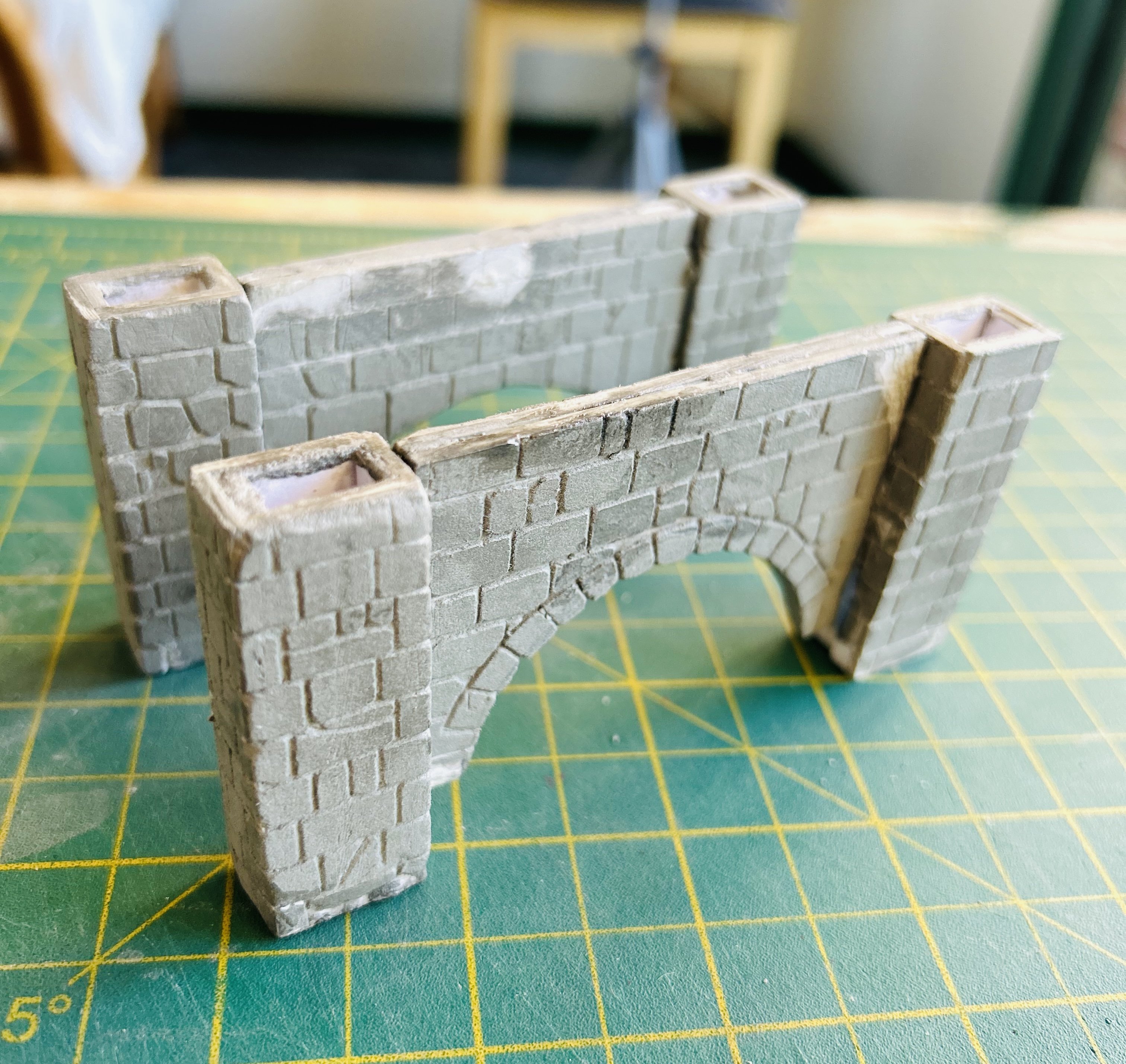

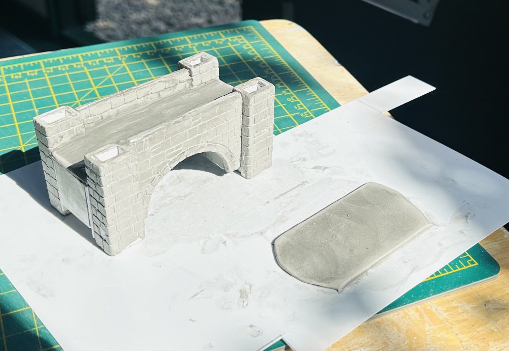

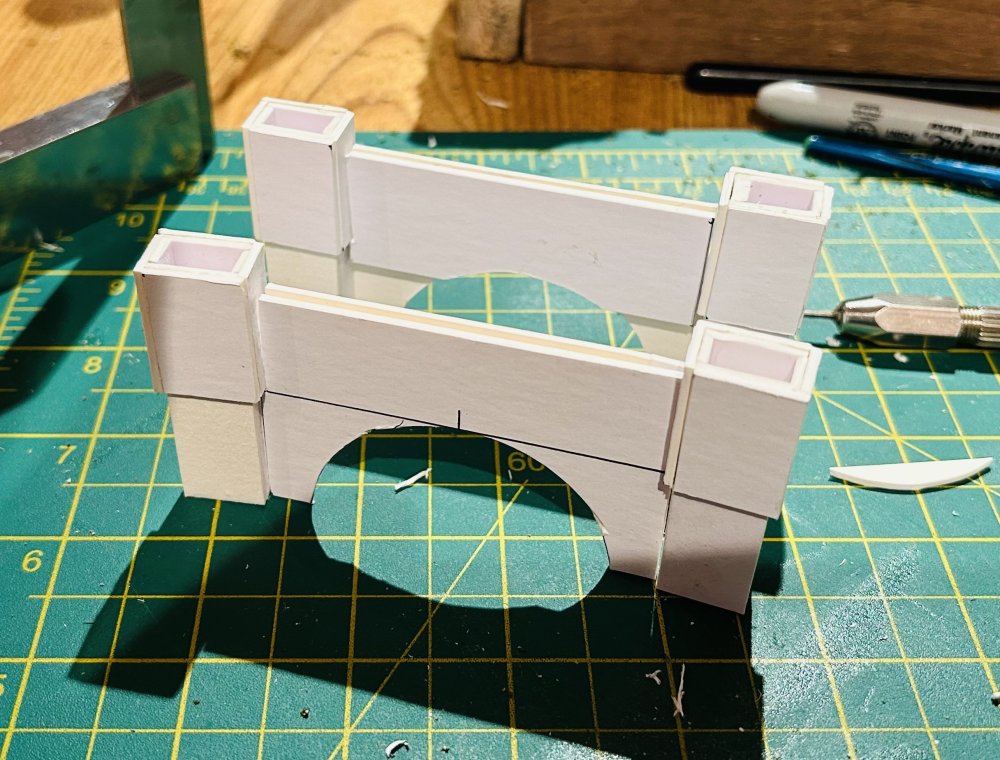

Patrick Davey Posted May 10 Author Posted May 10 (edited) Currently building a small stone bridge to cross the river below the cottage. The basic structure was constructed from mount board then Das clay was applied, once this was dry, the stonework was scribed. I have used the stone coloured variety of the clay and when it is fully dry, it gives a really authentic base colour which would probably only need weathering to complete the effect, although I am going to follow the example of Alan @Tullygrainey and paint the stonework in various colours of beige and brown. The extra slab of clay in the final photo will be used to create the coping stones and these will be applied individually. Edited May 10 by Patrick Davey 10

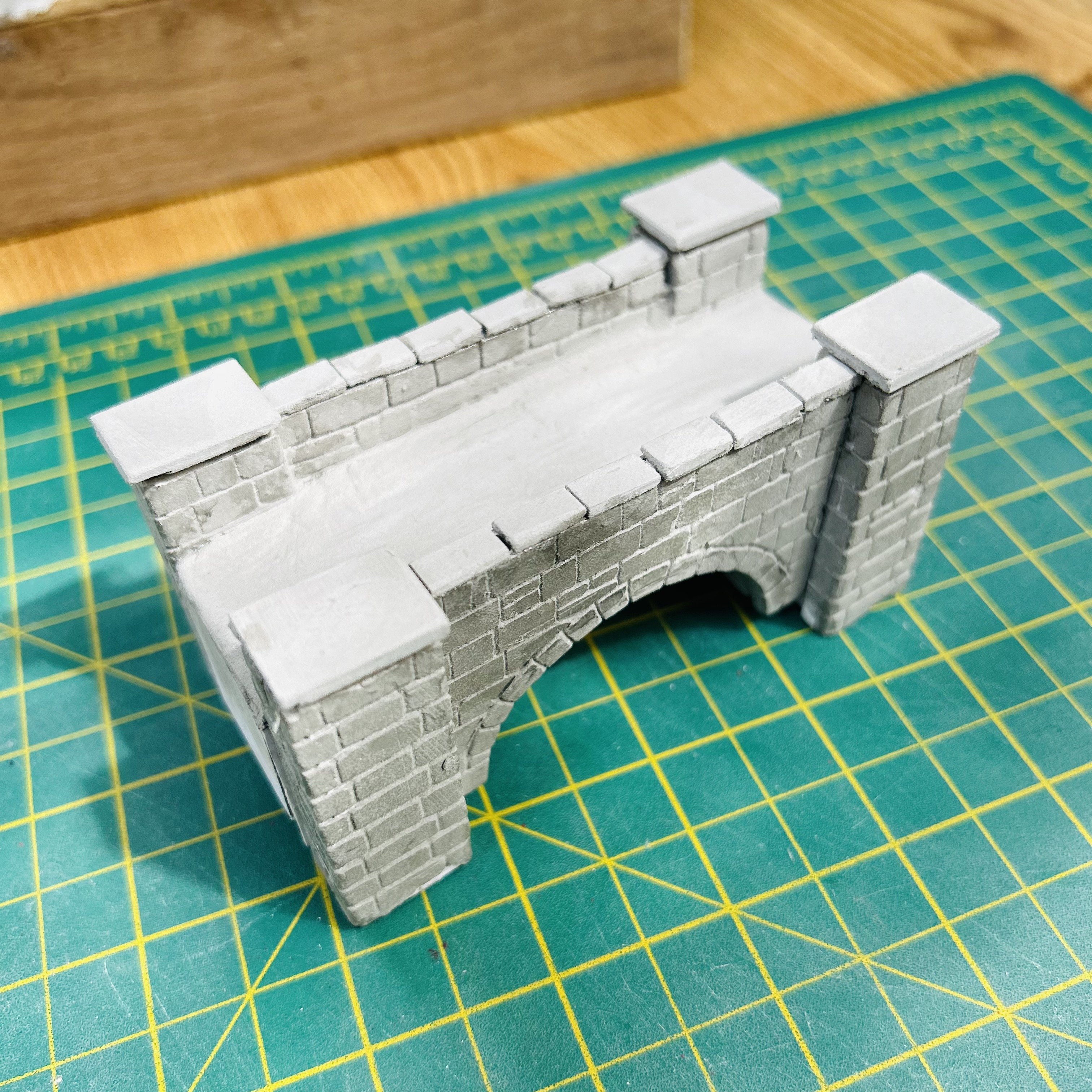

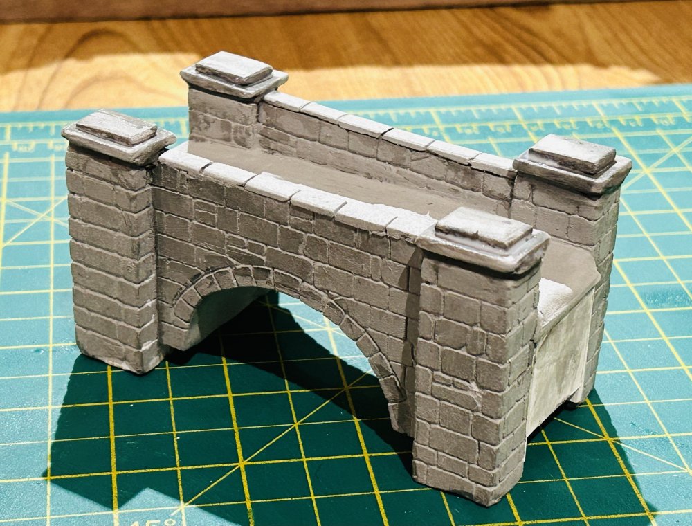

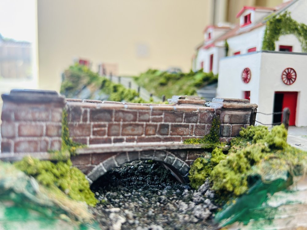

Patrick Davey Posted May 11 Author Posted May 11 (edited) The Das coping stones have been fitted - a bit more sanding and trimming needed but I do like how the clay dries to a good representation of stone. When the finished bridge is on the diorama, much of the lower stonework will be hidden and some of the upper stonework will be clad in ivy Edited May 11 by Patrick Davey 3
Patrick Davey Posted May 11 Author Posted May 11 Almost there - am really loving Das clay at the moment! 7 2

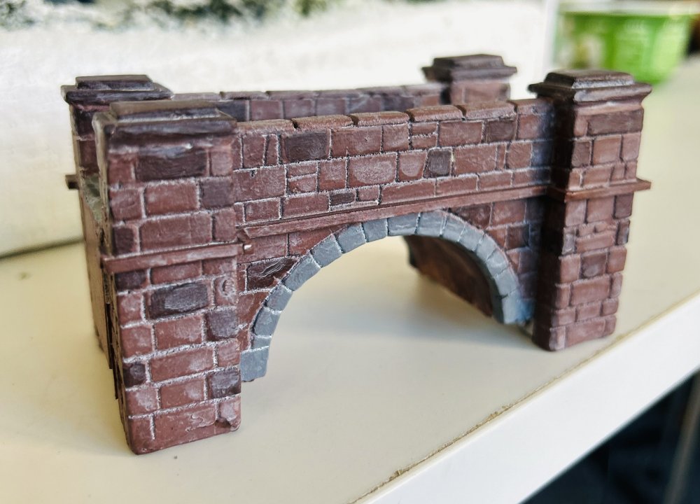

Mol_PMB Posted May 12 Posted May 12 Looks great, a lovely representation of smooth finished stone. Superb work! If you were to want a slightly more textured finish for your stone blocks on another structure, a good effect can be achieved with artists 'Matte Medium' dabbed onto the surface of the DAS after scribing but before painting, which is the technique I used here on my slow-burning Swiss project: 1 1

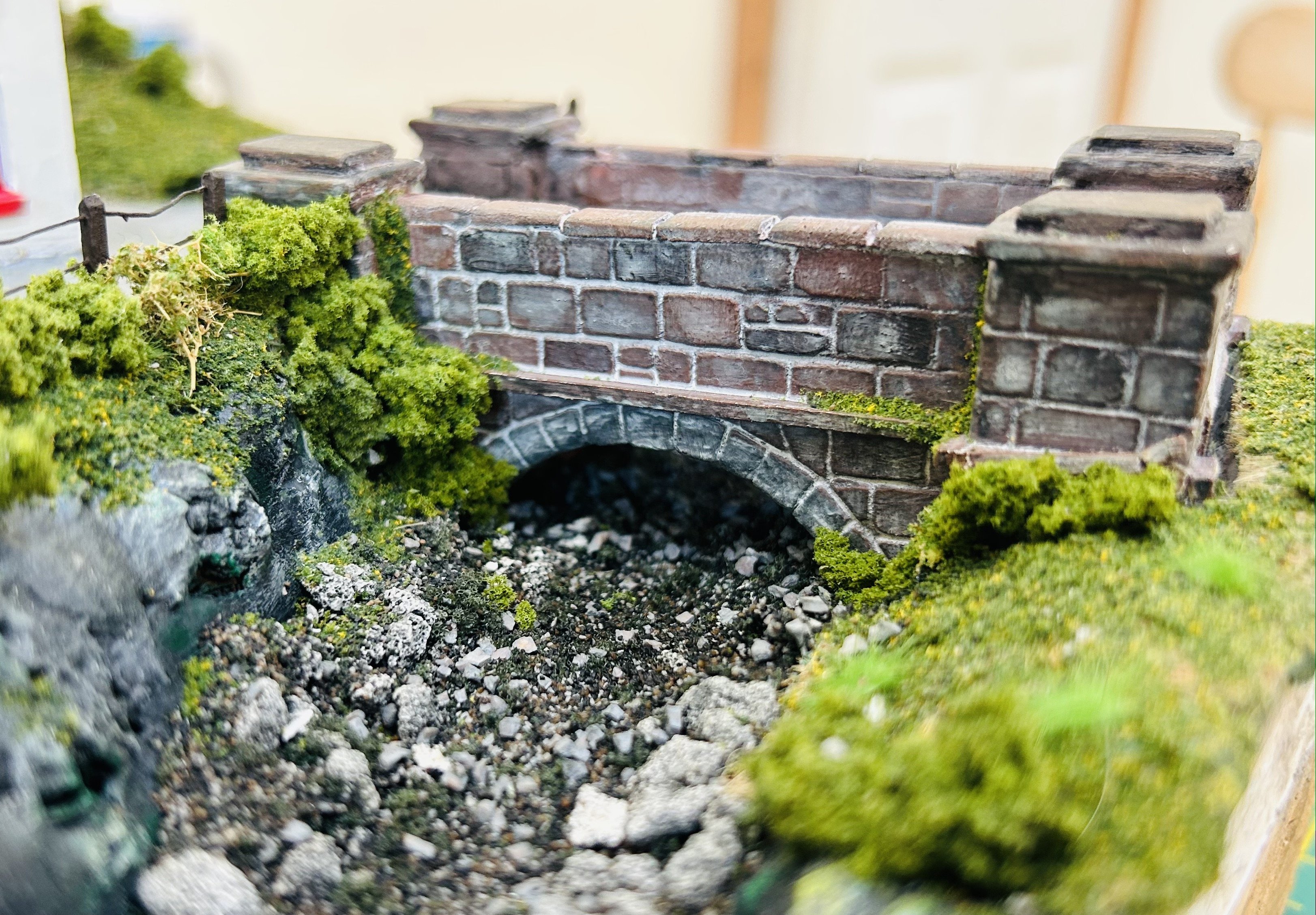

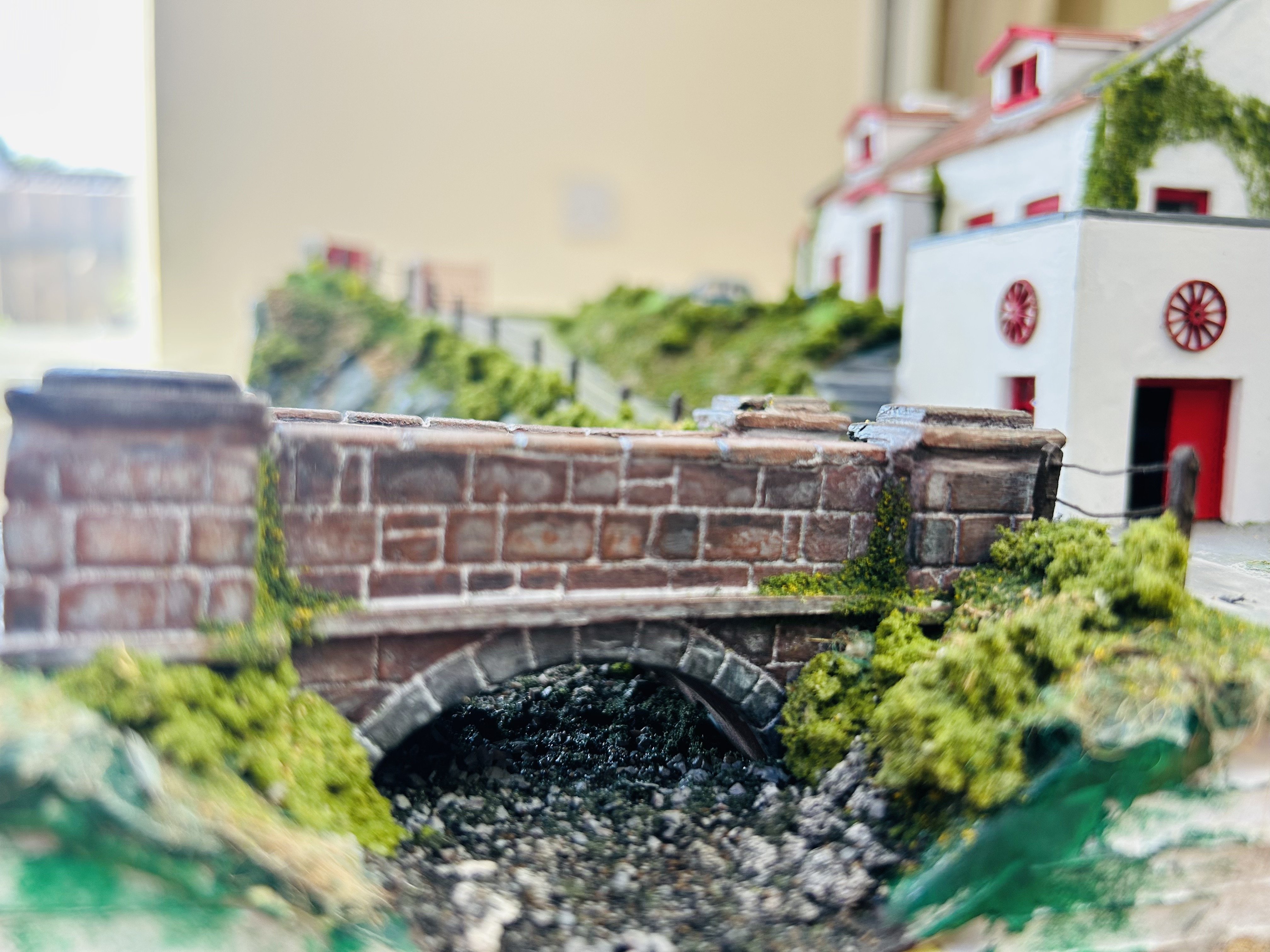

Patrick Davey Posted May 13 Author Posted May 13 Painting of the bridge has gone in an unexpected direction, it’s producing something of a sandstone effect, which I actually quite like: 3 3

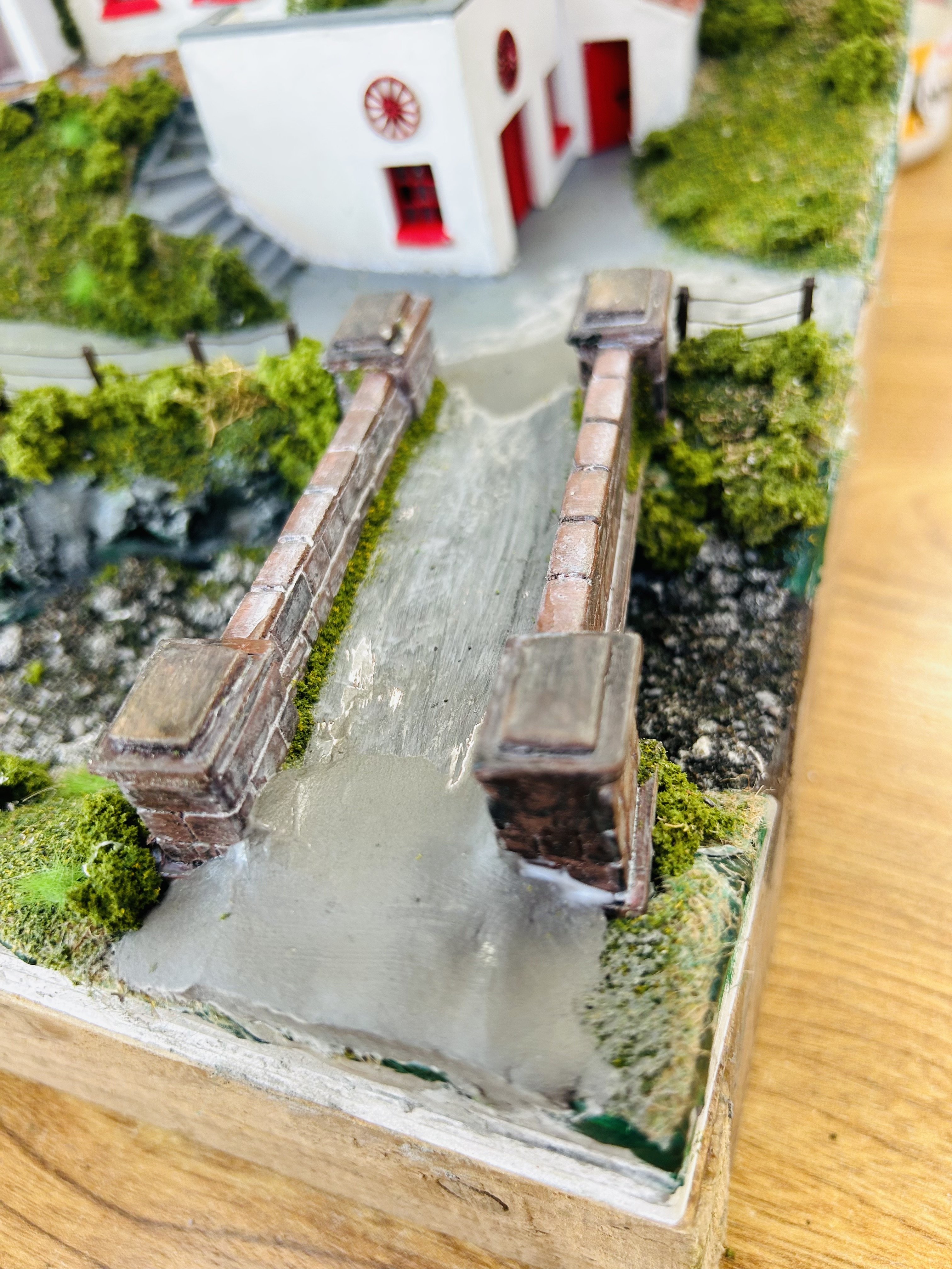

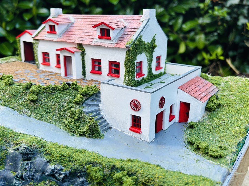

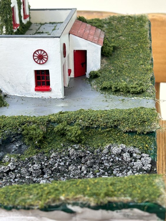

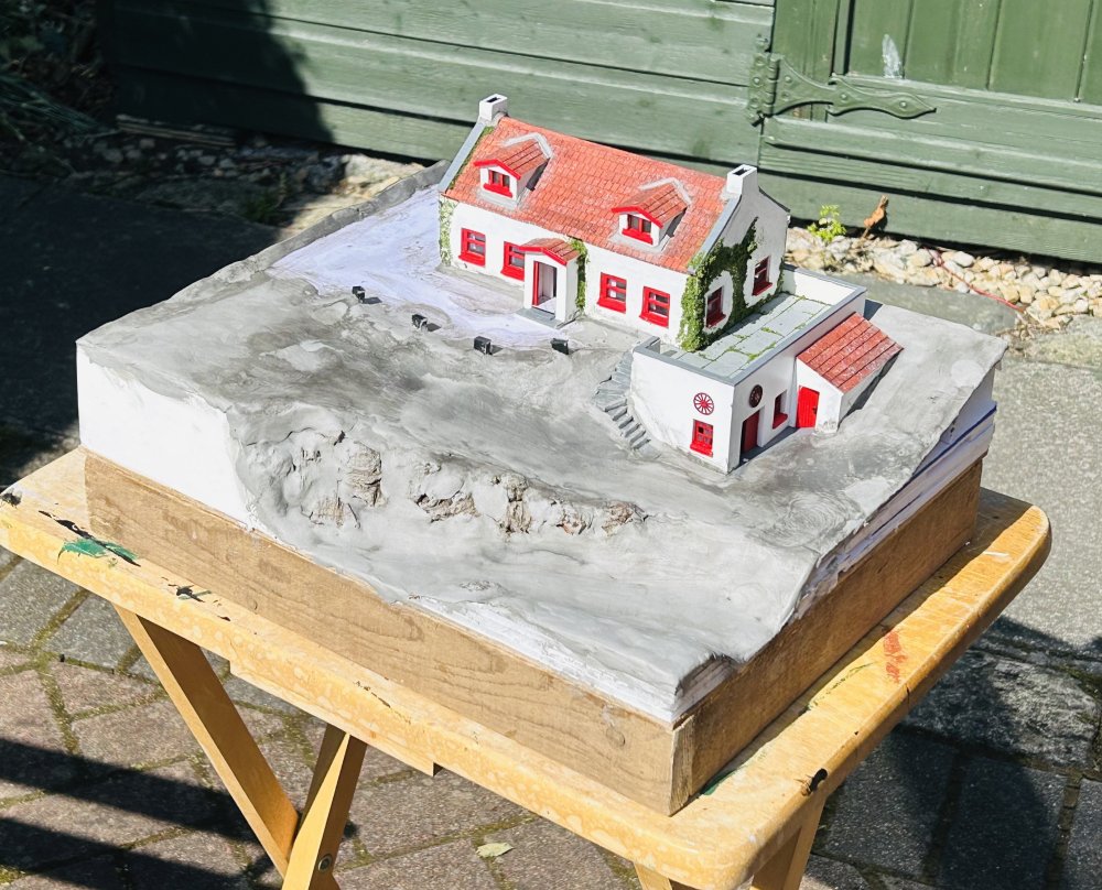

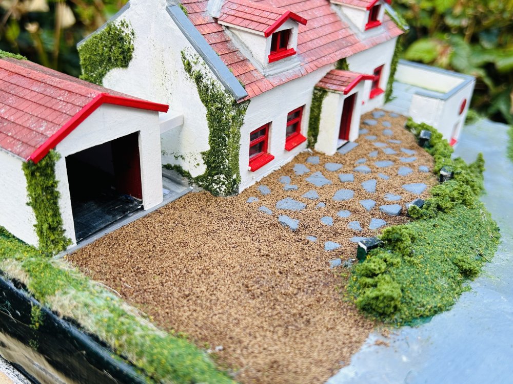

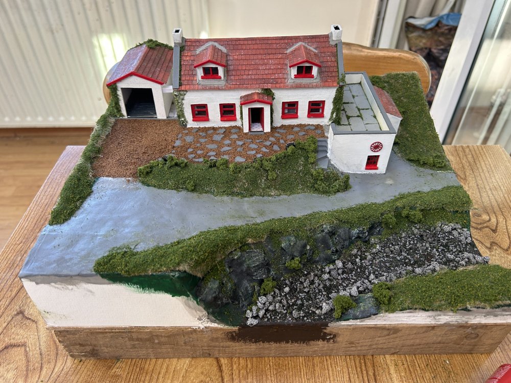

Patrick Davey Posted May 15 Author Posted May 15 I finally arrived at a finish for the bridge which I liked, so after a bit of weathering and adding some vegetation, I called in the Royal Ordnance Corps to blast holes in the riverbank, and the bridge was eventually placed in position on the diorama: 8 1
