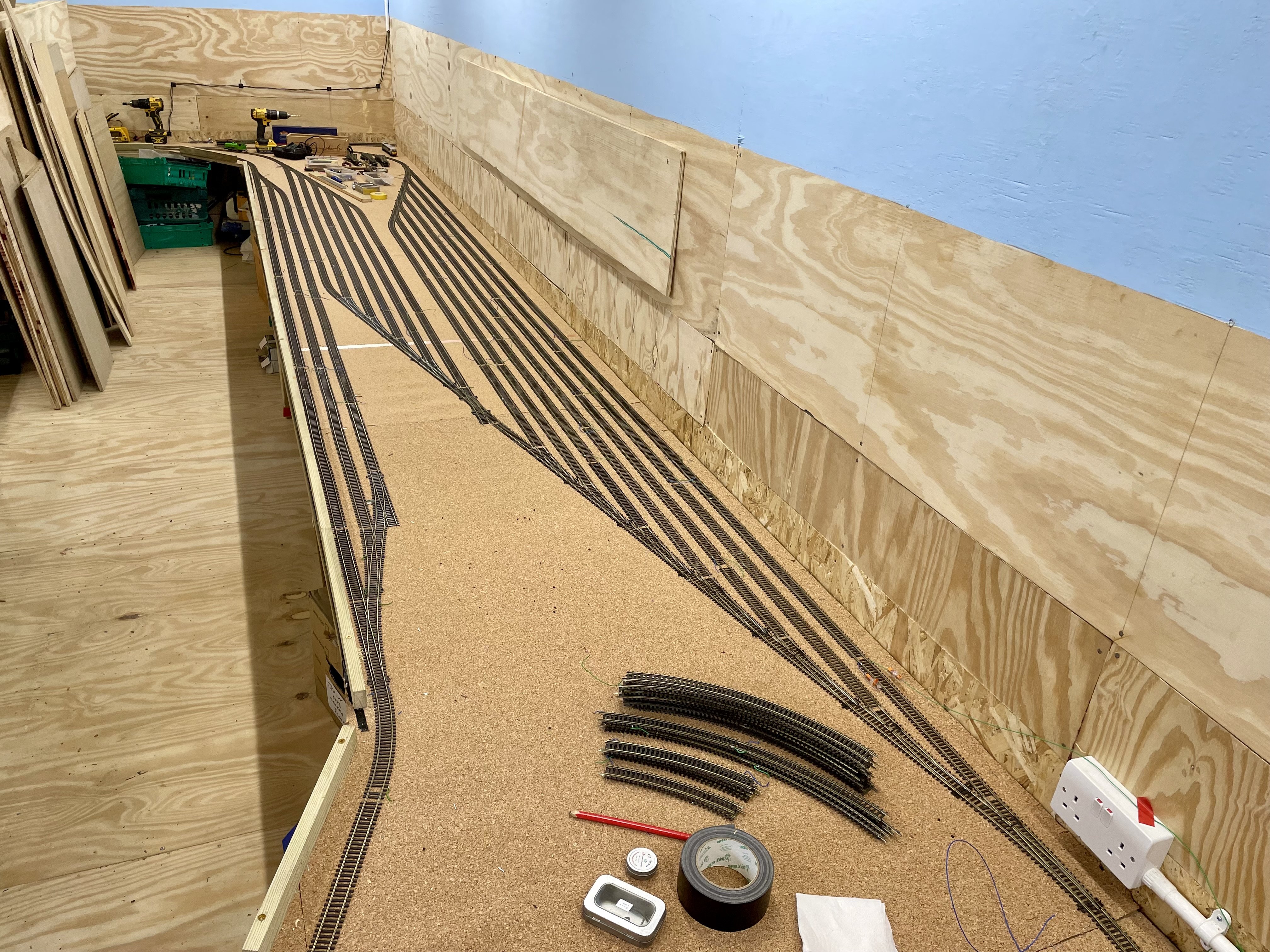

The first and smaller of the two lower level storage yards has been completed - well track laying has.
The longest siding is 20ft and the shortest 8ft.

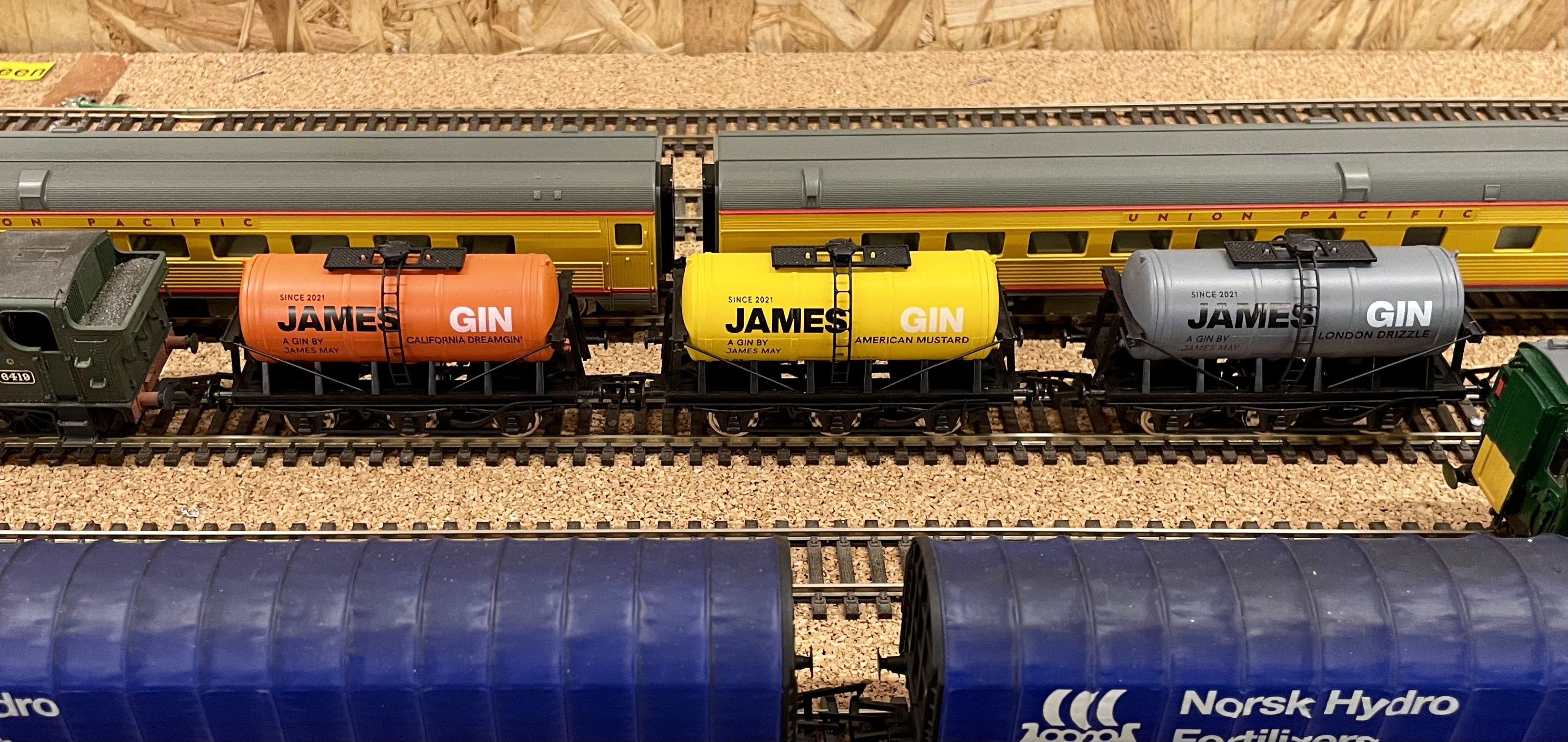

Trial run with the new Bachmann 69.

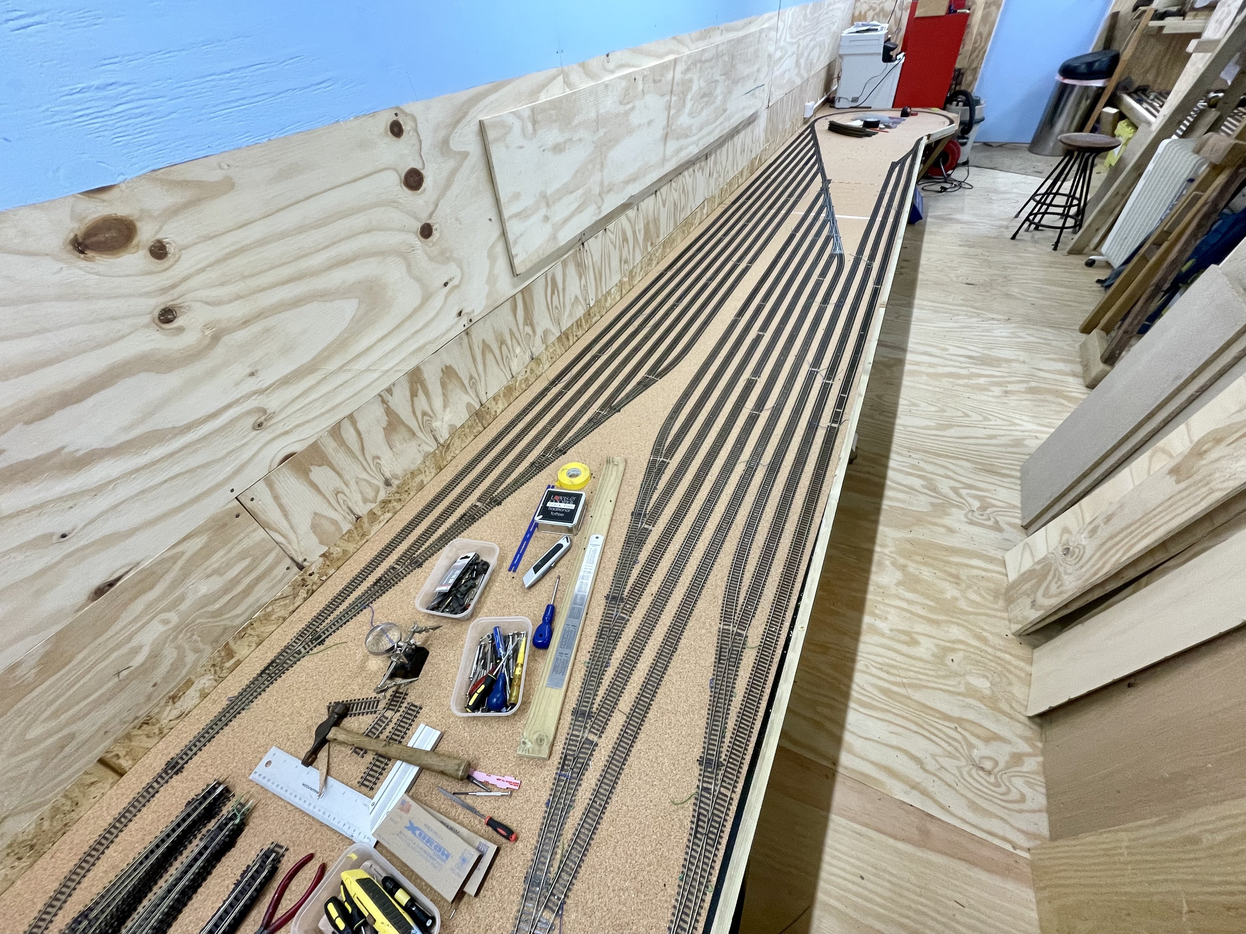

Lower level baseboard construction moves to the other side of the shed.
This will accommodate larger through storage sidings with a return loop connecting to the helix that links to the upper scenic levels.
Cheers

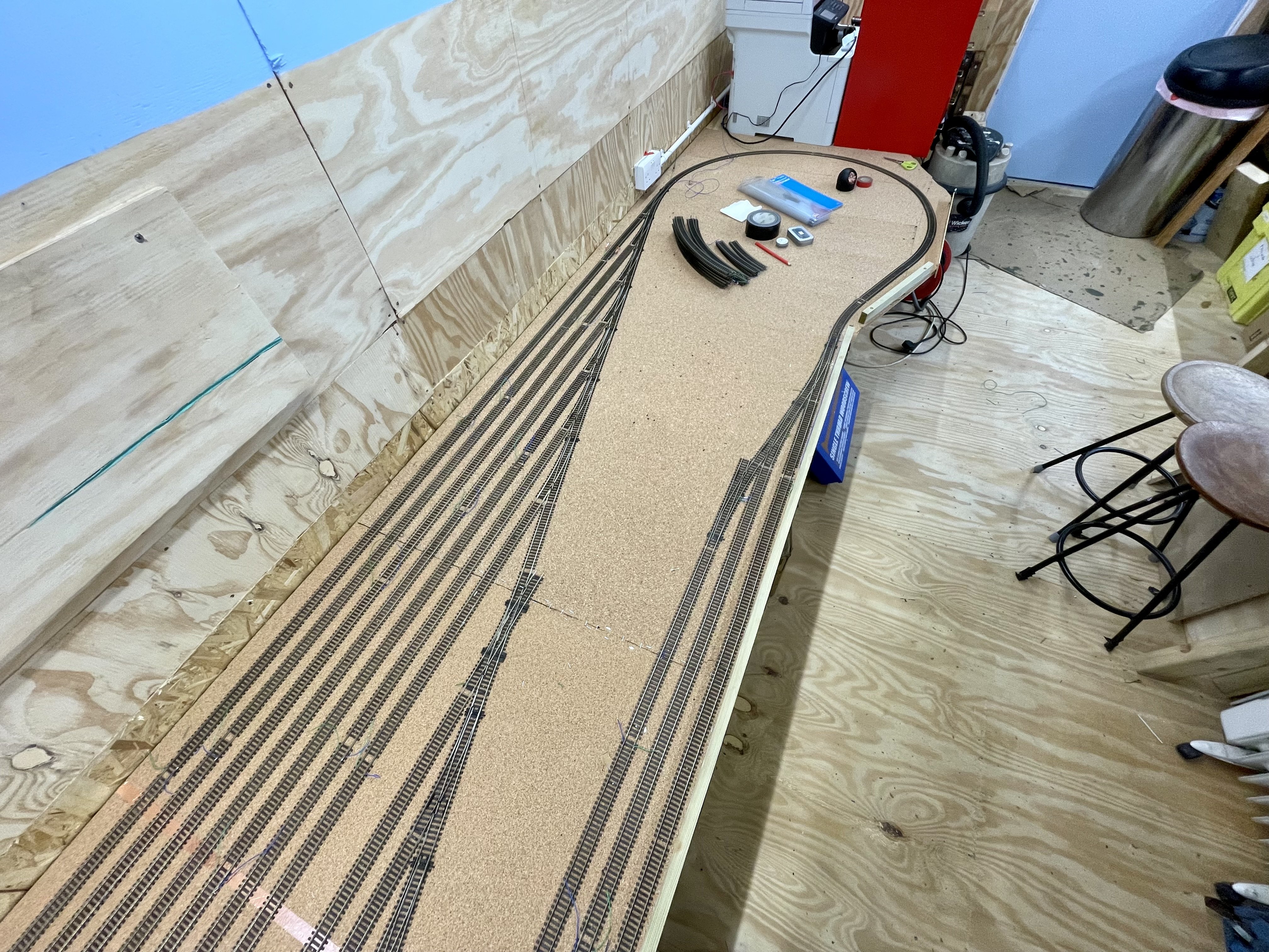

We reckon we have laid nearly 800ft of track so far - and that’s just the lower level storage.
There will be a higher scenic level above this.

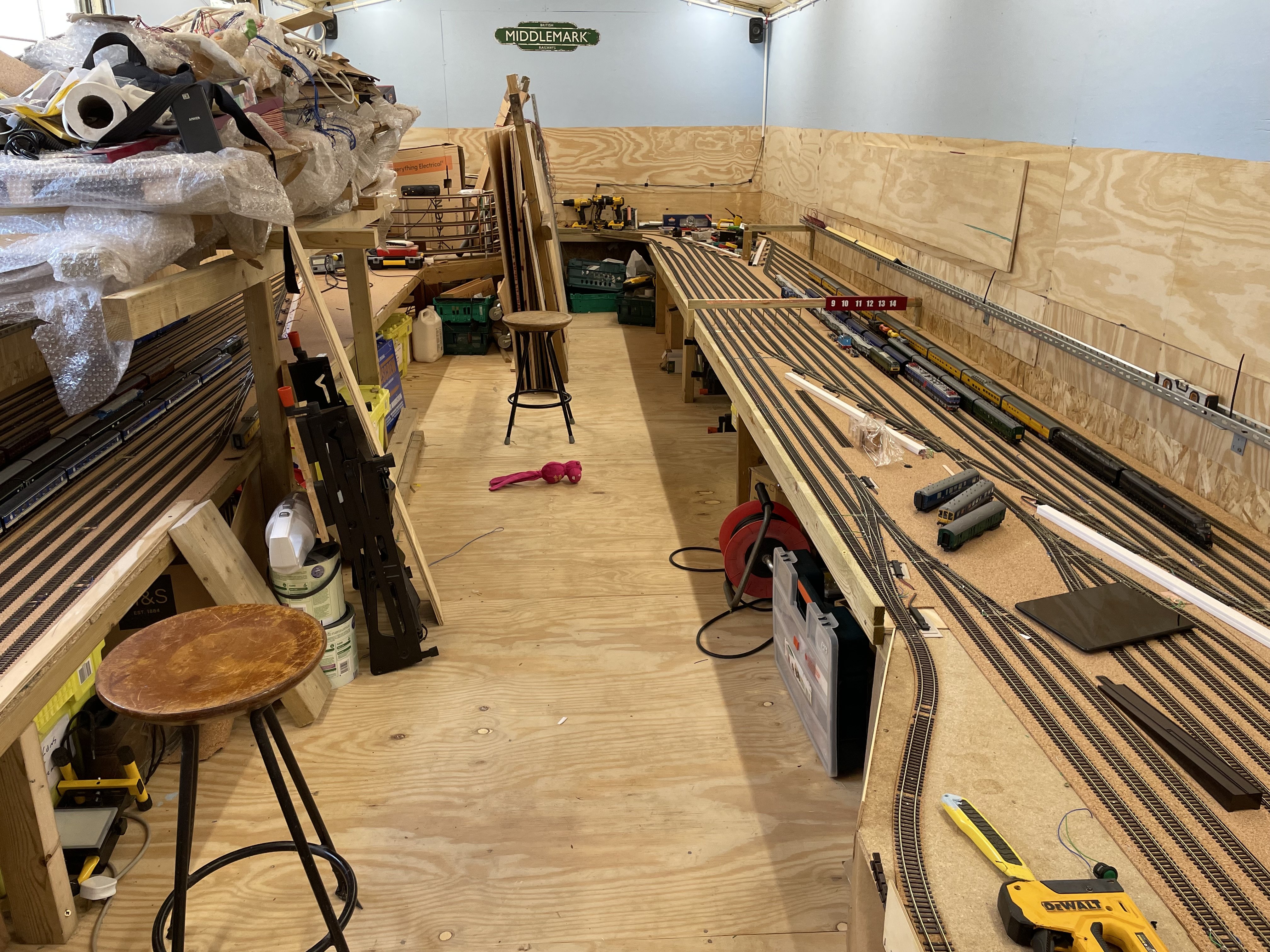

It’s a rebuild of a partially completed layout that was under construction a few years ago in a large shed belonging to a friend of mine.  He subsequently moved house and built a new, slightly larger, shed - the interior of which is seen in the preceding photos.
A double track helix in one corner will connect the lower storage siding level with an upper scenic level, which will itself have two levels.
The location will be “somewhere in the southern UK” but the era will be “flexible…”

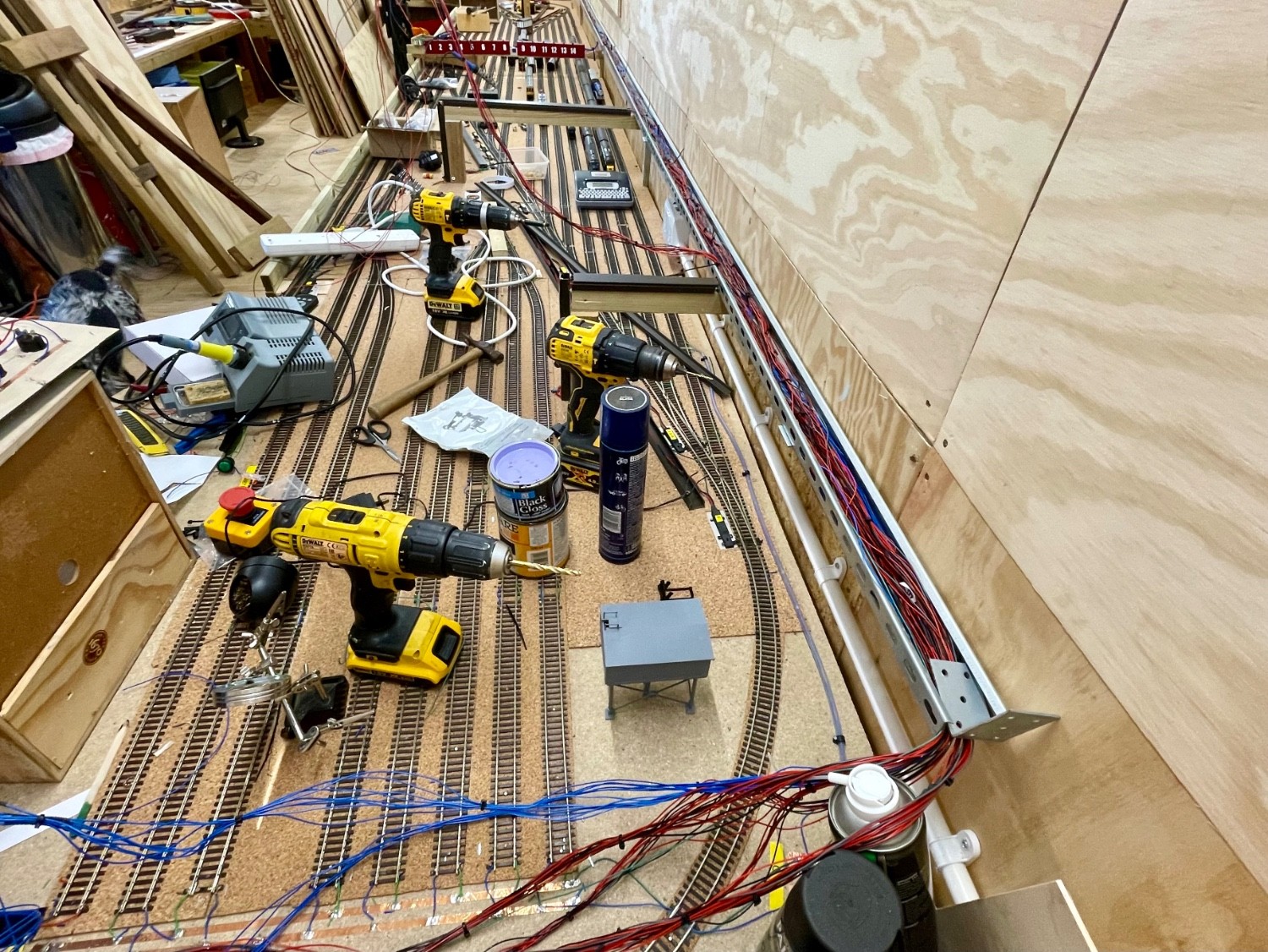

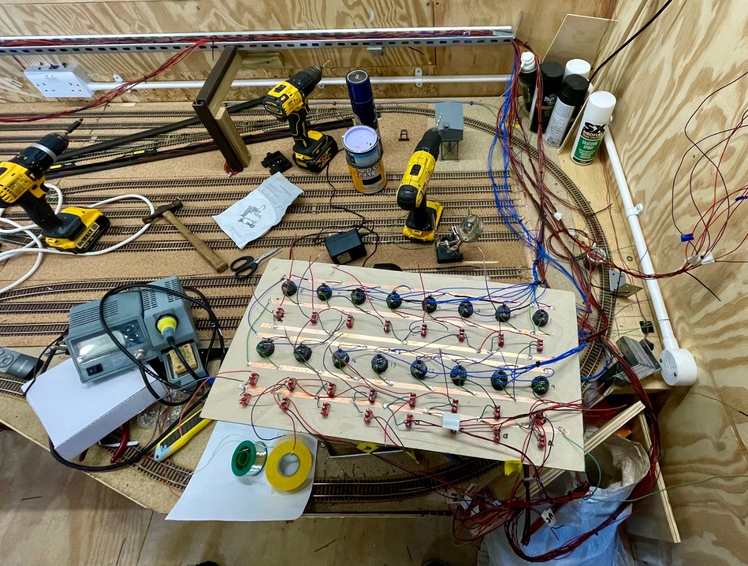

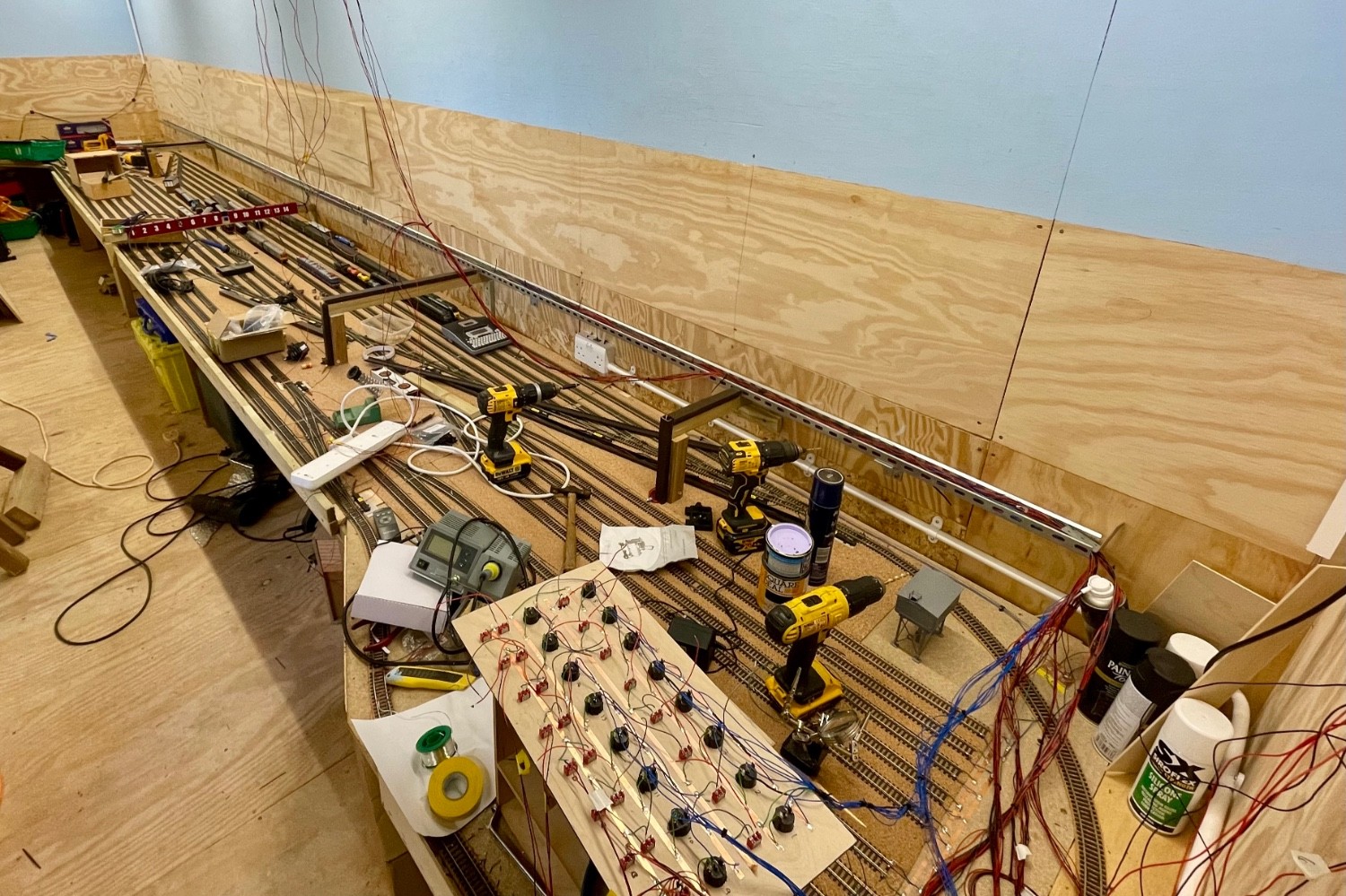

Back in the shed today - mainly wiring so not many pictures - especially of lots of wires, which aren’t that interesting.
Each siding in the storage yard is electrically isolated and will be wired to an illuminated switch on a control panel so that power to the siding can be switched on and off as required.
In addition to the panel switch we have wired LEDs to the bridge above the tracks so that the LED above the track lights up to provide a visual indication that power is switched on.
At present power is permanently on to each track as the control panel is still under construction.
Cheers
Darius

Point motor wiring almost completed.
So far around 600m of cable used and that’s just the lower level on one side of the shed.
So much for minimal wiring with DCC 😀
Cheers
