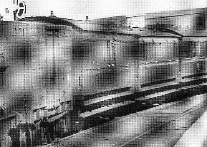

Mol_PMB Posted December 27, 2025 Author Posted December 27, 2025 Finally, the three images that show a diagram 69 lav compo in later years. All these photos were taken in 1956 at Albert Quay. Ernie's photo below shows a rather tatty no.541 on the right. It had been withdrawn in the previous year. The roof has a lavatory tank and vents above each compartment, whilst the doors also retain their vents (but the one above the toilet window is absent). The livery is CIE plain green with class designations on the first class only. The shade of plain green was the same as the later light green, considerably lighter than the original CIE dark green with elaborate lining as seen on no.500 in the middle of this photo. The IRRS also has a closer view of this rake, focused on 500 in the middle but showing only half of 541: https://www.flickr.com/photos/irishrailwayarchive/53511793685  Finally, another of Ernie's photos shows a distant view of 542, which was still in traffic at this time. Zooming in we can see some details including roof vents and lavatory water tank. On the sides, it appears that only the vent above the toilet window is fitted - they seem to be absent on the doors. The livery appears to be the same plain green, possibly without any class designations - it may have been declassified?  That's all I've found from Flickr. I haven't yet found any photos of the last surviving diagram 69 - number 545 - which would be my preferred coach to model considering its withdrawal date. I have learnt that the diagram 69 did have lavatory water tanks on the roof for most of their lives, and that CIE plain light green is a suitable livery for the last survivors. As for door vents, it's a lottery!  However, there are some other online sources yet to search, including the NLI. I'm still hoping to find some more - I've just stumbled across this better view of 905 which clearly shows it in light green livery with waist line in 1961:   2 1

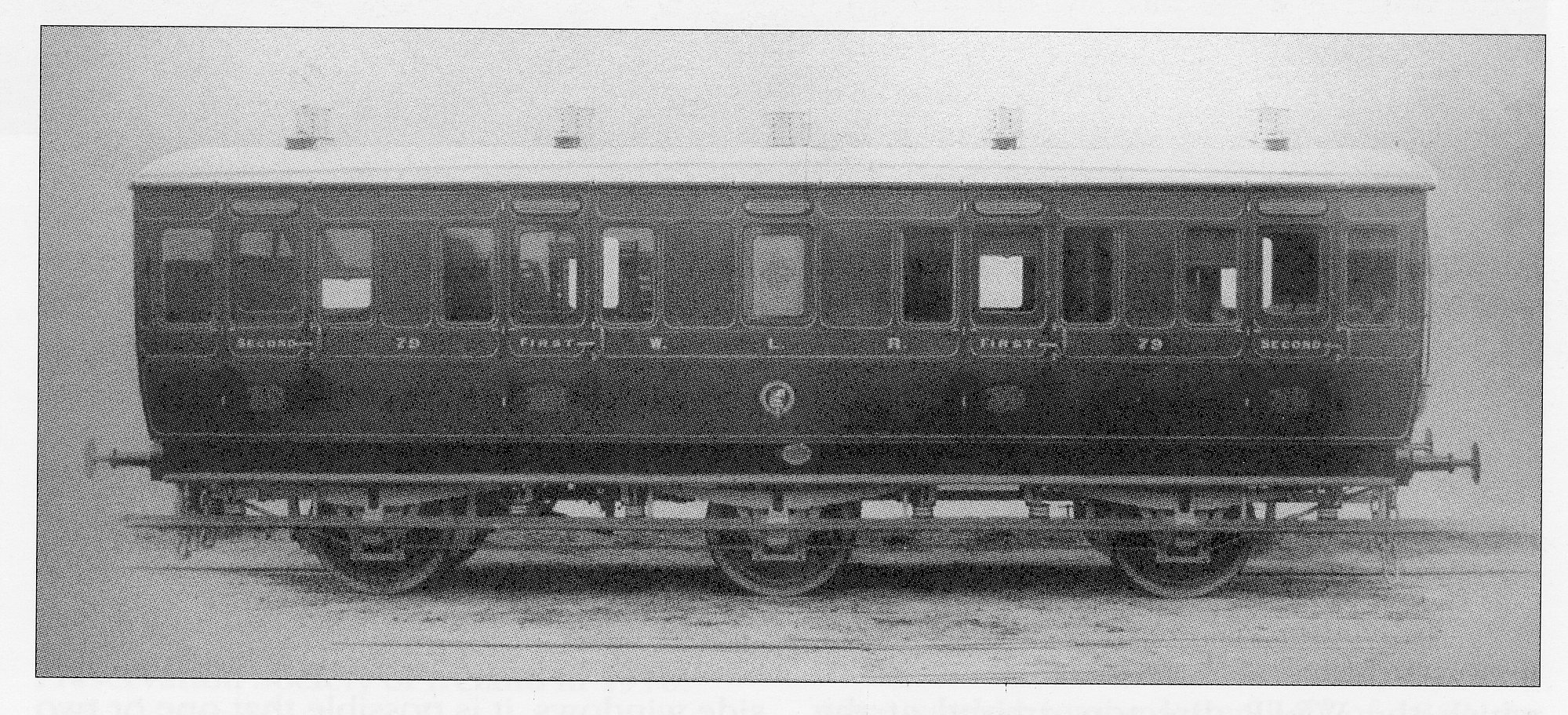

Mol_PMB Posted December 29, 2025 Author Posted December 29, 2025 Back to GSWR 6-wheel lav compos, here are a couple more images I've found. Featured in 'Waterford, Limerick & Western Railway' - Shepherd is this view of one of the WLWR lav compos when new. WLWR 79 became GSWR 928 and lasted until 1958 with CIE. This was one of three (928-930) that were allocated to GSWR diagram 69 along with a larger group of similar GSWR-built vehicles. The diagram shows flat ends which was correct for the GSWR vehicles but this photo clearly shows the curved-in ends of a WLWR vehicle. Oil lamps on the roof but no roof vents or water tank, but it has a full set of vents on the doors. Note the curved, apparently wooden headstock ends which is different from the other WLWR lav compo diagrams which had channel steel headstocks. Next up, this photo is reproduced in 'Great Southern Railways' - Murray and credited to W A Camwell although it is undated - I guess 1930s. Looking at the shape of the near corner, I think this has curved-in ends and it would be the same type as that illustrated above - a former WLWR coach allocated to GSWR diagram 69. The lavatory water tank is clearly visible and it has vents on the roof but not on the doors, although there is one above the lavatory compartment. Finally, here's another lav compo featured in 'Railways in Ireland part 4' - Bairstow and credited to the author's collection. The image is dated to 'around 1950' and the lav compo appears to be a genuine GSWR diagram 69 in the CIE dark green livery with elaborate lining. It has a full set of roof and door vents, but no vent over the toilet window. I think there is a water tank on the roof.  The last two photos both also feature GSWR full brakes and I'll be doing another thread on them later today. 4

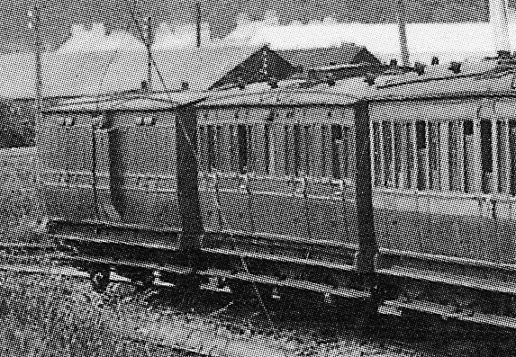

Mol_PMB Posted January 24 Author Posted January 24 This is one of those occasions where a photo crops up just too late to inform the modelling! Here's an old print I picked up on eBay last week, showing a GSWR lavatory composite, in the mid-1960s after withdrawal: This is by the far the best late-era photo I've found. I suspect all these vehicles received slightly different modifications and this one has some matchboarding on the ends and a sideways-mounted torpedo ventilator on the lavatory compartment. Livery-wise it appears to be light green with no waist line, but with both 1 and 2 class designations.  If I'd had this picture a month ago, I'd have built a model of this one. Never mind...  3
Horsetan Posted January 24 Posted January 24 2 hours ago, Mol_PMB said: This is one of those occasions where a photo crops up just too late to inform the modelling! Here's an old print I picked up on eBay last week, showing a GSWR lavatory composite, in the mid-1960s after withdrawal: This is by the far the best late-era photo I've found. I suspect all these vehicles received slightly different modifications and this one has some matchboarding on the ends and a sideways-mounted torpedo ventilator on the lavatory compartment. Livery-wise it appears to be light green with no waist line, but with both 1 and 2 class designations.  If I'd had this picture a month ago, I'd have built a model of this one. Never mind...  Is it my imagination, or is the centre wheelset missing? 1
GSR 800 Posted January 24 Posted January 24 1 hour ago, Horsetan said: Is it my imagination, or is the centre wheelset missing? I think its there, if you look behind the centre wheel you'll see the far one in shadow on its left 1
Horsetan Posted January 24 Posted January 24 13 minutes ago, GSR 800 said: I think its there, if you look behind the centre wheel you'll see the far one in shadow on its left *squints* Er.... think I need to get the oul magnifier out.... 1
Mol_PMB Posted January 24 Author Posted January 24 I agree. The spring and axlebox are still there - if the wheelset had been removed then they would be missing too. But I do see what you mean. It hasn’t been converted to a 4-wheeler as some other GSWR 6-wheelers were. Note the truss replacing the middle wheelset here:
lucas Posted January 24 Posted January 24 2 hours ago, Horsetan said: Is it my imagination, or is the centre wheelset missing? I cranked up the brightness and contrast and you can sort-of see there is a wheel there alright. 1
jhb171achill Posted January 25 Posted January 25 12 hours ago, Mol_PMB said: I agree. The spring and axlebox are still there - if the wheelset had been removed then they would be missing too. But I do see what you mean. It hasn’t been converted to a 4-wheeler as some other GSWR 6-wheelers were. Note the truss replacing the middle wheelset here: I think this one has been converted to a four wheeler from a six wheeler - look at the cut-out in the footboard. Can't make out the number or I'd look it up.
