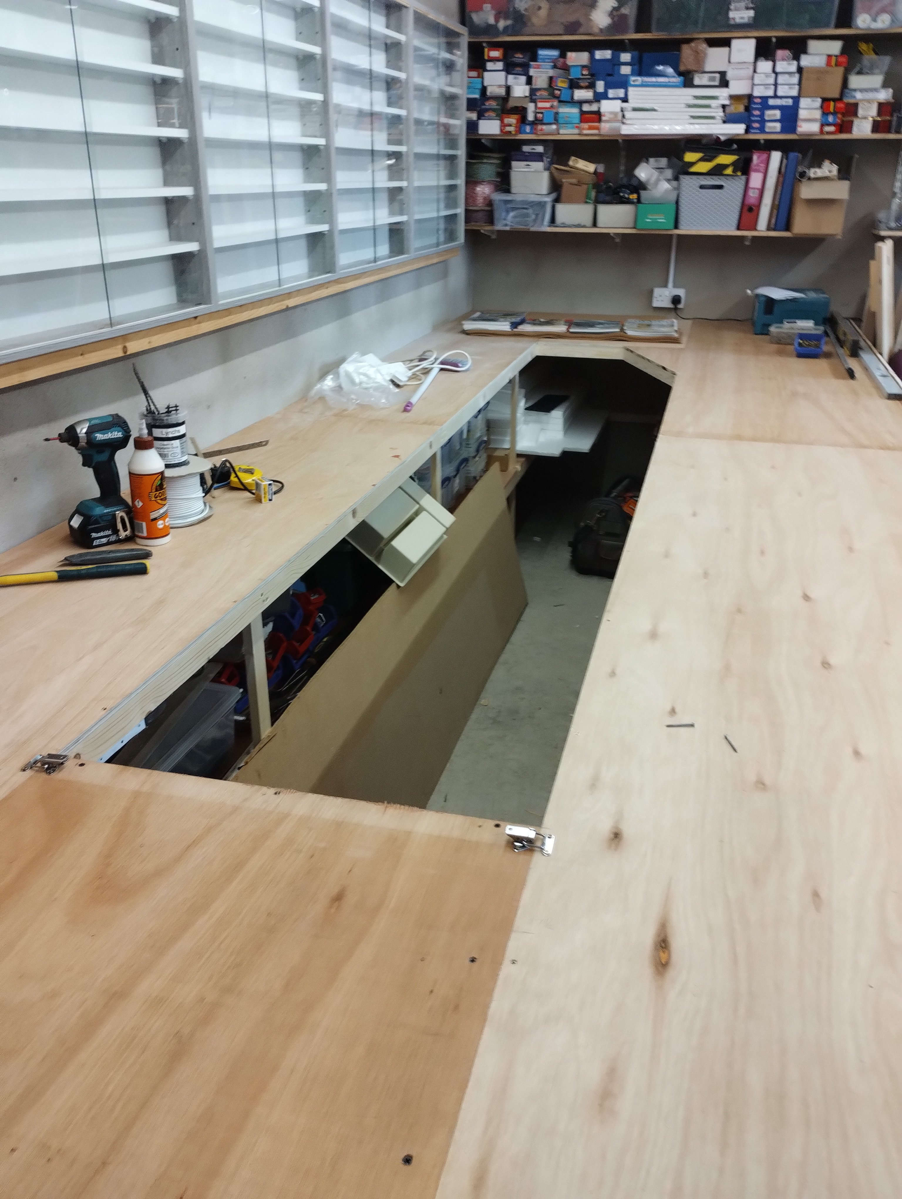

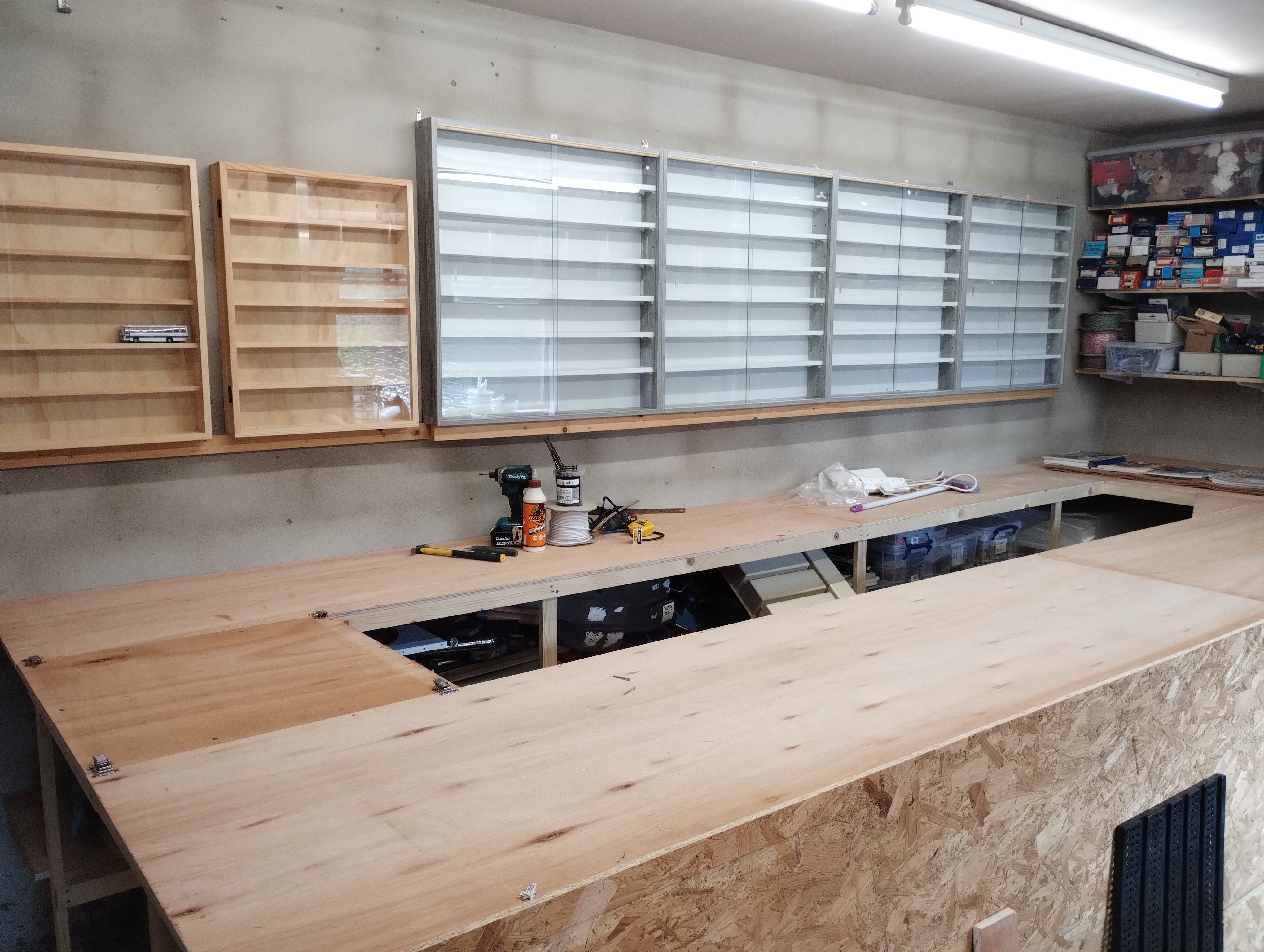

Popular Post The Derry Road Posted August 13 Popular Post Posted August 13 Hi everyone, just a quick note on the progress of a new layout I’m currently working on. Firstly a huge thank you to my son Stephen and nephew Chris who have built the base boards and assembled and erected the display cabinets, current and ongoing health issues mean I can only do some things . I will over the next few weeks/ months be laying the track which will have three circuits and incorporate as much of the bits and pieces from the old layout. The new layout is called “Lisneal Road”. I’m hoping if space permits a 10 track storage road. Overall size is 16ft x 6ft. DCC powered with one circuit switchable to DC running if required. Regards TDR 23
The Derry Road Posted August 13 Author Posted August 13 2 hours ago, Flying Snail said: thats some nice looking benchwork and cabinets! My nephew Chris is a self employed carpenter, I'm well pleased with the result, looking forward to getting cork glued down and then track sorted 2 hours ago, Flying Snail said: thats some nice looking benchwork and cabinets! 3
DJ Dangerous Posted August 16 Posted August 16 That’s an amazing space and the cabinets look sublime!
