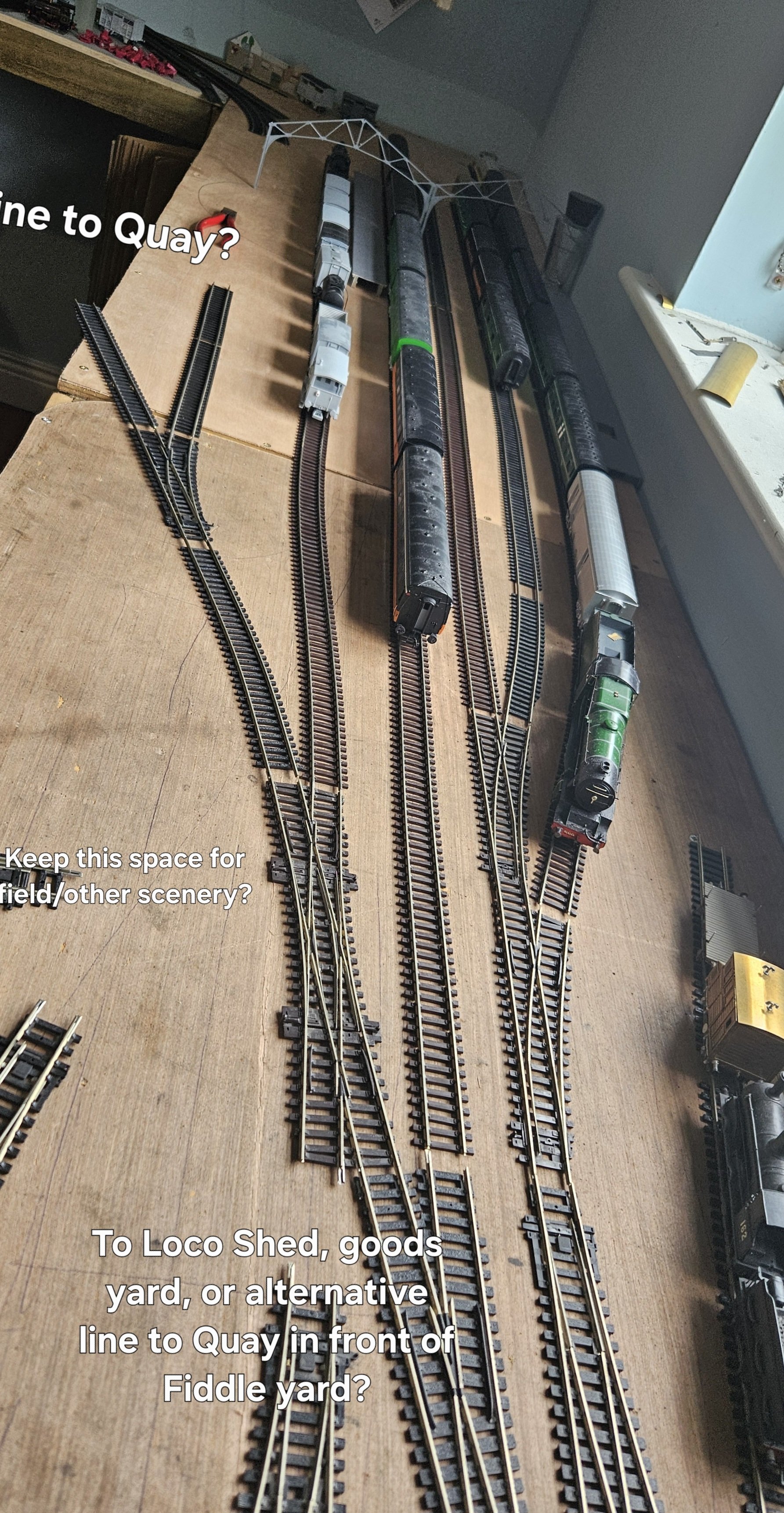

Been working on the idea for the track plan over the weekend. Have space for 2 carriage sidings in the middle. Both Platform 1 and 2 can hold 6 carriages and two locos.
I considered a run around loop from Platform 3, but I think it clutters things somewhat
Not sure about some things, listed in photo below!
Edited by GSR 800
  • Like 6
3 minutes ago, mfjoc said:
@GSR800 where did you get the frames for the station overall roof?
They are slightly modified from the Walthers kit "Train Shed with clear roof"
Honestly I think they might be too large, I might go with my Waterloo trainshed instead!

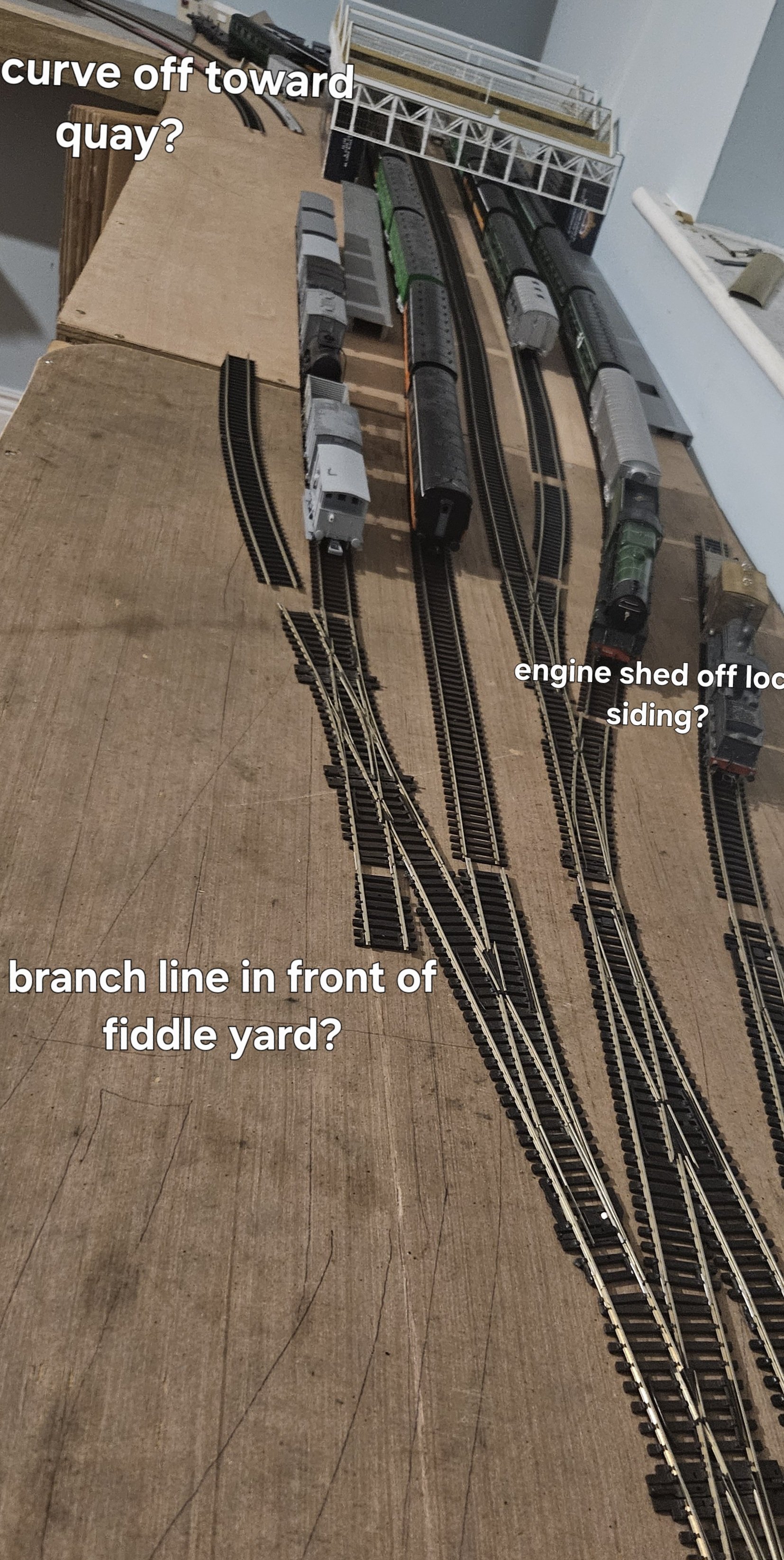

Some further mulling with the design, now with my waterloo trainshed standing in.
My thinking is I could have platform 3 split curve (bit like Mullingar) and be the quay platform for boat/mail trains and the like.
I was also thinking I could have a branch off in front of the fiddle yard. But I think I might simplify the plan and keep those two ideas condensed into one, rather than have two branch lines and a main.
