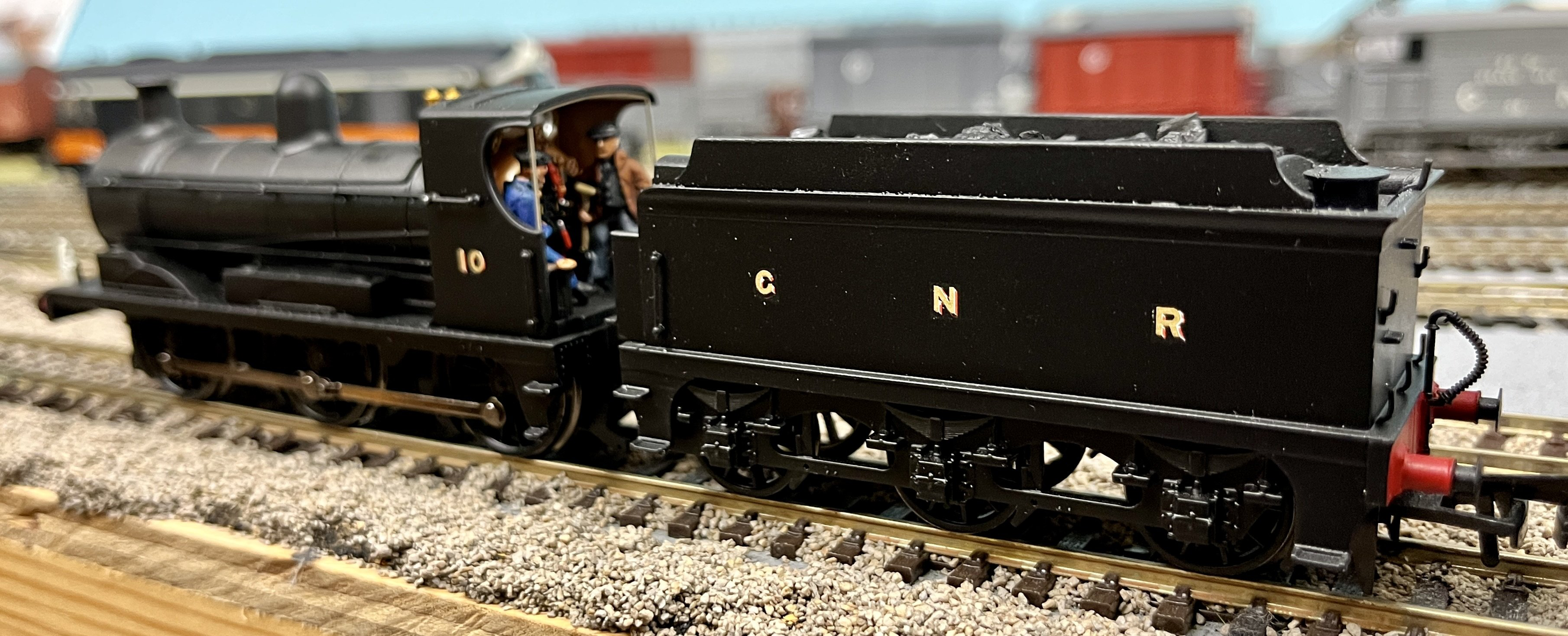

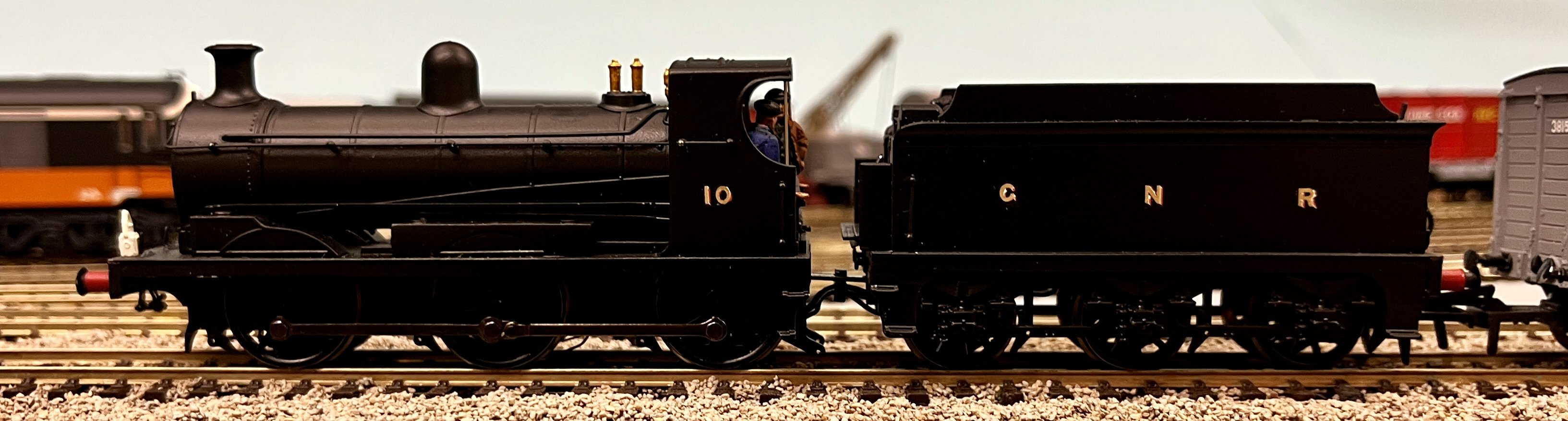

@Galteemore is right, that they tended to use 0-6-0s, at least latterly. See the one Nelson built for me:
https://irishrailwaymodeller.com/topic/8447-portadown-junction/page/6/
There was also the Class QGT - an 0-6-2T - I've just bought a LNER Class N2 (i think) to consider using as the basis for a QGT - a long shot? At £35, DCC fitted - I couldn't leave it sitting there and it works well!

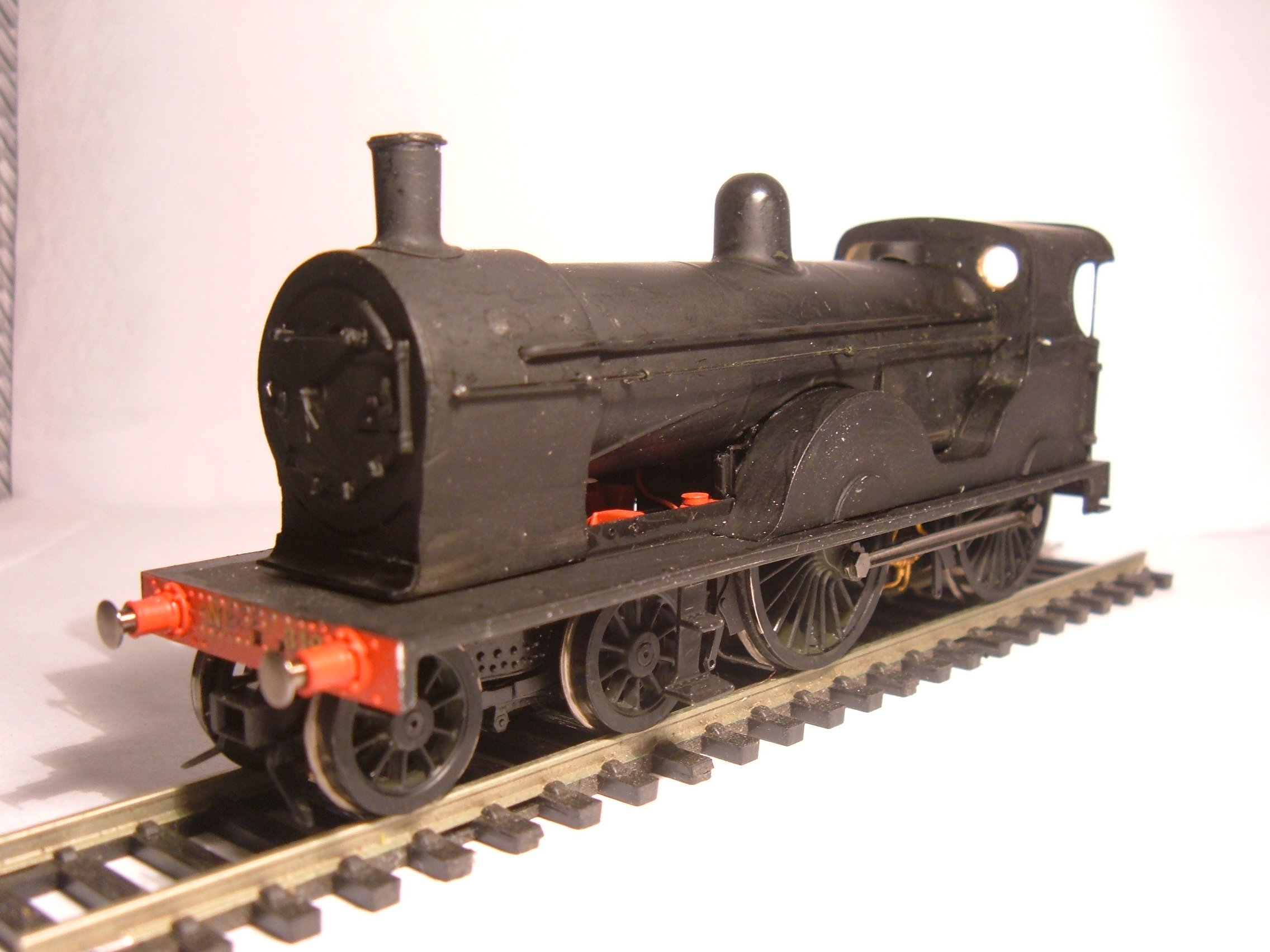

I made this Q class a few years ago,  based on a Hornby T9. Thought about using a T9 as a base for the BT but the driven wheels are too big. Is it possible to fit smaller wheels and adjust the height of the front bogie ?
Down from 6'8 to anywhere approaching 5', you might as well get a chassis custom built or scratchbuild yourself at that point, IMO

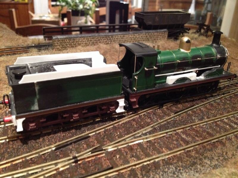

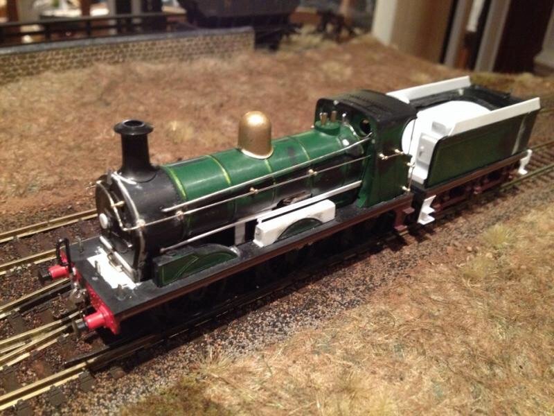

As mentioned above I have created a GNRI PG class from the Southern Railway C Class.
My first attempt was from a GBL (static models from magazines approx 10 years ago). It was fairly straightforward apart from removing the moulded handrails and pipes. My chosen chassis for it was a Bachmann Jinty.
My second attempt, fabricated for Leslie, was from a Bachmann model which in my opinion creates a more refined finish. The only difficult part is removing the metal casting at the smokebox saddle, as this is moulded as part of the frame. The wheel arches need filing down, apart from that, everything else was straight forward.
If anyone else wants to attempt it, I would say go for the Bachmann model as everything is provided and nothing extra needs bought.
Nelson.
