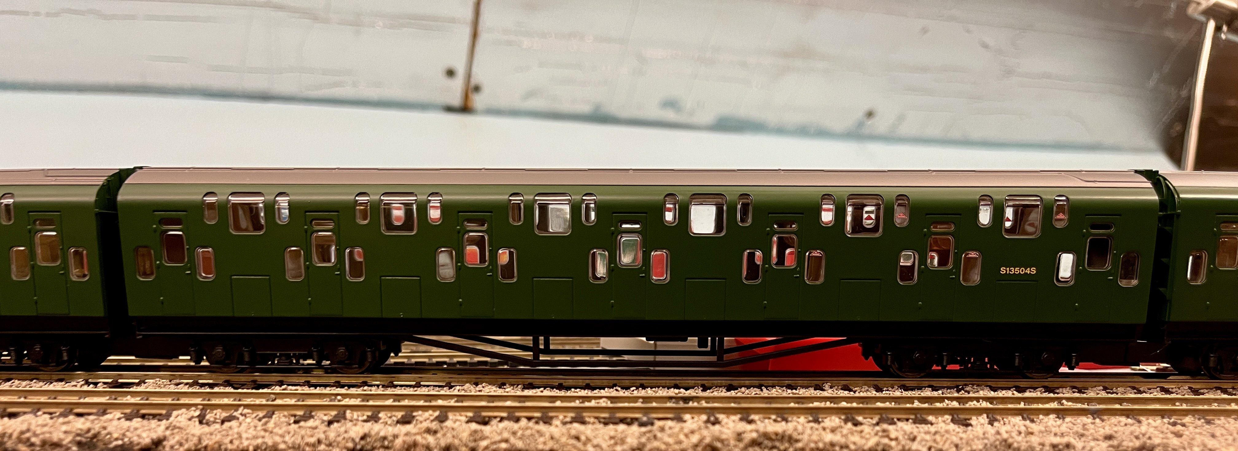

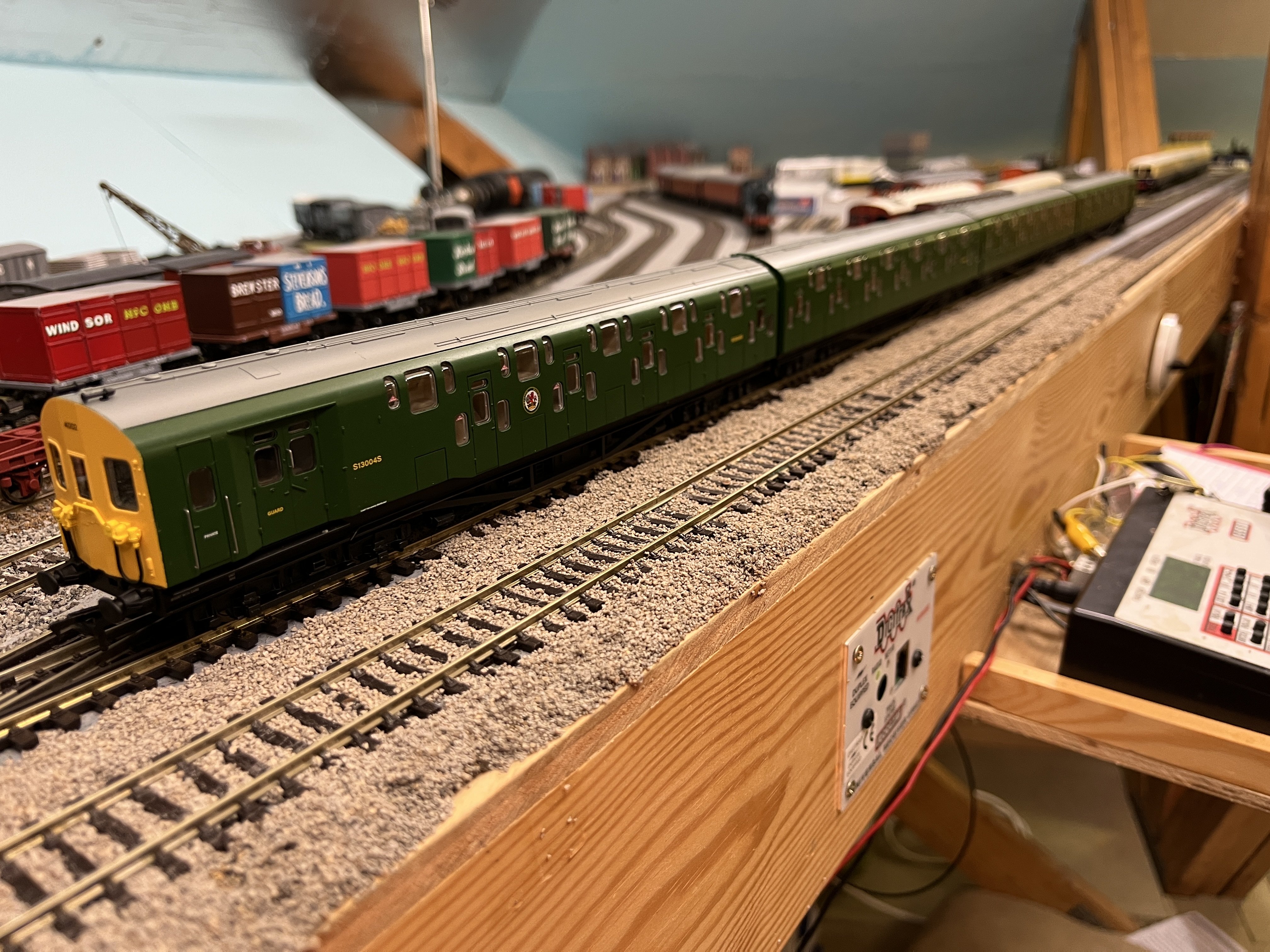

leslie10646 Posted November 28, 2025 Author Posted November 28, 2025 (edited) By way of a serious wind-up. I've decided to electrify the Junction, and this is an Armagh Commuter train of the future, after the line is put back ...... Rather than wait for an 800 which which may appear posthumously, I decided to invest the same sum in another creation of the Blessed Oliver: This is the just-released "KR Models" model of the Bulleid Class "4DD" EMU, which you can see was an attempt to build a double-decker within the GB gauge. Only two sets were built, but they ran for 13-14 years. The Jury is out on this one - it's derailing on my points and with my vast layout, that means creeping under rafters to rescue it - it hated by single slip at Richhill, derailled the whole train, while a point at the North End of Portadown has just taken it out for the second time. I'll be the Internet to see if others have found this an issue. Unusually (?) it has motors in both motor coaches (which are invisible!), so it runs nicely when it likes the track. Lights internally and in the cabs, but unbelievably none on the Headcode Box, or a rear red panel. Unremarkable for detail - it wouldn't pass Paul Isles' attention to detail, but hey, no-one else will make a RTR model of one? Really only bought for the glass cabinet, but I've hankered after a simple SR layout as i've 4/5 EMU sets. Edited November 28, 2025 by leslie10646 7 1
Paul 34F Posted November 28, 2025 Posted November 28, 2025 Leslie, I would check the back to back dimension of each pair of wheels. This may be the cause of multiple derailments. Kind regards Paul 1
Mol_PMB Posted November 28, 2025 Posted November 28, 2025 Nice! I believe the couplings between cars can be another source of derailment on these - either fouling on the body or the fixing screws a bit tight so they don’t swing freely. 1
leslie10646 Posted November 28, 2025 Author Posted November 28, 2025 4 hours ago, Paul 34F said: Leslie, I would check the back to back dimension of each pair of wheels. This may be the cause of multiple derailments. Kind regards Paul Thanks, to both of you for these points (pun intended!) I'll have a look at both points when I'm next in a position in do so. At this moment, my eighty year old knee isn't working so to even get back into the loft will be painful. 1

Signal Post Posted November 28, 2025 Posted November 28, 2025 Dawn Quest mentioned some problems with this model (at least I think it's the one that you've got) during her youtube livestream last night (the relevant bit starts at 36min 45sec): 1
leslie10646 Posted November 28, 2025 Author Posted November 28, 2025 Thanks @Signal Post - based on the advice given, it's going back to Rails! I hope that you enjoyed its short history on the Armagh Line.

jhb171achill Posted November 28, 2025 Posted November 28, 2025 (edited) On 28/11/2025 at 12:32 AM, leslie10646 said: ....................... - it's derailing on my points and with my vast layout, that means creeping under rafters to rescue it - it hated by single slip at Richhill, derailled the whole train, while a point at the North End of Portadown has just taken it out for the second time. The reason is that it's 4 fut 8 1/2 narra gauge, and it's 5 fut 3 at Portydown..... Edited November 29, 2025 by jhb171achill 3
leslie10646 Posted December 1, 2025 Author Posted December 1, 2025 On 28/11/2025 at 11:00 PM, jhb171achill said: Yes, I've "interrailed" a good l;ot on the past - plus, when in Switzerland, where a kitkat costs the price of an average family car in southside Dublin, there's a Swiss pass you can get, only avilable to us "furriners"; my sister (and her family), as a resident of Switzerland for over 40 years, isn't eligible! Ah yes, but she can get an All-Line, trains boats and buses, First Class for a YEAR for about CHF6,500! Trains on time and most places at least half-hourly! Who would own a car? I believe that spouses and kids get a big discount.
leslie10646 Posted December 1, 2025 Author Posted December 1, 2025 Anyway, back to the 4DD. I re-railed it and ran it THE OTHER WAY through the point with no trouble, but it still derailed in the other direction - I'm keeping fit going to retail it each time - remember my layout is house long! Then, I thought I'd show you it moving where it didn't derail - you'll love this - derailed right in front of me. Only 4 seconds, you'll love it! I've looked at the offending trailer and the bogie has more play than others, so I IMG_4181.MOV am looking for a suitable screwdriver ........ 2
Brendan8056 Posted December 1, 2025 Posted December 1, 2025 You have my sympathy about the 4DD. I have a blue 4DD, having seen the real thing at close quarters the body looks right to me, the close coupling is the best yet for a Southern Electric. If you have a layout with just a plain length of straight track, totally level with no pointwork then you will love this model. Sadly mine is unable to complete 30 minutes in each direction running in. I too have derailments every lap on my 3rd radius Rocoline test track, which is a plain oval with a very slight gradient at one end. I have probably spent 8 hours trying to loosen screws on the bogies/close couplings/checking the wheels etc, as yet no luck. Either the outer motor bogie derails or the trailer next to the motor car has a bogie ride up on the rail and off the track. I could send it back for a replacement, but it seems a problem with all the KR 4DDs. Irish modelling is a lot easier. 3 1
leslie10646 Posted December 1, 2025 Author Posted December 1, 2025 Hi Brendan Commiserations that you have a similar issue. The bogie which leaps off sets to be the trailing bogie of Car 3 (next to the trailing motor coach). As I said on an earlier post, it was really bought for the Glass Cabinet, so like you, I may swallow the issue. Of course, if I do build that SR layout it would be a station between two fiddle yards, so a nice straight shuttle arrangement for the $DD would work fine? As for Irish modelling being easier - IT IS if you model diesels - but steam IS A DIFFERENT MATTER. As almost no RTR steam exists, you end up with brass locos built from kits which need an Andy Candice, or a David Holman, or a David Richardson on hand to fiddle about with the things. THEY derail with impunity - mainly the leading bogies. Dr Edgar produced a working solution which has helped my S Class, but then there's the PPs (two) ALs (two, the Glover tanks (one quite well-behaved, the other two short out very happily), etc etc . Still, it's a nice problem to have - they look lovely just sitting around!!!!! 2
Darius43 Posted December 3, 2025 Posted December 3, 2025 (edited) Hi Leslie I have found that loosening the screws holding the non-power bogies on all the coaches helps to reduce the derailments for my 4DD. Others have found that removing the bodies and loosening the attachment screws to the coupling units also helps. Cheers Darius Edited December 3, 2025 by Darius43 1

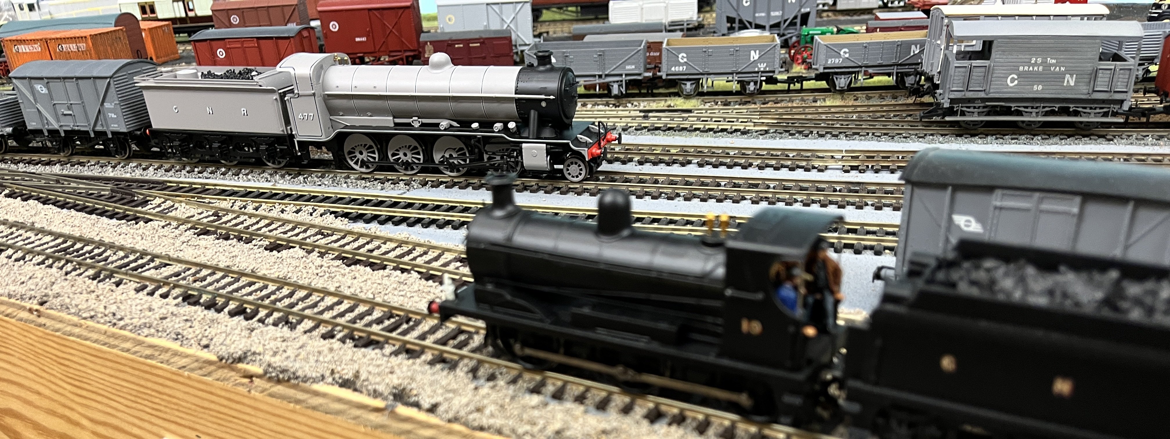

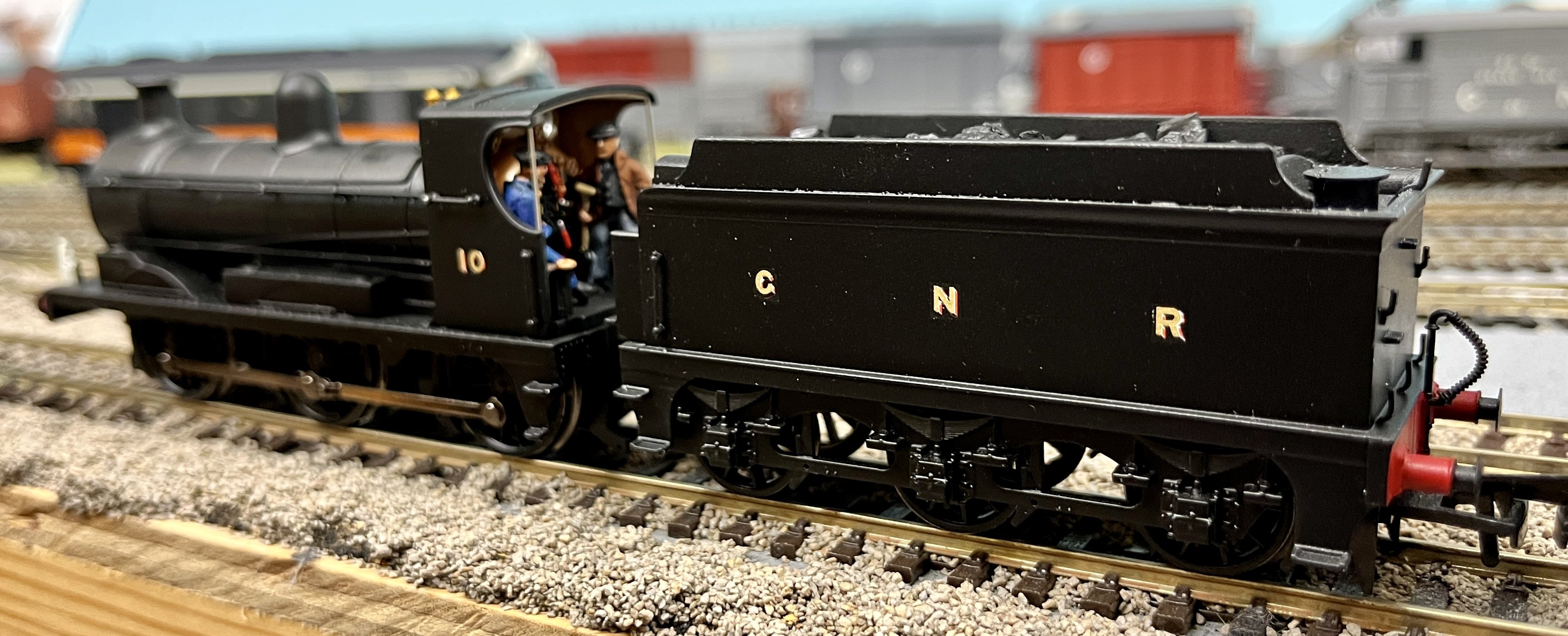

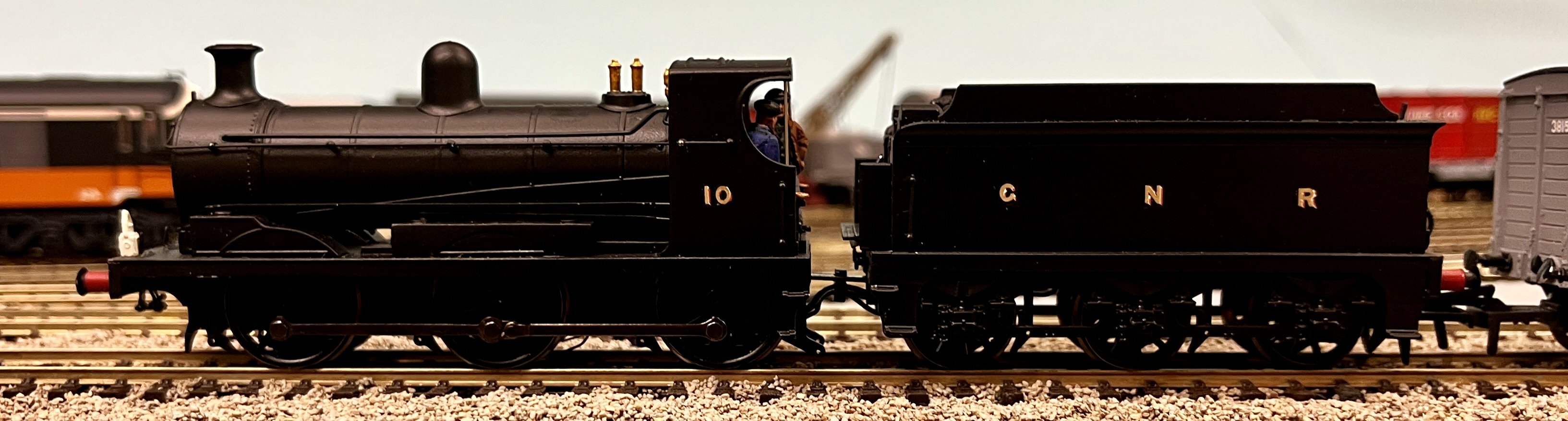

leslie10646 Posted 1 hour ago Author Posted 1 hour ago The Shed has got a new engine! Built for me by my ever skilful modeller, Nelson. a PG Class from a SE&CR C Class. For now, a few pics and a very short video. More later. As you can see on the video clip, all is chaos and confusion at The Junction with stock sitting everywhere except the on the rails! AND doing a turn on the Shipper! IMG_5168 3.MOV
