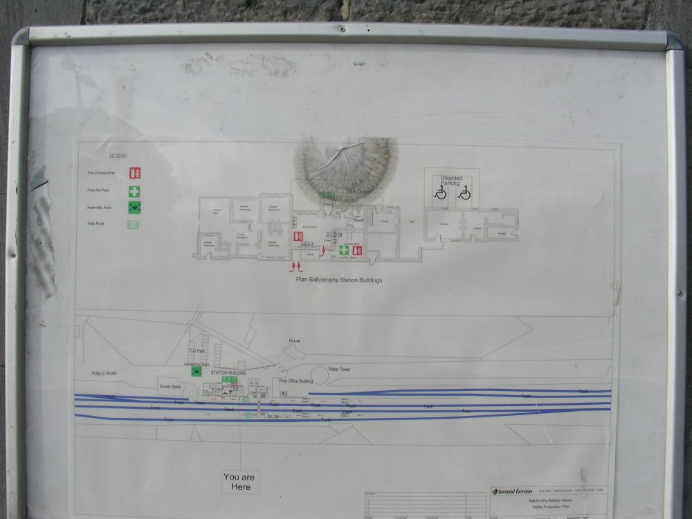

If you're local, or have access to a local 'agent', there may be an 'evacuation plan' on display somewhere - this is the one at Ballybrophy - it'll be based on a current layout plan and, thus, could be expected to be using a fairly recent layout.
That one is from 2009...
