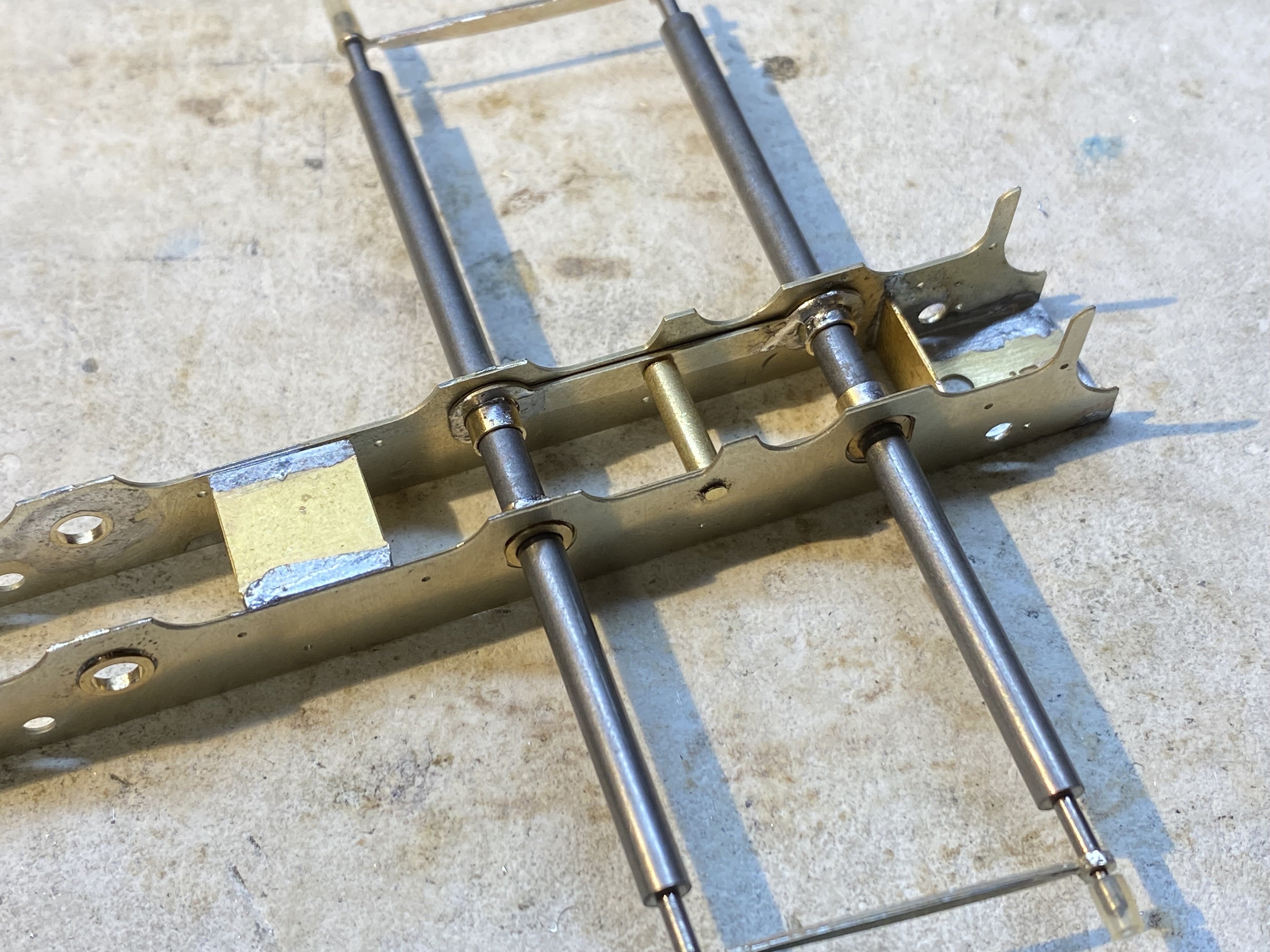

Horsetan Posted March 30, 2016 Author Posted March 30, 2016 I've elected to use the nickel silver frames, but they're not exactly friendly for what I have in mind...
GSR 800 Posted March 30, 2016 Posted March 30, 2016 I've elected to use the nickel silver frames, but they're not exactly friendly for what I have in mind... I didn't know what the spacer bars were until it was too late, so I went through a lot more hardship than I needed too. Are you using compensation? They wouldn't be easy for that.
GSR 800 Posted March 30, 2016 Posted March 30, 2016 I'm thinking of taking the chassis apart, and buying the Poppy's wood tech jig and building it around that.
Horsetan Posted March 30, 2016 Author Posted March 30, 2016 (edited) I didn't know what the spacer bars were until it was too late, so I went through a lot more hardship than I needed too. Are you using compensation? They wouldn't be easy for that. I want to use Continuous Spring Beam suspension, which is meant to allow all axles to float, and is the same system that I'm using on the "S" class. The J26 frames have to be modified for this. Here are some examples Edited March 31, 2016 by Horsetan
GSR 800 Posted April 3, 2016 Posted April 3, 2016 I want to use Continuous Spring Beam suspension, which is meant to allow all axles to float, and is the same system that I'm using on the "S" class. The J26 frames have to be modified for this. Here are some examples Wouldn't the brass chassis be better for that?
Horsetan Posted April 3, 2016 Author Posted April 3, 2016 Wouldn't the brass chassis be better for that? Yes and no. Yes, because the hornways are the right size. No, because the frame outline isn't quite as good as on the nickel silver frames.
