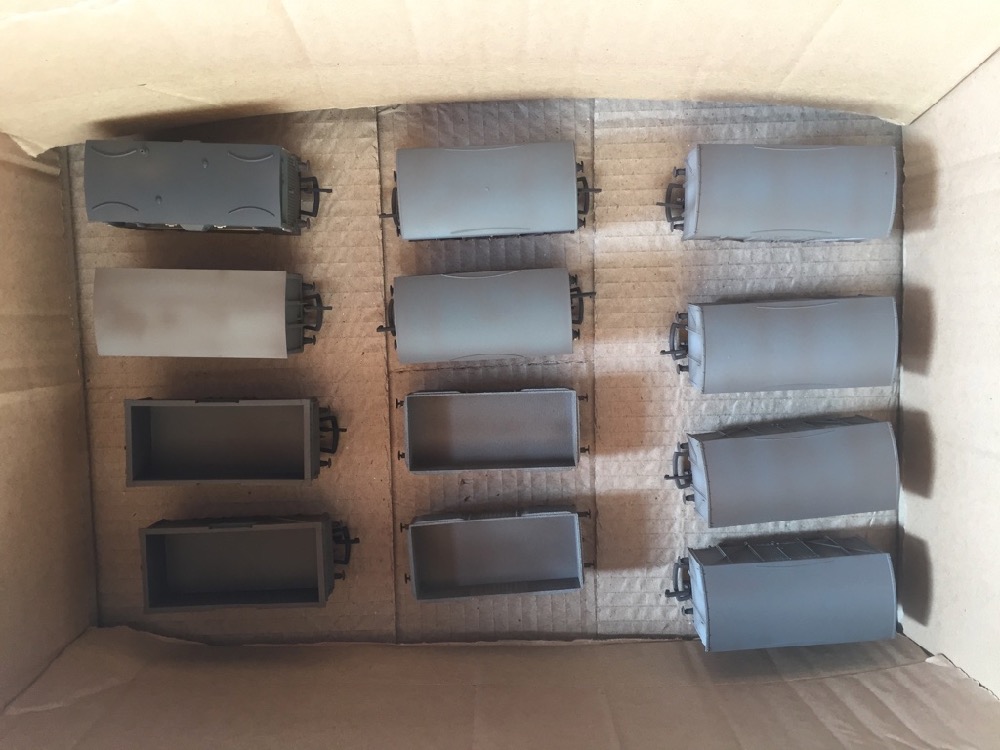

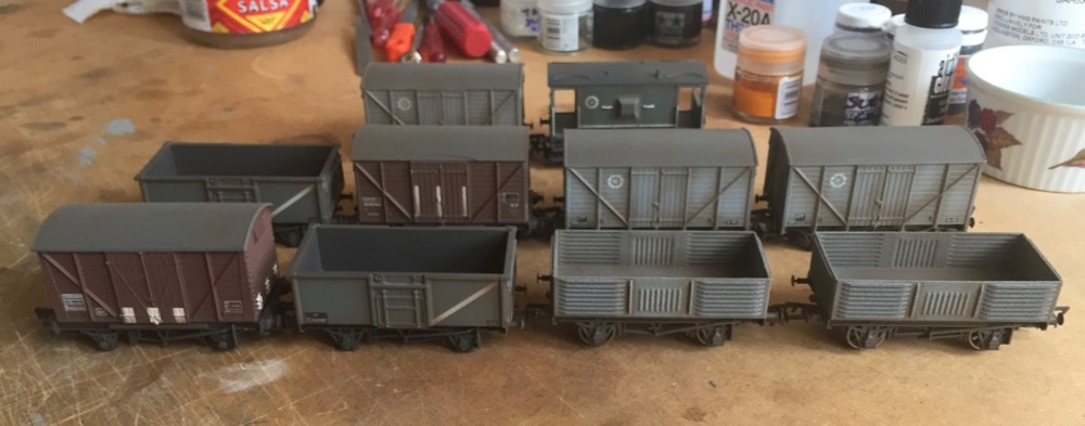

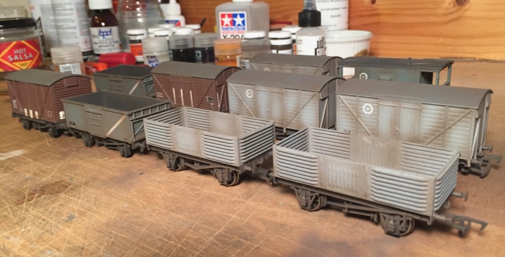

Noel Posted March 31, 2017 Author Posted March 31, 2017 (edited) Got 10 more wagons very lightly weathered tonight, and ten more black chassis banished to middle earth. Looks a bit stark directly under the bench lamp, but hopefully look a little more subtle in daylight tomorrow. If not will touch them up a bit tomorrow. Then will leave 48hr to cure (probably OTT but don't want any interactions), and then spray can of matt varnish to seal them. Put some of SSM's decals on a few of them yesterday using 'Decal fix' straight onto matt finish without a gloss patch (as an experiment just to see how they would take). I prefer painting in natural daylight rather than indoor light. The two Valve design beat wagons look more acceptable after I brush painted them to slightly fill the 3D pitting and then air brushed very light weathering. Dapol chassis. Edited July 21, 2017 by Noel 1
burnthebox Posted March 31, 2017 Posted March 31, 2017 Nice one Noel, well done sir, they're looking mega, shove them on your tracks behind a 141 & enjoy & video. Now mind telling me what code, RAL mix or what was that TAN you put on the carriage, TIA ( don't forget that video ) Paul

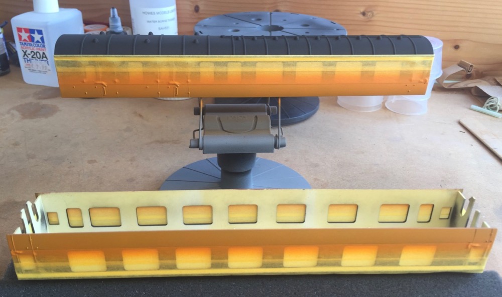

Noel Posted March 31, 2017 Author Posted March 31, 2017 Nice one Noel, well done sir, they're looking mega, shove them on your tracks behind a 141 & enjoy & video. Now mind telling me what code, RAL mix or what was that TAN you put on the carriage, TIA ( don't forget that video ) Paul Hi Paul. The TAN was mixed from Tamiya X-6 Orange and a tiny quantity of XF-64 Dull Brown (i.e. about 8 drops into half a mixing jar of orange). Possibly a drop or two of red might might be needed for some era's shade of tan. The MM cravens orange band have a little more red in them than my coach example. Noel

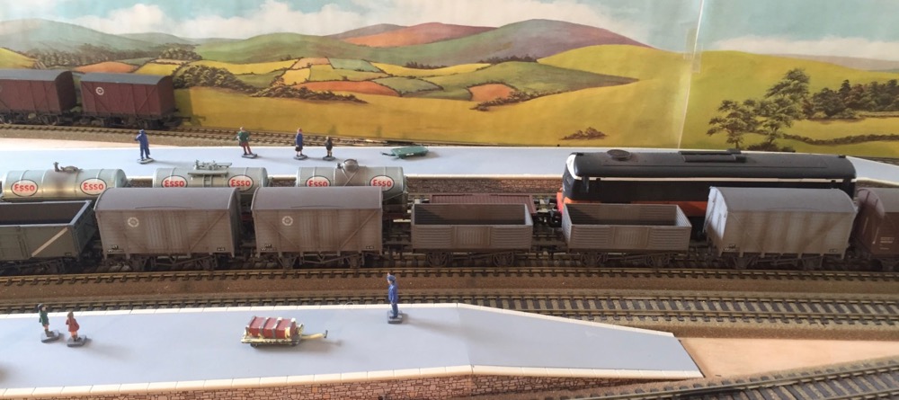

Noel Posted April 1, 2017 Author Posted April 1, 2017 (edited) The lightly weathered wagons and CIE decals look a little more subtle in natural daylight today compared to workbench lamp last night. Still learning - DECALS: Probably not the correct way, but the sequence I tried this time for applying the small waterslide transfers (CIE roundels) was: Spray wagon with matt acrylic paint (24hr after undercoat of Halfords grey primer) Apply water slide transfers using 'decal fix' 48hr later direct to matt finish (no gloss varnish under decal) Airbrush light weathering effects over wagon and decals using acrylic paints 48hr later (not sealed beforehand) Seal finished wagons with humbrol matt acrylic varnish 48hr later I tried this time without the extra gloss varnish step under decals, because the decals were small (6mm x 6mm) and I had seen a few video tutorials on Humbrol 'decal fix' which claimed it could be used with waterslide transfers directly on to a matt paint finish. I did it as an experiment to see if 'decal fix' really worked directly onto a matt acrylic paint finish, and in this case I seem to have got way with it. The decals are the little white CIE roundels below. I'm fairly new to all this painting and weathering so keen to try lots of experiments with different methods as I try to learn along the way. Not having to put a patch of gloss varnish under the small decals first, saved two steps and two extra drying times, not to mention having to then put a patch of matt varnish back over it afterwards before spraying some light acrylic weathering. Next time when I am adding decals to a loco will try a patch of gloss varnish under it, apply decal, apply matt varnish, then airbrush weather, then final coat of matt varnish to seal. But there seems to be a lot of varnishing steps. I will use a patch of gloss varnish though in future if applying larger decals. Loads more to learn but I'm loving the fun journey. Edited July 21, 2017 by Noel

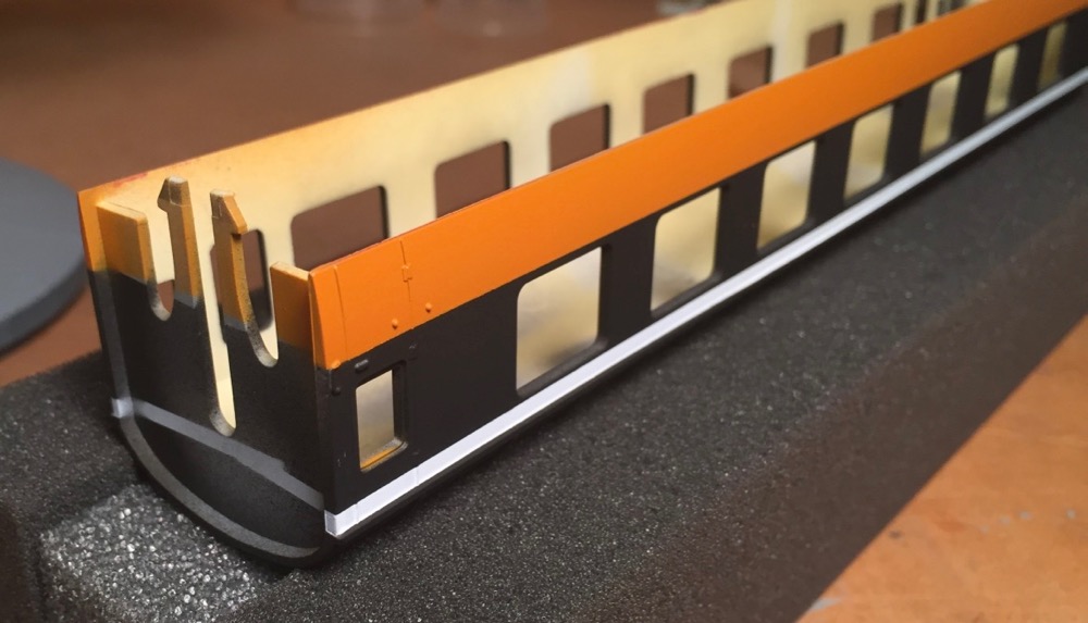

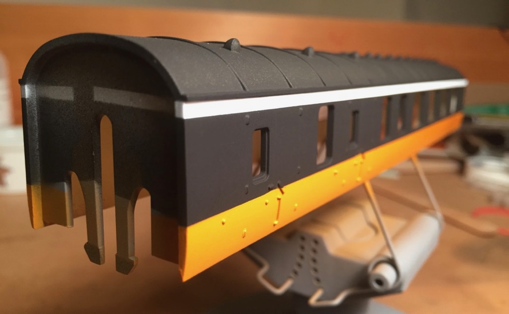

Noel Posted April 1, 2017 Author Posted April 1, 2017 (edited) Two more B&T coach resprays on the way - pseudo CIE Bredins. As JB suggests I'll mix these with other coaches in rakes for miss-mash formations like 1960s. Edited July 21, 2017 by Noel
Noel Posted April 1, 2017 Author Posted April 1, 2017 (edited) Pleasantly surprised this evening when the masking tape was removed on these two resprays to CIE Black'n'Tan Bredin(ish) from from Hornby Stanier BR Blood'n'Custard livery. This learning odyssey is addictive. Next will very lightly weather, mainly roofs and under frames as in the 60s coach sides were pretty clean, then a coat of matt varnish. The seating needs recolouring as well and a few seated pax installed. That will be three Bredin(ish) laminates to add to mixed B&T rakes on the layout. Edited July 21, 2017 by Noel

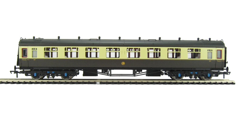

Noel Posted April 2, 2017 Author Posted April 2, 2017 (edited) . . . while your at it, any ideas as to what other BR / LMS coaches would be suitable for a lick of paint, for me, always keeping the 2 FOOT RULE in mind... Paul Hi Paul, I don't know, will look in the attic later, we would have to ask the 'Oracle' JB if something like this would pass muster as a repaint candidate. It's a much finer model than the Hornby toys I have used so far. Or, I have some of these in GWR livery, but not sure either look like any of the stuff CIE ever ran At this rate Noel you'll be setting up your own re - spray & weathering service!! Cheers, but I think not I'll stick to playing with my model trains. Edited April 2, 2017 by Noel Ommision
burnthebox Posted April 2, 2017 Posted April 2, 2017 Hi Paul, I don't know, will look in the attic later, we would have to ask the 'Oracle' JB if something like this would pass muster as a repaint candidate. It's a much finer model than the Hornby toys I have used so far. Cheers, but I think not I'll stick to playing with my model trains. Noel, I agree 100% of course, we would need to seek the knowledge of JB, but just think of the possiblities of the outcome ! A few photos of these coaches would be a great help. I have wagons that apart from colour, & which a coat or two of a similar paint, would, to me using the 2 FOOT RULE, not look out of place alongside / behind a B&T 141 ! Paul

Noel Posted April 5, 2017 Author Posted April 5, 2017 (edited) Finished lightly weathering 25 wagons. On next batch will try some alternate methods like washes and powders. This is addictive. Wagons after visit to varnishing shop - Humbrol Acrylic matt spray can varnish Wagons back on the layout CIE Decals from Weshty Video of rake of recently weathered wagons. Some sound editing to add to the DCC sound coming from the loco. I just love the diversity of loose coupled goods trains of that era. Edited July 21, 2017 by Noel
Noel Posted April 6, 2017 Author Posted April 6, 2017 Looking good - great weathering job. It really does make a difference. Cheers JB + Kieran. Well learning. The main thing is it has opened up another aspect of the hobby for me which I am enjoying. Looking forward to weathering the IRM ballasts later this month when my order is delivered. I added some background rail noises to the video which was interesting. I'm thinking of making up an app to play selected background sound mixes in a loop.
